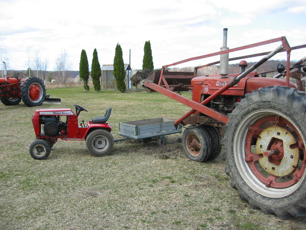

pfrederi 21,204 #17727 Posted November 18, 2022 14 minutes ago, Snoopy11 said: I'll likely be buying an older loader tractor of some sort in Spring... I would hope that it would be of variety, but I'm not opposed to something bigger as long as it is solid... @ebinmaine... Don Solid and reliable still working at 78 yrs old 1 6 Share this post Link to post Share on other sites

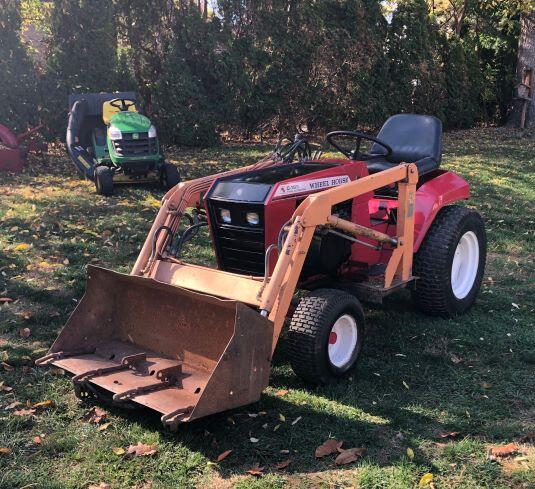

sjoemie himself 3,232 #17728 Posted November 18, 2022 17 hours ago, t_furl43 said: I added a johnson model 14 loader to my C-195 I like it a lot! Looks like it was made for the tractor. Did it need a lot of modification to make it fit and work? 1 Share this post Link to post Share on other sites

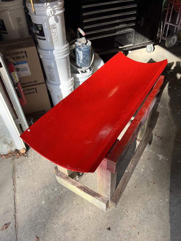

WHGuy413 2,859 #17735 Posted November 19, 2022 Todays progress on the plow while I was at work. Looks pretty decent to me. Minus the pitting. Brought Alex down to check it out and get his approval and he’s very happy. 9 5 Share this post Link to post Share on other sites
Handy Don 17,515 #17736 Posted November 19, 2022 I'd wonder who'd be foolish enough to complain after getting their plow prepped and painted for them! Not me, for sure. Looks good from here 3 2 Share this post Link to post Share on other sites
WHGuy413 2,859 #17737 Posted November 19, 2022 10 hours ago, Handy Don said: I'd wonder who'd be foolish enough to complain after getting their plow prepped and painted for them! Not me, for sure. Looks good from here Haha he certainly isn’t that foolish. He has handled the majority of this project but asked me to paint it. Which is fine with me. The approval was more for his color choice. 2 Share this post Link to post Share on other sites

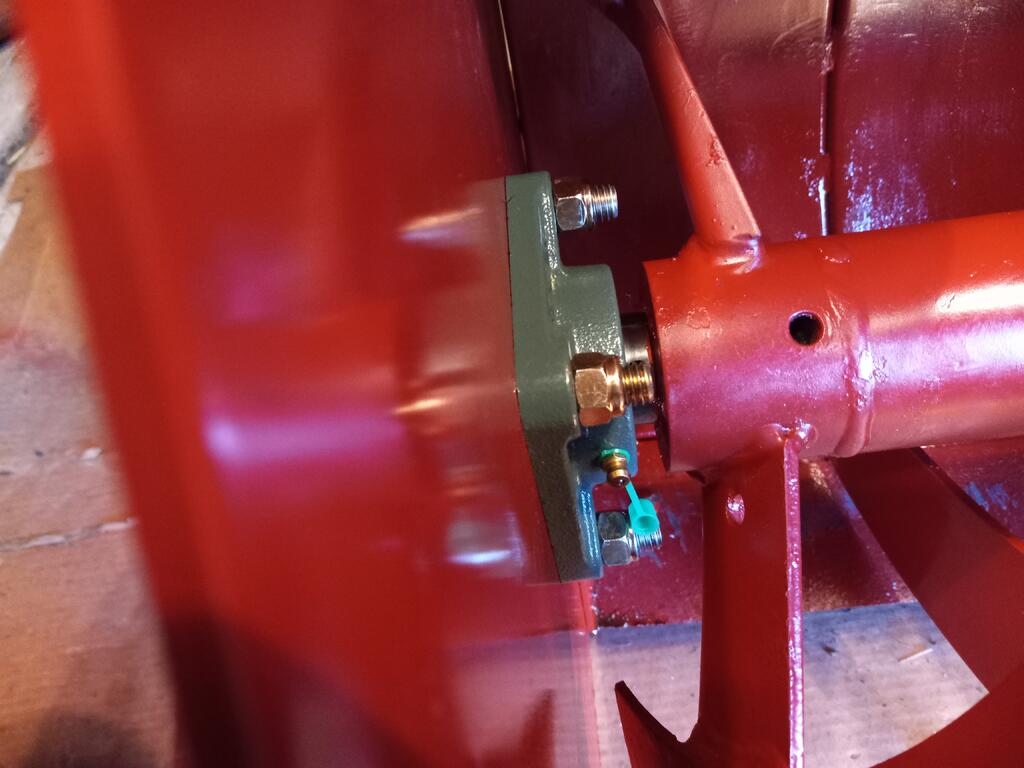

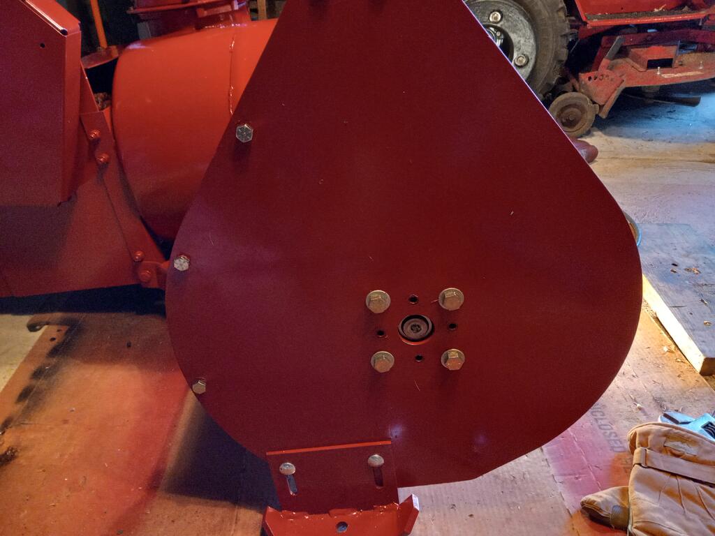

Panther416-8 342 #17738 Posted November 19, 2022 Replaced the factory auger shaft bushings on my two stage snowblower with greasable flange bearings. I did have to drill new holes on the side plates due to the spacing and size. Used the bearings at the link below. Cheaper than the factory bushings and seem to be of very good quality. They are PGN bearings and I didn't see any China markings which is nice. Definitely a nice upgrade. Thanks @wallfish @ri702bill https://www.amazon.com/gp/aw/d/B07QLBYT1Y?psc=1&ref=ppx_pop_mob_b_asin_title 3 6 Share this post Link to post Share on other sites
ri702bill 13,120 #17739 Posted November 19, 2022 Spin it while you grease it, place the protective cap on when done - looks good... Bill 3 Share this post Link to post Share on other sites
Panther416-8 342 #17740 Posted November 19, 2022 40 minutes ago, ri702bill said: Spin it while you grease it, place the protective cap on when done - looks good... Bill Thanks Bill. Yep, that's why I still have the shear pins out but ran out of grease. I've been using the Lucas grease but most of the auto parts stores around me seem to be out. 1 Share this post Link to post Share on other sites
wallfish 20,647 #17741 Posted November 20, 2022 3 hours ago, Panther416-8 said: Replaced the factory auger shaft bushings on my two stage snowblower with greasable flange bearings. We can also see the broken tap in that hole now. Glad it worked out and it's probably a better set up now. Other things to do are to add rubber paddles to the the impeller so they don't leave that space between them and the housing. But securing the gear box to the housing helps too with keeping everything steady. I wore my first set of rubber paddles prematurely because of the movement. Securing the auger gearbox solved it. ( Although it smelled like a car doing a burnout when they're first added) Another good item for maintenance/performance is to flatten the 2 surfaces for the PTO pulleys. I use a belt sander for the metal and sandpaper on a small block for the clutch pad material. Makes a huge difference if those 2 mating surfaces aren't on full contact now. If the PTO pulleys are getting hot under load , they're slipping so more contact area helps. Add motorized chute controls too 3 2 Share this post Link to post Share on other sites

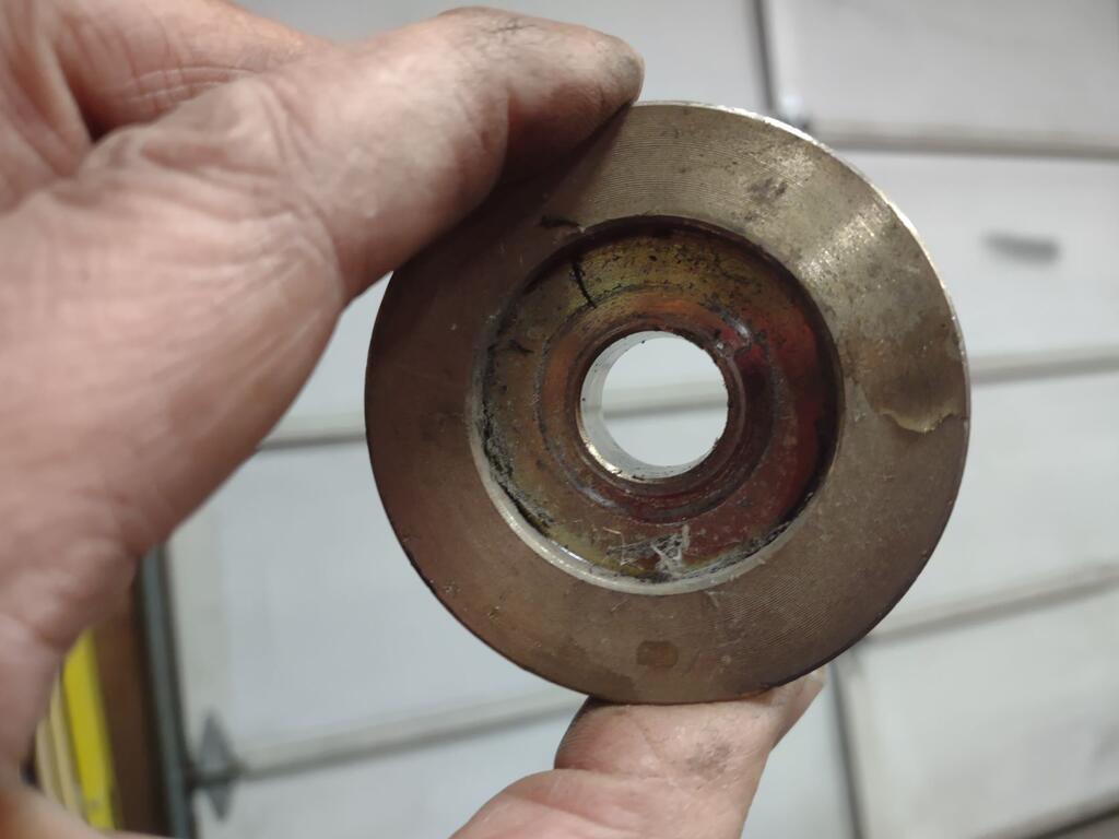

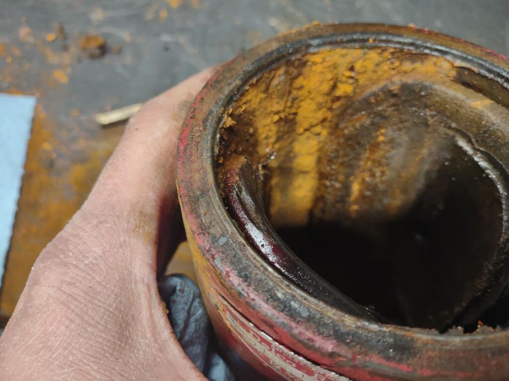

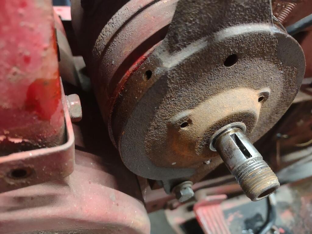

Achto 32,816 #17742 Posted November 20, 2022 I pulled a tractor out of storage to see if I could get it running today. I acquired this tractor a few years ago as a non-runner. Brought it home, stuffed it in storage and have not touched until today. Unfortunately things did not go real well. I hooked a battery up, hit the starter button, & ...... NOTHING. Grabbed the pulley on the fly wheel to find that it would not move at all. I decided to remove the starter/gen belt in order to get a better grip on the fly wheel pulley. Surprise!!! the engine turns over like it should. Bad news the S/G is locked up tight. Lets roll through what I found. First, just to let you know how tight this S/G was locked up. I was able to remove the pulley nut with a wrench, without holding the shaft at all. Which leads to the first issue that I've found. Any one see an issue with this nice pulley that a PO installed? May be this will add a clue. Correct me if I'm wrong but shouldn't there be a key way cut inside the pulley?? Wonder how the PO thought this would work. Issue 2 with the pulley - It bottoms out on the case of the S/G when it is tightened down. Is this what was locking the S/G up??? Well not exactly. Broke it open to see what the deal was. Tapped the rear plate loose and it rotated easy as pie on the bearing, After removing the rear bearing plate I found this lovely mess. Removed the front bearing plate & things did not get any better. The rotor was actually rusted to the magnets, this is what was locking the S/G up. Sprayed every thing down with Sea Foam Deep Creep and left it sit for a while. After a while I was able to get the rotor to slide out of the case. Nasty mess here. Going to take some effort to try & save this mess, may not be able to save it at all. Goin' to give it a try though. 7 1 1 5 Share this post Link to post Share on other sites

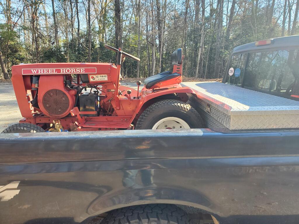

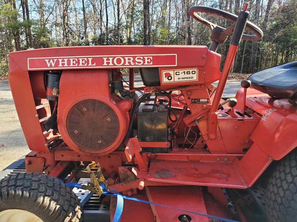

GAJoe 852 #17743 Posted November 20, 2022 Got it home! :), and unloaded. 5 9 Share this post Link to post Share on other sites

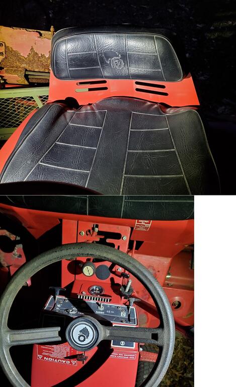

Achto 32,816 #17747 Posted November 20, 2022 11 hours ago, oliver2-44 said: Seems like your being a little evasive on the model of this tractor Here's a sneak preview of ground 0 for you. A lot of "shoe man" repairs to chase out of the ole girl. Will start a post when I get into it more. 8 2 1 Share this post Link to post Share on other sites
sjoemie himself 3,232 #17748 Posted November 20, 2022 Nice. Looks pretty decent from where i'm sitting. Also, that's one of those boat seats right? How does that sit comfort wise? 3 Share this post Link to post Share on other sites
ebinmaine 80,812 #17749 Posted November 20, 2022 43 minutes ago, sjoemie himself said: Nice. Looks pretty decent from where i'm sitting. Also, that's one of those boat seats right? How does that sit comfort wise? I was just thinking... I like that boat seat. 😂 2 Share this post Link to post Share on other sites
KrazeyOlDave 860 #17750 Posted November 20, 2022 On 11/17/2022 at 9:37 PM, t_furl43 said: I added a johnson model 14 loader to my C-195 Nice!! Pics of the hydraulic setup please? What did you use for the tank? Looks great! 2 Share this post Link to post Share on other sites
