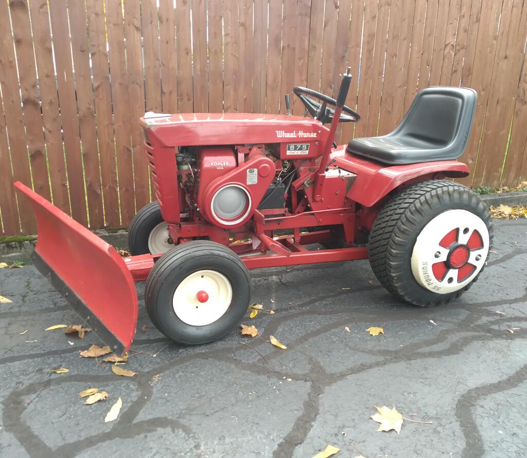

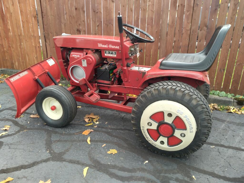

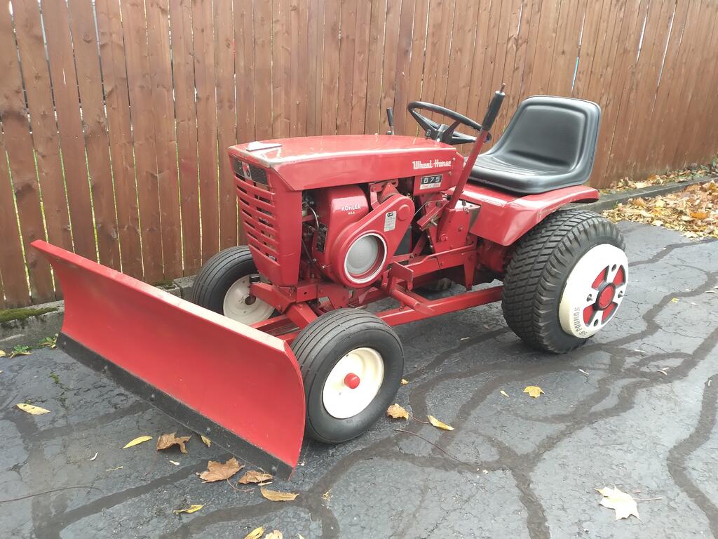

D_Mac 9,337 #17503 Posted October 28, 2022 (edited) Woke up this morning and frost was covering the ground outside. After I took my dog for a walk I pulled the 875 out for a 10 min ride. Parked it back in the garage. Went and filled my gas can with ethanol free gasoline and added Sta - bil. I'm all ready for when the frost turns to snow. Going to look for a set of chains for the rear tires. I used this tractor last year with no weights on the rear to plow and it did just fine. Now that I added the weight I might as well put chains on the tires. Edited October 28, 2022 by D_Mac 10 2 Share this post Link to post Share on other sites
Wheelhorse#1 1,956 #17504 Posted October 28, 2022 (edited) @D_MacNice .I’m really liking the 857.She’s ready for duty to battle the snow ! Edited October 28, 2022 by Wheelhorse#1 2 1 Share this post Link to post Share on other sites

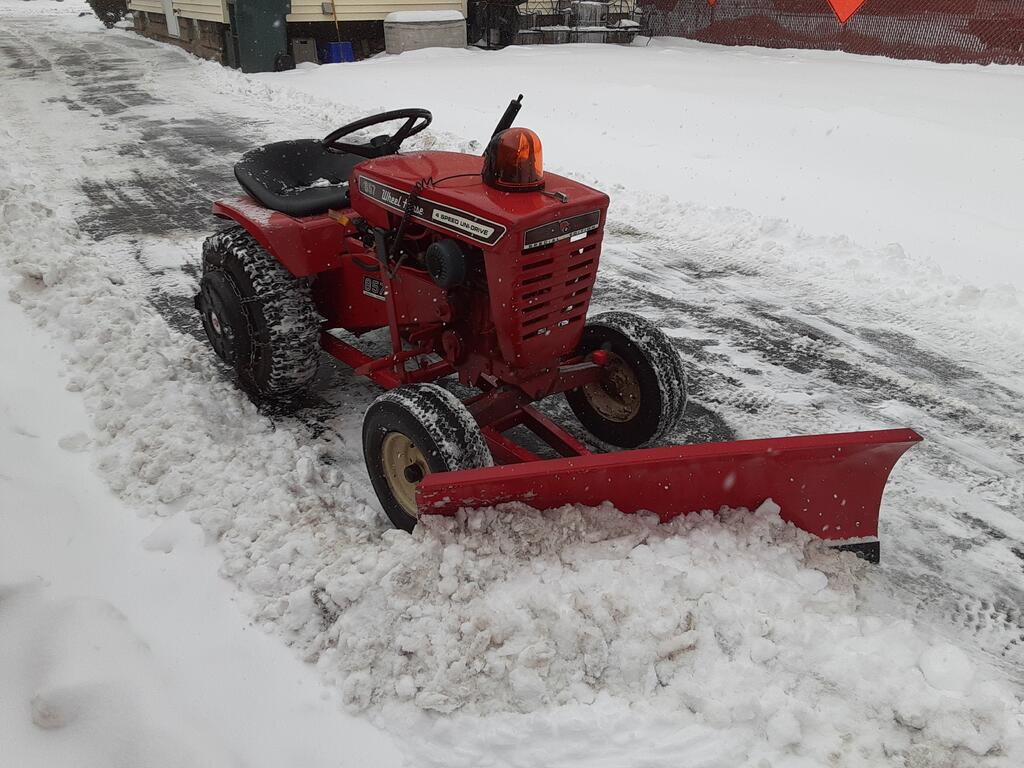

D_Mac 9,337 #17506 Posted October 28, 2022 (edited) 14 minutes ago, Wheelhorse#1 said: @D_MacNice .I’m really liking the 857.She’s ready for duty to battle the snow ! This one is an 875. The 857 was sold couple years ago. To be honest I like the automatic better for plowing. This was my 857. Edited October 28, 2022 by D_Mac 5 2 Share this post Link to post Share on other sites

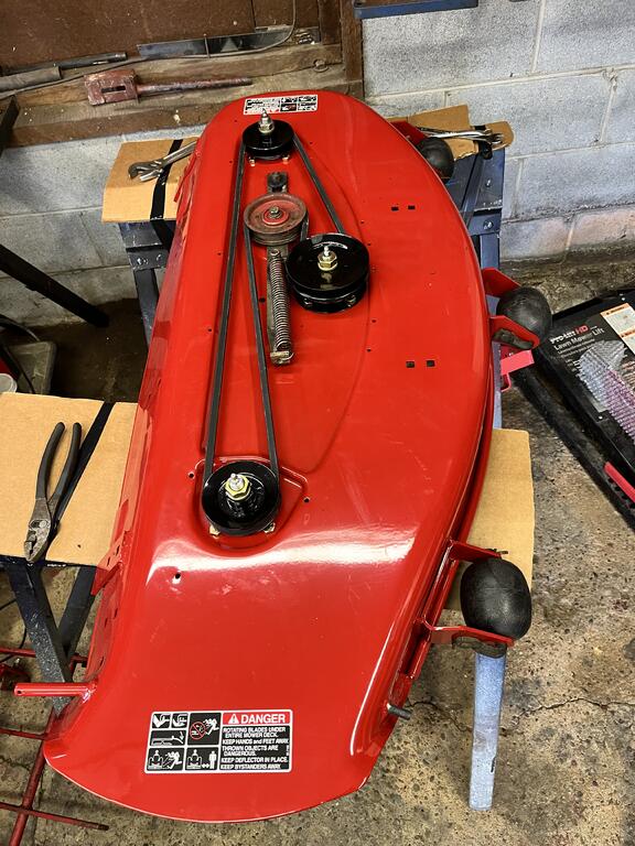

Wvtroutbum81 324 #17507 Posted October 28, 2022 Greetings from WV, first time posting. Restoring my dads old 312-8 and started with a new 42” shell. 5 7 Share this post Link to post Share on other sites

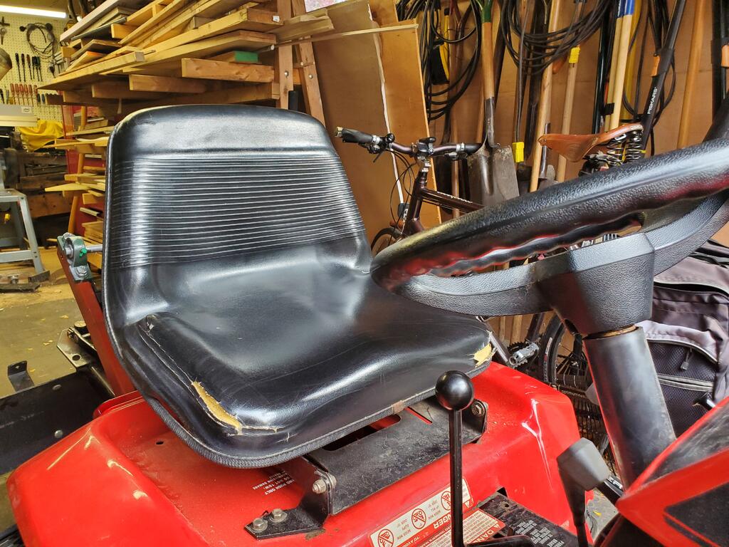

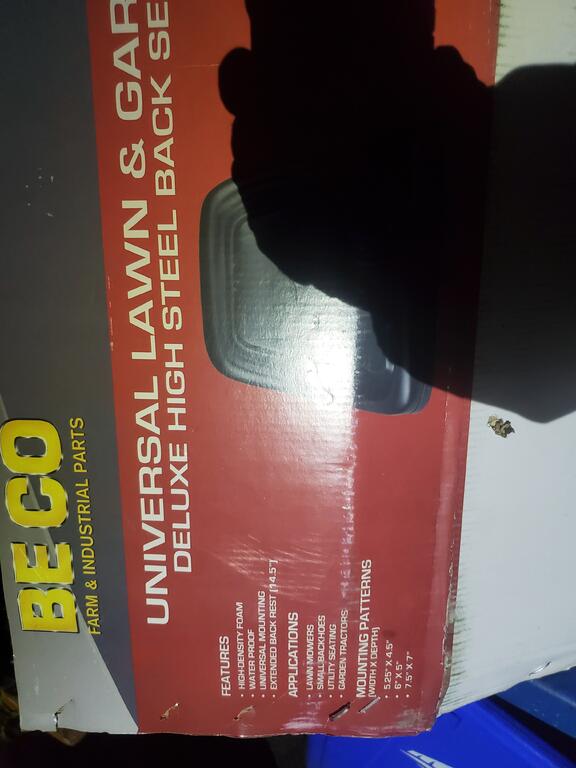

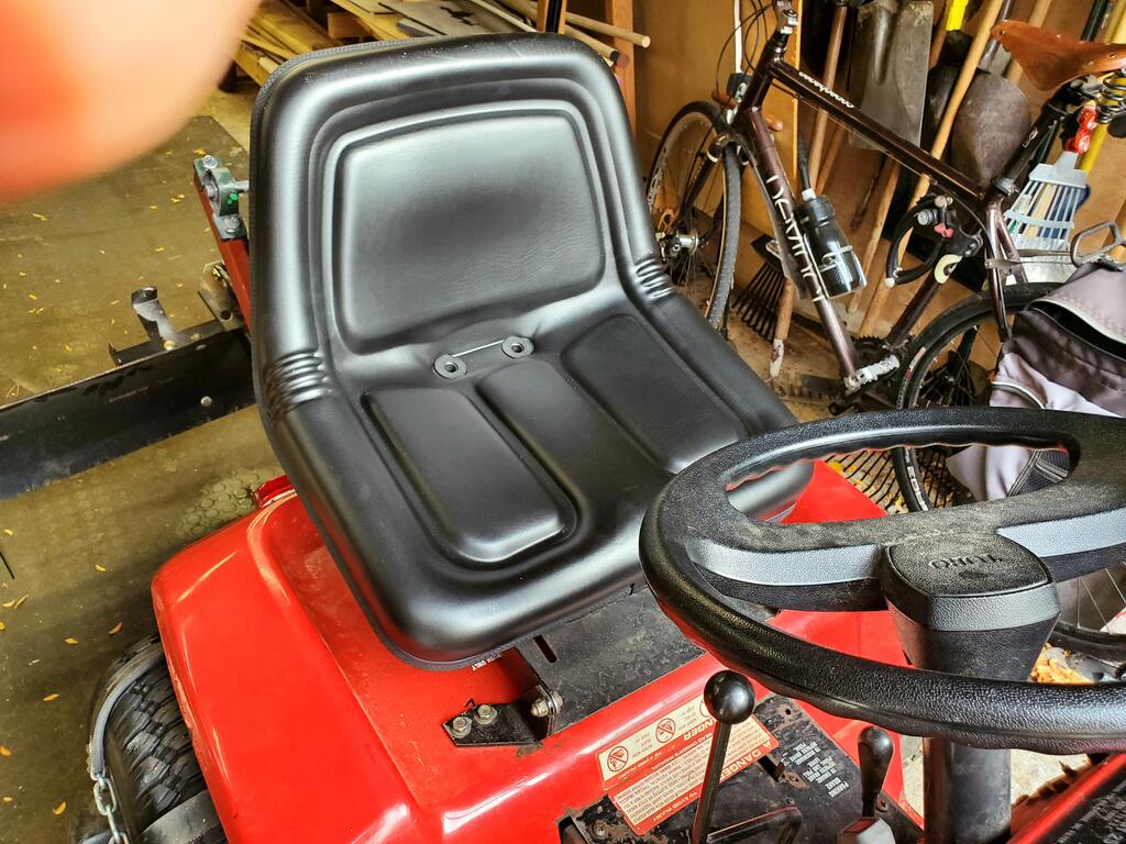

R Scheer 515 #17511 Posted October 29, 2022 I got tired of looking at the torn seat, so I found a solution. Old New Easy install, the bolt pattern matched up exactly. Not quite as comfy as the old one, but does have drain holes/channels that may be nice on rainy days. 8 4 Share this post Link to post Share on other sites

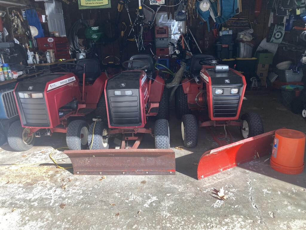

SylvanLakeWH 31,706 #17515 Posted October 29, 2022 Blades on!!! Ready for winter!!! 9 3 Share this post Link to post Share on other sites

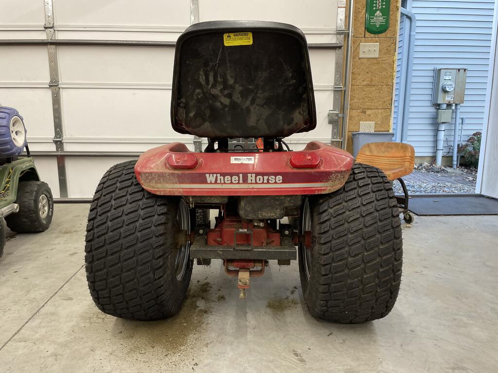

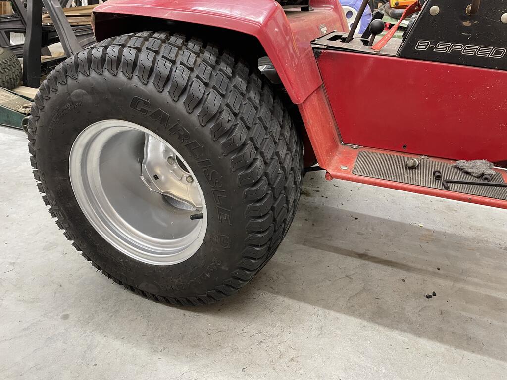

OoPEZoO 606 #17517 Posted October 29, 2022 (edited) Got some free wheels, tubes, and tires at work a few weeks ago, so I felt compelled to get them on the tractor. They are 24x12x12 Carlisle Turf Masters, and I mounted them on a set of 10.5x12 wheels. I just had to cut out the centers (they were the wrong bolt pattern) and weld in new center disks I picked up from Miller Tire. It was a fun project and I'm happy with the results. Not show quality, but then again, nothing I own ever is. Still debating if I want to pull them back off and fill them with fluid. They would be a serious bear to wrestle back on after that. Edited October 30, 2022 by OoPEZoO 7 9 Share this post Link to post Share on other sites
kpinnc 18,740 #17518 Posted October 30, 2022 3 hours ago, OoPEZoO said: Got some free wheels, tubes, and tires at work a few weeks ago, so I felt compelled to get them on the tractor. They are 24x12x12 Carlisle Turf Masters, and I mounted them on a set of 10.5x12 wheels. They look nice! 3 Share this post Link to post Share on other sites
ebinmaine 79,634 #17519 Posted October 30, 2022 3 hours ago, OoPEZoO said: debating if I want to pull them back off and fill them with fluid. They would be a series bear to wrestle back on after that I'm of the contingent that advises fluid filled tires. If you change over to studs and nuts the wheels will be much easier to reinstall. 3 Share this post Link to post Share on other sites
OoPEZoO 606 #17520 Posted October 30, 2022 1 hour ago, ebinmaine said: If you change over to studs and nuts the wheels will be much easier to reinstall. Funny you mention that......I was thinking the exact same thing while I was balancing one of these behemoths on my foot while trying to blindly get the wheel bolt started. 2 Share this post Link to post Share on other sites
sjoemie himself 3,117 #17521 Posted October 30, 2022 10 hours ago, OoPEZoO said: That looks FAT! I like it a lot. Great work on changing the centers. Was it a pain to get them squared up properly? 3 Share this post Link to post Share on other sites
ebinmaine 79,634 #17522 Posted October 30, 2022 7 hours ago, OoPEZoO said: Funny you mention that......I was thinking the exact same thing while I was balancing one of these behemoths on my foot while trying to blindly get the wheel bolt started. I can send instructions if you like. Easy enough to do. 1 Share this post Link to post Share on other sites

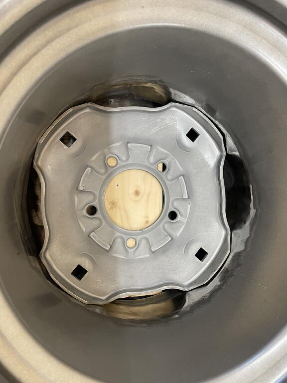

OoPEZoO 606 #17523 Posted October 30, 2022 4 hours ago, sjoemie himself said: That looks FAT! I like it a lot. Great work on changing the centers. Was it a pain to get them squared up properly? Thanks. Actually, it was not nearly as difficult as I imagined it would be. The center disks were slightly larger diameter than the inside of the wheels, so I slowly ground each "wing" of the disk down as uniformly as I could until they just slid down into the rims. It turns out the backspacing they used on stock wheels is almost the exact thickness as a piece of 2x4 lumber laying on its side. I mean, it may be off by 1/8" or so, but its more than fine. There should be plenty of clearance, even if I move them over to a Hydro tractor at some point. So I just set the rim on my welding table, dropped a chunk of 2x4 in the bottom, lined the wings of the disk evenly around the valve stem, and hit it with some tack welds. Then flipped it over and double checked the backspacing with a straight edge and depth caliper. Everything lined up fine the first try, so I went back and ran a weld bead along each wing. Below is a pick of right before I tack welded it 8 Share this post Link to post Share on other sites
