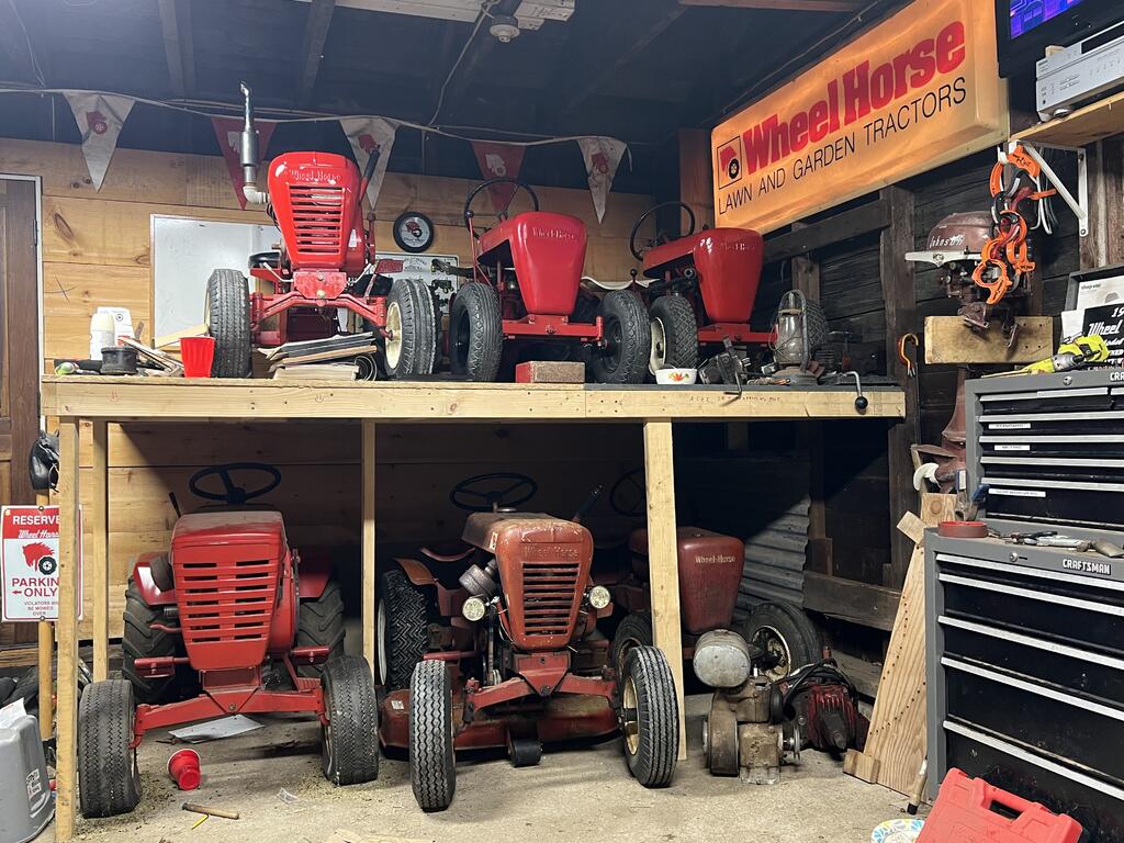

WHGuy413 2,859 #17155 Posted September 25, 2022 Boys and I put my show tractors away for the winter. They also staged some of their small engines and reel mowers in the old chicken coop that we have turned into their storage area. Making room in the garage for some projects. The 1277 that’s Aiden’s will be getting dragged out and worked on and the 1077 that’s Alex’s will be getting brought up from the shed out back to go threw it. 3 5 Share this post Link to post Share on other sites
Evguy 567 #17156 Posted September 25, 2022 @WHGuy413 I so need this in my building, always looking for floor space 4 Share this post Link to post Share on other sites
Heatingman 977 #17157 Posted September 26, 2022 53 minutes ago, WHGuy413 said: Boys and I put my show tractors away for the winter. They also staged some of their small engines and reel mowers in the old chicken coop that we have turned into their storage area. Making room in the garage for some projects. The 1277 that’s Aiden’s will be getting dragged out and worked on and the 1077 that’s Alex’s will be getting brought up from the shed out back to go threw it. Nice Concept. How much weight you got up there? Looks like one false bump of a 2x4 upright taking out a lower tractor, and you’ll wind up moving 3 of them on top of you. 2 Share this post Link to post Share on other sites

WHGuy413 2,859 #17160 Posted September 26, 2022 8 minutes ago, Heatingman said: Nice Concept. How much weight you got up there? Looks like one false bump of a 2x4 upright taking out a lower tractor, and you’ll wind up moving 3 of them on top of you. Well what ever the 3 tractors up there weigh plus usually a couple small engines and there is a tombstone weight up there. And of course all my miscellaneous junk that I need to go threw. The 2x4 uprights have been ok so far. It’s lagged into the wall studs and each upright is blocked on all sides to help Prevent twisting and falling. I’ve been doing this set up for prob 6 years or more and have never had an issue. 5 Share this post Link to post Share on other sites
WHGuy413 2,859 #17161 Posted September 26, 2022 58 minutes ago, Evguy said: @WHGuy413 I so need this in my building, always looking for floor space It helps for sure. In my attached shed I used to put 2 under and 1 on top. That would be my ideal location to stuff my 3 rj’s for winter but I can’t get in there cause I have so much junk in the way😂. By moving these tractors today to this shelf I made a ton of room to work on stuff. 1 Share this post Link to post Share on other sites

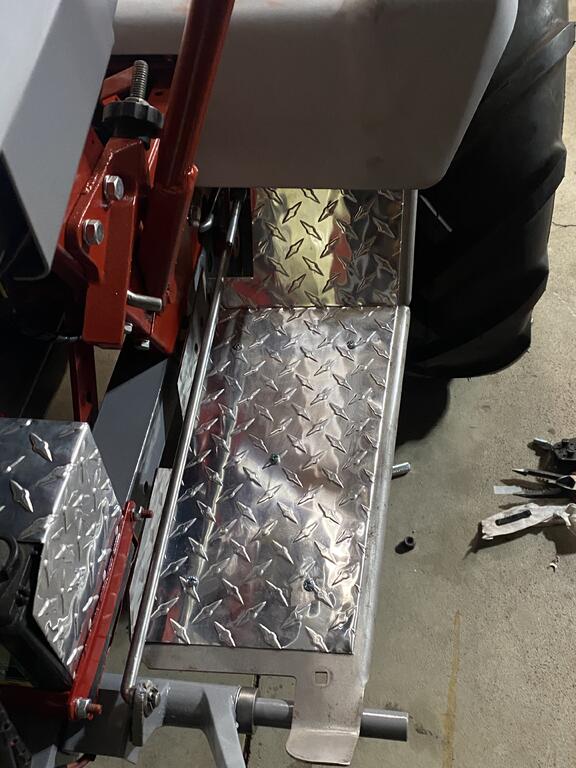

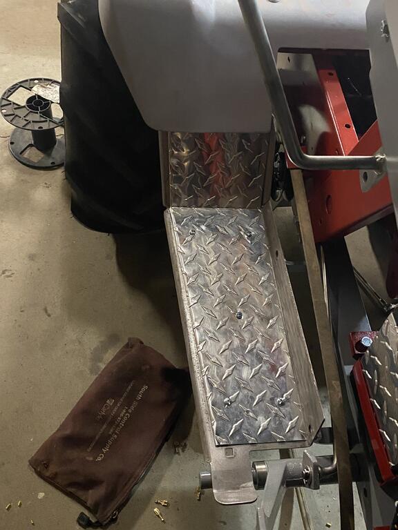

Handy Don 17,515 #17162 Posted September 26, 2022 3 hours ago, Heatingman said: Decided to add diamond plate onto the foot boards, and get them mocked up before painting Not sure how you plan to attach that, but it looks like a "trap water underneath and get rusty" situation. Share this post Link to post Share on other sites
Heatingman 977 #17163 Posted September 26, 2022 (edited) 5 minutes ago, Handy Don said: Not sure how you plan to attach that, but it looks like a "trap water underneath and get rusty" situation. 10-24 stainless button head screws, and silicone to seal out water. Ive had diamond plate rail covers on my pick up truck bed since I bought it new in 2006. Completely rust free. Edited September 26, 2022 by Heatingman 2 3 Share this post Link to post Share on other sites
Pullstart 71,336 #17164 Posted September 26, 2022 22 minutes ago, WHGuy413 said: It helps for sure. In my attached shed I used to put 2 under and 1 on top. That would be my ideal location to stuff my 3 rj’s for winter but I can’t get in there cause I have so much junk in the way😂. By moving these tractors today to this shelf I made a ton of room to work on stuff. What’s your method for loading and unloading? 1 Share this post Link to post Share on other sites
WHGuy413 2,859 #17165 Posted September 26, 2022 1 minute ago, Pullstart said: What’s your method for loading and unloading? It’s tall enough that a tractor with a lift arm can fit under it. Plus 4 inches with the 2x4 frame and plywood on top of that. I use ramps to roll them up and down. The boys each take a rear wheel and roll them up and I take the front axle and push. Works pretty good now that they are both bigger. Once we get them up there Aiden climbs up and moves them around to position. 4 Share this post Link to post Share on other sites
Evguy 567 #17166 Posted September 26, 2022 10 minutes ago, WHGuy413 said: It’s tall enough that a tractor with a lift arm can fit under it. Plus 4 inches with the 2x4 frame and plywood on top of that. I use ramps to roll them up and down. The boys each take a rear wheel and roll them up and I take the front axle and push. Works pretty good now that they are both bigger. Once we get them up there Aiden climbs up and moves them around to position. I wondered about loading also, I would be doing it solo. I was just looking at lifts if I wanted to implement this. 1 Share this post Link to post Share on other sites
Pullstart 71,336 #17167 Posted September 26, 2022 7 minutes ago, Evguy said: I wondered about loading also, I would be doing it solo. I was just looking at lifts if I wanted to implement this. block and tackle? 2 Share this post Link to post Share on other sites
WHGuy413 2,859 #17168 Posted September 26, 2022 8 minutes ago, Pullstart said: block and tackle? That’s always an idea I’ve had. Just never followed threw. Even a Pully and electric winch would work great. 2 1 Share this post Link to post Share on other sites
Evguy 567 #17169 Posted September 26, 2022 7 minutes ago, Pullstart said: block and tackle? If my pole barn had rafters that would support a lift I would go that route, guessing I could add some support structure. Owning a fork truck would be fun too 2 Share this post Link to post Share on other sites
ineedanother 2,872 #17170 Posted September 26, 2022 4 hours ago, Heatingman said: Decided to add diamond plate onto the foot boards, and get them mocked up before painting. I've been thinking about doing this but wasn't sure how to secure it and finish the edges without making it look like a hack job 1 Share this post Link to post Share on other sites

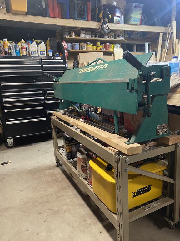

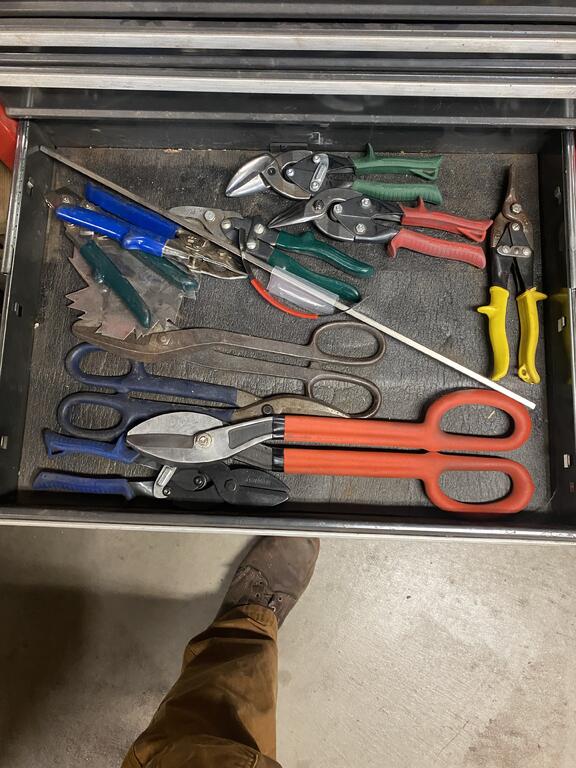

Heatingman 977 #17171 Posted September 26, 2022 6 minutes ago, ineedanother said: I've been thinking about doing this but wasn't sure how to secure it and finish the edges without making it look like a hack job Here is essentially what the finished product will look like. To cut and bend clean, you need good quality snips and a bender. I have both. 5 2 Share this post Link to post Share on other sites
Pullstart 71,336 #17172 Posted September 26, 2022 50 minutes ago, Evguy said: If my pole barn had rafters that would support a lift I would go that route, guessing I could add some support structure. Owning a fork truck would be fun too You could pull them up the ramps with block and tackle too…. Every pulley cuts the load in half, right? A long enough rope and plenty of pulleys and an RC truck could pull a tractor up hill right? 1 2 1 Share this post Link to post Share on other sites
Heatingman 977 #17173 Posted September 26, 2022 1 minute ago, Pullstart said: You could pull them up the ramps with block and tackle too…. Every pulley cuts the load in half, right? A long enough rope and plenty of pulleys and an RC truck could pull a tractor up hill right? Yes, but that block and tackle set would be more expensive then the tractor. 4 Share this post Link to post Share on other sites
ineedanother 2,872 #17174 Posted September 26, 2022 45 minutes ago, Heatingman said: Here is essentially what the finished product will look like. To cut and bend clean, you need good quality snips and a bender. I have both. Nice. There's a decent one at work, I might grease the skids with the guys over there for some future work 1 2 Share this post Link to post Share on other sites
