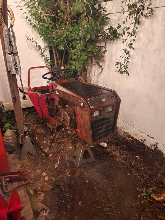

Heatingman 977 #16976 Posted September 12, 2022 11 hours ago, Monstrosity said: Well I was messing around with the 1054 I put the engine from the c125 on the frame and I need to do some fabrication. The base for the engine mount is wide and I kinda want to keep it isolated mounting. So lengthing the frame seems to be in the plans now. I set the c series hood on it and it doesn't look bad lol Poor thing definitely looks like its seen better days. Share this post Link to post Share on other sites

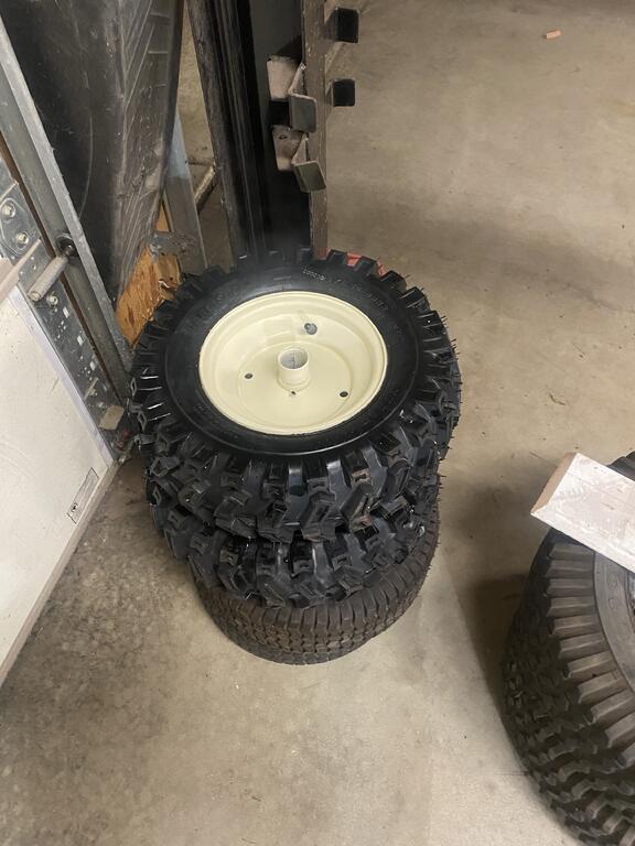

Gregor 4,848 #16977 Posted September 13, 2022 I see on the rims that the rim sides are about equal distance. Does it matter much whether you mount the tires from the front or back side? Share this post Link to post Share on other sites
rjg854 13,391 #16978 Posted September 13, 2022 (edited) Generally speaking if they are rims, the air nozzle would be to the inside of the tractor. The taper on the lug nut hole should be on the outside. Edited September 13, 2022 by rjg854 add 3 Share this post Link to post Share on other sites
ebinmaine 80,811 #16979 Posted September 13, 2022 6 minutes ago, Gregor said: I see on the rims that the rim sides are about equal distance. Does it matter much whether you mount the tires from the front or back side? I put tubes in all of my tires and I put the tube hole facing up because I find it easier. I mount one side of the tire on the rim. Get the tube in with the valve in the hole. Then proceed from there. If you're mounting a tire on a rim without tubes I don't think it matters. 1 Share this post Link to post Share on other sites

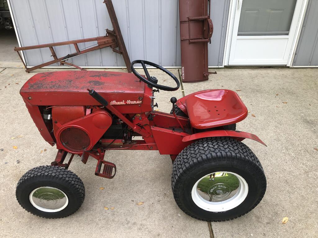

Rob J. 1,944 #16980 Posted September 13, 2022 Painted the seat for the 1045 and placed it on the tractor to get a look, think the regal red matches nicely. Now to let it finish drying. Little by little it’s getting there. Gitty up and cheers! 2 7 Share this post Link to post Share on other sites
ebinmaine 80,811 #16981 Posted September 13, 2022 3 minutes ago, Rob J. said: Painted the seat Quite a difference from the other color. It looks much better. 1 Share this post Link to post Share on other sites
Handy Don 17,515 #16982 Posted September 13, 2022 1 hour ago, Rob J. said: regal red matches nicely Does that make it a "hot" seat? 1 1 Share this post Link to post Share on other sites

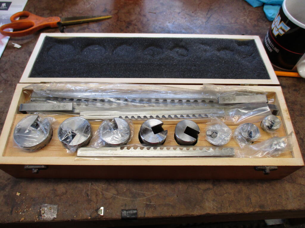

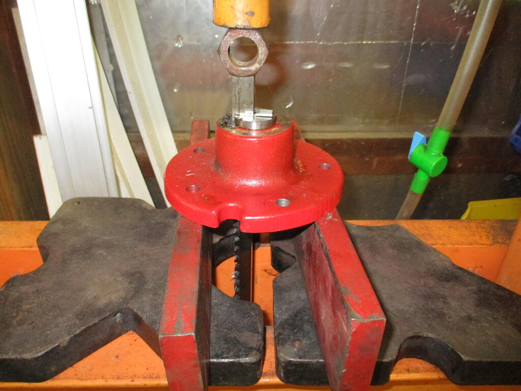

pfrederi 21,204 #16983 Posted September 13, 2022 (edited) After two months of drought it has rained a lot the last few days. Rained again to day so I did some hub repair. Beats $126 for a new one... Edited September 13, 2022 by pfrederi 3 9 Share this post Link to post Share on other sites
ebinmaine 80,811 #16984 Posted September 13, 2022 1 minute ago, pfrederi said: After two months of drought it has rained a lot the last few days. Rained again to day so I did some hub repair. Beats $126 for a new one... I've been mulling over purchasing the tool to do that. Already have the press. How would I find the correct thing I'm looking for? Share this post Link to post Share on other sites
pfrederi 21,204 #16985 Posted September 13, 2022 7 minutes ago, ebinmaine said: I've been mulling over purchasing the tool to do that. Already have the press. How would I find the correct thing I'm looking for? Got it on Amazon a couple years ago. It is a nice set but more than I really needed. Have only used the 1-1/8" and 1" guides... Over $200 now ... But I have done several hubs so it has paid for itself 2 4 Share this post Link to post Share on other sites

Heatingman 977 #16987 Posted September 14, 2022 7 hours ago, pfrederi said: After two months of drought it has rained a lot the last few days. Rained again to day so I did some hub repair. Beats $126 for a new one... What is it that you are doing here? Cleaning/enlarging the key way? Share this post Link to post Share on other sites

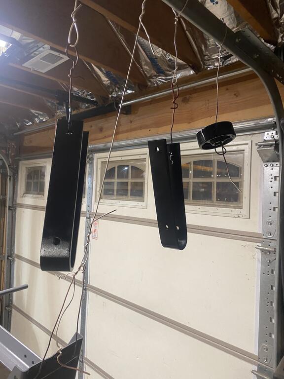

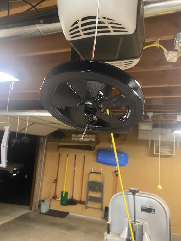

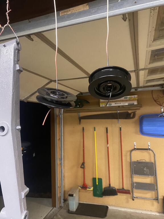

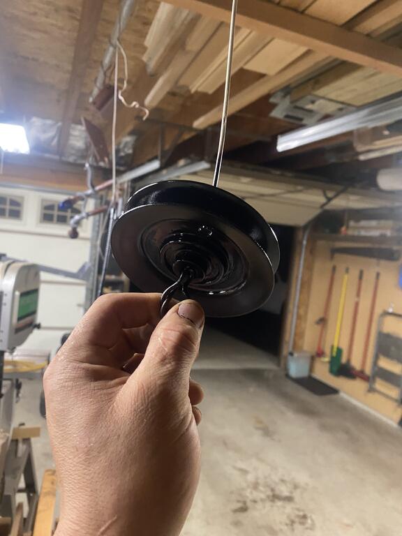

Heatingman 977 #16988 Posted September 14, 2022 (edited) I mounted the front tires on the rims, knowing full well there was gonna be some scratches to the fresh paint, I mounted in a way that all the scratches would be to the inside, then touched up those scratches with a brush. Also put some color on a few parts today, and yesterday. Black went on the pulleys yesterday, red today. Tomorrow I plan for a round of grey. Hope to start reassembly this weekend. Then once the bulk of the rolling chassis is back together, Ive gotta prep and paint the seat pan, and fenders. Also want to clean the carb and open up the motor to make sure nothing is too out of whack with it, then paint that, mount and tractor complete. So maybe another month and a bit. Edited September 14, 2022 by Heatingman 6 Share this post Link to post Share on other sites
ebinmaine 80,811 #16989 Posted September 14, 2022 9 hours ago, 8ntruck said: demounting For a junk tire I've used a sawzall with a long fine blade. A little time consuming but seems easier than the wrestling match. 6 hours ago, Heatingman said: What is it that you are doing here? Cleaning/enlarging the key way? Making a new keyway. Share this post Link to post Share on other sites
squonk 48,184 #16990 Posted September 14, 2022 17 hours ago, pfrederi said: After two months of drought it has rained a lot the last few days. Rained again to day so I did some hub repair. Beats $126 for a new one... Ok Paul. How do you keep that nut from flying out and taking out some bridgework? 2 Share this post Link to post Share on other sites
pfrederi 21,204 #16991 Posted September 14, 2022 2 minutes ago, squonk said: Ok Paul. How do you keep that nut from flying out and taking out some bridgework? I have used it or something like it several times to avoid having to reposition the hub a third time to complete the cut. I only use it for the last inch or so, so it is stable. 2 Share this post Link to post Share on other sites

kpinnc 18,995 #16996 Posted September 14, 2022 20 hours ago, Heatingman said: What is it that you are doing here? Cleaning/enlarging the key way? Broaching. Even if it is an Amazon product, so long as it works- it keeps another Wheel Horse working. And by definition that is a broaching process! Who needs a machine shop? 4 Share this post Link to post Share on other sites
lynnmor 9,042 #16997 Posted September 14, 2022 33 minutes ago, kpinnc said: Broaching. Even if it is an Amazon product, so long as it works- it keeps another Wheel Horse working. And by definition that is a broaching process! Who needs a machine shop? That is exactly what a machine shop would use, so you actually have one hundredth of one percent of a machine shop. 😶 1 Share this post Link to post Share on other sites
