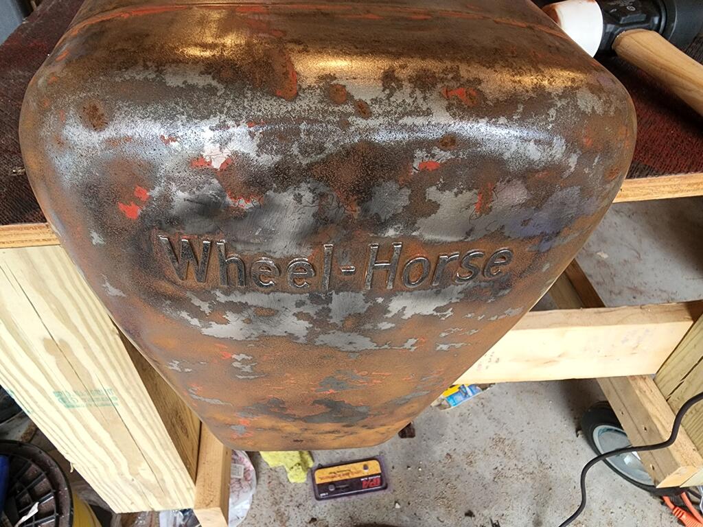

953 nut 69,635 #16776 Posted August 29, 2022 9 hours ago, Pullstart said: 20 hours ago, Heatingman said: @Andy N. Did that e tank remove paint too? Or just rust? And what fluid? Just food preservation grade vinegar? This thread might help… but WASHING Soda is my go-to with water. @Andy N., Never add vinegar to the washing soda in the E Tank. Vinegar is an ACID, low PH and washing soda is a base, high PH and the two will neutralize each other forming a salt which is worthless for removing rust or paint. 5 Share this post Link to post Share on other sites
Andy N. 2,842 #16777 Posted August 30, 2022 21 hours ago, Heatingman said: @Andy N. Did that e tank remove paint too? Or just rust? And what fluid? Just food preservation grade vinegar? I just used Arm & Hammer Super Washing Soda in the water. I used about 2 cups and it's a 40 gallon tub. It did start to bubble the paint in some areas, but most of what you see where the paint is missing were rusty spots. Below is the link for the washing soda. I'll probably experiment some next time with amount of soda added and length of the soak. https://www.amazon.com/dp/B0029XNTEU?psc=1&ref=ppx_yo2ov_dt_b_product_details 1 Share this post Link to post Share on other sites
WHGuy413 2,859 #16778 Posted August 30, 2022 I have only ever used Armon Hammer washing soda in my e tanks. It works really really well. I’ve used old chunks of rebar as my sacrificial pieces in there. The more you put the better. The E tank will take off paint but only if there is rust under it. 1 Share this post Link to post Share on other sites

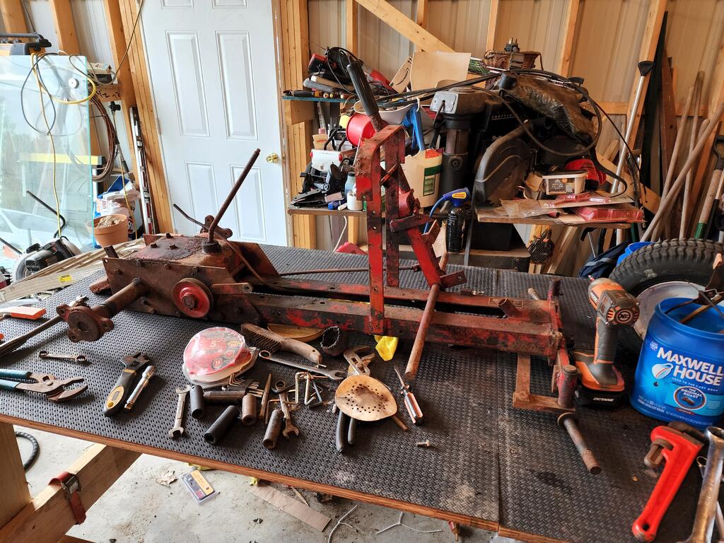

Heatingman 977 #16782 Posted August 30, 2022 Yesterday I got the plow partially reassembled and all motion points lubed. Works as @peter lena says like a rifle bolt. Im waiting for the new wear bar before I go the rest of the way. Also got the motor and wiring removed from the B80. Getting close. 6 2 Share this post Link to post Share on other sites

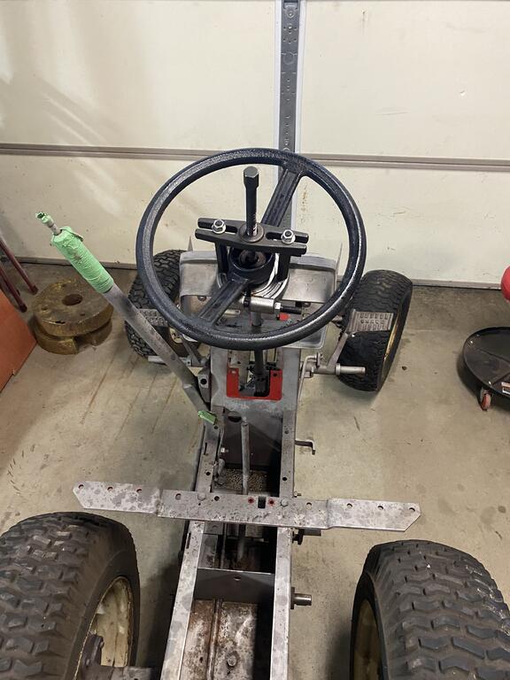

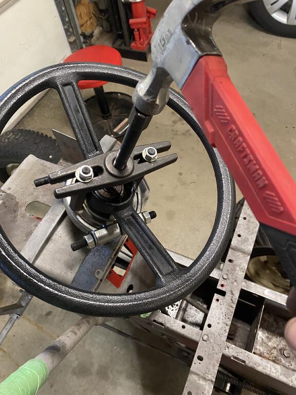

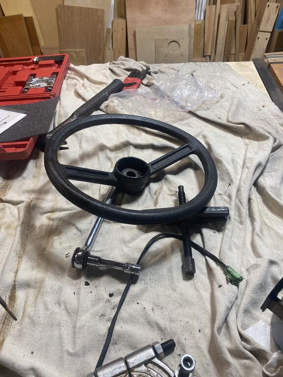

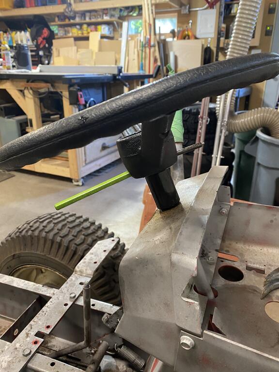

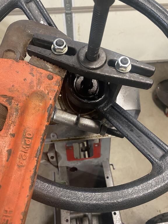

Heatingman 977 #16788 Posted August 30, 2022 Almost got the steering wheel off. 3/4 the way there. What a pain. As bad as any blower shaft or pump impeller Ive dealt with of similar size. Ive read on here that at times it’s impossible. Maybe that’s true some times. Here is my method. Soak the parts with PB or other penetrating oil. Drive the roll pin out - larger pin then it looks - so - roughly the same outside diameter as the access hole in the wheel cover opening. then grab your steering wheel puller, set it up, apply tension, then hit the puller screw like its a nail. Add more screw tension, then hit it again, rinse and repeat. Every whack of the hammer, you can get just a little more screw turning. If needed use a pipe wrench to hold back on the bridge of the puller when tightening the screw. Got about a 1/4 inch or so left. Been at it about 1.5 hours. Home stretch. 2 2 Share this post Link to post Share on other sites
Heatingman 977 #16789 Posted August 30, 2022 Got it. 2 2 Share this post Link to post Share on other sites

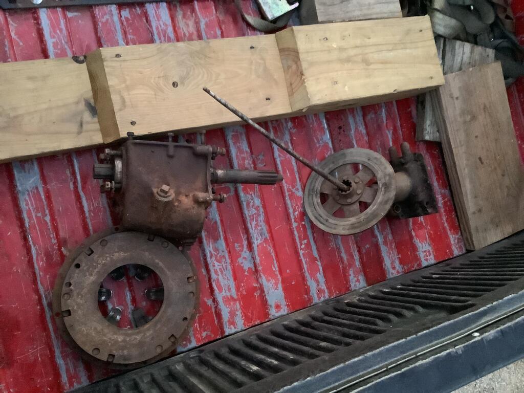

Pullstart 71,336 #16796 Posted August 31, 2022 Picked up a few spares this weekend… 3 1 2 Share this post Link to post Share on other sites

953 nut 69,635 #16799 Posted August 31, 2022 11 hours ago, Pullstart said: Picked up a few spares this weekend… Kevin, that clutch disk isn't goin to work well the way you have it mounted there. 5 Share this post Link to post Share on other sites
Pullstart 71,336 #16800 Posted August 31, 2022 7 minutes ago, 953 nut said: Kevin, that clutch disk isn't goin to work well the way you have it mounted there. I had to make it easy to carry one handed 2 Share this post Link to post Share on other sites
