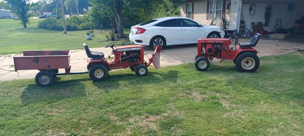

Markus Owens 7 #16755 Posted August 29, 2022 (edited) i took the first pic of them together Edited August 29, 2022 by Markus Owens 5 2 Share this post Link to post Share on other sites
ebinmaine 80,811 #16756 Posted August 29, 2022 3 hours ago, Markus Owens said: i took the first pic of them together Good looking pair. Share this post Link to post Share on other sites

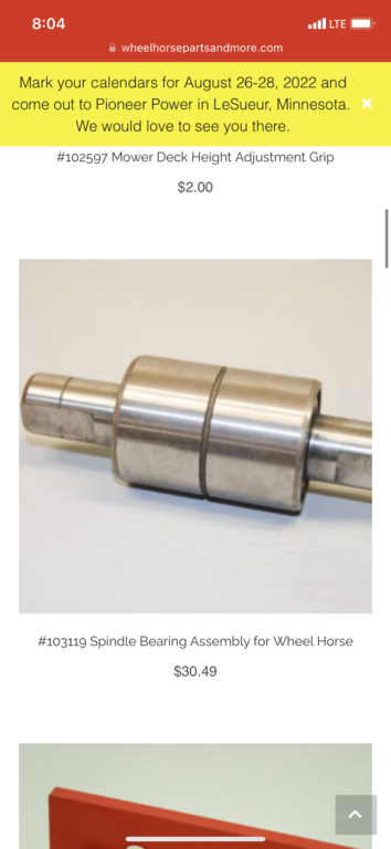

Heatingman 977 #16765 Posted August 29, 2022 36 minutes ago, peter lena said: @Heatingman deck looks sweet , did you upgrade those spindles ? cut a 2 x 12 scrap hunk for a angular deck prop up , similar ,but smaller when I clean and oil soak my deck s , holds up right up to the sun . deck gets hot , and sucks in the oil . pete Thank you and Yes, I installed new spindle bearings. This type unfortunately is not serviceable. I still have the old ones, so I may see what I can do with them, but as of yet, have not figured out how the spindles are assembled. This is the spindle bearing style: 1 Share this post Link to post Share on other sites

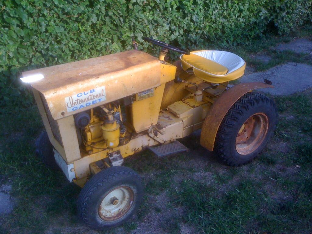

squonk 48,184 #16769 Posted August 29, 2022 10 hours ago, ohiofarmer said: Dad bought an original cadet and it did not come with fenders at all. i did see fenders in the catalog advert literature. This is an "original Original" that I had. Should have kept it. 2 Share this post Link to post Share on other sites

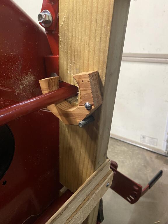

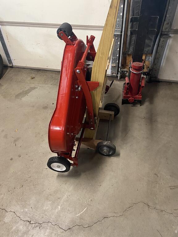

Heatingman 977 #16773 Posted August 29, 2022 18 hours ago, Handy Don said: Either way is a winner. Personally I like the Navajo better, but to each their own! Ok, that is a HUGELY clever idea which I plan to copy! Only improvement I can imagine would be if it mounted and unmounted the deck for you! Added the old worn deck wheels to the deck stand, so now its a deck stand/cart. Works as desired. Also added a safety pin (bolt) to the keeper. If you do make a copy, its hard to see in the pictures, but the bottom support feet are rounded like 3/4” 1/4 round on both ends to smooth the tilting. The plan is to take the stand back apart, and 1/2 lap / let in all the overlapping parts, glue, and screw back together, and knock down/round out the corners of the handles. But for now, its good enough - winter project. 10 1 Share this post Link to post Share on other sites

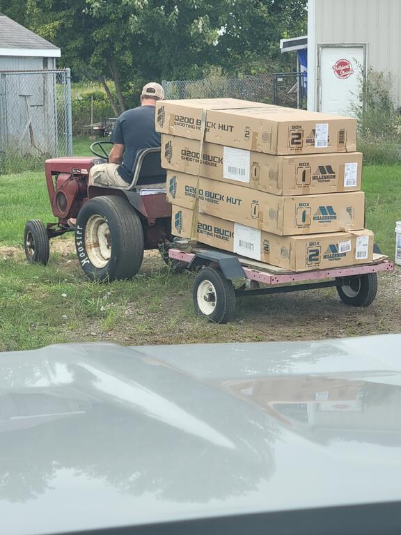

Pullstart 71,336 #16774 Posted August 29, 2022 Used Chloe the 953 to help unload a delivery from my uncle today. We’ll be putting these Q200 Buck Huts up soon. The tires were kind of flat in the bottom with close to 1,000 lbs on the trailer, so I aired them up from 4 psi to 45 psi. 4 2 1 Share this post Link to post Share on other sites

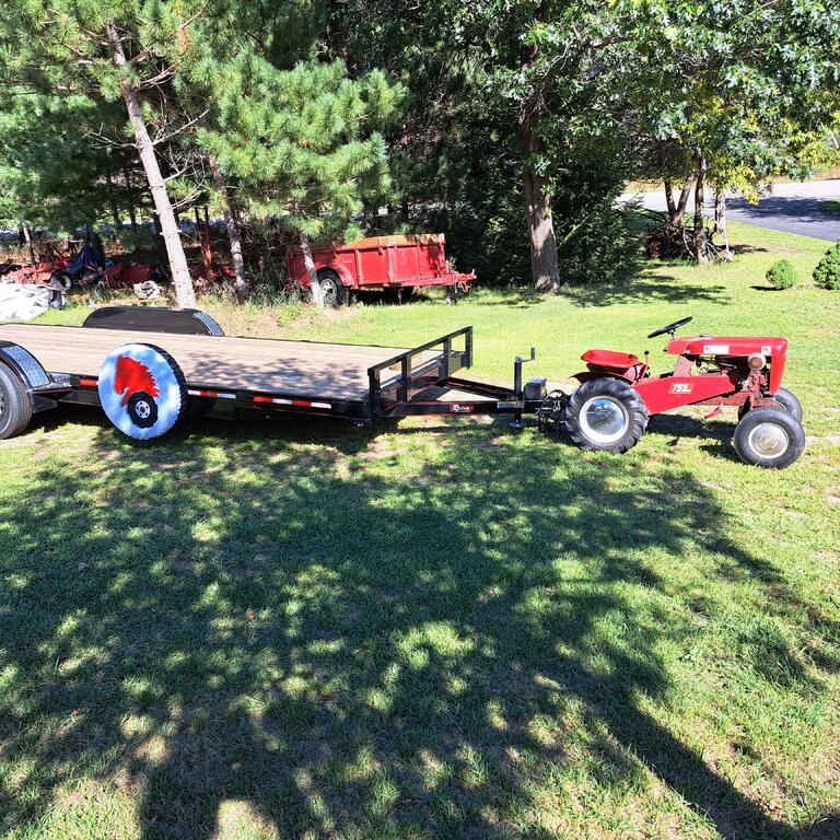

WHX?? 58,254 #16775 Posted August 29, 2022 (edited) Well I hooked up a 753 to a small tub too Kev... Just for the halibut and to make sure the new to me spare cover matched. Didn't figure the tongue jack would go that low but it did. Just used it to move to mow underneath. Edited August 29, 2022 by WHX?? 2 2 1 Share this post Link to post Share on other sites
