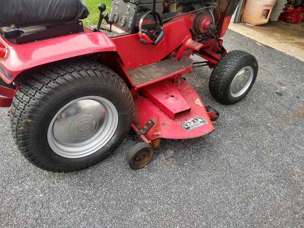

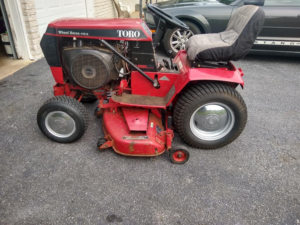

andyk 83 #16677 Posted August 25, 2022 Replaced belt on my side discharge deck and reinstalled. While I was at it I cleaned the wheels up a little bit and put the hub caps back on. My rear discharge deck really puts some grass on the leaft rear tire.. This winter I think i'm going freshen both my decks up by welding some baffles back on the RD deck and patch the holes on SD deck. 4 3 Share this post Link to post Share on other sites

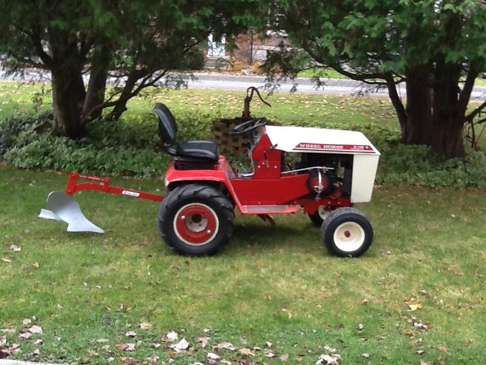

SylvanLakeWH 32,652 #16686 Posted August 26, 2022 33 minutes ago, Bill Winn said: Pardon me if this is the wrong spot to ask this... Can anyone point me to the Red Square member who has a c series that they have painted red and antique white instead of red and black. I am gathering materials to strip my WH and paint it over the winter and I remember really liking that off-white color. Bill @squonk? This one? 1 Share this post Link to post Share on other sites
Bill Winn 157 #16687 Posted August 26, 2022 1 minute ago, SylvanLakeWH said: @squonk? This one? Maybe I seem to recall white on the seat pan too though. I'm still hunting through the archives lol Share this post Link to post Share on other sites

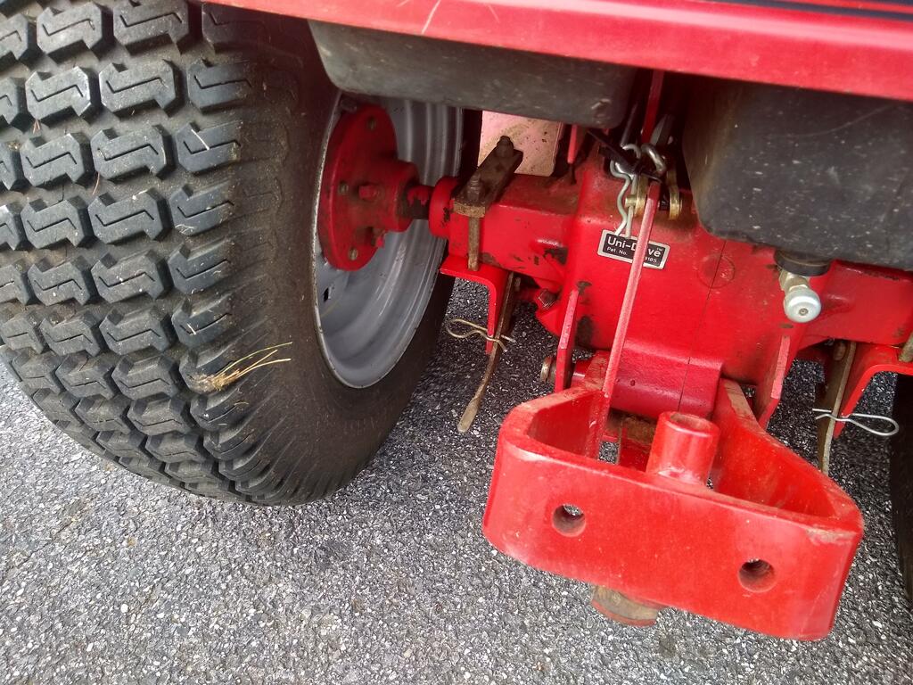

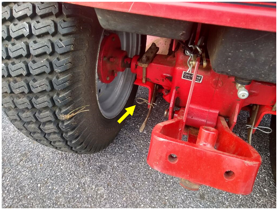

Bill Winn 157 #16688 Posted August 26, 2022 3 hours ago, andyk said: Totally dig your solution to those idiotic little pins on the rear tiller mount. Do your pins ever fail or bend? Does the hitch ever come open? Share this post Link to post Share on other sites

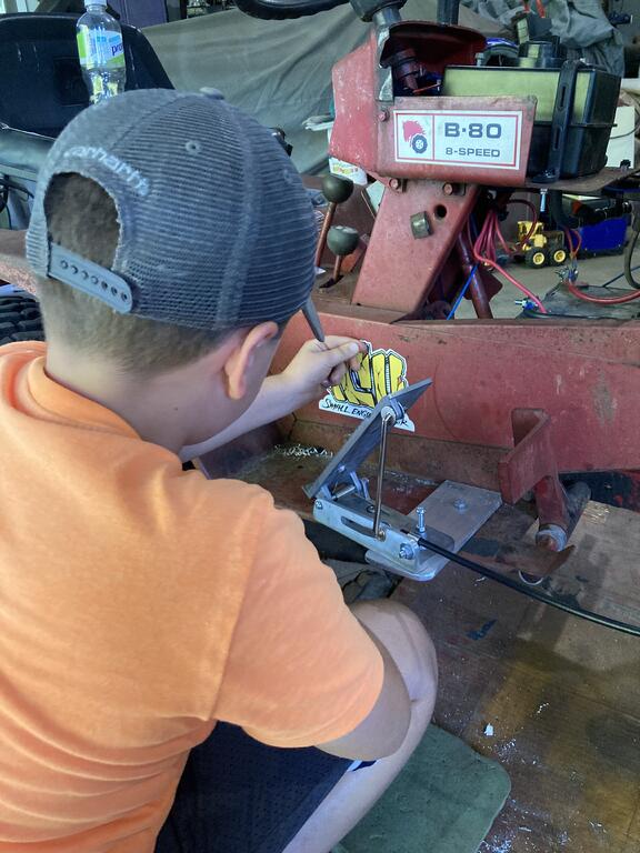

TonyToro 1,190 #16689 Posted August 26, 2022 @TonyToro Jr. and I worked on the B-80 for a few hours today. This pulling tractor is getting really close to completion. Tomorrow will be adding the aluminum rims with new tires, add a weight bar and get a final tune on it. 3 5 2 Share this post Link to post Share on other sites

Bill Winn 157 #16691 Posted August 26, 2022 1 minute ago, ineedanother said: Sorry Bill, I think I misunderstood what you were asking... My rear tiller mount has little hitch pins that lock the rear mount closed. Those little hitch pins have little “hair pin” keepers that are impossible to manage. I’ll post a pic tomorrow. Share this post Link to post Share on other sites
Heatingman 977 #16692 Posted August 26, 2022 23 minutes ago, TonyToro said: @TonyToro Jr. and I worked on the B-80 for a few hours today. This pulling tractor is getting really close to completion. Tomorrow will be adding the aluminum rims with new tires, add a weight bar and get a final tune on it. Whats that new pedal for? 1 Share this post Link to post Share on other sites
ineedanother 2,872 #16693 Posted August 26, 2022 1 minute ago, Heatingman said: Whats that new pedal for? Looks like the heater 2 3 Share this post Link to post Share on other sites

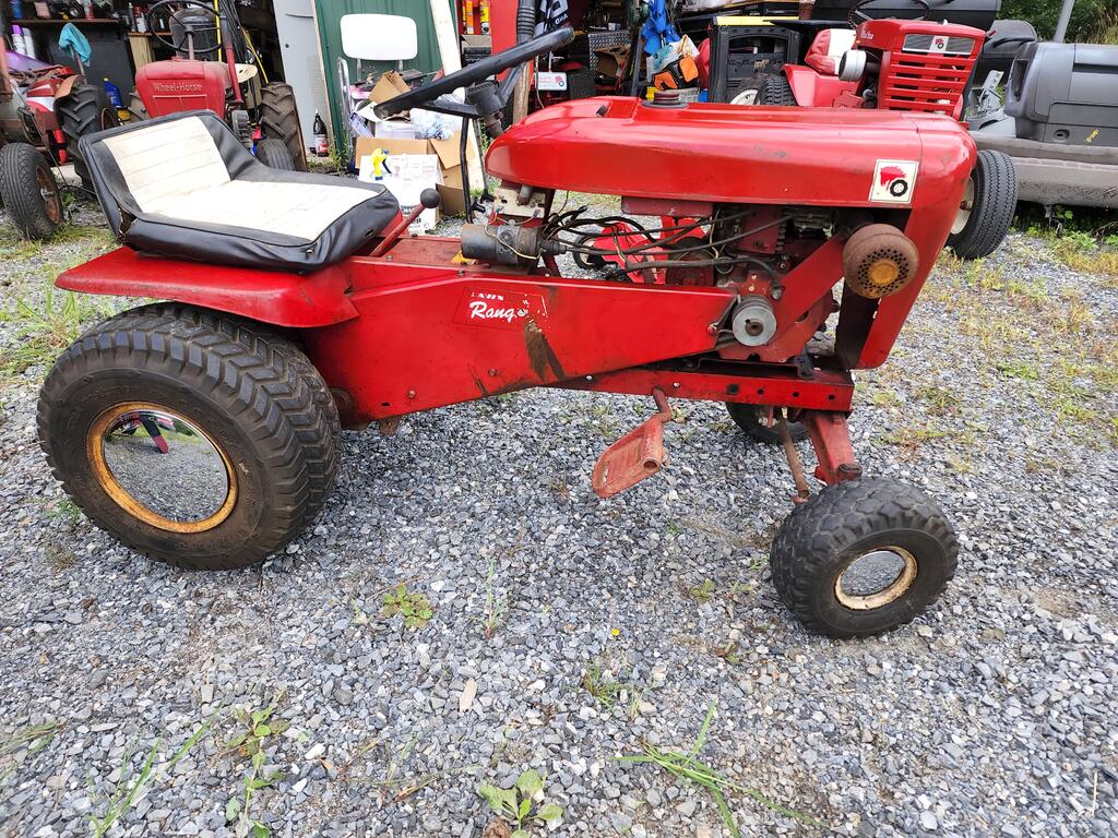

CRAZYFROG 302 #16694 Posted August 26, 2022 How about some NOS hubcaps on the Lawn Ranger 6 1 Share this post Link to post Share on other sites
andyk 83 #16695 Posted August 26, 2022 1 hour ago, Bill Winn said: Totally dig your solution to those idiotic little pins on the rear tiller mount. Do your pins ever fail or bend? Does the hitch ever come open? Havent lost any yet . used mainly with the front blade. rest of the year it keeps those hooks from catching on anything 2 Share this post Link to post Share on other sites

lynnmor 9,042 #16697 Posted August 26, 2022 5 hours ago, Bill Winn said: My rear tiller mount has little hitch pins that lock the rear mount closed. Those little hitch pins have little “hair pin” keepers that are impossible to manage. I’ll post a pic tomorrow. That is the correct way. Using only hairpins doesn't fill the holes and make for a sloppy fit and they would catch on things, especially when using a rototiller. 1 Share this post Link to post Share on other sites
ebinmaine 80,811 #16698 Posted August 26, 2022 46 minutes ago, lynnmor said: That is the correct way. Using only hairpins doesn't fill the holes and make for a sloppy fit and they would catch on things, especially when using a rototiller. 6 hours ago, Bill Winn said: My rear tiller mount has little hitch pins that lock the rear mount closed. Those little hitch pins have little “hair pin” keepers that are impossible to manage. I’ll post a pic tomorrow. Up here we need to be ready for snow/ice from Dec 1st or even earlier. We leave the plows on for several months. We keep the levers tightened up with the bolt. I use a grade 8 bolt with a nyloc nut. Not the quick and easy method but the pins and levers sure don't move. 2 1 Share this post Link to post Share on other sites
TonyToro 1,190 #16699 Posted August 26, 2022 8 hours ago, Heatingman said: Whats that new pedal for? That’s a foot throttle 3 Share this post Link to post Share on other sites
