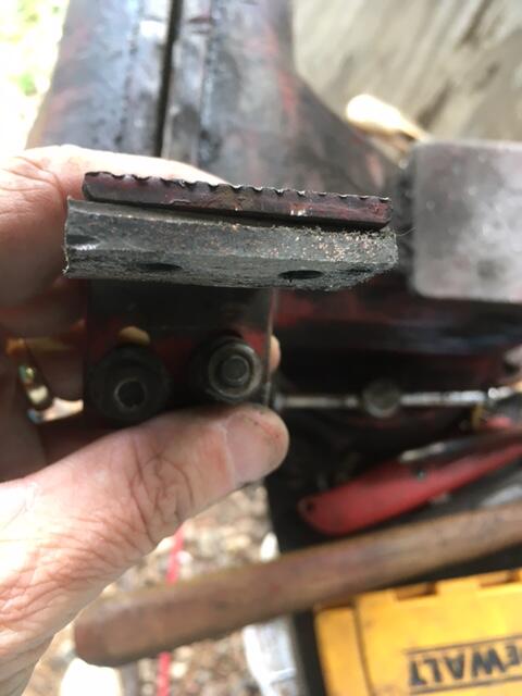

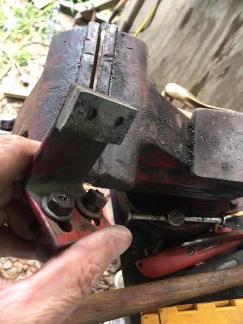

Bill Winn 157 #16653 Posted August 23, 2022 Working on a few general maintenance items in preparation for the new PTO bell and clutch when it arrives. My PTO brake pad was all worn down so I cut a piece of of an old brake pad from my wife's Camry and riveted it on. Bill 7 5 Share this post Link to post Share on other sites

Heatingman 977 #16657 Posted August 24, 2022 52 minutes ago, Bill Winn said: Working on a few general maintenance items in preparation for the new PTO bell and clutch when it arrives. My PTO brake pad was all worn down so I cut a piece of of an old brake pad from my wife's Camry and riveted it on. Bill Looks like plenty of brake pad left. maybe just smooth it out with a belt or disk sander. 2 Share this post Link to post Share on other sites

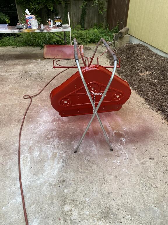

Heatingman 977 #16658 Posted August 24, 2022 Painted the deck when I got home from work. 8 2 Share this post Link to post Share on other sites
ebinmaine 80,809 #16659 Posted August 24, 2022 53 minutes ago, Bill Winn said: My PTO brake pad was all worn down so I cut a piece of of an old brake pad from my wife's Camry and riveted it on Hey nice work there Bill!! 19 minutes ago, Pullstart said: Now what’s SHE gonna do!?!? Who cares??!!?? The tractor is headed to working better. 41 minutes ago, 953 nut said: 666 Pages is true but as frequently as this train becomes derailed probably only 444 or so are about what we did on Wheel Horses. Likely more in the range of 222..... 1 3 Share this post Link to post Share on other sites
Bill Winn 157 #16660 Posted August 24, 2022 20 minutes ago, Pullstart said: Now what’s SHE gonna do!?!? I’m lucky enough that my sister in laws trust me with their children. Our youngest is nearing 13 and our oldest is on her own working full time LOL yep luckily they were the old set for the front. I per-emptively replace front and rears before state inspection this year because last year the garage I took it too hinted that they almost gigged me for the brakes. Cheaper by far to do them myself and I always keep stuff like used brake pads just in case. This time it paid off. 3 1 Share this post Link to post Share on other sites
Bill Winn 157 #16661 Posted August 24, 2022 6 minutes ago, Heatingman said: Painted the deck when I got home from work. When can I drop mine off? Share this post Link to post Share on other sites

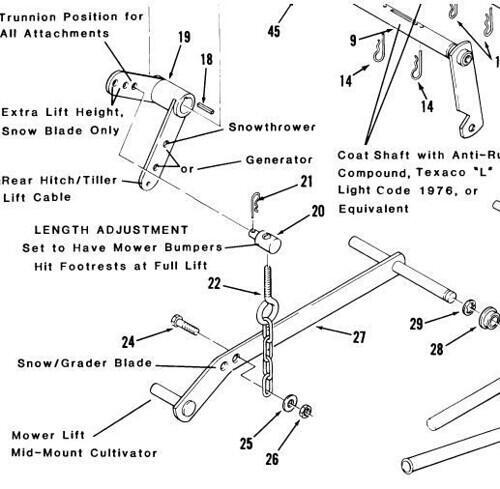

Bill Winn 157 #16662 Posted August 24, 2022 Hello RSC, I am tidying up the C-175 Auto at the moment as there are a good many repairs adjustments that I've let stack up and one of the issues I am trying to resolve is a lack of upward lift travel for the clevis hitch in the back. I have replace the cable, clevis, and tube and still had less lift than i felt like I should have. In the attached diagram the lift cable for the rear hitch is shown fitting in the bottom hole on the LIFT LEVER. The trunnion on my lift cable will not fit that hole. It fits in the next one up. Could that be the issue? Should I drill it out? Also should my T-Bar bottom out against the steering shaft (as it currently does). I know that's a lot for one post but I am in a writing mood I guess. Thankful for any help, Bill Share this post Link to post Share on other sites

Heatingman 977 #16665 Posted August 24, 2022 18 minutes ago, Bill Winn said: Hello RSC, I am tidying up the C-175 Auto at the moment as there are a good many repairs adjustments that I've let stack up and one of the issues I am trying to resolve is a lack of upward lift travel for the clevis hitch in the back. I have replace the cable, clevis, and tube and still had less lift than i felt like I should have. In the attached diagram the lift cable for the rear hitch is shown fitting in the bottom hole on the LIFT LEVER. The trunnion on my lift cable will not fit that hole. It fits in the next one up. Could that be the issue? Should I drill it out? Also should my T-Bar bottom out against the steering shaft (as it currently does). I know that's a lot for one post but I am in a writing mood I guess. Thankful for any help, Bill its shown to fit just above the bottom hole. Bottom hole labeled for snow blade linkage. Share this post Link to post Share on other sites
Bill Winn 157 #16666 Posted August 24, 2022 1 hour ago, Heatingman said: its shown to fit just above the bottom hole. Bottom hole labeled for snow blade linkage. I am referring to the bar in the diagram labeled 19. The bottom hole that shows it’s for the rear cable trunnion is too small for my cable’s trunnion. Share this post Link to post Share on other sites
Heatingman 977 #16667 Posted August 24, 2022 49 minutes ago, Bill Winn said: I am referring to the bar in the diagram labeled 19. The bottom hole that shows it’s for the rear cable trunnion is too small for my cable’s trunnion. I see it now. Yes if you use that lower hole, it should allow for more lift. 1 Share this post Link to post Share on other sites

Bill Winn 157 #16670 Posted August 24, 2022 20 hours ago, Heatingman said: Okay, update on the lift capacity. I took apart the home made mess that the PO had cobble together underneath the tractor for the lift linkage and fabbed a trunnion for the lift cable with a 1/4" pin. I decided to hunt around online after supper and discovered this diagram. Now this will make sense to those of you suggesting I not drill out the bottom hole (in part 19 of the original diagram I posted) but use a different sized pin. On my tractor lift cable assembly parts 4 and 19 had been swapped by the POe swapped. In short the lift cable had been installed backward and a trunnion with a 3/8" pin was installed so naturally it would not fit in the bottom hole of the lift linkage from the diagram I posted earlier. This is just the nature of the beast when you buy preowned equipment. Managing expectations and treating it like a game or a puzzle to solve makes it less frustrating. This community is like having access to cheat codes. LOL 2 Share this post Link to post Share on other sites
Handy Don 17,514 #16671 Posted August 24, 2022 (edited) 50 minutes ago, Bill Winn said: swapped by the POe swapped 50 minutes ago, Bill Winn said: like having access to cheat codes Go ahead and swap it back. The main reason, I've concluded, for having the clevis at the "front" is that there are tight clearances there between the rockshaft arm and the frame and the clevis fits nicely. At the "rear" there is more room so a trunnion works. Edited August 24, 2022 by Handy Don Share this post Link to post Share on other sites
Bill Winn 157 #16672 Posted August 24, 2022 (edited) 1 hour ago, Handy Don said: Go ahead and swap it back. The main reason, I've concluded, for having the clevis at the "front" is that there are tight clearances there between the rockshaft arm and the frame and the clevis fits nicely. At the "rear" there is more room so a trunnion works. Roger that. Task complete and I am happy to report that after swapping the cable (major pain in the butt) and fiddling with the other adjustments I now have 3 1/2" of upward travel on the clevis hitch (up from 1 3/4"). Oh and Pete I sprayed Red Tacky Grease on everthing... including my shirt. (gotta watch which way the can is aimed). Thanks everyone for you advice. Bill Edited August 24, 2022 by Bill Winn 1 1 2 Share this post Link to post Share on other sites
