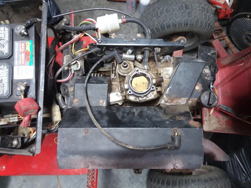

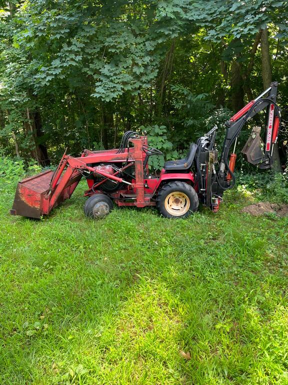

wallfish 20,645 #16512 Posted August 6, 2022 Changed the carb and cleaned her up a little. Running perfect now and even dug a little test hole. She's not pretty paint wise but she sure has big attachments. LoL 4 8 1 Share this post Link to post Share on other sites

Stormin 9,988 #16515 Posted August 8, 2022 On 8/6/2022 at 7:08 PM, wallfish said: Pardon me for asking, but how do you operate the back actor/hoe? Sit backwards on the seat? 1 Share this post Link to post Share on other sites

ebinmaine 80,808 #16518 Posted August 8, 2022 On 8/6/2022 at 2:08 PM, wallfish said: . not pretty but sure has big attachments. LoL Sounds like the kind of thing several people have said about me over the years and I don't remember any of them ever being for great reason. 😂😂😂 Nothing wrong with that beautiful machine being in its work clothes John. That's quite a piece. Share this post Link to post Share on other sites

wallfish 20,645 #16520 Posted August 8, 2022 2 hours ago, Stormin said: Pardon me for asking, but how do you operate the back actor/hoe? Sit backwards on the seat? The seat flips up on to the steering wheel and then sit on the back of it. I made the controls adjustable so they can be pulled back towards the operator to a comfortable position. It's not that bad as far as comfort goes. It doesn't take very long to dig and move on so you're not on there very long anyway. There were some videos from the Big Show parade of it being demonstrated, I'll post a link if I can find one 3 1 Share this post Link to post Share on other sites

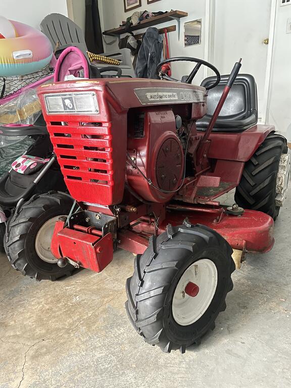

BrianKoch 370 #16522 Posted August 8, 2022 Installed the Deestone D407 16X6.50-8 63A3 4 Ply AS A/S All Season Tires! 4 4 Share this post Link to post Share on other sites
ebinmaine 80,808 #16523 Posted August 8, 2022 18 minutes ago, BrianKoch said: Installed the Deestone D407 16X6.50-8 63A3 4 Ply AS A/S All Season Tires! I've used AG tires on the front of the C160 that holds the Mackissic chipper which is VERY heavy. I've tried them both forward (as you have them) and reversed. They DEFINITELY worked better for steering when reversed. The "dig in" is much much better. 4 Share this post Link to post Share on other sites

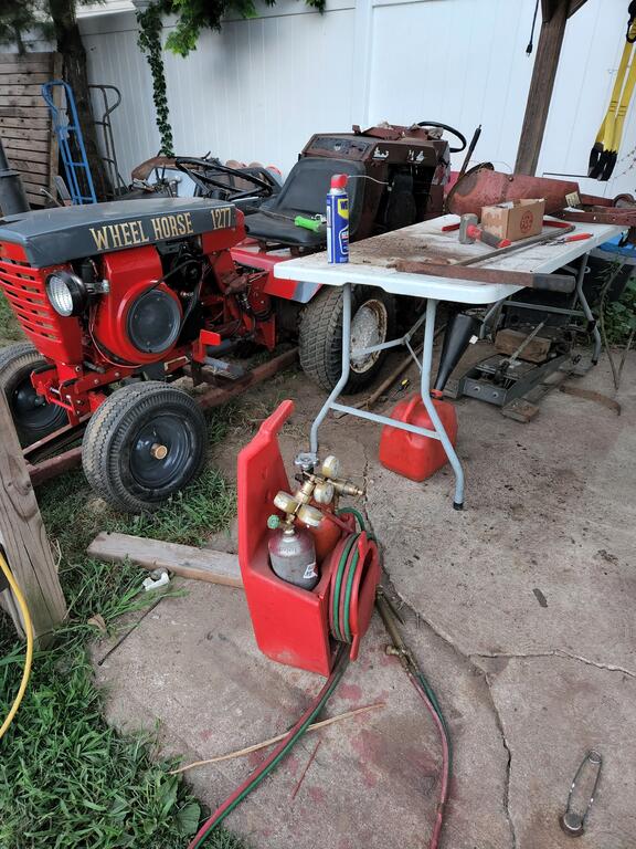

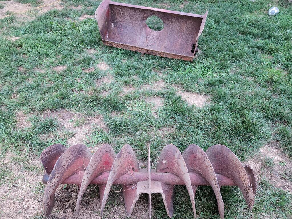

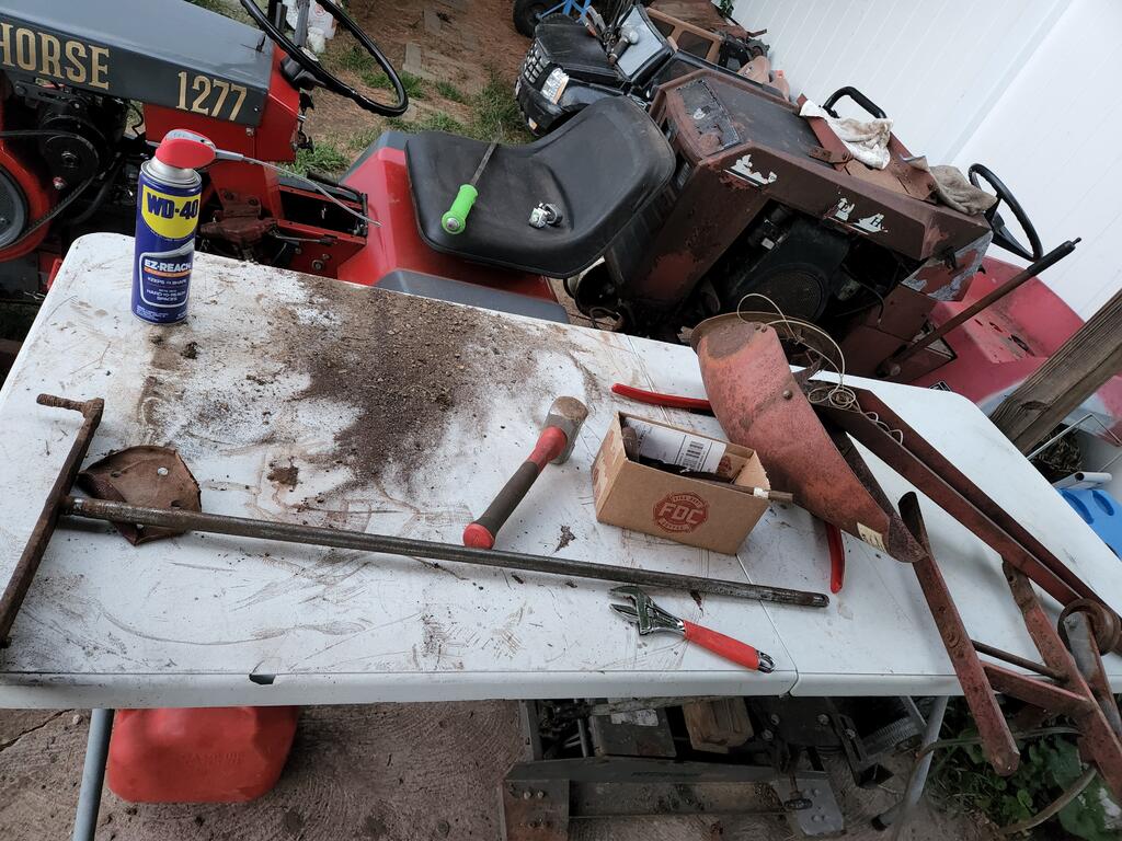

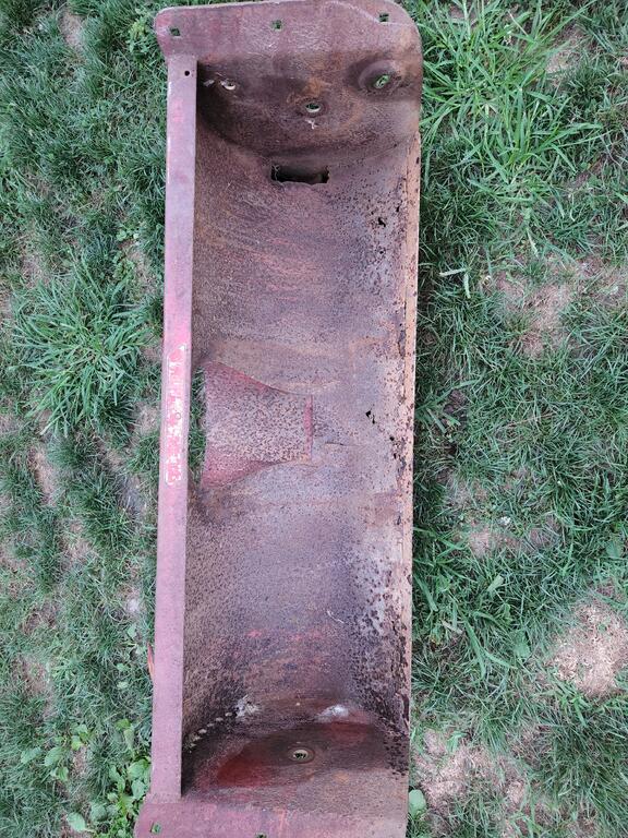

Monstrosity 1,153 #16525 Posted August 9, 2022 (edited) So I finally got to the throwher tonight.. It did not want to come apart I asked politely but I was done asking and brought out the smoke wrench. Needs bearings obviously and needs some patch work. Thinking about dropping the hopper at the local metal shop and having them cut out and back half it with the next gauge thicker steel add some weight to it!! 💪💪 Edited August 9, 2022 by Monstrosity 2 Share this post Link to post Share on other sites
