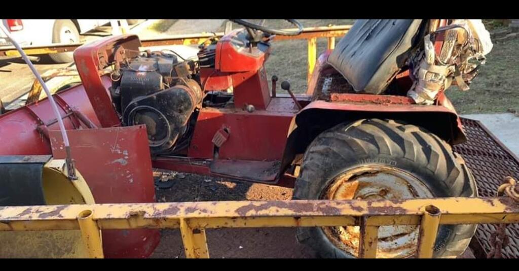

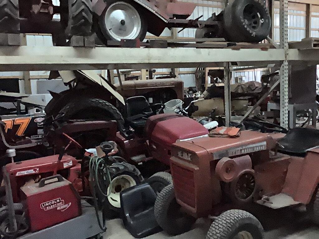

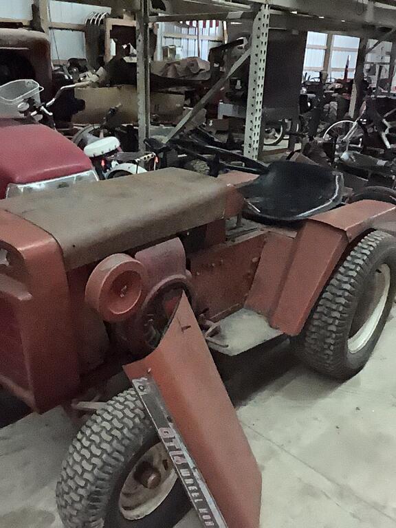

ebinmaine 80,808 #16426 Posted August 1, 2022 7 hours ago, Monstrosity said: Would anyone know what series tractor this is? Trying to find info going to look at this possibly Thursday. It has a pull off hood I thought GT14 but it has a manual not a Hydro it seams. 6 hours ago, 8ntruck said: it looks like a 953 or a 1054. Should be a 3 speed manual with a 9 or 10 horse engine. Agreed. @953 nut could chime in here. 2 Share this post Link to post Share on other sites
953 nut 69,634 #16427 Posted August 1, 2022 9 hours ago, Monstrosity said: Would anyone know what series tractor this is? Trying to find info going to look at this possibly Thursday. It has a pull off hood I thought GT14 but it has a manual not a Hydro it seams. As others have said it would be a 953 or 1054, basically the same tractor with minor differences.. Under the steering wheel there is a sticker with a serial number that will tell you for sure. The 1054 (built in 1965) is basically a third generation 953 (built in 1963) with a slightly different seat frame. The bends on the seat frame of the 953 (all three generations) are smooth and the bends on the 1054 seat frame is dimpled at the bends. 3 1 Share this post Link to post Share on other sites

Monstrosity 1,153 #16430 Posted August 1, 2022 4 hours ago, 953 nut said: As others have said it would be a 953 or 1054, basically the same tractor with minor differences.. Under the steering wheel there is a sticker with a serial number that will tell you for sure. The 1054 (built in 1965) is basically a third generation 953 (built in 1963) with a slightly different seat frame. The bends on the seat frame of the 953 (all three generations) are smooth and the bends on the 1054 seat frame is dimpled at the bends. Thanks!! These are larger than the other series correct? And can handle bigger implements? 1 Share this post Link to post Share on other sites
Pullstart 71,336 #16431 Posted August 1, 2022 33 minutes ago, Monstrosity said: Thanks!! These are larger than the other series correct? And can handle bigger implements? They are a monumental pillar in Wheel Horse’s market stronghold of the day. They had a larger fuel tank, heavy cast iron grill, along with factory hydraulic lift and a manual transmission. Add that to the higher ground clearance, heavier frame, heavier front axle, heavier spindles… and they WHOOPED all over the competition! But I’m not biased… 1 3 Share this post Link to post Share on other sites
Monstrosity 1,153 #16432 Posted August 1, 2022 4 minutes ago, Pullstart said: They are a monumental pillar in Wheel Horse’s market stronghold of the day. They had a larger fuel tank, heavy cast iron grill, along with factory hydraulic lift and a manual transmission. Add that to the higher ground clearance, heavier frame, heavier front axle, heavier spindles… and they WHOOPED all over the competition! But I’m not biased… So what your saying is part out the C125 take the 12hp engine off that and put it on the 953 to make a bit stronger???? 1 1 Share this post Link to post Share on other sites

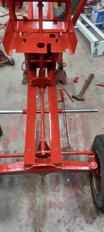

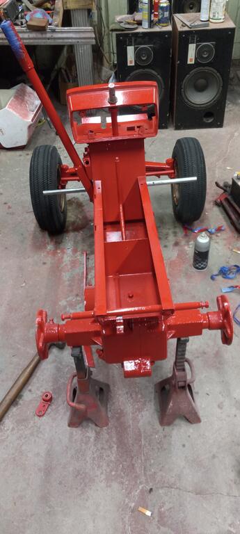

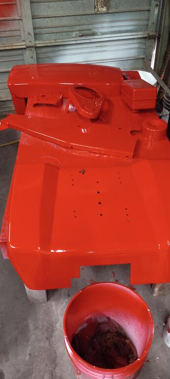

Amt73 25 #16433 Posted August 1, 2022 Started putting my 857 back together after paint job 1 8 1 Share this post Link to post Share on other sites
Pullstart 71,336 #16434 Posted August 1, 2022 1 hour ago, Monstrosity said: So what your saying is part out the C125 take the 12hp engine off that and put it on the 953 to make a bit stronger???? You’d be amazed at the power of that 9.6 hp (10) engine… I can pull a one bottom plow, disc, push snow, etc.. all day long and run out of traction long before power 3 1 Share this post Link to post Share on other sites
ebinmaine 80,808 #16435 Posted August 1, 2022 1 hour ago, Monstrosity said: So what your saying is part out the C125 take the 12hp engine off that and put it on the 953 to make a bit stronger???? 5 minutes ago, Pullstart said: You’d be amazed at the power of that 9.6 hp (10) engine… I can pull a one bottom plow, disc, push snow, etc.. all day long and run out of traction long before power I'd agree with that. I would go so far as to say that on a manual transmission tractor ... unless you were going to rototill tough ground or cut tall grass it's legitimately possible you'd never see the difference between a 10 and a 12. Trina's go to horse is an 8 67. 8 HP Kohler. I've seen her spin the tires more times than I can possibly count but I've never ever ever seen her run out of power while grading the driveway, plowing snow, single tooth ripping, pulling heavy stuff. 4 Share this post Link to post Share on other sites

squonk 48,180 #16437 Posted August 1, 2022 4 hours ago, Monstrosity said: So what your saying is part out the C125 take the 12hp engine off that and put it on the 953 to make a bit stronger???? Just put a .020" over 14 HP in my 953 3 5 1 Share this post Link to post Share on other sites

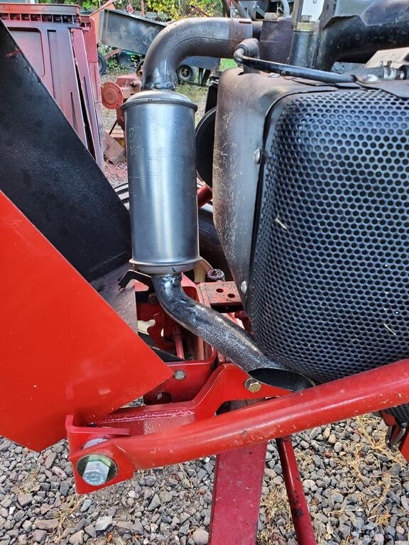

Thor27 892 #16442 Posted August 3, 2022 (edited) On 8/1/2022 at 1:43 PM, 8ntruck said: Tinkered a little with Clyde the C-195 today. Measured the muffler up to see what I can find that is close enough for a replacement. It is a straight through muffler with 90 degree elbows welded on for intake and exhaust. I figure field fitting a 'standard' muffler to the tractor will be the easiest way to go. Might as well ask here - anybody know if the mufflers for the KT 16 and KT 17 engines that Wheel Horse used in other models will fit the KT 19? This isn't a Super C, but I used the exhaust from one I found on the big auction site. I made a copy from a smaller NOS nelson and the cut off ends from a rusty wheel horse nelson for another project. The manifold from a c175 and a 195 are the same part number, but the 175 muffler is smaller. Yes the exhaust from a 417 or a 418 will fit. Pay no attention to the streak on the hood, that was from some other magnum muffler that was similar to, but didn't have as much of a curve in the exit as the 418 shown. Edited August 3, 2022 by Thor27 Add pics from phone 3 1 Share this post Link to post Share on other sites
8ntruck 9,315 #16443 Posted August 3, 2022 @Thor27 - thanks for the information. It gives me another avenue to search. Share this post Link to post Share on other sites

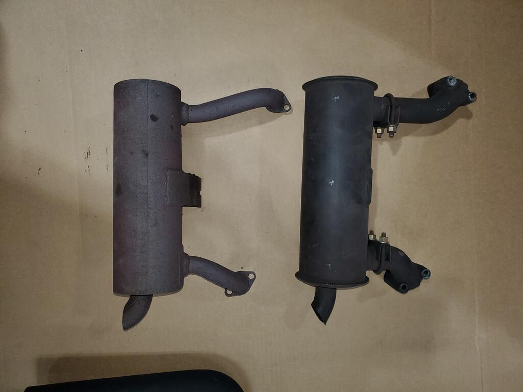

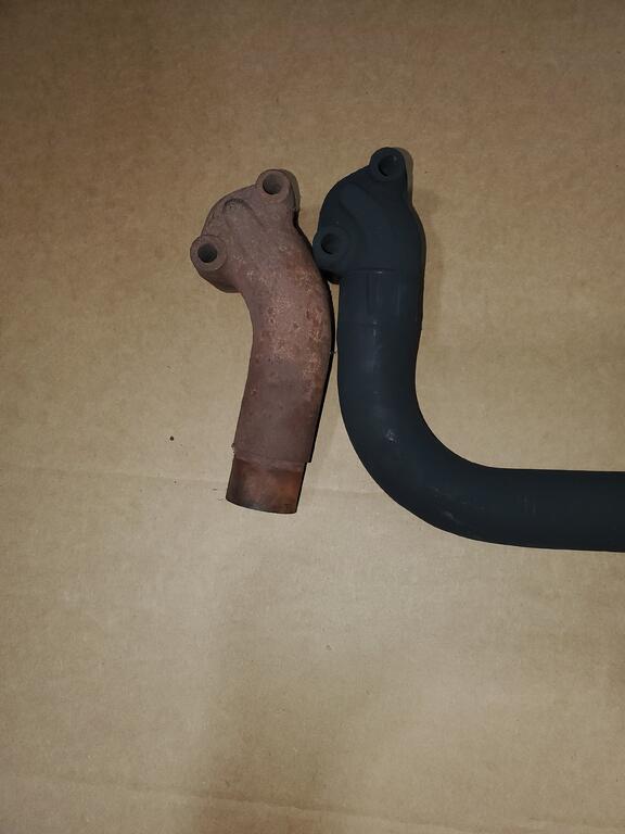

Thor27 892 #16444 Posted August 3, 2022 (edited) @8ntruck One other thing to be aware of, found out the hard way that there are 2 styles of the cast iron manifolds, so If you go to a different style muffler, make sure to get them too. I don't know if the change was at the break from the KT to the magnum or not. Here is a 418 muffler ans a similar of unknown origin (painted). The unknown streaked the paint, the 418 doesn't. Edited August 3, 2022 by Thor27 Add pics from phone 1 1 Share this post Link to post Share on other sites

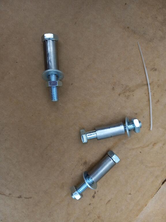

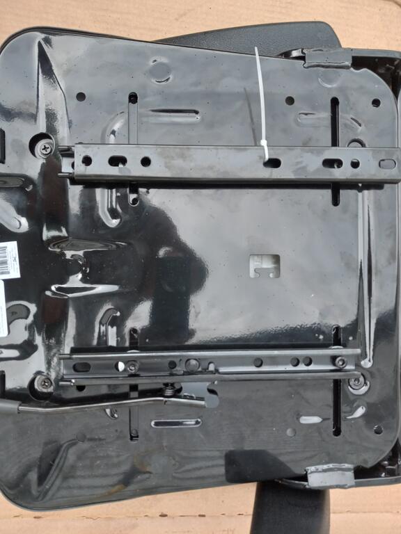

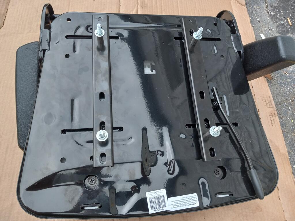

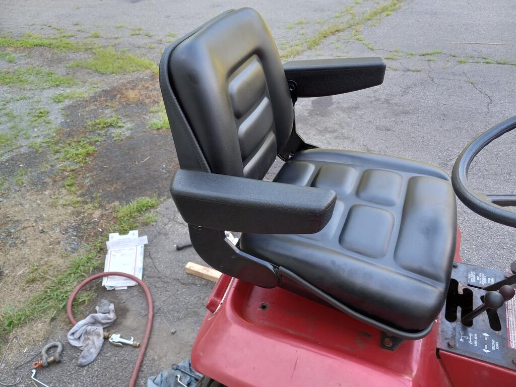

Panther416-8 342 #16445 Posted August 3, 2022 Put on a Bllack Talon seat from Northern Tool. Model 355000BK. Fairly easy install. First adjusted tracks on new seat so they were 7.5" apart CTC to match the original flip bracket. Used 5/16" coarse thread x 2" bolts with 1" space sleeves, 1/4" flat washers and the thinner type of hex nut. Slid the tracks off the new seat and installed the bolts through from the inside of the sliding tracks ( technically downward once seat is installed) and then added the sleeve, washer and nut on the other side of the track pieces. The tracks were slid back on the seat and then these "studs" that were created this way then went through the slots in the factory flip mount. I used the set of round holes on the tracks that were 8 inches CTC. 7 7 Share this post Link to post Share on other sites

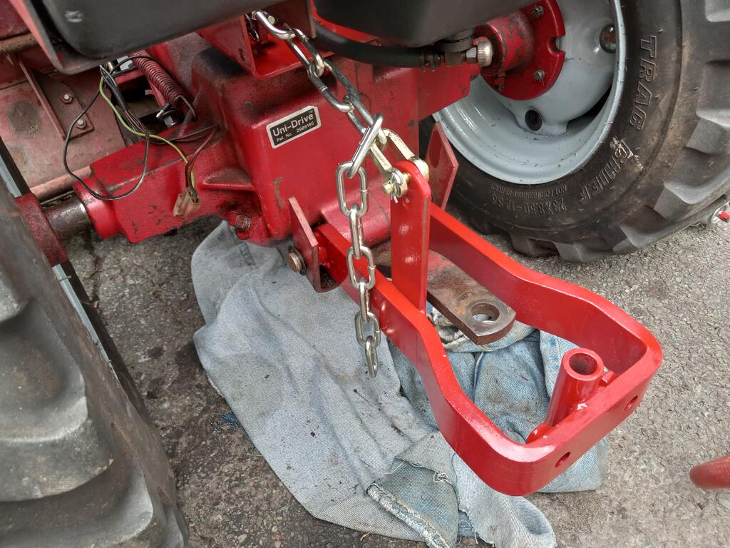

Panther416-8 342 #16446 Posted August 3, 2022 Also put on a new clevis hitch and rock shaft kit to be ready for field plowing in the fall. 8 3 Share this post Link to post Share on other sites
