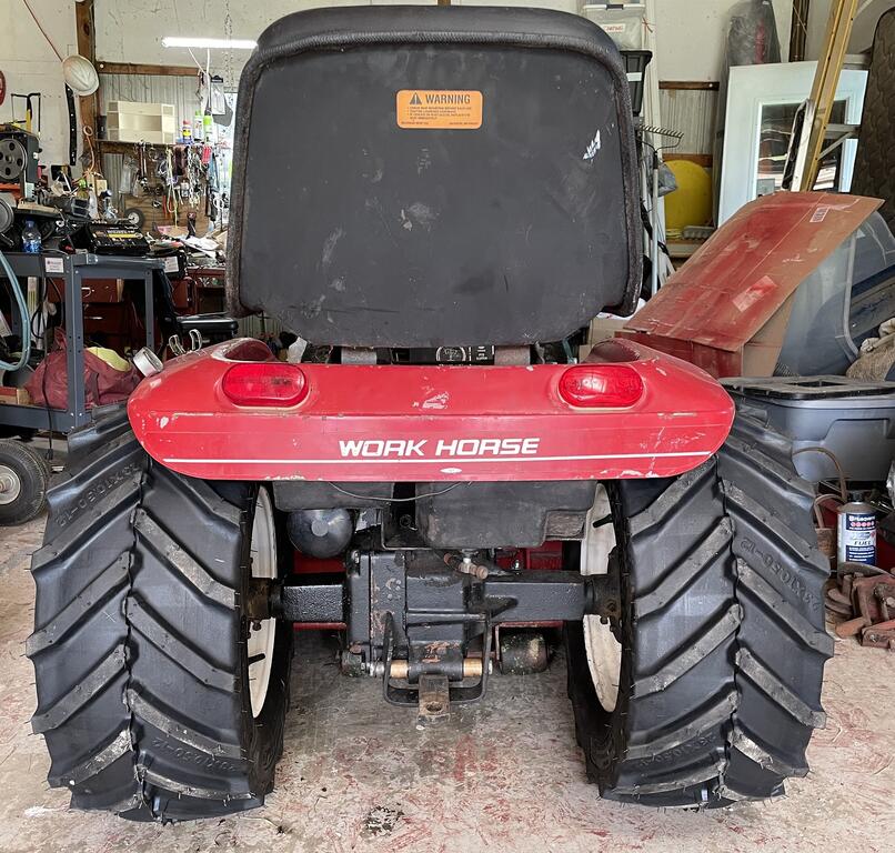

davem1111 2,381 #16351 Posted July 29, 2022 (edited) Got the new Carlisle Ags mounted up and put on the GT-1848: Oh yeah, and while I was at it I got some 7/16" 20 1-1/2" bolts, and nuts. Put 2 on each side, threaded through from the inside of the hub to act as studs. Made putting the wheels on much easier! Tapered the nuts on the bench grinder. Edited July 29, 2022 by davem1111 5 13 Share this post Link to post Share on other sites

Evguy 567 #16357 Posted July 29, 2022 2 hours ago, davem1111 said: Got the new Carlisle Ags mounted up and put on the GT-1848: Are they a lot taller than stock? 1 Share this post Link to post Share on other sites
Wheelhorse#1 1,997 #16358 Posted July 29, 2022 Looks great. I have a set of those ,Carlisle True Power.Did you mount them by hand? I did, not fun.Ill pay someone next time.. 1 1 Share this post Link to post Share on other sites
ebinmaine 80,808 #16359 Posted July 29, 2022 22 minutes ago, Evguy said: Are they a lot taller than stock? I have a set of Carlisle Trupower 23s. They're at just 23. That's about ½" taller than the stock turfs I removed. 2 1 Share this post Link to post Share on other sites
ebinmaine 80,808 #16360 Posted July 29, 2022 8 minutes ago, Wheelhorse#1 said: Looks great. I have a set of those ,Carlisle True Power.Did you mount them by hand? I did, not fun.Ill pay someone next time.. I paid. 4 1 Share this post Link to post Share on other sites
davem1111 2,381 #16361 Posted July 29, 2022 7 minutes ago, Wheelhorse#1 said: Looks great. I have a set of those ,Carlisle True Power.Did you mount them by hand? I did, not fun.Ill pay someone next time.. I got a cheap tire machine from HF and got the old ones off, but putting the new ones on was generating a lot of four-letter words, so I took them to Belle Tire and they mounted them for $10 each. Can't complain about that. 5 1 Share this post Link to post Share on other sites
davem1111 2,381 #16362 Posted July 29, 2022 24 minutes ago, Evguy said: Are they a lot taller than stock? I'm not sure - I don't think this tractor had stock on it to start with. They were 23x10.50 turfs, and it sits just about the same. I'd say within 1/2", like @ebinmaine said. The turfs are on my 312-A now, and I can no longer use the 42" deck on it. But that deck will now go on the 416-8 with 9.50's. I hope. Haven't tried yet. 2 Share this post Link to post Share on other sites
Lee1977 7,786 #16363 Posted July 30, 2022 I would be supprized if they made any tires taller as smaller seams to be the way they go. My 520 -H had 7" rims and 23 x 950 x 12 tirfs .I went with 24 x 950 x 12 Tirf Masters and 18 x 650 x 8 Tirf Masters on the front. They are all shorter then the listed height. 1 1 Share this post Link to post Share on other sites

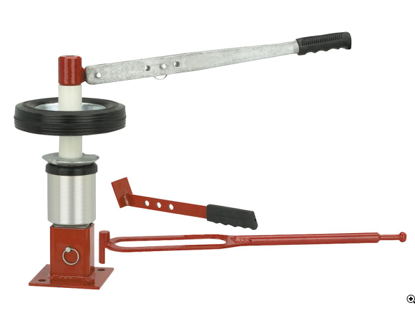

ineedanother 2,872 #16364 Posted July 30, 2022 3 hours ago, davem1111 said: I got a cheap tire machine from HF and got the old ones off, but putting the new ones on was generating a lot of four-letter words... Kinda like this one @davem1111? If you don't bolt that sucker down real good and have a brush and a bowl of dawn for the bead you might oughta just tell the kids to go in the house until you're done...that being said, mine does well enough to tolerate it and keep it around. 5 Share this post Link to post Share on other sites

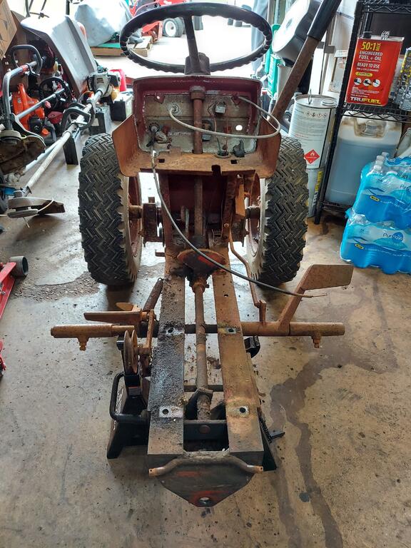

josephbruce11212@gmail.co 262 #16369 Posted July 30, 2022 (edited) The process continues!! Edited July 30, 2022 by josephbruce11212@gmail.co 6 1 Share this post Link to post Share on other sites

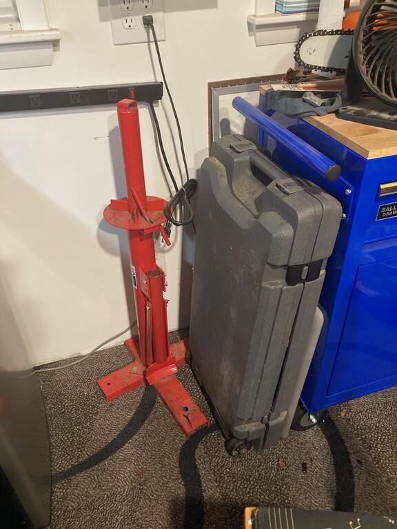

davem1111 2,381 #16372 Posted July 30, 2022 10 hours ago, ineedanother said: Kinda like this one @davem1111? If you don't bolt that sucker down real good and have a brush and a bowl of dawn for the bead you might oughta just tell the kids to go in the house until you're done...that being said, mine does well enough to tolerate it and keep it around. No, I should have bought that one but I was on a road trip at the time and the car was too full already. The one I got looks like this: It's supposed to go up to 12" rims but I think only for light-duty stuff. The beads on these Carlisles did not want to cooperate. If I had more good tire spoons and about 4 more arms, it may have worked. I may box this one back up and exchange it. I bolted mine to my workbench, which was a bit of a pain because I had to stand on a stool to get leverage at times. I have a concrete slab floor so I think I may get the bigger machine and put anchors in the floor. 21 minutes ago, Rob J. said: On the tire changers, stayed tuned. I have another idea for combining both so you can use the little guy on top of the big guy that’s bolts to the floor. Simple idea that raises the little guy off the ground or too high on a work bench. Can't wait to hear about it! 4 Share this post Link to post Share on other sites
