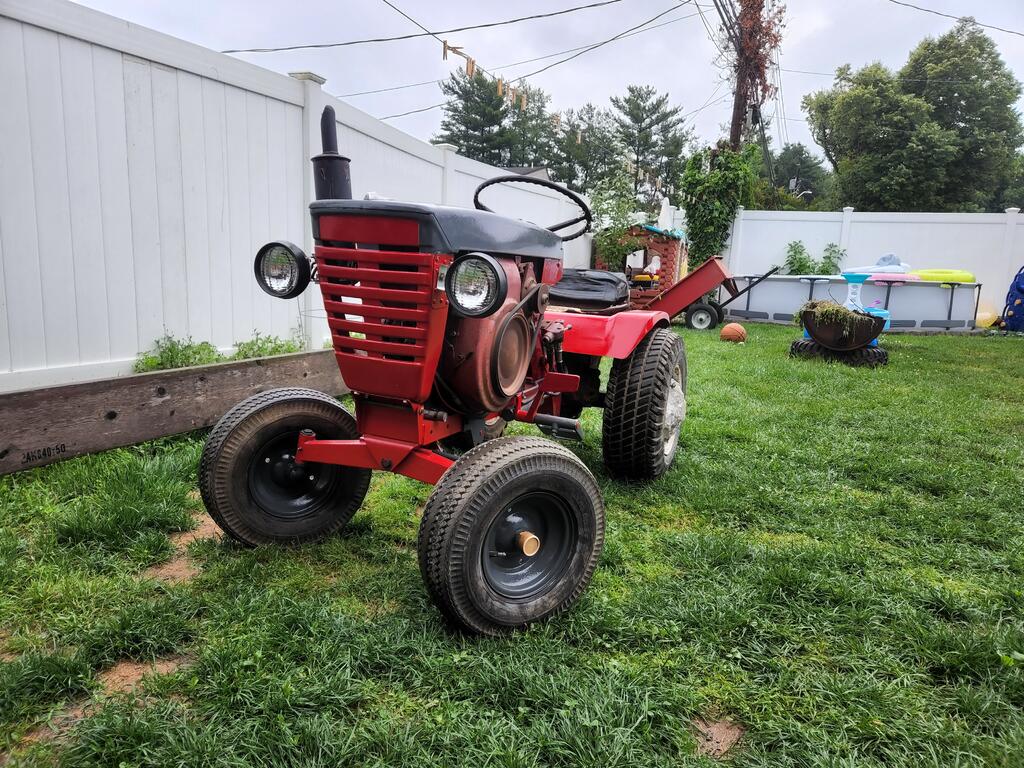

Monstrosity 1,153 #16127 Posted June 27, 2022 And the lights came in!!! And painted the front wheels 4 4 Share this post Link to post Share on other sites

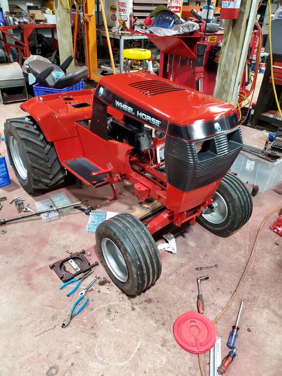

Thor27 892 #16128 Posted June 28, 2022 (edited) Tossing together my new mowing tractor. Was a 418-8 but is going forward with either a M12 or a briggs i/c 18, haven't decided. Should have painted it silver, would be an easier choice then. Edited June 28, 2022 by Thor27 7 6 Share this post Link to post Share on other sites

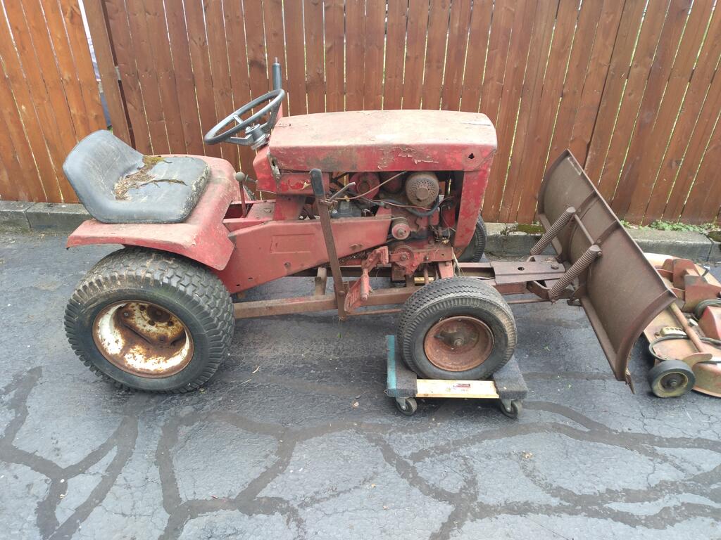

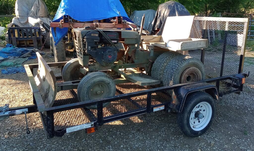

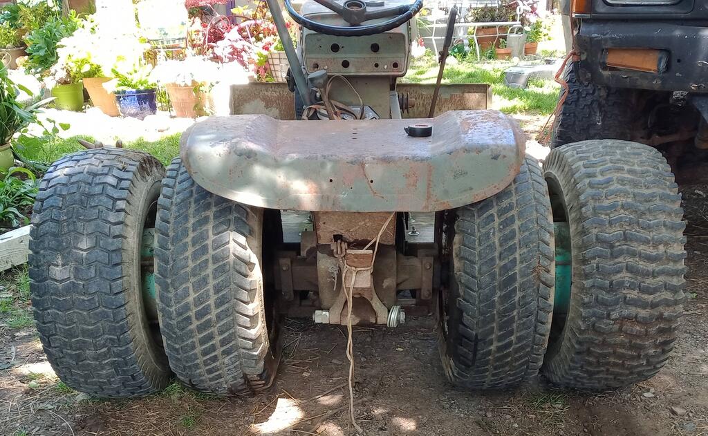

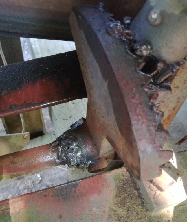

nyquil junkie 333 #16132 Posted June 28, 2022 It was time to drag one home and do some fixing and maintenance. On draining the gearbox, I discovered that for an unknown number of years, it has been lubricated by a quart of water and a tablespoon of oil. I really should have changed it after it was under water in that flood way back when. Oh well no harm done, right? Then I found the cause of all the slop in the steering, a good spot weld will fix that because, who needs a new bolt thats gonna wear out again? Then, all the tires got a dose of flat-out tire sealer, because they were all flat and don't hold air for long. Then, that right back tire setup that is 1-1/2 wider at the spacer than the right had to be corrected. Yes green sewer pipe and carriage bolts, works well enough. They havent slipped or twisted yet so.... there ya go. I had to trim a good bit off the left pipe. Now they are more evenly space. And since that custom made fancy wooden workbench seat was broken when I ran into it with a backhoe, I just dug the old pan out and put it back on. Ill stick a nice pad on there for my butt....or maybe not. Also the engine was surging, so I put a new honda carb I had here for... some reason, on it. It still surged and hunted. So I took the plastic jet out and give it a good reaming out, which was good because honda didnt drill it out all the way to begin with. Now it runs nice and smooth, no surge no hunting and no backfiring. It needs an oil change and an air filter. It hasnt had an air filter on it for years but hey, new fancy honda carb, it really should have a proper fliter. Then it can go back out to live in the cow fields for another couple yrs. 12 Share this post Link to post Share on other sites

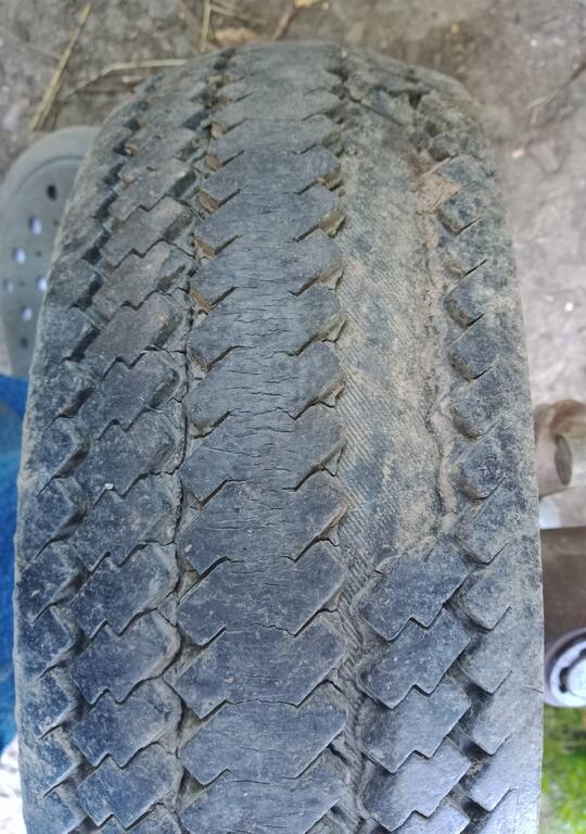

nyquil junkie 333 #16141 Posted June 29, 2022 (edited) Last few touches before I toss it off the deep end of the pool and back to work... Yes I have taken the bolt out before, the hole is egged out really bad so a new bolt wouldnt help. It just matches the other busted bits that are farmer welded back together. It'll hold. This is a real tragedy. my original issue wheelhorse front tires are starting to come apart. After only 55 years. I want my money back. Edited June 29, 2022 by nyquil junkie 6 Share this post Link to post Share on other sites
OutdoorEnvy 1,817 #16142 Posted June 29, 2022 28 minutes ago, nyquil junkie said: This is a real tragedy. my original issue wheelhorse front tires are starting to come apart. After only 55 years. I want my money back. LOL! Yeah that's how they get you! Share this post Link to post Share on other sites
Wheelhorse#1 1,997 #16143 Posted June 29, 2022 27 minutes ago, nyquil junkie said: . This is a real tragedy. my original issue wheelhorse front tires are starting to come apart. After only 55 years. I want my money back. Heck,theres still plenty rubber left Share this post Link to post Share on other sites

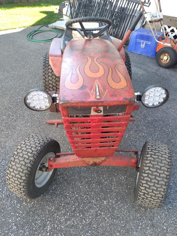

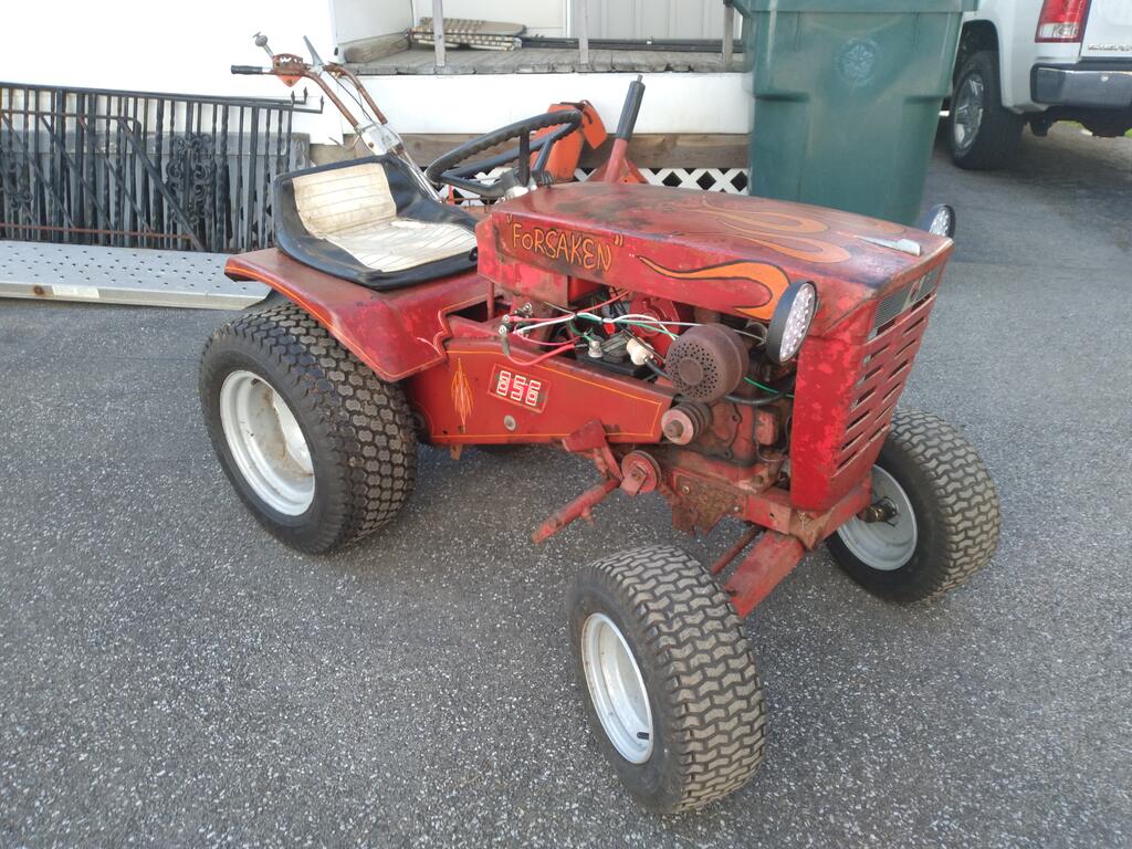

D_Mac 9,339 #16145 Posted June 30, 2022 (edited) Well " Forsaken " is running and driving. Hard to believe but it is. Crazy the engine runs as smooth as it does. This tractor was left in the woods for 20 plus years. I dragged it home for yard art and now it's back in service again. It's not finished yet but the hard stuff is done. It had to be all rewired. Also I had to put a solenoid on it as the old key switch was shot. So that's the wiring and stuff you see on the side. We also put those head lights on it to fill some holes in the hood. Is it perfect ??? Heck no. Do I have more in it then what it's worth ??? Heck yeah, but it is back from the dead. Had to change the tires and wheels as the rims were rotted away. New key switch. Had to add solenoid. Swapped out starter. All new wiring. New carburetor. New choke and throttle cables. New plug. New fuel lines, pitcock, shut off valve, fuel filter. Cleaned the tank. New air filter. New muffler. Replaced all fluids. Washed off most of the dirt and moss and weeds. Pinstripe and added flames to the tins. Added head lights. I want to look into replacing the spring on lift lever as it won't lock in place. Drive pulley is pretty squeaky. Replaced the seat. Freed up the steering as it was seized up.. It will get there. Edited June 30, 2022 by D_Mac 7 5 Share this post Link to post Share on other sites
