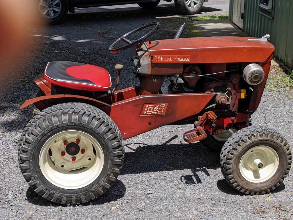

josephvigg 88 #16051 Posted June 15, 2022 20 hours ago, rjg854 said: Painted the wheels on the 1045, waiting on a set of tie rods, to complete the punch list. The rest of the parts I need I'll pick up at the big show. wheels look great!! what paint/code did you use 1 2 Share this post Link to post Share on other sites

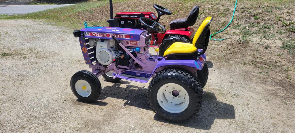

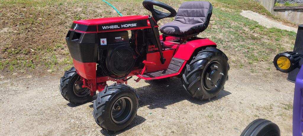

OldWorkHorse 3,156 #16054 Posted June 15, 2022 Very nice weather out today so took the 314-8 and FlowahPowah out for a good power washing and waxing. 3 7 Share this post Link to post Share on other sites
ebinmaine 81,208 #16055 Posted June 15, 2022 3 minutes ago, OldWorkHorse said: 314-8 and FlowahPowah Now ya just need a nice old C160... 1 1 Share this post Link to post Share on other sites
rjg854 13,427 #16056 Posted June 15, 2022 2 hours ago, josephvigg said: wheels look great!! what paint/code did you use Almond Rust-Oleum spray bombs. Nothing fancy. 3 Share this post Link to post Share on other sites
ebinmaine 81,208 #16057 Posted June 15, 2022 2 hours ago, josephvigg said: wheels look great!! 1 minute ago, rjg854 said: Almond Rust-Oleum spray bombs. Nothing fancy. I agree. Something about an old tractor with character and fresh wheels and seat. 1 1 Share this post Link to post Share on other sites
OldWorkHorse 3,156 #16058 Posted June 15, 2022 1 hour ago, ebinmaine said: Now ya just need a nice old C160... Workin on that lol 1 Share this post Link to post Share on other sites

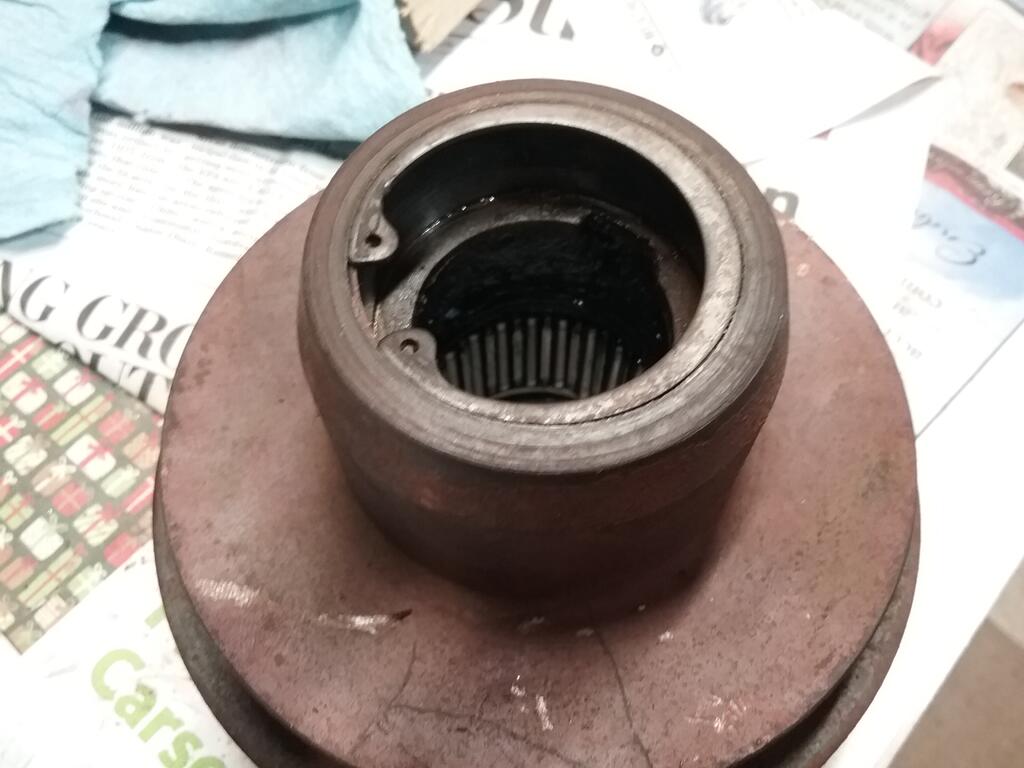

8ntruck 9,420 #16059 Posted June 15, 2022 (edited) Got Morgan the 14-8 out and pulled the paddle boat down to the lake today. Then remembered that I need to replace the tie rod that was wired together on one end. Did that with no issues. Getting ready to push Morgan back into the shed, then remembered that I needed to take Clyde the C195's PTO apart to see what I need to get it back operational. The PTO bell was bolted onto the end of the crankshaft through the stub shaft hole - weird. Found out why: The outside half of the C ring groove is worn away. Looks like I need a set of new bearings and a different PTO bell. Toro still lists these as being available - at $$$$! I got to wonder what happened to wear the outside of that outside groove off...... Edited June 15, 2022 by 8ntruck Share this post Link to post Share on other sites
ebinmaine 81,208 #16060 Posted June 15, 2022 12 minutes ago, 8ntruck said: C195's PTO apart to see what I need to get it back operational. The PTO bell Are these specific to 195s or that engine? Share this post Link to post Share on other sites
peter lena 10,118 #16061 Posted June 15, 2022 @8ntruck don't forget to use a hi temp grease in that needle bearing , lucas 560 deg . xtra hd , really helps in your spin up , pete 1 Share this post Link to post Share on other sites

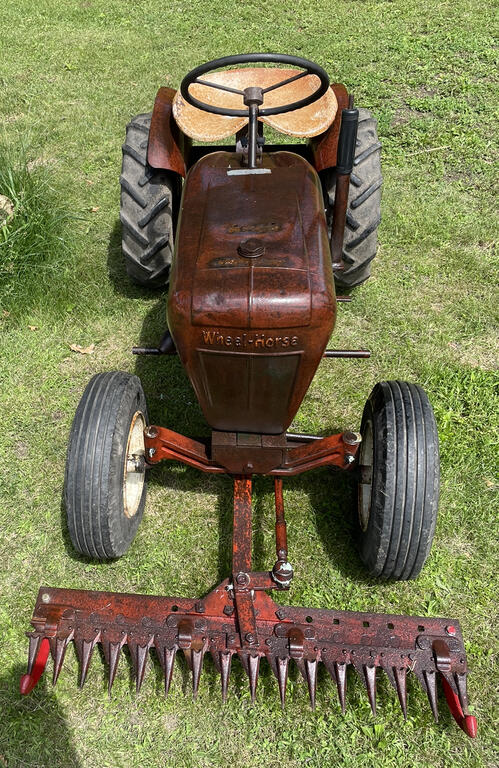

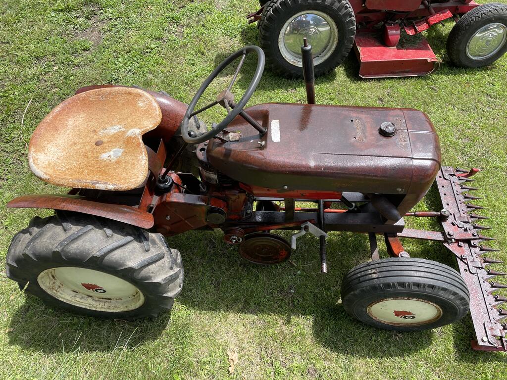

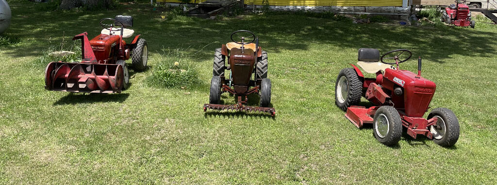

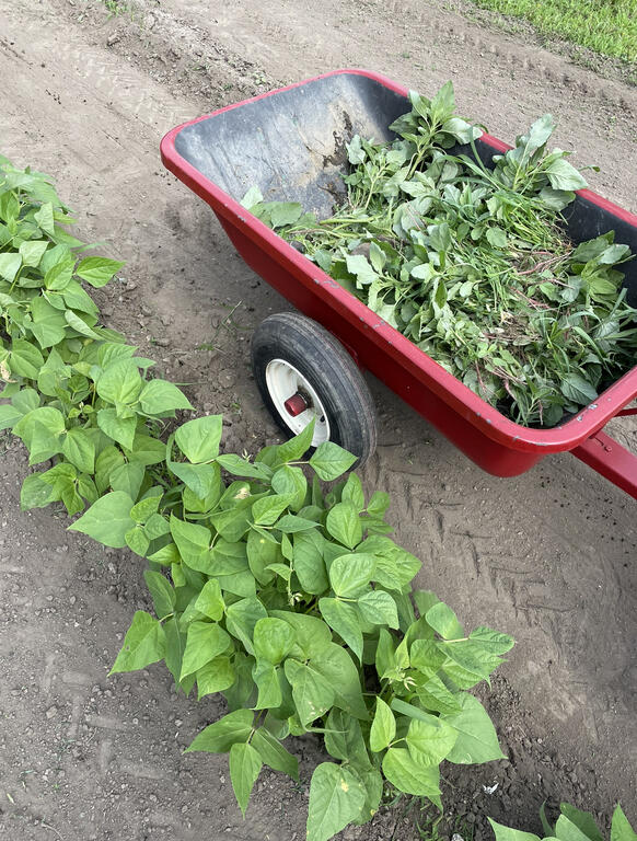

Jennifer 1,878 #16062 Posted June 16, 2022 (edited) Used it to weed the garden! Lol…. Weeds are cheap chicken feed…🤪. Sickle was put on old Rusty.. New 39” belt…. Have to get a new tension spring tomorrow… Edited June 16, 2022 by Jennifer 6 8 1 Share this post Link to post Share on other sites
Thor27 892 #16063 Posted June 16, 2022 (edited) 3 hours ago, 8ntruck said: The outside half of the C ring groove is worn away. Looks like I need a set of new bearings and a different PTO bell. Toro still lists these as being available - at $$$$! I got to wonder what happened to wear the outside of that outside groove off...... Lincoln at a-z looks like he's got the bell #109759. I've seen damage like that to a pto from using wrong pin #28. Interesting set up, I'd really like to see some pics when you are in it! Curious to see how the pulley and bell seat without a separate friction disk in the mix. what is the diameter of the crank on that beast 1-1/4"? Edited June 16, 2022 by Thor27 spellin Share this post Link to post Share on other sites
8ntruck 9,420 #16064 Posted June 16, 2022 (edited) 4 hours ago, ebinmaine said: Are these specific to 195s or that engine? As far as I can tell, it is specific to the C195. I have heard of conversions to the more common disc type PTO clutch. Have not seen any details on that, though. I also made another discovery on Clyde today. The drive belt was running inside out on the end of the PTO bell instead of in the drive pulley groove. That probably explains why the hydraulics are still being driven when the clutch is in the off position. Explains the occasional hot belt smell, too. A new drive belt goes on the 'to get' list as well. Edited June 16, 2022 by 8ntruck 1 Share this post Link to post Share on other sites
8ntruck 9,420 #16065 Posted June 16, 2022 (edited) @Thor27 the other side of the clutch is a cone shape, maybe 15 degrees off of the axis of the crankshaft. The drive pulley has a mating cone with friction material on the O. D. I'll snap some pictures when I get back here sometime around Independance Day. Not sure about the crank diameter - the drive pulley is still on the engine. Maybe we've got a KT 19 expert out there who knows? I'm going to have to take a look at the bits and pieces on the hoop to see if there are any matching wear marks. Edited June 16, 2022 by 8ntruck 1 Share this post Link to post Share on other sites
lynnmor 9,073 #16066 Posted June 16, 2022 14 hours ago, 8ntruck said: Got Morgan the 14-8 out and pulled the paddle boat down to the lake today. Then remembered that I need to replace the tie rod that was wired together on one end. Did that with no issues. Getting ready to push Morgan back into the shed, then remembered that I needed to take Clyde the C195's PTO apart to see what I need to get it back operational. The PTO bell was bolted onto the end of the crankshaft through the stub shaft hole - weird. Found out why: The outside half of the C ring groove is worn away. Looks like I need a set of new bearings and a different PTO bell. Toro still lists these as being available - at $$$$! I got to wonder what happened to wear the outside of that outside groove off...... I bought two PTO bells from A-Z Tractor, both were worn to the snap ring like in the photo. Of course he made it right and sent me good ones. I believe that people are running their tractors with parts missing or damaged and adjusting the PTO clutch linkage till the hoop is pushing the bell directly. I can see no other explanation for the wear. Share this post Link to post Share on other sites
peter lena 10,118 #16067 Posted June 16, 2022 @Jennifer is that an oil / lubricant rub down on that horse ? looks like it to me , thats part of my baseline recovery of neglected horses , pete 1 Share this post Link to post Share on other sites

Wheelhorse#1 1,998 #16069 Posted June 16, 2022 4 hours ago, peter lena said: @Jennifer is that an oil / lubricant rub down on that horse ? looks like it to me , thats part of my baseline recovery of neglected horses , pete Linseed oil,Pete ? Share this post Link to post Share on other sites

Fishroe 261 #16075 Posted June 16, 2022 17 hours ago, Jennifer said: Used it to weed the garden! Lol…. Weeds are cheap chicken feed…🤪. Sickle was put on old Rusty.. New 39” belt…. Have to get a new tension spring tomorrow… Nice looking Horses Green beans looking good, same height as mine 2 1 Share this post Link to post Share on other sites
