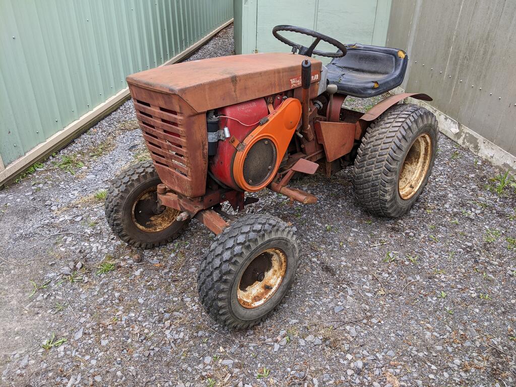

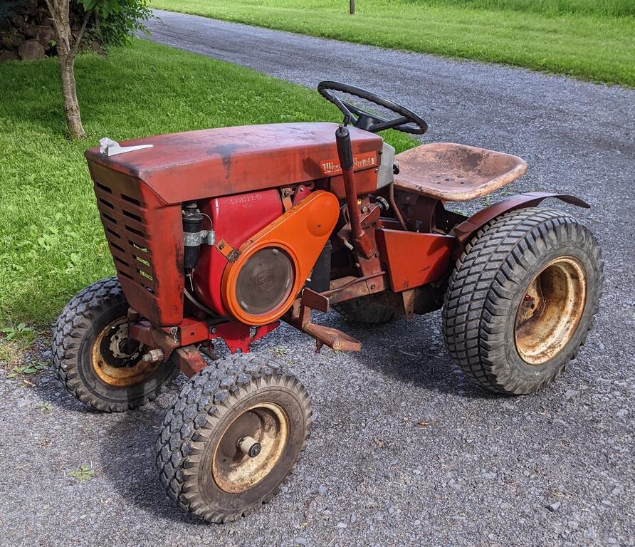

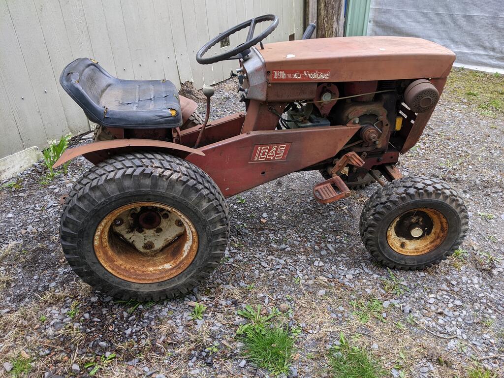

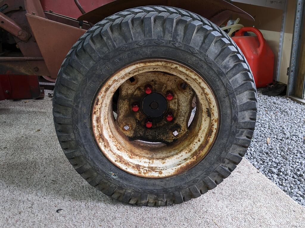

rjg854 13,391 #16005 Posted June 6, 2022 Now that my kitchen is done I can start working on the 1045 again. So today I attacked the rear hubs. The hubs were shot. The wheels were swinging back and forth on the axle but surprisingly the slot in the axle was in good shape. I had a set of hubs on the shelf so I put those on and before I did that I put studs in, so I could use lug nuts instead of just the studs like it originally came with. Obviously the tractor needs a lot of cleaning up but that will come after I work all the rest of the bugs out of it. 13 Share this post Link to post Share on other sites

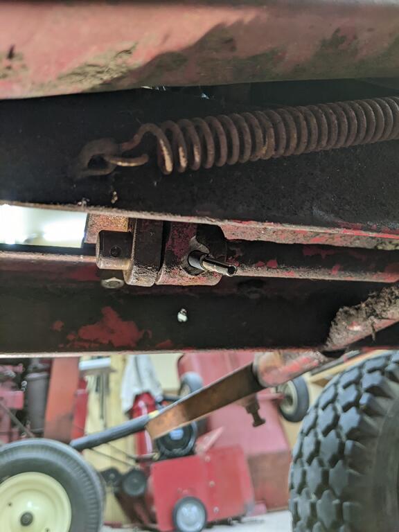

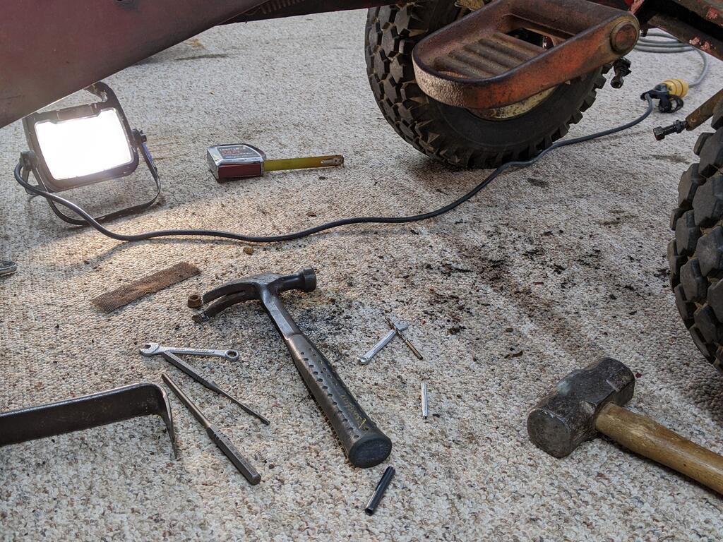

rjg854 13,391 #16007 Posted June 7, 2022 Worked on the 1045 again today. I tightened up the steering fan gear on the bar that moves the tie rods. Had to remove the the 2 roll pins and drill the holes for larger roll pins. 8 Share this post Link to post Share on other sites
Evguy 567 #16008 Posted June 8, 2022 I had tried to find replacement seat springs for the seat tray to no avail. Finding the correct spring so seat switch would work was giving me fits. I went to garage and noticed an old dead Briggs twin, I took the valve springs and retainers and bolts and viola, they worked! I just need to add some rubber bumpers, but they are what I needed. I like to recycle stuff! 2 3 Share this post Link to post Share on other sites
Handy Don 17,512 #16009 Posted June 8, 2022 14 hours ago, rjg854 said: I tightened up the steering fan gear on the bar that moves the tie rods. Had to remove the the 2 roll pins and drill the holes for larger roll pins. I had the same problem, but realized that a larger hole in the lower steering shaft would leave less metal at the point of contact. I had seen that later tractors have this joint welded so that became my inaugural use of my new welder. No wiggle. 3 Share this post Link to post Share on other sites

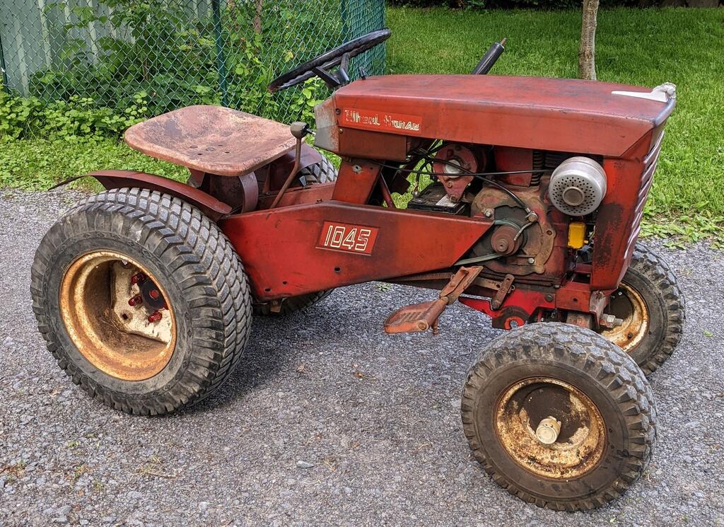

rjg854 13,391 #16010 Posted June 8, 2022 6 hours ago, Handy Don said: I had seen that later tractors have this joint welded so that became my inaugural use of my new welder. No wiggle. I considered that myself, but this is how the service bulletin suggested as the fix. Today I repaired a loose steering arm with the same process. Put a newer pepper pot muffler on and that takes care of the things that needed attention. Then gave it a MMO rubdown, really improved the appearance. I replaced the seat with the style that was originally on it. Now just have to paint the wheels. 6 7 2 Share this post Link to post Share on other sites
SylvanLakeWH 32,648 #16011 Posted June 8, 2022 @rjg854 looking good!!! 1 1 Share this post Link to post Share on other sites
squonk 48,180 #16012 Posted June 8, 2022 4 minutes ago, rjg854 said: I considered that myself, but this is how the service bulletin suggested as the fix. Today I repaired a loose steering arm with the same process. Put a newer pepper pot muffler on and that takes care of the things that needed attention. Then gave it a MMO rubdown, really improved the appearance. I replaced the seat with the style that was originally on it. Now just have to paint the wheels. Got everything good and Tight? 1 Share this post Link to post Share on other sites
rjg854 13,391 #16013 Posted June 8, 2022 I'm happy with it 1 Share this post Link to post Share on other sites

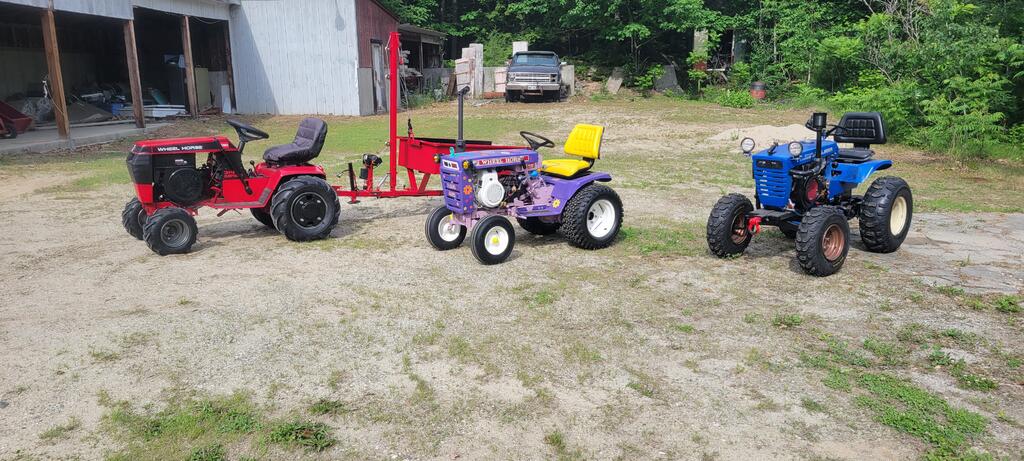

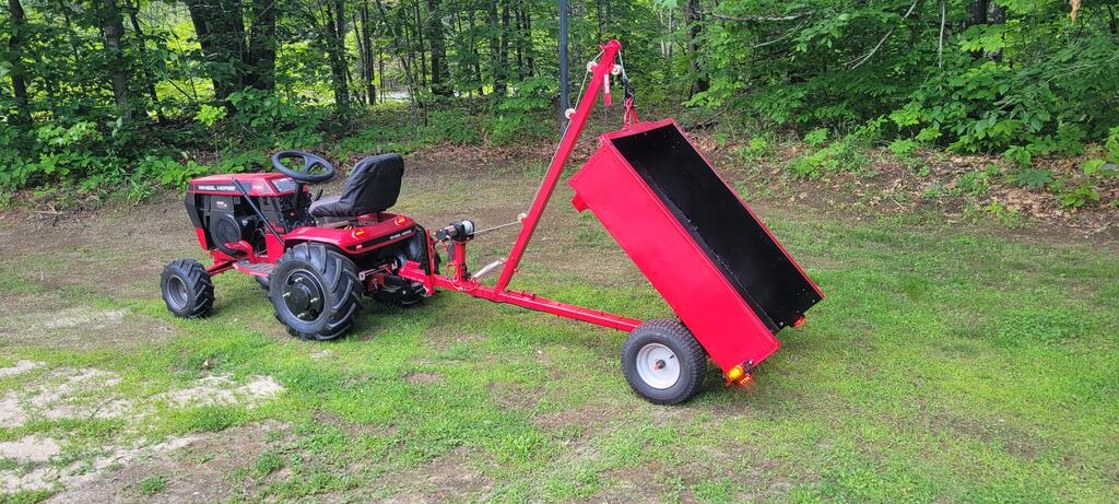

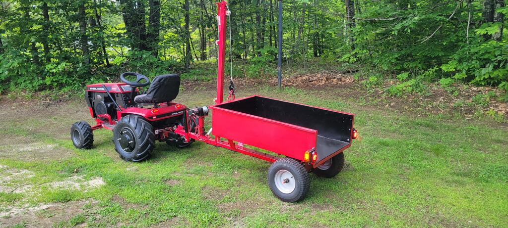

OldWorkHorse 3,156 #16014 Posted June 8, 2022 (edited) Today, I replaced the axle seal & idler pulley along with put a new drive belt on my 314-8. After that I finished up running quick disconnect battery cables to the rear hitch. Edited June 8, 2022 by OldWorkHorse 7 7 Share this post Link to post Share on other sites
ebinmaine 80,808 #16015 Posted June 8, 2022 4 minutes ago, OldWorkHorse said: drive belt How's that WHEELHORSE BRAND belt? 1 1 Share this post Link to post Share on other sites
OutdoorEnvy 1,817 #16016 Posted June 8, 2022 @OldWorkHorse That is a darn handy looking setup sir! Nice rig! 1 1 Share this post Link to post Share on other sites
OldWorkHorse 3,156 #16017 Posted June 8, 2022 35 minutes ago, OutdoorEnvy said: @OldWorkHorse That is a darn handy looking setup sir! Nice rig! Thank you! 1 Share this post Link to post Share on other sites
OldWorkHorse 3,156 #16018 Posted June 8, 2022 1 hour ago, ebinmaine said: How's that WHEELHORSE BRAND belt? It's amazing that new belt with the I forgot to mention new clutch spring I added thing grips and rips! All new horse now haha. Got to get use to it again 1 1 Share this post Link to post Share on other sites
mrc 1,119 #16019 Posted June 10, 2022 GREAT trailer oldworkhorse!!! 1 Share this post Link to post Share on other sites

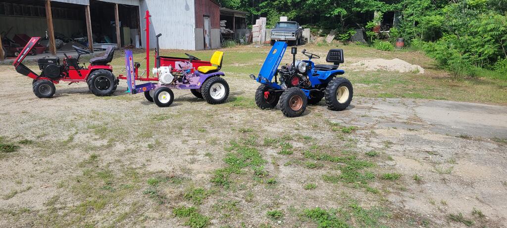

OldWorkHorse 3,156 #16020 Posted June 11, 2022 Not much pulled them out of the stables for some fresh air. 2 7 Share this post Link to post Share on other sites
ebinmaine 80,808 #16021 Posted June 11, 2022 4 minutes ago, OldWorkHorse said: Not much pulled them out of the stables for some fresh air. 4 minutes ago, OldWorkHorse said: Steve which of those run n drive? Is the 1257 going yet? Share this post Link to post Share on other sites
OldWorkHorse 3,156 #16022 Posted June 11, 2022 4 minutes ago, ebinmaine said: Steve which of those run n drive? Is the 1257 going yet? All but the 1257Heavy haha :/ soon tho! 1 Share this post Link to post Share on other sites
ebinmaine 80,808 #16023 Posted June 11, 2022 Just now, OldWorkHorse said: All but the 1257Heavy haha :/ soon tho! Toss it the trailer bub. We'll have it cookin in no time. 1 Share this post Link to post Share on other sites

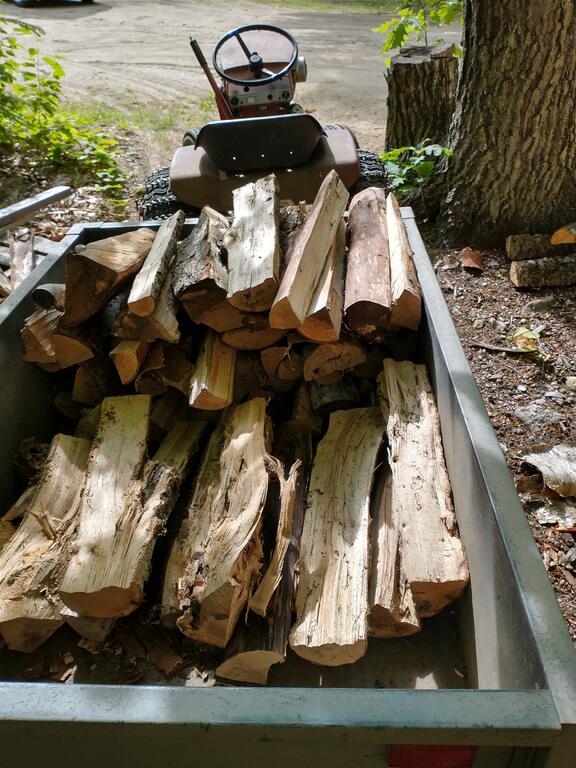

ebinmaine 80,808 #16024 Posted June 11, 2022 (edited) Excellent busy day around the EB/BBT acreage today. General yard duty stuff. Moved wood. Split wood. Chipper shredder got some activities. One of the things I've always found interesting about Trina and I is how much we think alike. Earlier today I was out in the forest and took this pic. A bit if time later she's up front by the shed and sends me this. Neither one knew the other one had done that... 🤪 Here's a few more..... And a video... Edited June 11, 2022 by ebinmaine 5 5 Share this post Link to post Share on other sites

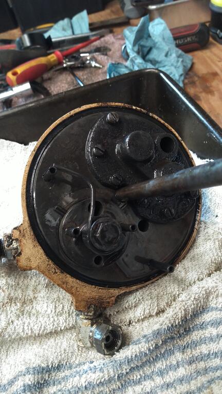

JPWH 6,544 #16025 Posted June 11, 2022 I removed the ram pac hydraulic pump and installed the rebuilt pump and changed the hydraulic cylinder out with a rebuilt one. No more leak down or hydraulic fluid leaks. It looks like the pump shaft seal was leaking on the ram pac. I opened it up and found a broken spring. 7 Share this post Link to post Share on other sites
