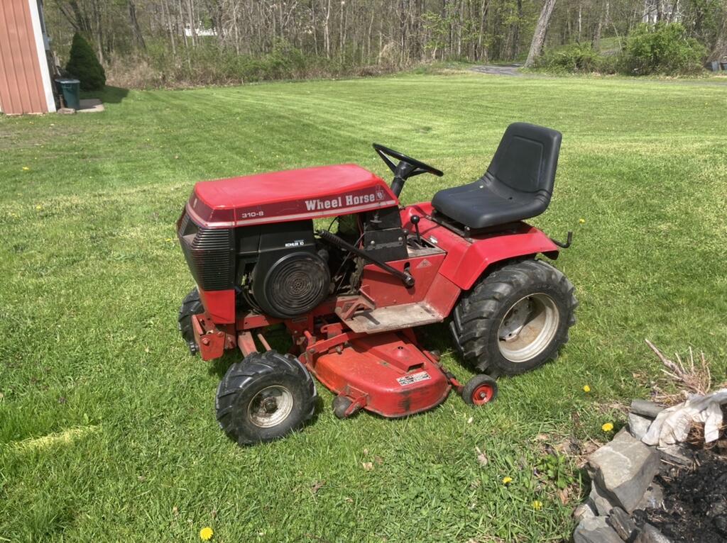

Ifixoldjunk 778 #15827 Posted May 20, 2022 Well did some more cutting with the patched deck. I think the deck itself is warped cause it leaves a odd pattern in the grass. Whatever. Doesn’t dig into the dirt. Really I’m just happy to have a usable deck for once. Hard to find any decent wheel horse stuff by me. Im thinking I’ll try to hunt down another horse sometime this summer. My collection has been knocked down quite a bit. (2 tractors) Might look for a hydro with a really nice deck, that way I’ll have a mowing horse, and a snow horse. 3 1 Share this post Link to post Share on other sites
Lee1977 7,786 #15828 Posted May 20, 2022 1 hour ago, Ifixoldjunk said: Well did some more cutting with the patched deck. I think the deck itself is warped cause it leaves a odd pattern in the grass. Whatever. Doesn’t dig into the dirt. Really I’m just happy to have a usable deck for once. Hard to find any decent wheel horse stuff by me. Im thinking I’ll try to hunt down another horse sometime this summer. My collection has been knocked down quite a bit. (2 tractors) Might look for a hydro with a really nice deck, that way I’ll have a mowing horse, and a snow horse. Check the height adjustment rod with the wheels seen those twisted causing one side to mow lower. 42" decks are bad to get cracked at the height adjustor and rust out causing that side to mow lower. the deck that came with my 520 was that way. It could be bent where the spindle is mounted. 4 Share this post Link to post Share on other sites

Ifixoldjunk 778 #15833 Posted May 20, 2022 @Lee1977 yeah that was my first thought. Unfortunately the middle spindle is visibly crooked. Share this post Link to post Share on other sites

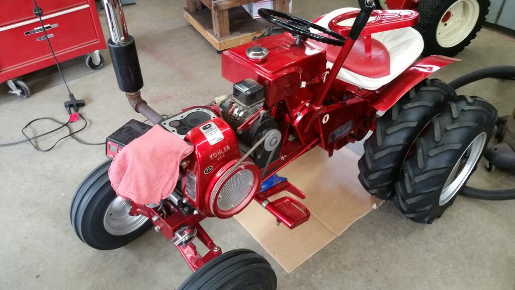

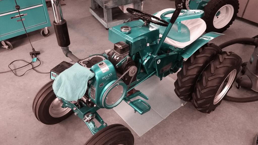

WHX?? 58,254 #15847 Posted May 22, 2022 (edited) Lots of horse stuff today.... painted The Flame... sure @Achto ain't gonna like it.... Naawww just kidding phone went screwball....head gasket was leaking. Head bolts real loose so a new gasket and inspection. Clutch was always grabby and has orginal WH rubber belt so going to try a TSC one. Replaced a roll pin in in the steering. Smoked like a bandito.... too much seafoam or stabil so fresh gas and a oil change straightened that out. Edited May 22, 2022 by WHX?? 4 4 7 Share this post Link to post Share on other sites
Achto 32,816 #15848 Posted May 22, 2022 Just now, WHX?? said: painted The Flame OMG, you need a new camera. Interesting color choice. A little head de-carbon going on??? 1 Share this post Link to post Share on other sites
WHX?? 58,254 #15849 Posted May 22, 2022 12 minutes ago, Achto said: A little head de-carbon going on??? Naw just inspection and new gasket but will do that long as I am ther. Bore looks great. 1 2 Share this post Link to post Share on other sites
