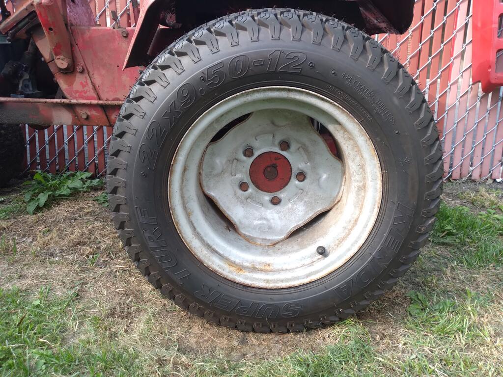

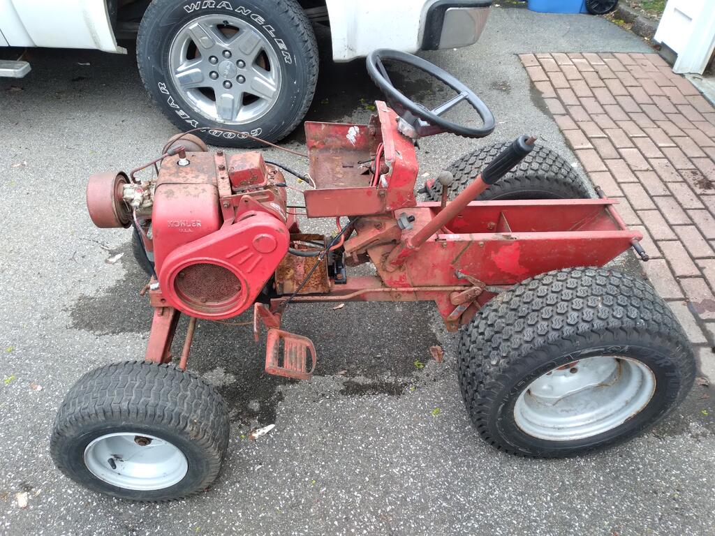

D_Mac 9,339 #15652 Posted May 8, 2022 On my 856 project when we pulled it from the weeds ,and having the wheels being half buried in dirt, the wheels disintegrated. I had to pick up a set cheap just so I could roll it around. The rims I got are silver/gray. Trying to decide if I should keep them that color, paint them original wheel horse color, or paint them black. I think painting the wheels on a tractor is the one single thing you can do to make it look 1000 times better. 9 Share this post Link to post Share on other sites

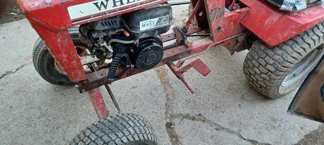

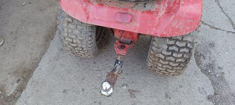

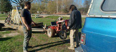

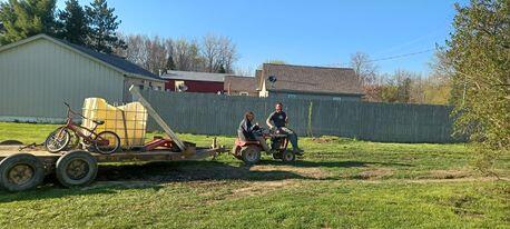

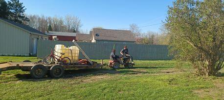

CodyP 51 #15653 Posted May 8, 2022 (edited) I added a hitch to the back and a recoil and I pulled my brother in laws tandem axle trailer with it as well I'll post the pictures as soon as my internet decides to send em Edited May 8, 2022 by CodyP picture upload 5 2 Share this post Link to post Share on other sites

ebinmaine 80,190 #15655 Posted May 8, 2022 1 hour ago, D_Mac said: Trying to decide if I should keep them that color, paint them original wheel horse color, or paint them black I'm putting in my vote for an antique white of your choice. Trina and I have had 1967 wheels off and find the Rust-Oleum 2X Navajo White is a great match. 2 1 Share this post Link to post Share on other sites

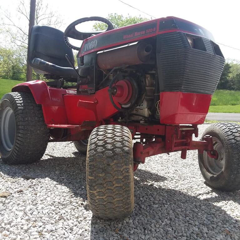

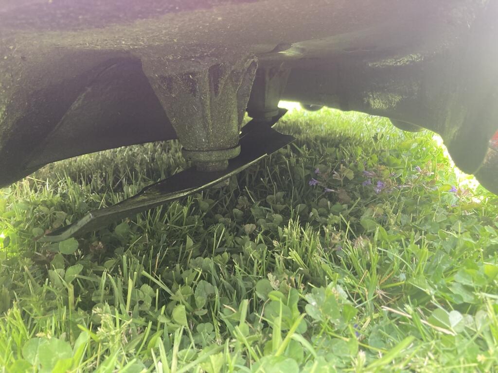

Ifixoldjunk 778 #15659 Posted May 8, 2022 Tried out my freshly patched deck today. The agricultural paint seemed to prevent grass from clumping almost entirely. I took the front AG tires off and swapped them for some original turf savers. The front AGs seemed to want to dig around turns. 4 3 Share this post Link to post Share on other sites

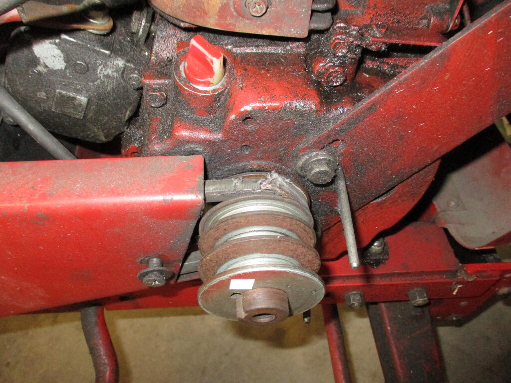

pfrederi 21,010 #15661 Posted May 8, 2022 Old reliable (L-107) had a bad day. Thought the last couple of outings she seemed to slow under load. Today she told me I am not going anywhere until you fix me.... Darn After market belt only lasted about 20 years.... 4 4 2 Share this post Link to post Share on other sites

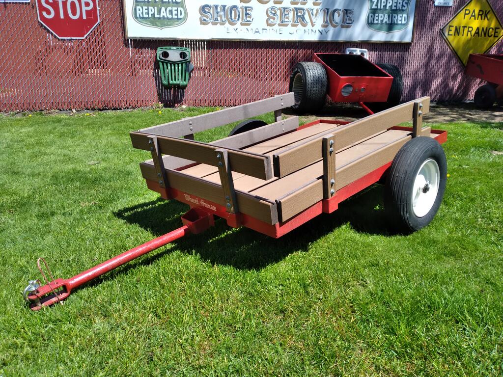

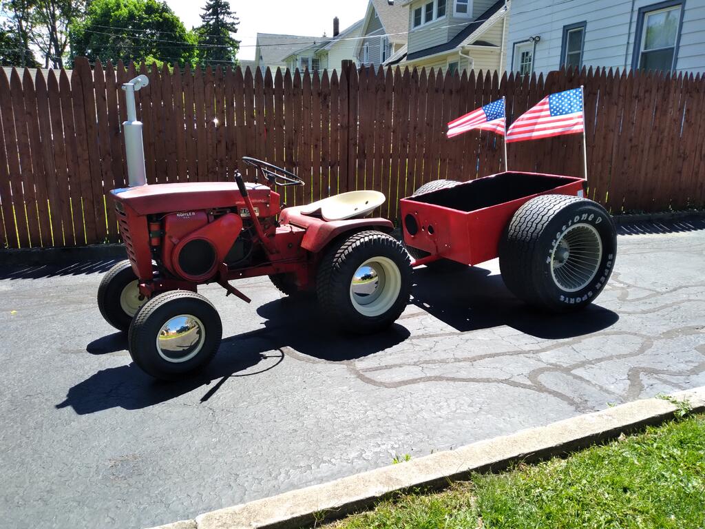

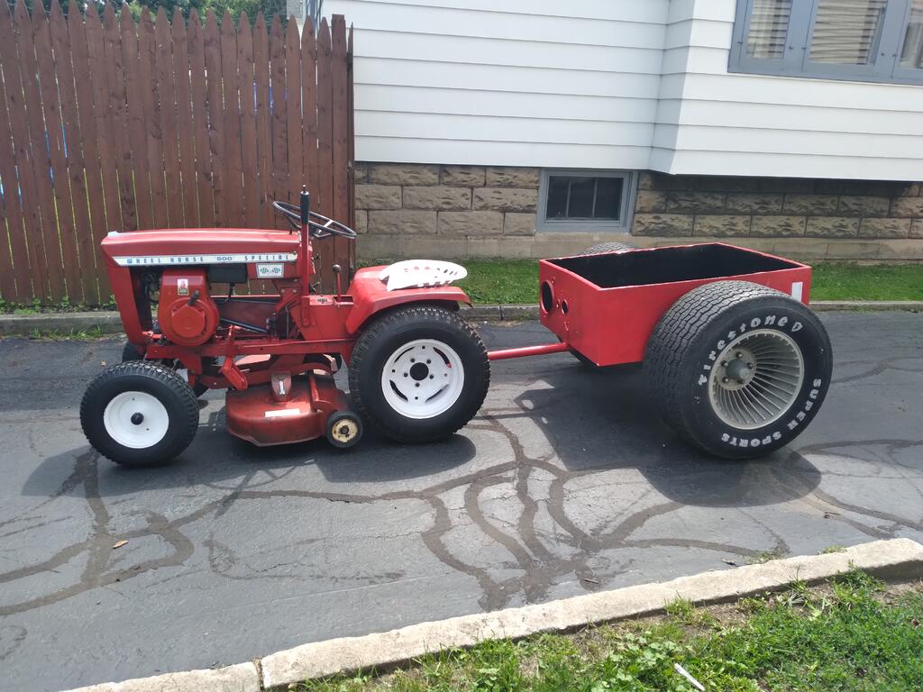

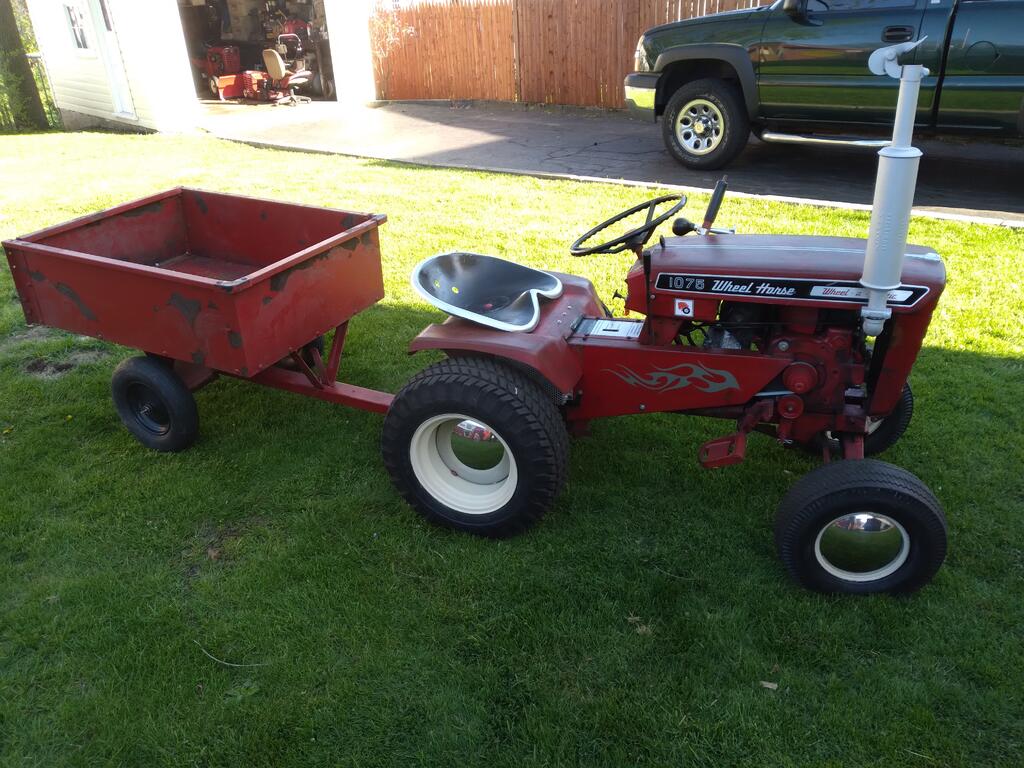

D_Mac 9,339 #15663 Posted May 8, 2022 So I got the tubes for the dump trailer I got from the junk man. Of course after I put them on I had to take it for a few laps. I switched the wheels around. Put the black ones on the dump cart and the white ones on the flat trailer. 8 1 Share this post Link to post Share on other sites
ebinmaine 80,190 #15664 Posted May 8, 2022 1 hour ago, pfrederi said: After market belt only lasted about 20 years Not tooo bad I guess. 1 Share this post Link to post Share on other sites

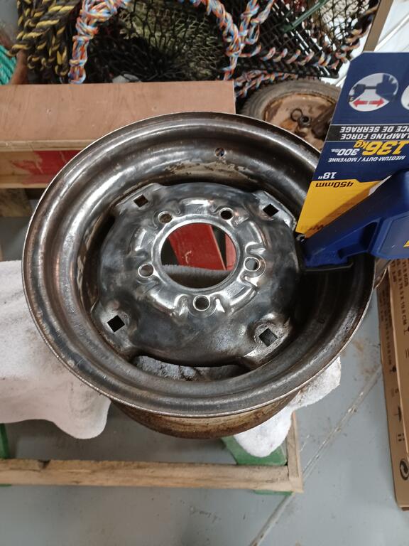

Dan.gerous 2,696 #15665 Posted May 8, 2022 (edited) Managed half an hour on one of the wheel rims before starting work this evening. Bit fiddly, but will potter away and get it all stripped. Had a poll with the family to decide on colour between white, almond or black. General consensus for this set is black. They are going on a blackhood C125 so should look fine. Edited May 8, 2022 by Dan.gerous 7 Share this post Link to post Share on other sites
mrc 1,109 #15666 Posted May 9, 2022 D-Mac, love that trailer with the fat tires and turbo wheels. looks cool! 2 Share this post Link to post Share on other sites

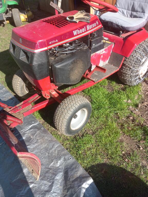

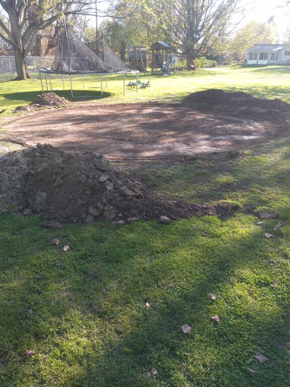

Cee245 859 #15667 Posted May 9, 2022 Used the plow on front of my 417A to help with leveling ground for a pool. Had to dig a few inches on one side. Will finish tomorrow by hand and tamp it down. 7 5 Share this post Link to post Share on other sites
D_Mac 9,339 #15668 Posted May 9, 2022 7 hours ago, mrc said: D-Mac, love that trailer with the fat tires and turbo wheels. looks cool It is very cool. 5 Share this post Link to post Share on other sites
balconio 606 #15669 Posted May 9, 2022 11 hours ago, Cee245 said: Used the plow on front of my 417A to help with leveling ground for a pool. Had to dig a few inches on one side. Will finish tomorrow by hand and tamp it down. Nice! I've done this same thing for an 18' round pool by hand and it was miserable. Can you actually dig a little or is it mostly good for just pushing loose dirt? I'm not familiar with how a plow mounts to the lift, and if you can put downpressure on the lift handle or not. 2 Share this post Link to post Share on other sites

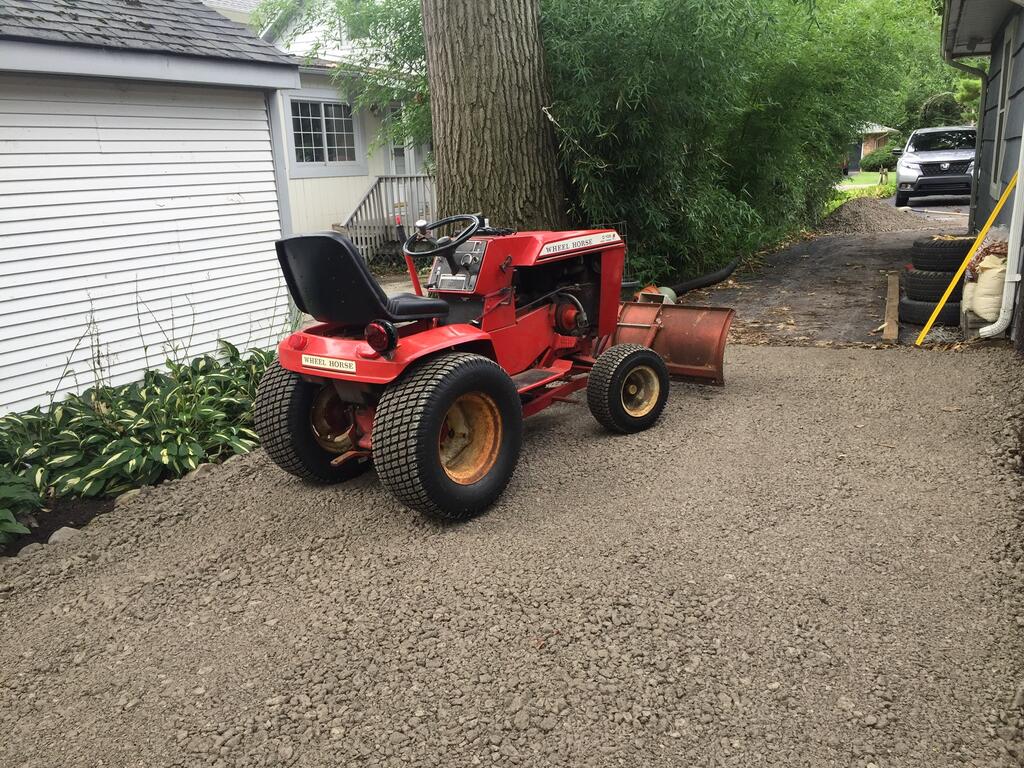

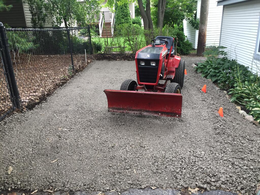

ebinmaine 80,190 #15670 Posted May 9, 2022 16 minutes ago, balconio said: Nice! I've done this same thing for an 18' round pool by hand and it was miserable. Can you actually dig a little or is it mostly good for just pushing loose dirt? I'm not familiar with how a plow mounts to the lift, and if you can put downpressure on the lift handle or not. Trina and I have plowed snow with manual transmission manual lift tractors for three or four years now and they WILL dig in to our gravel driveway a little bit even when it's frozen. Partially thawed like fall or spring and you can easily scrape off an inch or two at a time. With a properly set up Hydro tractor with Hydro lift you could easily cut into the ground some as long as it was a little loose. A mid-mount grader blade like Trina has on her 867 is invaluable for moving or spreading dirt sand gravel etc. If the surface is too stiff or rough to cut into you could buy a ripper tooth like we just did. Works excellent for cutting into the top surface of our new garden site to get the rocks and roots out. 3 Share this post Link to post Share on other sites

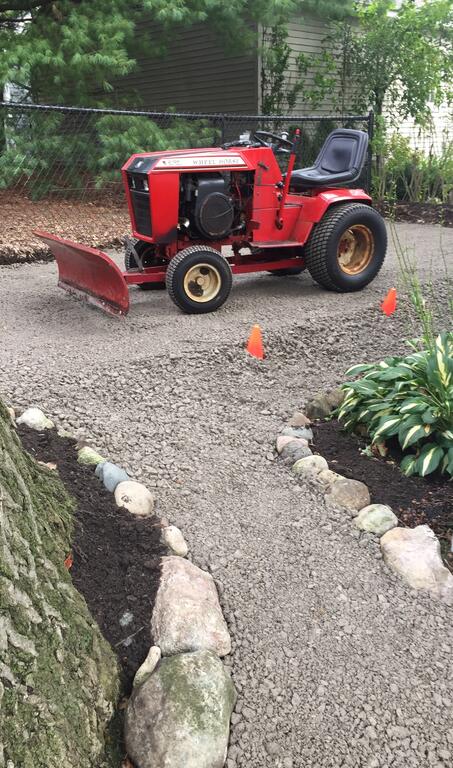

SylvanLakeWH 32,069 #15671 Posted May 9, 2022 Works good for spreading too… forward digs in…reverse back blade levels and spreads… 2 6 Share this post Link to post Share on other sites
Handy Don 17,261 #15672 Posted May 9, 2022 6 minutes ago, SylvanLakeWH said: Works good for spreading too… forward digs in…reverse back blade levels and spreads… Adjusting the pitch of the blade helps--top rearward it digs more; top forward it digs less 4 Share this post Link to post Share on other sites
Cee245 859 #15673 Posted May 9, 2022 @ebinmaine, @balconio It worked good enough, Not great, but decent. I do have a solid bar to the plow for down pressure, NOT the chain from the factory. This enables me to lift the front off the ground and dig in a little bit. I thought a mid mount grader would be good for this project, but I do not own one, yet. I was able to scrape a little at a time and got it close. According to the line level, I'm about 1" plus/minus around the area of the circle. This is good enough before I put a layer of sand down to even it out better. 4 Share this post Link to post Share on other sites
balconio 606 #15674 Posted May 9, 2022 47 minutes ago, Cee245 said: @ebinmaine, @balconio It worked good enough, Not great, but decent. I do have a solid bar to the plow for down pressure, NOT the chain from the factory. This enables me to lift the front off the ground and dig in a little bit. thanks- good to know about the solid bar... on mine the PO had the helper spring way too tight for the snowblower and i ended up having to put my foot on the lever to push it down. it's awkward but a great way to apply downpressure. i've since ditched the spring entirely. 1 Share this post Link to post Share on other sites
