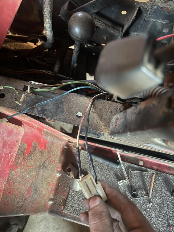

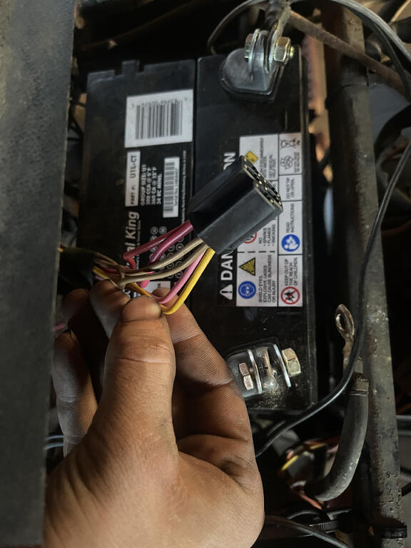

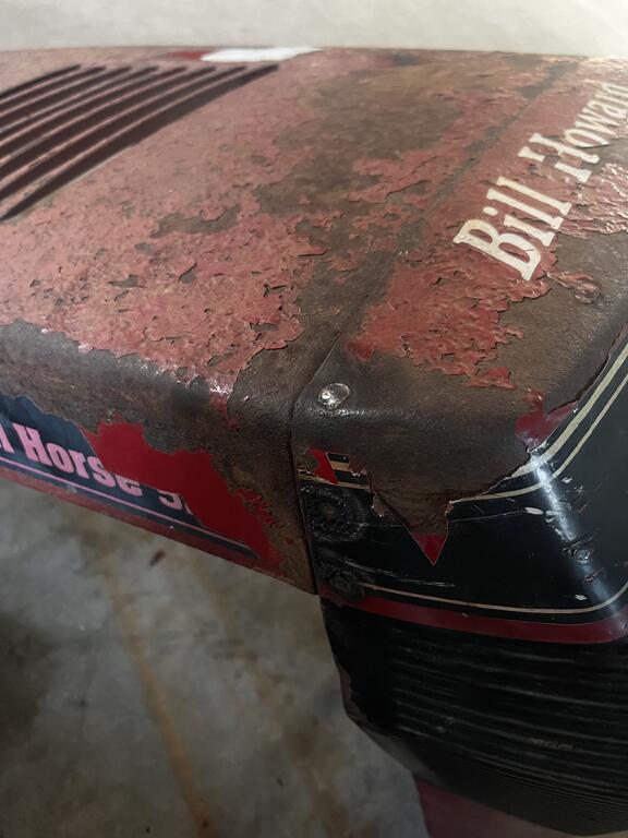

Desko 685 #15561 Posted May 2, 2022 Did some work on the 520-8 this evening while I had a little time. I started off with a new 5 pin plug and spades for the key switch. Then I moved onto the parking brake wiring and repaired that. I'm waiting on the new flag connectors for the clutch switch which I was able to cross to a 3 pin GE fridge light switch since they are nla from toro. I also repaired the hood corner since the spot welds broke out and it was separating but I still have to fix the dent under the headlights yet but haven't come up with a good idea that won't mess up the ribbing of it. Also is there anyone that keeps a record of the build date/unit numbers of these on here? 4 Share this post Link to post Share on other sites

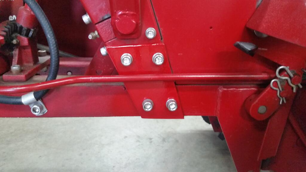

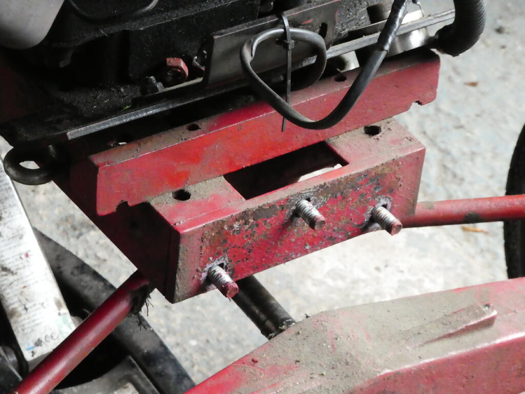

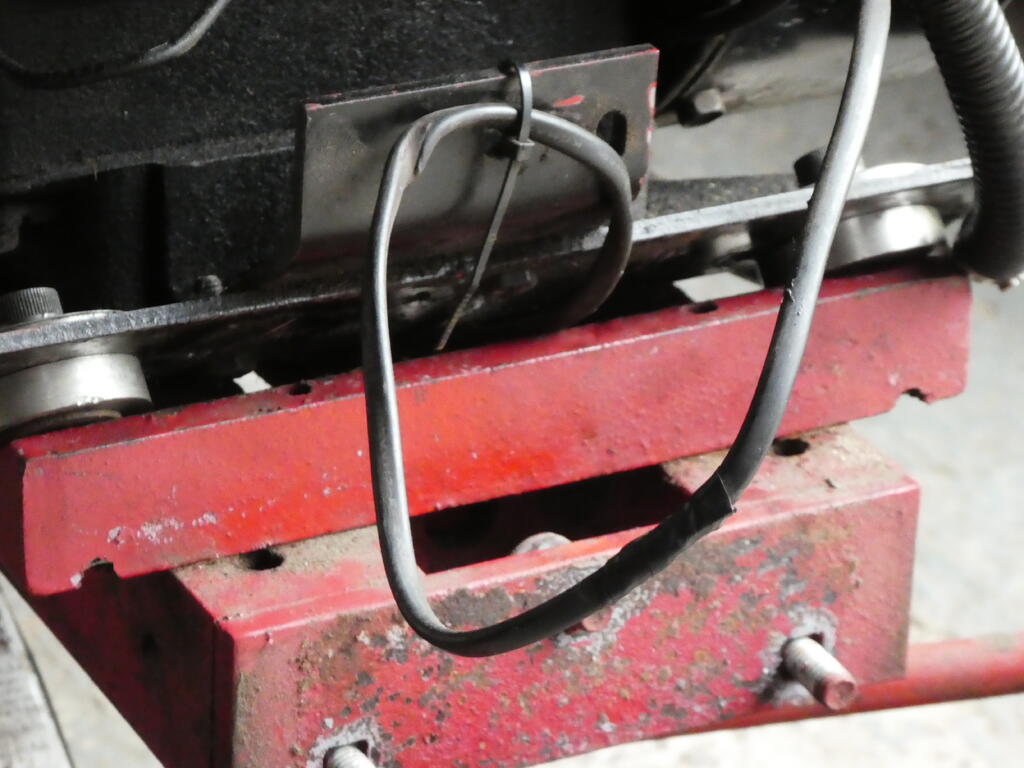

Stormin 9,988 #15564 Posted May 3, 2022 (edited) Last week while mowing the green, front, right engine to shaker plate bolt broke on the C125. Today I finally got to work on it. Getting the mounting bar off to remove the broken piece of bolt was a bit of work. First bonnet/hood off. No way to get a socket/spanner the the bolts holding the bar. So off with the front axle mounting. Eased up the shaker plate and inserted a small piece of wood 'twix it and chassis/frame. Then undid the bar and removed it. The broken piece was then drilled out from the under side. The drill bit actually screwed it out. Just a case of putting it all back together after that. Edited May 3, 2022 by Stormin 9 1 Share this post Link to post Share on other sites
Ed Kennell 46,867 #15565 Posted May 3, 2022 Shaker plate engine mounts.......One of Wheel Horses bad ideas. 8 Share this post Link to post Share on other sites
Stormin 9,988 #15566 Posted May 3, 2022 7 minutes ago, Ed Kennell said: Shaker plate engine mounts.......One of Wheel Horses bad ideas. I agree. You'll notice the ally spacers fitted and the washer under one of them. That's because the plate is not even. Slight twist. 3 Share this post Link to post Share on other sites
cleat 9,157 #15567 Posted May 3, 2022 My Ford LGT165 had those as well. Must have been something about that time frame. I think it was a 1979 or thereabouts.. 2 Share this post Link to post Share on other sites
peter lena 10,000 #15568 Posted May 3, 2022 @Desko noting your wiring , I regularly use spiral cable wrap on my wires to stop chafing and prevent the usual shorting issues , then I use nylon hangers secured to a nearby bolt or screw , just picked up 20 ft of 3/8" ID clear cable wrap on amazon for $ 6 . 5 Share this post Link to post Share on other sites

Desko 685 #15570 Posted May 3, 2022 2 hours ago, peter lena said: @Desko noting your wiring , I regularly use spiral cable wrap on my wires to stop chafing and prevent the usual shorting issues , then I use nylon hangers secured to a nearby bolt or screw , just picked up 20 ft of 3/8" ID clear cable wrap on amazon for $ 6 . Yea I'll reloom it when it's done and tie it off properly so it doesn't get caught up in the shifter or on the brake cross shaft. I try and get my stuff locally even if it costs a little more but it's worth helping the small businesses when I can. 3 1 Share this post Link to post Share on other sites

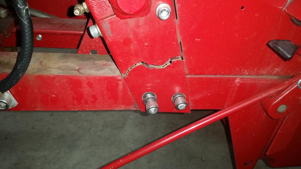

WHX?? 57,685 #15572 Posted May 3, 2022 Had the 1067 in the shop for some repair & upkeep. This was broken BR (before resto). I welded it but it cracked again. Made a plate to bolt over it & hopefully cures the problem. Put a new @76c12091520h seat on it. Yep It needed spacers too @Achto 7 11 Share this post Link to post Share on other sites
ebinmaine 80,190 #15573 Posted May 3, 2022 20 minutes ago, WHX?? said: Made a plate Nice work on that bub. 2 1 Share this post Link to post Share on other sites
8ntruck 9,203 #15574 Posted May 4, 2022 That looks like a fatigue crack. Was your weld repair a weld and grind smooth type of repair? In this case, the weld left a stress riser that eventually grew into another fatigue crack. If you make another similar weld repair, go over the weld with a pneumatic needle de-scaler. The de-scaler will leave a layer of compressed metal along the repair, which will help prevent another crack from forming. Then again, your plate repair is effective as well. Nicely done, too. The best repair is quite often the one that matches the resources and tools at hand. 4 4 Share this post Link to post Share on other sites
