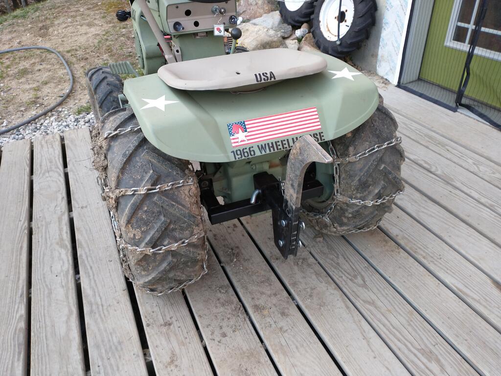

ebinmaine 80,808 #15380 Posted April 21, 2022 So earlier today, before I was home... I texted the BBT to see what she was upta. I get this: Now last I knew that rig had a hitch on it. Turns out she was swapping out a weak welded hitch for the one I rewelded this past weekend. She also got the ripper spike put on. "Transport mode" so it's upside down. 7 7 Share this post Link to post Share on other sites
EB-80/8inPA 2,116 #15381 Posted April 21, 2022 1 hour ago, ebinmaine said: She also got the ripper spike put on. I’d like to see a video of that underway and doing its thing. 2 Share this post Link to post Share on other sites
ebinmaine 80,808 #15382 Posted April 21, 2022 6 hours ago, EB-80/8inPA said: I’d like to see a video of that underway and doing its thing. Be more than happy to. We used it a bit with the other hitch and the tab style hitch still on. The tab hitch was somewhat in the way. The ripper mount square is maybe 1.5" instead of the standard 2". It actually fits inside of a ball mount. ((WTH??)) I cut a short section off the end of a ball mount and redrilled that. Used the short section as an adapter. It isn't perfect but it'll do for now. It was impressive to see how well the ripper worked even not being set right. I'll be looking forward to seeing just how deep we can get in our rock mix with it. 2 Share this post Link to post Share on other sites

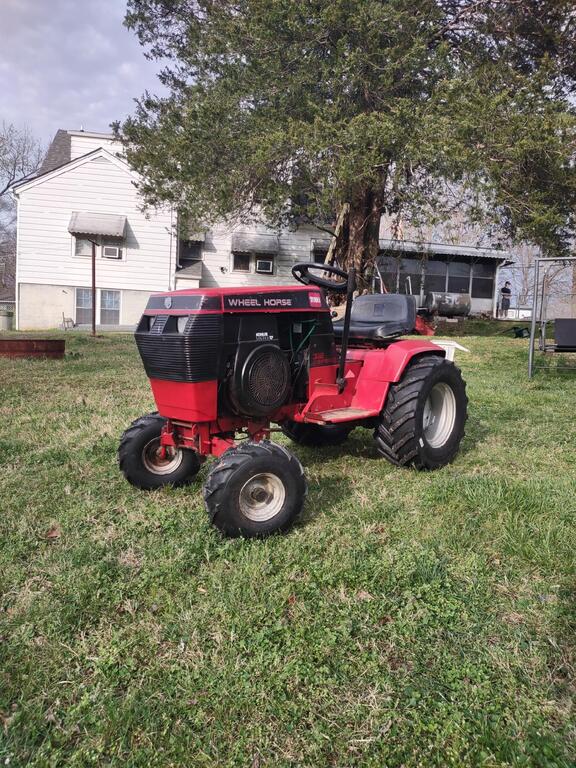

Clayton Rogers 15 #15388 Posted April 22, 2022 did some stuff to my 312-8 7 8 Share this post Link to post Share on other sites

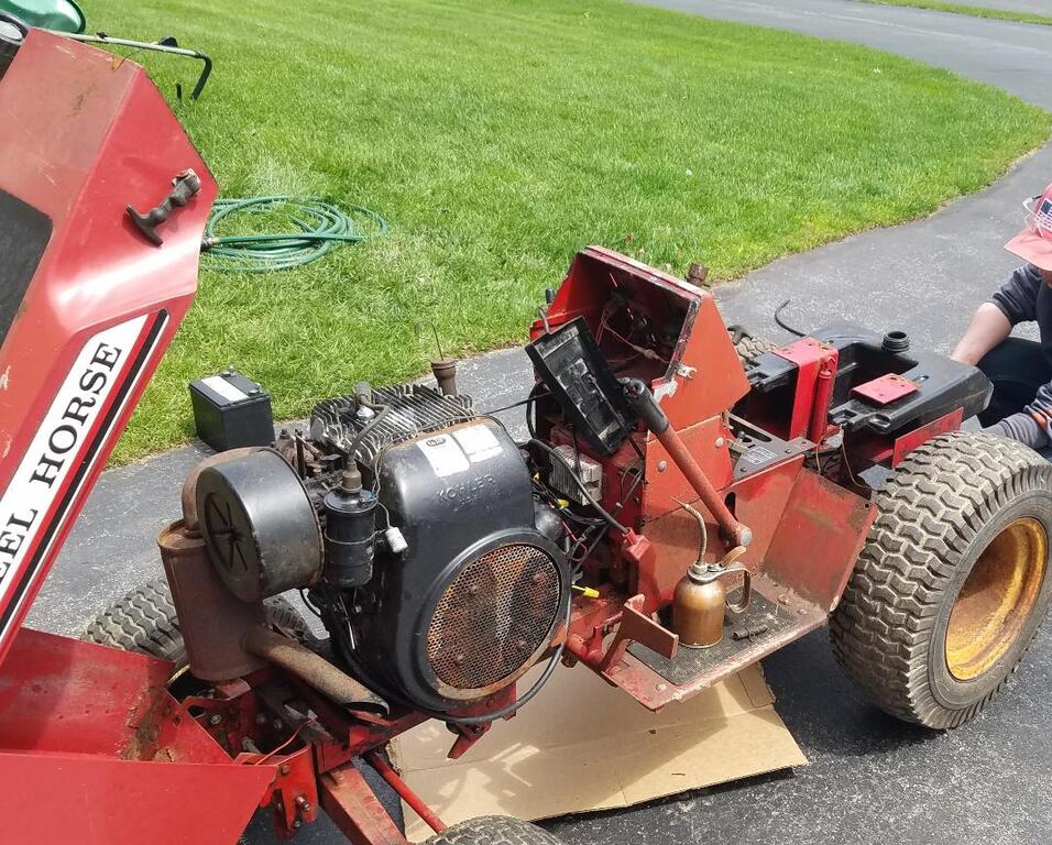

Bill D 3,160 #15389 Posted April 22, 2022 Yesterday I used my 416 to tow a neighbors Deere back to my house for mouse nest removal and starter gear free up. Today I helped a friend get his newly acquired C165 started. The machine had sat outside for a very long time. We used my cheater box to get it fired up. It ran surprisingly well. It was thrilling to hear that K341 fire up 4 Share this post Link to post Share on other sites

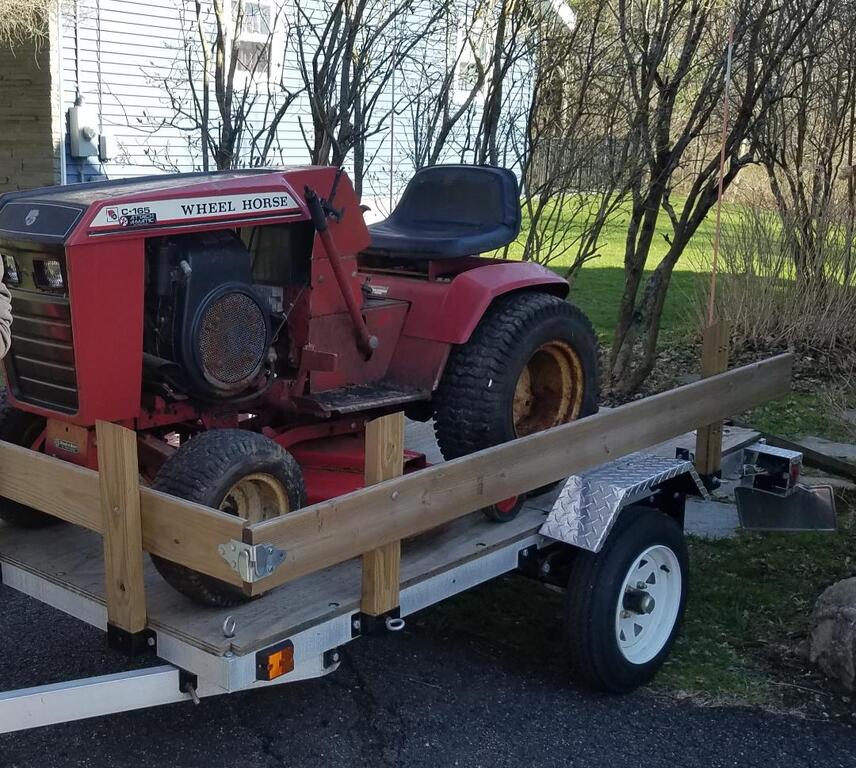

Brockport Bill 2,478 #15390 Posted April 22, 2022 attempting to save a lonely horse sent out to a cold pasture too soon -- given a new home - hopefully with some life left???? 5 7 Share this post Link to post Share on other sites

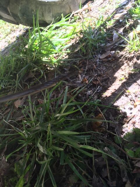

Bill Winn 157 #15394 Posted April 22, 2022 What have I done to my Wheel Horse today? Well I recently put narrow wheel and tri-ribs on her and she steers easier and better now. Oh, and I broke my lift cable. Hmmm, gotta try and rig something up temporarily until I can get a cable that isn't priced at half a hondo!!!! BTW why isn't this a rod/ bar instead of a cable? 3 Share this post Link to post Share on other sites
Lee1977 7,786 #15395 Posted April 22, 2022 3 minutes ago, Bill Winn said: What have I done to my Wheel Horse today? Well I recently put narrow wheel and tri-ribs on her and she steers easier and better now. Oh, and I broke my lift cable. Hmmm, gotta try and rig something up temporarily until I can get a cable that isn't priced at half a hondo!!!! BTW why isn't this a rod/ bar instead of a cable? A old Ford brake cable will work and I don't think you will break it. 3 Share this post Link to post Share on other sites
Bill Winn 157 #15396 Posted April 22, 2022 13 minutes ago, Lee1977 said: A old Ford brake cable will work and I don't think you will break it. Great to hear. Thank you. Do you know from what year/ model I would look for that brake cable? 2 Share this post Link to post Share on other sites
Lee1977 7,786 #15397 Posted April 22, 2022 (edited) 23 minutes ago, Bill Winn said: Great to hear. Thank you. Do you know from what year/ model I would look for that brake cable? 60''s 70's hand brake cable. The ends will have a ball on them. Not sure about the later models. Edited April 22, 2022 by Lee1977 4 Share this post Link to post Share on other sites
Ed Kennell 47,459 #15398 Posted April 22, 2022 32 minutes ago, Bill Winn said: a cable that isn't priced at half a hondo I use garage door cables available at any hardware store for a couple bucks. One end will have a crimped loop. Cut to length and use a small cable clamp to make the loop on the cut end. I also use old garage door springs to make lift assist springs. A solid rod would not work due to the twisted path from the lift lever to the rear hitch and the vertical movement of the two ends. 6 Share this post Link to post Share on other sites

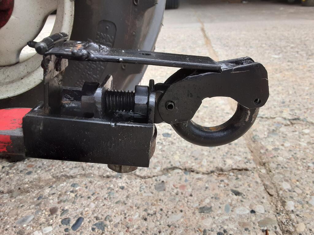

Roger R 473 #15399 Posted April 22, 2022 What have I done to my Wheel Horse? Designed and built a pintle hook system. Why does a GT need a pintle hook hitch you ask.... No good reason except that it was an enjoyable design / build project. It does make hitch ups easy and compensates for rough ground better than a draw pin. Added a spring to the latch after the picture was taken. Works great on the lawn roller etc. 10 6 Share this post Link to post Share on other sites
