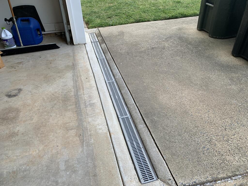

Horse Newbie 7,405 #15317 Posted April 14, 2022 8 hours ago, TJ Salyers said: The storms we had last night did this the wind blew against the doors and the doors leaked water on the bottom. Water used to run under my garage door… until I did this… Now I only get a little when the rain blows against the garage door. 3 3 Share this post Link to post Share on other sites

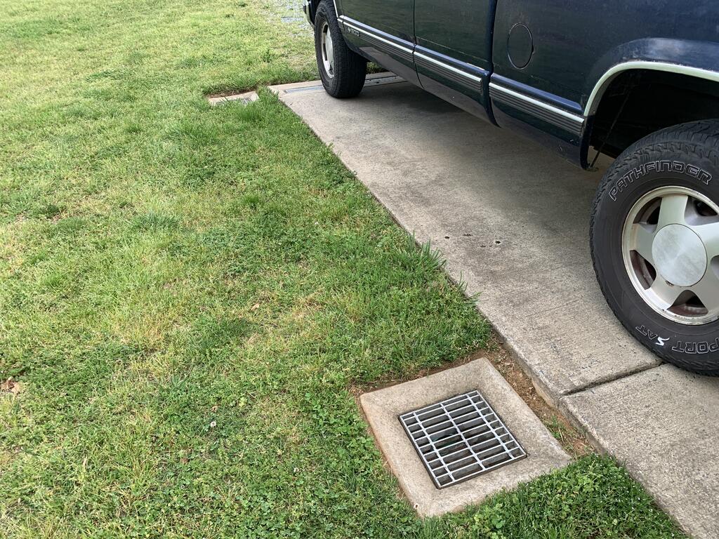

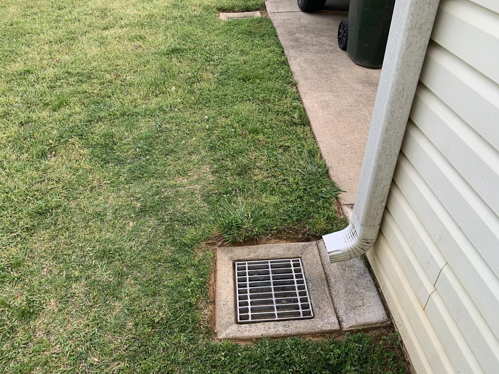

Horse Newbie 7,405 #15320 Posted April 14, 2022 19 minutes ago, Horse Newbie said: Water used to run under my garage door… until I did this… Now I only get a little when the rain blows against the garage door. Oh.. and this… water would come across the yard and flood across the concrete driveway… 4 1 Share this post Link to post Share on other sites

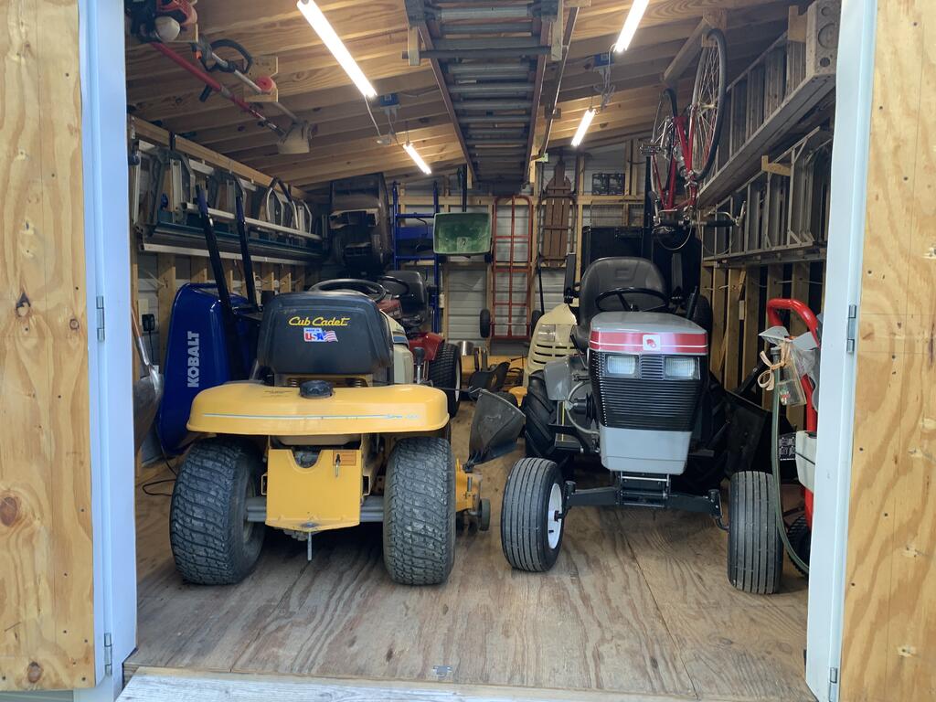

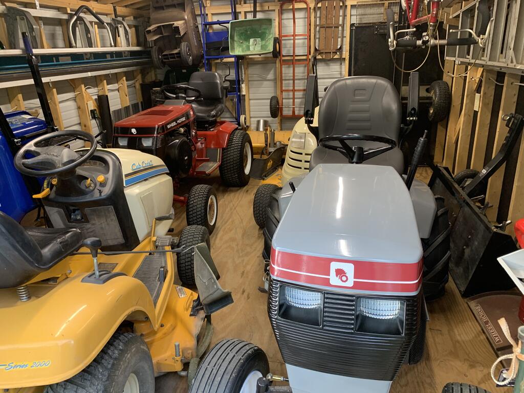

Horse Newbie 7,405 #15323 Posted April 15, 2022 Maybe not so much what I did “to” my Wheel Horses today, as “what” I did “with” them… I am all but finished the Work Horse refresh, so I figured I would put her in the tractor shed… I got my two horses in there with the two yellow and white machines, but it was a tight fit… Thought I was gonna have to toss a Cub outside ! 5 1 Share this post Link to post Share on other sites

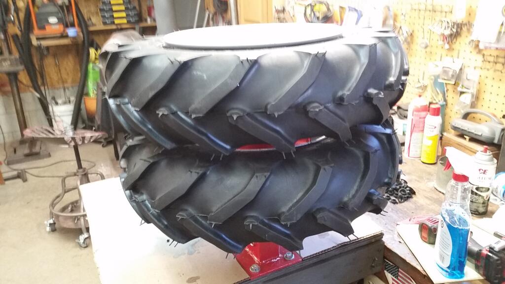

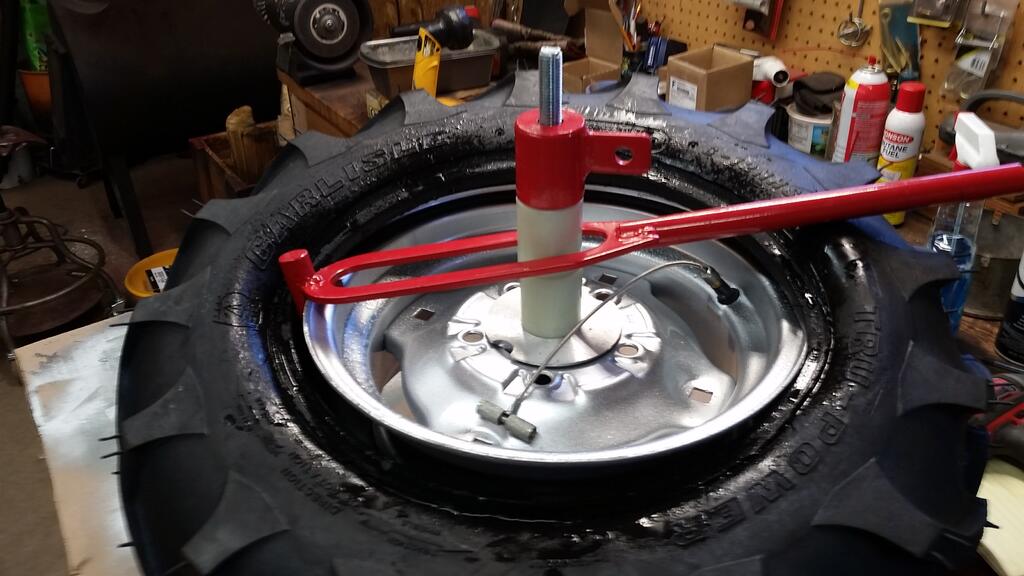

WHX?? 58,254 #15324 Posted April 15, 2022 (edited) 14 hours ago, JoeM said: somewhat a PIA lining up tread What I did Joe is mounted the tires on the rims but didn't seat the beads. Then bolted everthing up and mounted the whole shebang up on the mini changer and used it for the third hand. Adjusted the tires to get the stagger I wanted then seated the beads. Just thought the not lined up lugs looked better. Still rides a bit rough! Edited April 15, 2022 by WHX?? 6 1 1 Share this post Link to post Share on other sites

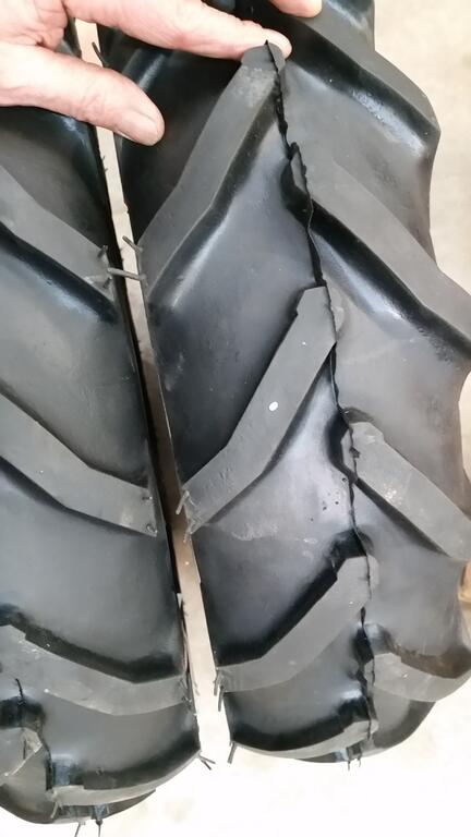

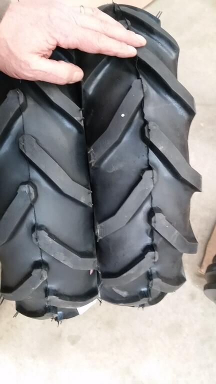

JoeM 10,315 #15325 Posted April 15, 2022 47 minutes ago, WHX?? said: lined up lugs One other thing was I think I got 3 tires from the same mold and 1 odd one comparing tread. Of course you can only tell it I point it out. My approach was similar to yours. Air up the bottom tire with it lined up with a reference, and no stem in it so I could push it back down easily. Snugged the to rims together lightly, only using two bolts and none fiber nuts. Then positioned the top tire. I used a square to check and had to adjust the insert because the slop in the tubes allowed the top tire to be out high on two sides. And that caused a readjustment to line up the lugs. Probability was being way to picky. But it is a hobby. 3 1 Share this post Link to post Share on other sites
