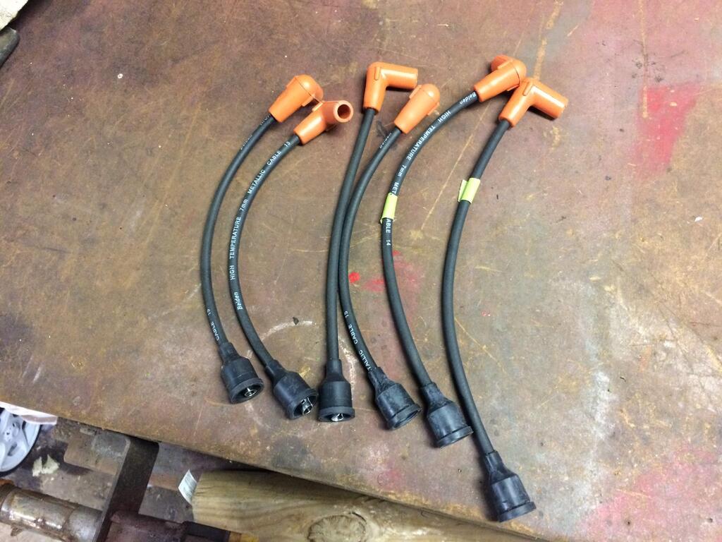

TonyToro 1,190 #15101 Posted March 25, 2022 23 hours ago, squonk said: Correct length and end spark plug cables I have. Just need to know how long you want it. Points to coil is just 14 ga. wire with ring ends. You snip part of the ring end at the points to get it under the screw or use a spade end. I need a wire. Do you have extra for sale? 3 Share this post Link to post Share on other sites

squonk 48,182 #15103 Posted March 25, 2022 8 minutes ago, TonyToro said: I need a wire. Do you have extra for sale? Yes. I just need to know how long you want it. $12 with shipping 2 1 Share this post Link to post Share on other sites

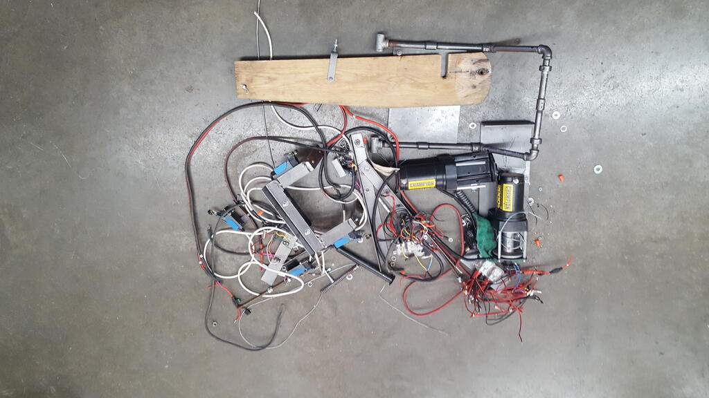

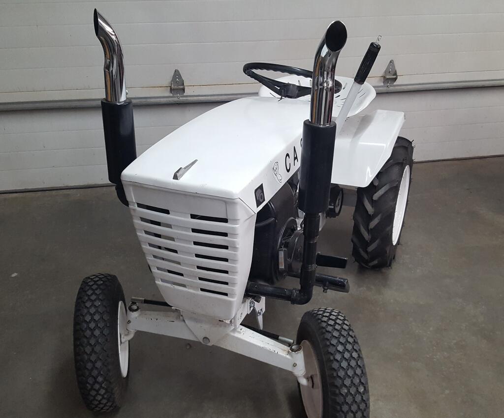

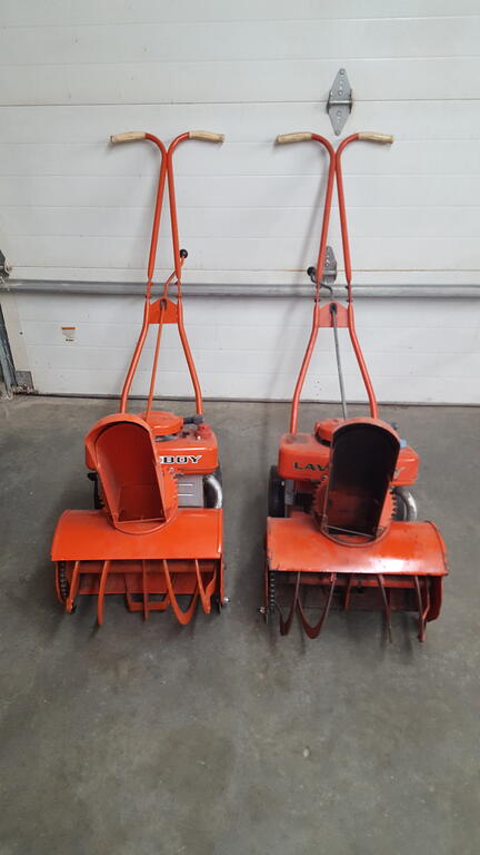

Gregor 4,848 #15104 Posted March 25, 2022 I did some un-modifying this morning. Casper is back to being good ole Casper. No more snow blowers, winches, or push button steering. I think all that extra weight was kind-a hampering his flying anyway, and the Lawn Boy snow blowers are happy just being snow blowers again. 6 1 3 Share this post Link to post Share on other sites
Horse Newbie 7,405 #15105 Posted March 25, 2022 9 hours ago, Gregor said: I did some un-modifying this morning. Casper is back to being good ole Casper. No more snow blowers, winches, or push button steering. I think all that extra weight was kind-a hampering his flying anyway, and the Lawn Boy snow blowers are happy just being snow blowers again. That pile is exactly what I would end up with if I try to modify… that’s why things work better if I just leave stuff alone… Although, I don’t see a thing wrong with modifications, just not when I do it. 1 Share this post Link to post Share on other sites
Gregor 4,848 #15106 Posted March 25, 2022 14 minutes ago, Horse Newbie said: That pile is exactly what I would end up with if I try to modify… that’s why things work better if I just leave stuff alone… Although, I don’t see a thing wrong with modifications, just not when I do it. The fun is in the trying, even if it never works. 1 1 1 Share this post Link to post Share on other sites

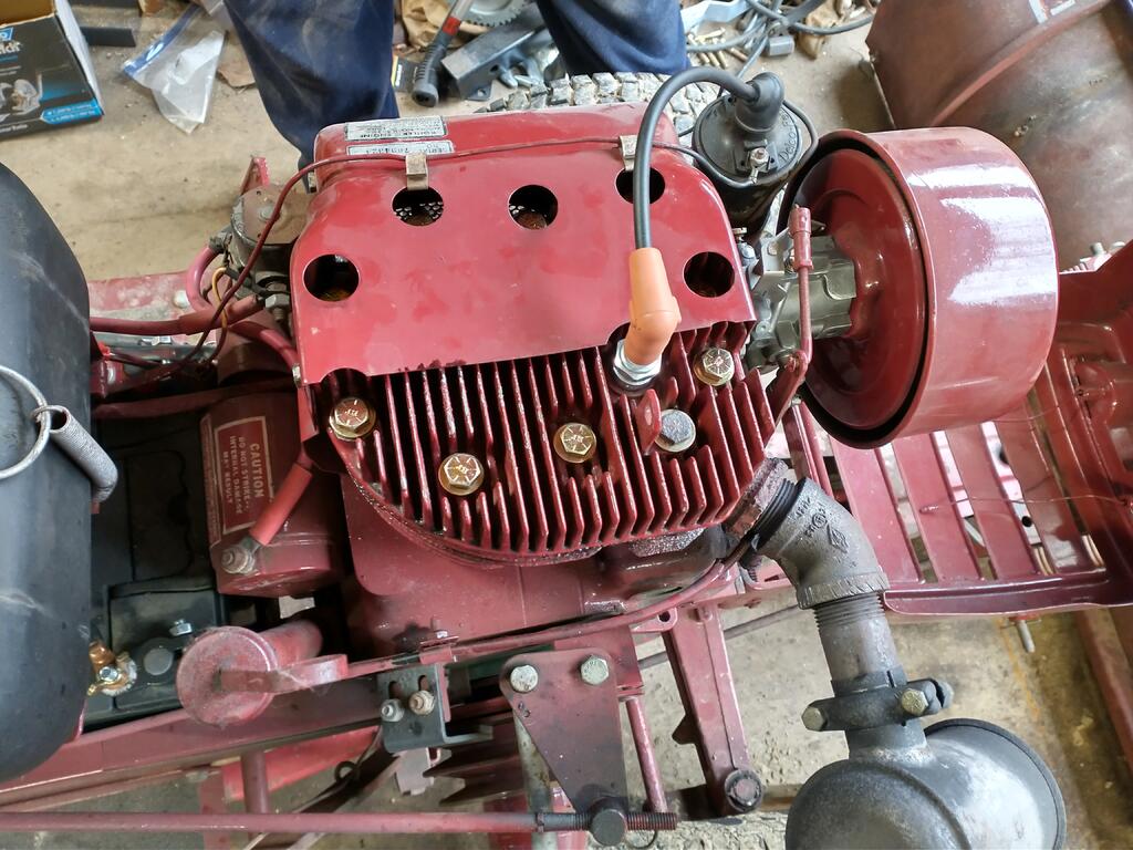

ebinmaine 80,809 #15108 Posted March 27, 2022 Got the '75 C160 Automatic head reinstalled with a new gasket and bolts. Also added a piece of sheet metal trim to the back of the hood. Looks good and tightens up the connection from hood to hood stand. 6 9 Share this post Link to post Share on other sites

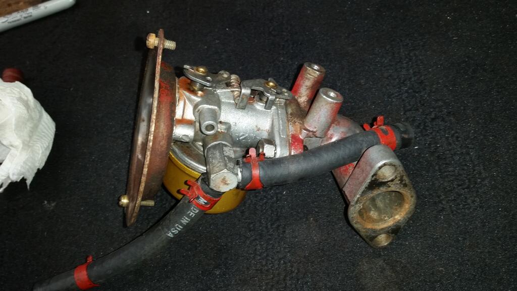

WHX?? 58,254 #15114 Posted March 28, 2022 (edited) Did you go with the 6 3/4 tube length Joe? Pics once you get them on a tractor! Can you use the centers with some good blanks for a custom offset? Rebuilt a Squonky carb that the inlet that would not quit leaking by. Good thing it was easy on/off. Edited March 28, 2022 by WHX?? 3 Share this post Link to post Share on other sites

peter lena 10,080 #15117 Posted March 29, 2022 @WHX?? do you see it ? opportunity for a 5/16 vertical fuel check valve just before carb entry , EVIL ENERGY has them on line . have them on my 3 magnum engines , instant starts , no fuel drain back , only if you want to , have a good one , pete 2 1 Share this post Link to post Share on other sites

peter lena 10,080 #15121 Posted March 29, 2022 @WHX?? when installed vertically , arrow up to carb , that valve looks like it was made for that set up , just fits into the gap on side of carb . I also build / assemble the installation before installing it , makes it easier , pete 1 1 Share this post Link to post Share on other sites
peter lena 10,080 #15122 Posted March 29, 2022 @WHX?? scary details on the pre build set up , measure it up for close location and fit , I use those dark green spring clamps , also , use just a light film of dielectric grease on each hose to filter slide point , lets you bottom out the hose fit , then squeeze and slide on the clamps , hose and 5/16 check valve are same size, lubricant makes for a very smooth / easy slide on fit . pre built this and its a very easy installation, leave the 2 final squeeze clamps on the hose , down from slide on point , once the hose is on carb / fuel pump , squeeze clamps on into place . your done ! start up leak check , retest for start . imagine that , no more fuel drain back , it works , I use clear vinyl hose ,pete 1 Share this post Link to post Share on other sites
Lane Ranger 12,125 #15123 Posted March 29, 2022 2 hours ago, peter lena said: @WHX?? do you see it ? opportunity for a 5/16 vertical fuel check valve just before carb entry , EVIL ENERGY has them on line . have them on my 3 magnum engines , instant starts , no fuel drain back , only if you want to , have a good one , pete pete : I bought two of these today and going to try them out on your recommendation! Looks like an easy install. https://www.amazon.com/dp/B09TT4T16M/ref=cm_sw_r_awdo_66C3TS7J7R7BSD2VKPY7?psc=1 2 Share this post Link to post Share on other sites
peter lena 10,080 #15124 Posted March 29, 2022 @Lane Ranger yes they are an easy install, after I did the first one , in place , I changed that over to putting it together away from the tight spot , think about it , hoses clamped on valve , last 2 clamps in place to slide on ends , lite hose lubricant , install and test run . flow arrow on valve facing up , easy pete 2 Share this post Link to post Share on other sites
