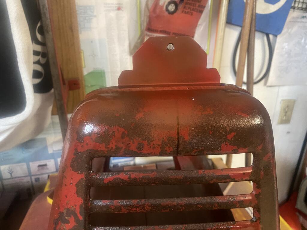

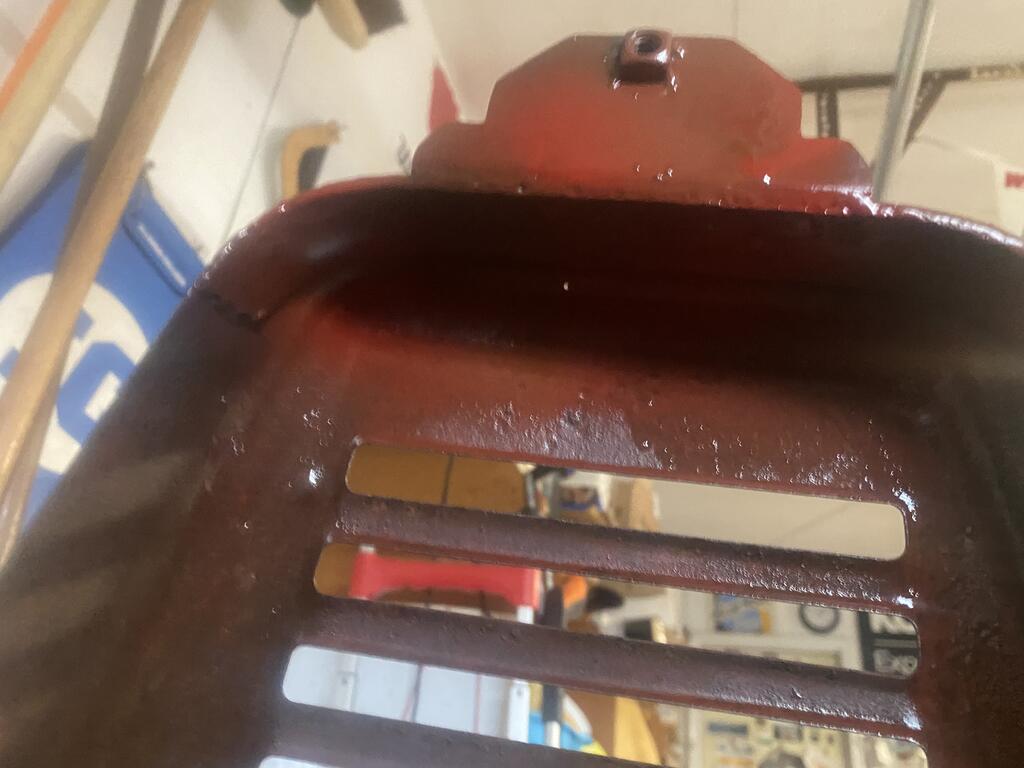

Lane Ranger 12,125 #15080 Posted March 22, 2022 (edited) Picked up my 754 hood today from my welder Russ. He has done several of these new fronts for me on the old round hoods that have rust outs or breaks in front bottom of the hoods. Will Patton makes the plate and a half inch band to weld on these old hoods and I have purchased several from him. They are very good and mimic the originals. I also have my welder add more plate on the interior bottom of the old hoods to strength the overall hood as it sits in the front of the tractor frame. Only need to change the head and head gasket on my 754 as the next project! what I started with on the 754 hood. Edited March 22, 2022 by Lane Ranger 1 13 Share this post Link to post Share on other sites

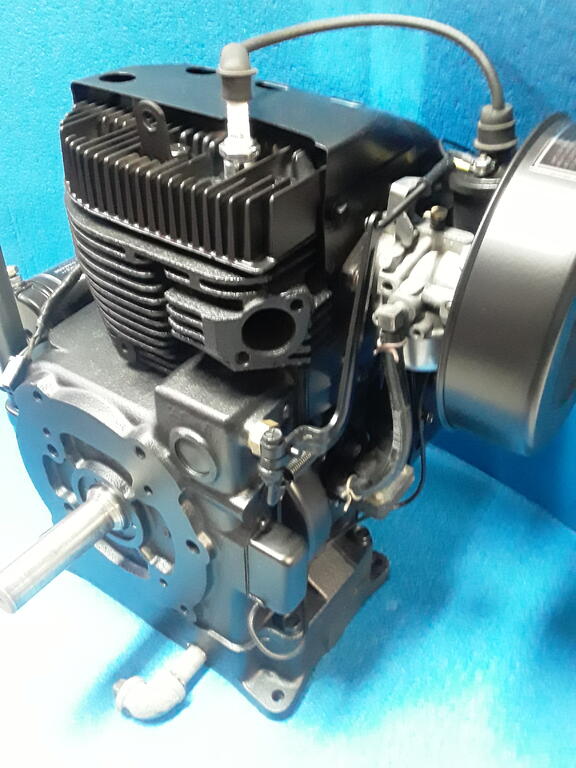

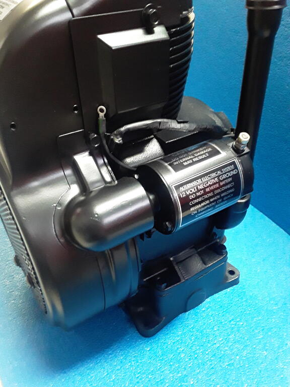

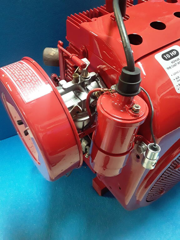

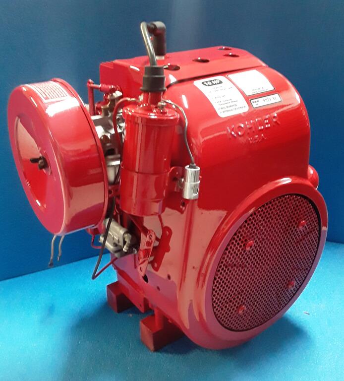

dmoore 1,042 #15083 Posted March 23, 2022 On 3/20/2022 at 8:16 PM, 76c12091520h said: Finished the rebuilds on a pair of K-series: Nothing short of perfection 3 4 Share this post Link to post Share on other sites
Jeff-C175 7,211 #15084 Posted March 24, 2022 1 hour ago, dmoore said: Nothing short of perfection You got that right! Beautiful work! What paint did you use on the 321? 1 Share this post Link to post Share on other sites
76c12091520h 4,290 #15085 Posted March 24, 2022 35 minutes ago, Jeff-C175 said: You got that right! Beautiful work! What paint did you use on the 321? PPG "Hot Rod Black" 1 1 Share this post Link to post Share on other sites
dmoore 1,042 #15086 Posted March 24, 2022 Question, Were the carbs, fuel pump painted with the engines ORIGINALLY? 1 Share this post Link to post Share on other sites
76c12091520h 4,290 #15087 Posted March 24, 2022 1 minute ago, dmoore said: Question, Were the carbs, fuel pump painted with the engines ORIGINALLY? Pre-teardown photo 1 Share this post Link to post Share on other sites
dmoore 1,042 #15088 Posted March 24, 2022 I thought so. On a diff subject, Do you have the correct wire from points to coil? Mine is original and is getting "soft" I'd love to replace with the correct ends/length. 1 Share this post Link to post Share on other sites
76c12091520h 4,290 #15089 Posted March 24, 2022 11 minutes ago, dmoore said: I thought so. On a diff subject, Do you have the correct wire from points to coil? Mine is original and is getting "soft" I'd love to replace with the correct ends/length. will check 1 Share this post Link to post Share on other sites
dmoore 1,042 #15090 Posted March 24, 2022 Thanks Brian! 1 Share this post Link to post Share on other sites
ebinmaine 80,809 #15091 Posted March 24, 2022 6 hours ago, dmoore said: Question, Were the carbs, fuel pump painted with the engines ORIGINALLY? I've seen both. We've had what we believe to be original untouched horses with black coils and unpainted carbs. Might be another case of Wheelhorse grabbing whatever was available from Kohler at the time of need. 1 Share this post Link to post Share on other sites

rjg854 13,391 #15093 Posted March 24, 2022 10 hours ago, dmoore said: I thought so. On a diff subject, Do you have the correct wire from points to coil? Mine is original and is getting "soft" I'd love to replace with the correct ends/length. get a hold of @squonk he usually has them for sale. Share this post Link to post Share on other sites
squonk 48,182 #15094 Posted March 24, 2022 Correct length and end spark plug cables I have. Just need to know how long you want it. Points to coil is just 14 ga. wire with ring ends. You snip part of the ring end at the points to get it under the screw or use a spade end. 2 1 Share this post Link to post Share on other sites
dmoore 1,042 #15095 Posted March 24, 2022 I was talking about the points to coil lead Share this post Link to post Share on other sites
dmoore 1,042 #15096 Posted March 24, 2022 My original lead is a "hook" end at coil. I cant remember what is at the points end. 1 Share this post Link to post Share on other sites
squonk 48,182 #15097 Posted March 24, 2022 (edited) 33 minutes ago, dmoore said: My original lead is a "hook" end at coil. I cant remember what is at the points end. Ring end at the coil. To make the hook just snip a small portion of another ring terminal with side cutters. Edited March 24, 2022 by squonk 5 Share this post Link to post Share on other sites
ebinmaine 80,809 #15098 Posted March 24, 2022 2 hours ago, dmoore said: My original lead is a "hook" end at coil. I cant remember what is at the points end. 1 hour ago, squonk said: Ring end at the coil Yep. On the coil end I've seen rings or forks. On the points end, either a fork or a hook. I prefer to use a ring on both ends just because it's easier during assembly. To make a decent original looking wire you can take one of those terminals with the blue covering as pictured above. Remove the blue and replace it with a short piece of appropriate colored heat shrink. 2 Share this post Link to post Share on other sites
