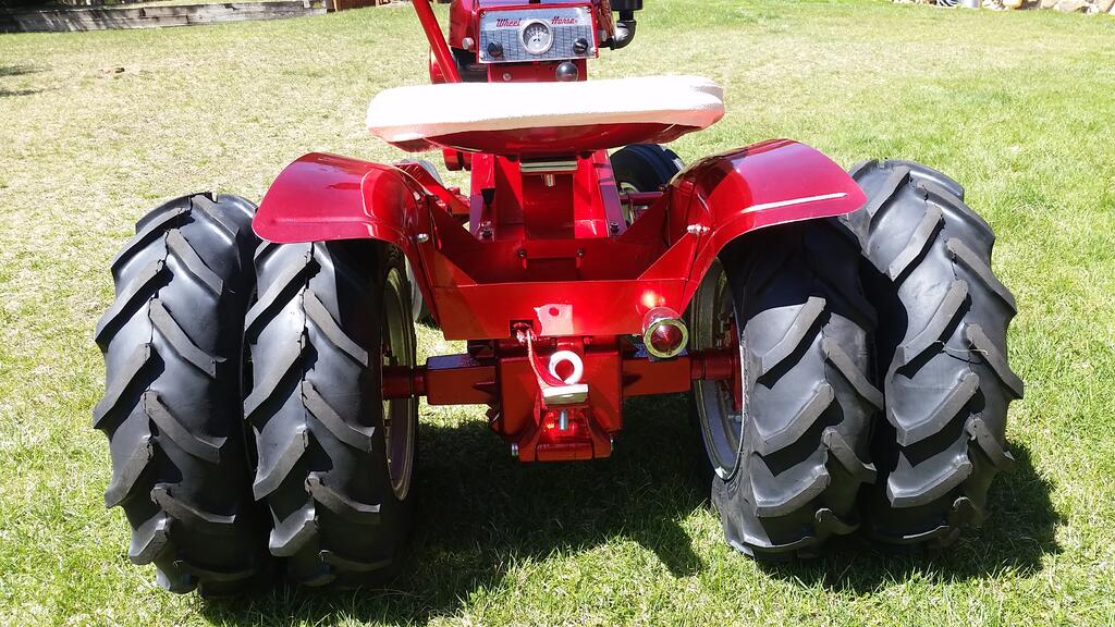

pfrederi 21,204 #15053 Posted March 21, 2022 14 hours ago, JoeM said: Paul as compared to other WH's 3,4 500 series what makes it possible to use the taller rear tires? How much difference in the frame etc.? I only owned 1 and it was for a very short time. Frame is wider (1") Front axle has a drop and uses bigger tires. The hoodstand and seat platform are taller than regular horses to give clearance for the tires.. Sunstrand Hydro gear and transaxle are dimensionlly the same as Chargers electros etc. Only internal difference is input gear (hydro motor to transaxle) 2 1 Share this post Link to post Share on other sites

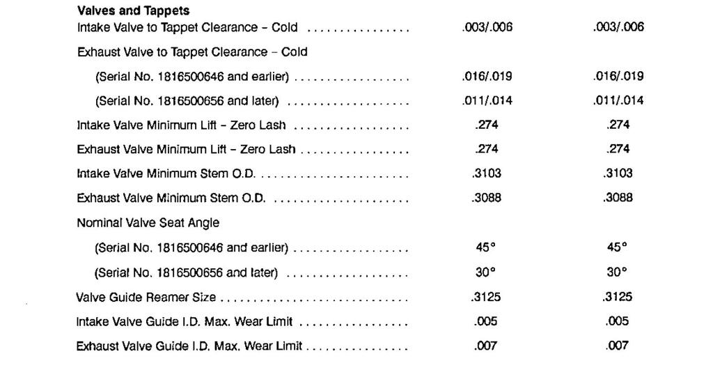

johnnymag3 2,646 #15055 Posted March 21, 2022 What should the gap be for each valve at the cam / lifter intake_______ exhaust_____ Share this post Link to post Share on other sites
pfrederi 21,204 #15056 Posted March 21, 2022 7 minutes ago, johnnymag3 said: What should the gap be for each valve at the cam / lifter intake_______ exhaust_____ 1 Share this post Link to post Share on other sites

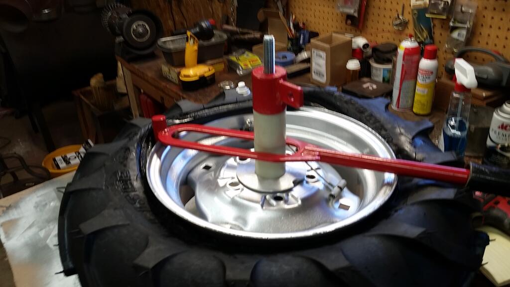

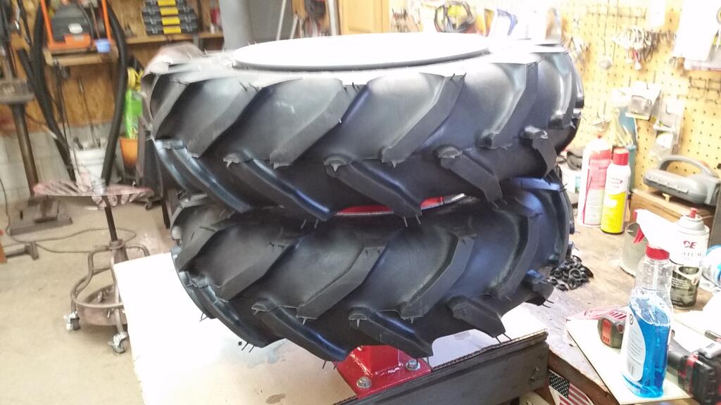

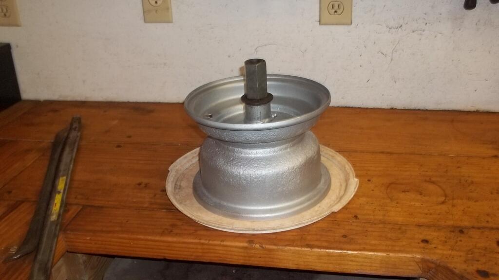

JoeM 10,315 #15058 Posted March 21, 2022 got out the harbo freight small tire changer and got ready to mount some tires on fresh painted wheels for the C81 Covid Project. I am sure others may have a trick or two but I use a piece of plywood, with a hole drilled to accept the threaded rod, between the rim and changer to stop the changer from running up into the hub area. I put the bearings in afterward. 9 Share this post Link to post Share on other sites

WHX?? 58,254 #15060 Posted March 21, 2022 (edited) What keeps the rim from spinning on the plywood Joe? Any tips to keep from scratching paint? Edited March 22, 2022 by WHX?? 1 Share this post Link to post Share on other sites

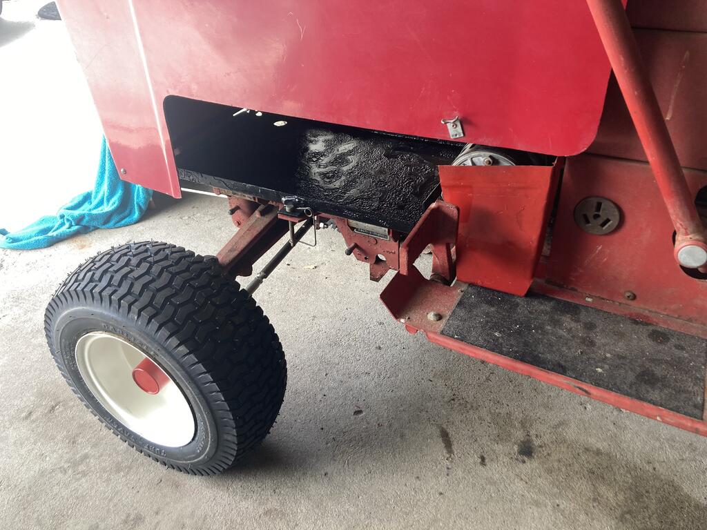

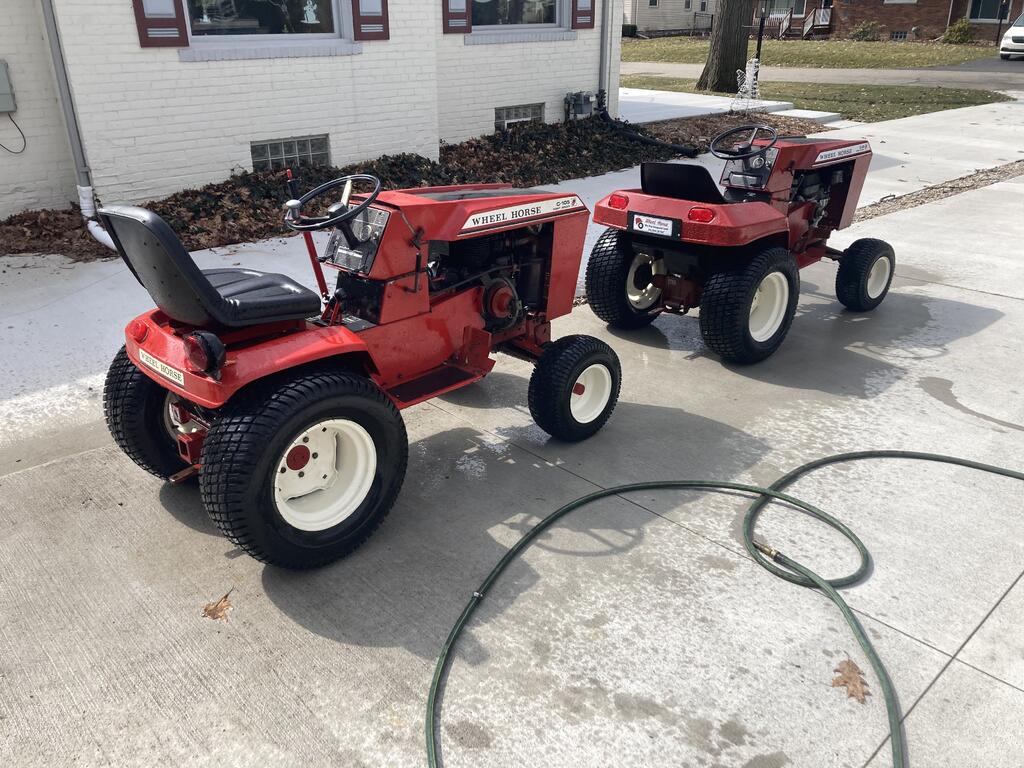

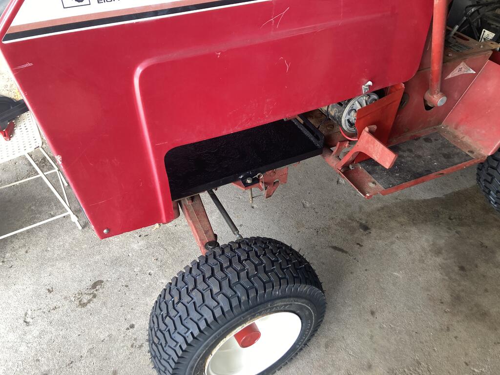

SylvanLakeWH 32,648 #15062 Posted March 21, 2022 Washed off the salt and winter grime from snow plow duty on the C 105 and the C 6.5 predator swap… Painted the lower battery tray on the E-141. Badly pitted from rust / acid. Just laid on the primer and paint to get it sealed. Not going trailer queen - this one’s going to work pulling the SL&WHN train… 9 1 Share this post Link to post Share on other sites
JoeM 10,315 #15063 Posted March 21, 2022 (edited) 2 hours ago, WHX?? said: What keeps the rim from spinning tighten the big nut on the top with the washer between. The bottom against the wood, (the side of the rim is facing out on the tractor), comes out really nice no touch up. the top can be tricky and you get a few skin marks around the edge of the rim against the tire. Nothing a small brush and a spray of paint in a jar won't touch up if one was needing to do so. I'll take an after pic or two later when I go back to the shop. Outside (side against plywood) Inside, the one is worse because I tried a different tool and should have stuck to the motorcycle tire tools. I thought afterward that maybe a couple wraps of electrical tape on this area may be the solution. ?? I got a couple more to do and might try that tape idea but that is a couple weeks away. Edited March 21, 2022 by JoeM 4 1 Share this post Link to post Share on other sites

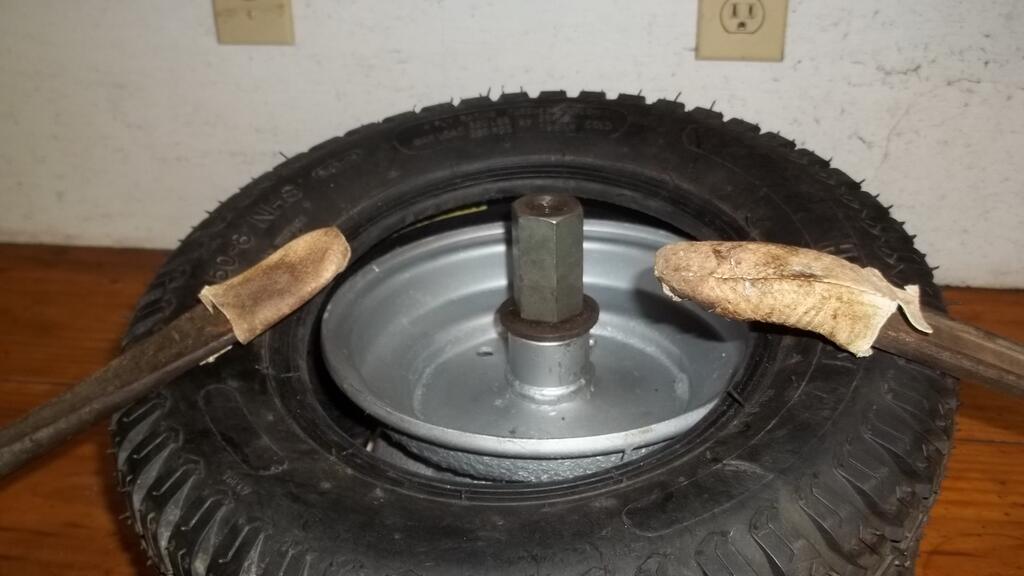

953 nut 69,635 #15064 Posted March 22, 2022 5 hours ago, WHX?? said: What keeps the rim from spinning on the plywood Joe? Any tips to keep form scratching paint? I use two tire irons at a time and have leather glove fingers over the ends, works fine. My tire changing station is a piece of 3/4" all thread through the work bench. 4 3 Share this post Link to post Share on other sites
WHX?? 58,254 #15065 Posted March 22, 2022 (edited) 'Nuts I have the same one as Joe. My problem is I don't have a bench to mount it solidly on where a guy can get the swing on it proper and have it it not flying around. Tis a handy thing to have around tho. Especially when I was setting the tires on the flame and wanted to get the stagger right. Thanks I will try the plywood thing. Edited March 22, 2022 by WHX?? 5 Share this post Link to post Share on other sites
peter lena 10,080 #15066 Posted March 22, 2022 @ SYLVANLAKE WH , nice work , looks like a wheel horse production line, don't give anyone ideas ! pete 1 1 Share this post Link to post Share on other sites

JoeM 10,315 #15068 Posted March 22, 2022 6 hours ago, 953 nut said: I use two tire irons at a time and have leather glove fingers over the ends Sweet........tire iron mittens, great idea. I got the perfect place to get a set (neighbor left a set of girly size leather gloves here, I will have to give them a Michael Jackson look) @WHX?? I like to leave the tires out in the sun if possible to soften them up a bit too. Those look like Farm Specials, tough tire strong sidewalls. I have an old axle with a old hub that I bolt the rear wheels on for mounting. I stick it in the vise 4 Share this post Link to post Share on other sites

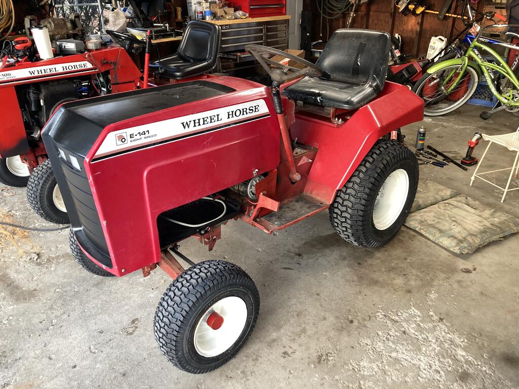

SylvanLakeWH 32,648 #15069 Posted March 22, 2022 Got the E 141 put back together. Rides nice on the new tires. 6 6 Share this post Link to post Share on other sites
WHX?? 58,254 #15070 Posted March 22, 2022 (edited) 5 hours ago, JoeM said: Those look like Farm Specials, Nope Carlisle Tru Powers, got a heck of a deal on them ...all four for a tad less than 200. I do like the farm specials Tho Sun what sun?!?!? Was very cold out when I did those so in front of the wood stove for an hour. Edited March 22, 2022 by WHX?? 8 3 Share this post Link to post Share on other sites
JoeM 10,315 #15071 Posted March 22, 2022 17 hours ago, SylvanLakeWH said: Painted the lower battery tray good application for POR-15 ? 1 1 Share this post Link to post Share on other sites
JoeM 10,315 #15072 Posted March 22, 2022 Just told the neighbor about the paint on that machine. Is that the tractor that barked your calf? 1 Share this post Link to post Share on other sites
WHX?? 58,254 #15073 Posted March 22, 2022 1 minute ago, JoeM said: good application for POR-15 ? Or bed liner Sylvia? 1 Share this post Link to post Share on other sites
WHX?? 58,254 #15074 Posted March 22, 2022 2 minutes ago, JoeM said: that barked your calf? Lol .... yep..... good way to put it! I do have to work on that jerky clutch one of these days. Doesn't help I have it pullyed for a little more speed! Share this post Link to post Share on other sites
SylvanLakeWH 32,648 #15075 Posted March 22, 2022 48 minutes ago, JoeM said: good application for POR-15 ? 46 minutes ago, WHX?? said: Or bed liner Sylvia? Both excellent suggestions! Thx! I went with using up what I had on hand because 1) I’m cheap and 2) I’m trying to keep costs on the E 141 below the stratosphere and 3) I’m decluttering and 4) did I mention I’m cheap? It will spend the rest of its life inside or in sunshine whilst pulling the train, so I’m not overly concerned about future rust… If I do another project and get into using liner or Por I will use it up on this application… 4 Share this post Link to post Share on other sites
