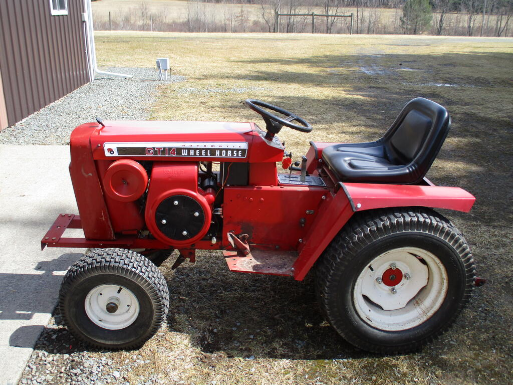

pfrederi 21,204 #15015 Posted March 19, 2022 I had to weld on some hood retainers (rear) on my GT14. My salvaged Miller spot welder did a nice job so a bit of sanding and throwing on some paint ( I do not have a paint department and body work/painting is my least favorite activity) Paint is adequate but Terry's new decals make it work!!! 2 12 Share this post Link to post Share on other sites
peter lena 10,080 #15016 Posted March 19, 2022 @pfrederi looks like a well kept , stout piece , lucky you , pete 1 1 Share this post Link to post Share on other sites

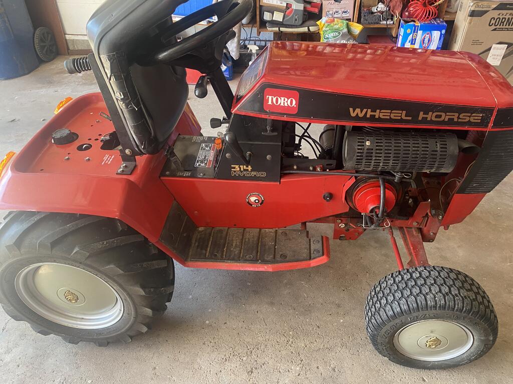

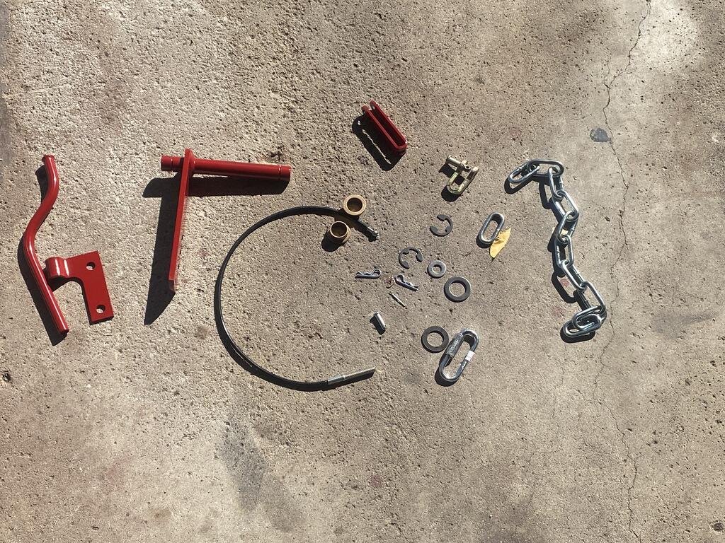

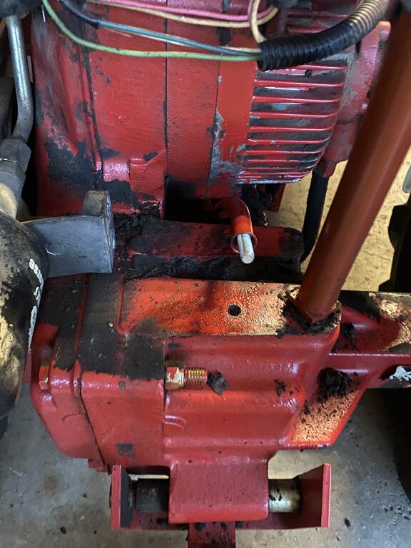

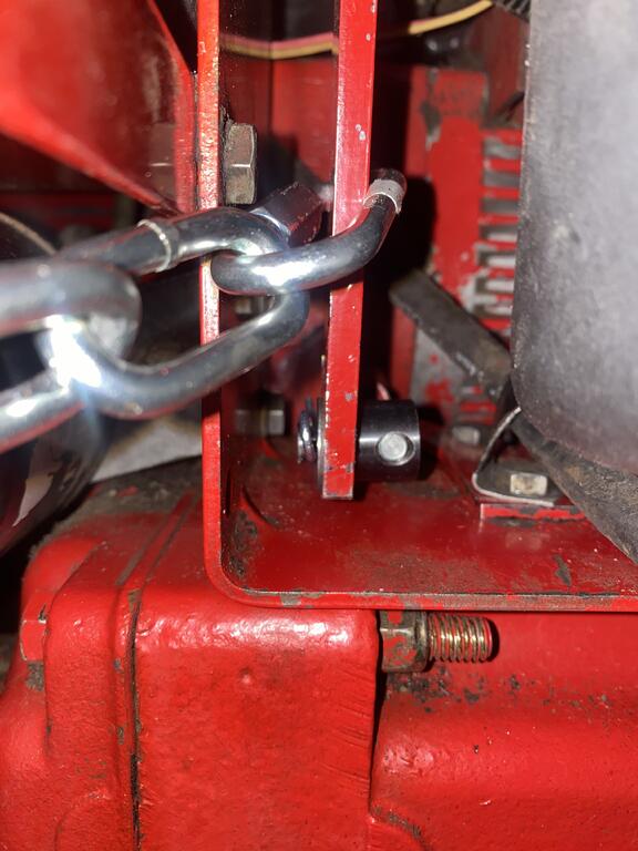

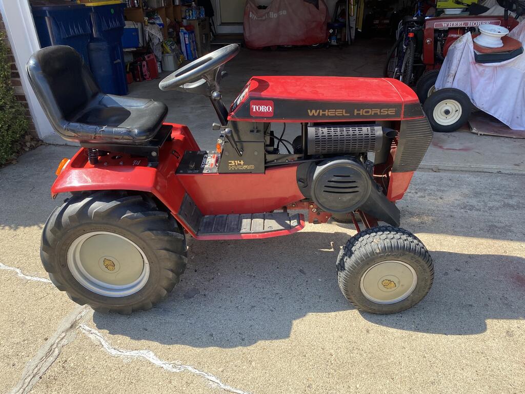

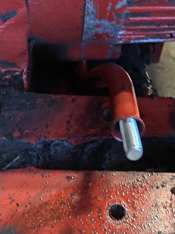

Lane Ranger 12,125 #15025 Posted March 20, 2022 I finally have my rear lift rockshaft and cable setup installed on my 314 Hydro Wheel Horse. Put the trunnion on the rear cable today with the lift chain for tiller and hitches. Takes a while to get it all set up correctly but works great when finished. 5 8 Share this post Link to post Share on other sites
