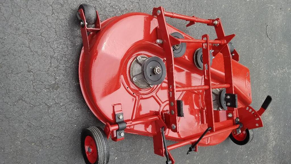

OutdoorEnvy 1,807 #14830 Posted March 5, 2022 Well it was time for my least enjoyable maintenance job of maintaining my horse in good shape...mower deck cleaning and sharpening...but it's gotta get done. I don't over do it. I knock most of the dirt/debris off and spray it off and let it dry in the sun, then spray some WD40 on the under side, sharpen and balance the blades, then grease it pretty good. I'm always satisfied and get the warm and fuzzy feelings when it's done though...she's ready for those baseball practice fields! 5 1 Share this post Link to post Share on other sites

Wheelhorse#1 1,901 #14832 Posted March 5, 2022 3 hours ago, OutdoorEnvy said: Well it was time for my least enjoyable maintenance job of maintaining my horse in good shape...mower deck cleaning and sharpening...but it's gotta get done. I don't over do it. I knock most of the dirt/debris off and spray it off and let it dry in the sun, then spray some WD40 on the under side, sharpen and balance the blades, then grease it pretty good. I'm always satisfied and get the warm and fuzzy feelings when it's done though...she's ready for those baseball practice fields! Looking good.It does feel good once you get it installed back on the tractor.It’s like wrestling a 500 pound gorilla ! 2 1 1 Share this post Link to post Share on other sites
cleat 8,735 #14833 Posted March 6, 2022 Try wrestling the 60" deck.... 4 2 1 Share this post Link to post Share on other sites

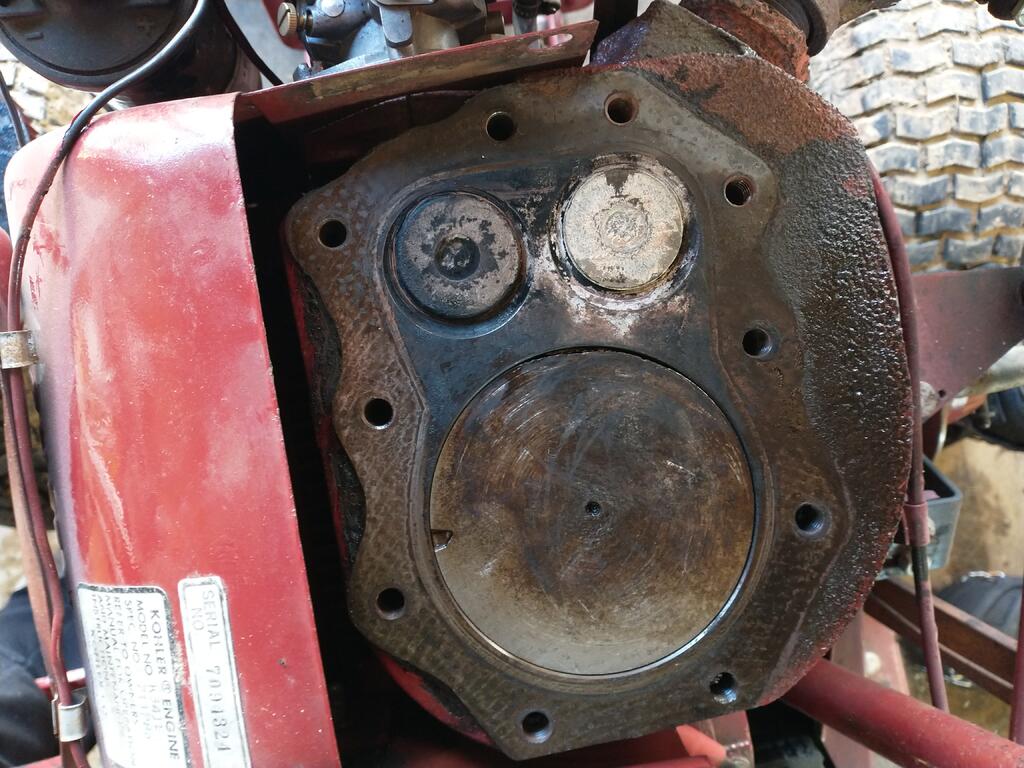

ebinmaine 77,358 #14834 Posted March 6, 2022 I took the cylinder head off the C160 Automatic. That's gonna need a rebuild. Major piston slap... 5 Share this post Link to post Share on other sites
Wheelhorse#1 1,901 #14835 Posted March 6, 2022 2 hours ago, ebinmaine said: I took the cylinder head off the C160 Automatic. That's gonna need a rebuild. Major piston slap... What causes it to break the piston like that what does it hit…the head ?Caused by a worn crank bearing ? 2 Share this post Link to post Share on other sites
ebinmaine 77,358 #14836 Posted March 6, 2022 12 minutes ago, Wheelhorse#1 said: What causes it to break the piston like that what does it hit…the head ?Caused by a worn crank bearing ? This picture was taken after I cleaned a fair amount of carbon out. The "out-of-round" is natural wear. The chipped piston, I believe, is from the carbon breaking it. I don't have reason to believe the crank is worn excessively. 2 Share this post Link to post Share on other sites
kpinnc 17,164 #14837 Posted March 7, 2022 On 3/5/2022 at 6:00 PM, Wheelhorse#1 said: I know a bad word around here😝or drop a Kohler in. Not a bad word. That's what came in it from the factory. 3 Share this post Link to post Share on other sites
19richie66 17,809 #14838 Posted March 7, 2022 @ebinmaine From what I’ve read, the 16hp piston had that notch in the top. Not a chip. Faces the flywheel. 3 Share this post Link to post Share on other sites

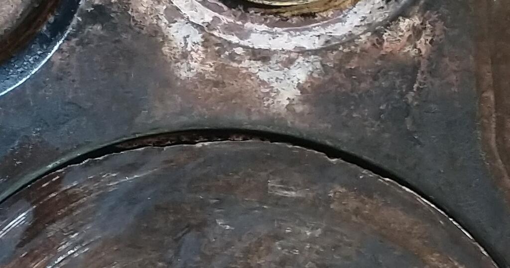

ebinmaine 77,358 #14839 Posted March 7, 2022 7 minutes ago, 19richie66 said: @ebinmaine From what I’ve read, the 16hp piston had that notch in the top. Not a chip. Faces the flywheel. That notch is definitely there but check out this picture. Tough to see without zooming in so I cropped the picture. Look at the gap between the piston and the wall... 2 1 Share this post Link to post Share on other sites

kpinnc 17,164 #14841 Posted March 7, 2022 (edited) 3 hours ago, ebinmaine said: Look at the gap between the piston and the wall... I'm not so sure that's cylinder wall out of round. Looks almost like the piston ground against something and wore down on the lip. Almost like it tried to rock over to one side in the cylinder? Maybe it was grinding some carbon that fell from the head? Or just burned piston. It's on the exhaust side... If the cylinder was that far worn and out of round, I don't think you'd have compression enough to crank it. Not saying the cylinder won't have scoring there, but if it had a visible amount of out of round, it in the very least shouldn't have power at all. Just my opinion. Very possibly wrong... And if you just don't want to deal with it, crate it up and I will take it off your hands... Edited March 7, 2022 by kpinnc 2 Share this post Link to post Share on other sites
kpinnc 17,164 #14842 Posted March 7, 2022 And Eb- I've seen a piston break the whole skirt off and still run for a while. Definitely allows for it to wobble over one way or the other. The more I look at your pic, the more it just looks like a burned piston. Does the cylinder wall have scoring in the same spot? 1 Share this post Link to post Share on other sites
ebinmaine 77,358 #14843 Posted March 7, 2022 8 minutes ago, kpinnc said: And Eb- I've seen a piston break the whole skirt off and still run for a while. Definitely allows for it to wobble over one way or the other. The more I look at your pic, the more it just looks like a burned piston. Does the cylinder wall have scoring in the same spot? I don't actually dare to answer that without taking a look when I get home. Seems to me I remember the cylinder being kind of egg-shaped but it was only on that one side so it most certainly could have been an optical illusion based on colors of grays and blacks and steels. 2 Share this post Link to post Share on other sites
lynnmor 8,629 #14844 Posted March 7, 2022 I suspect that the top ring is knackered. 2 Share this post Link to post Share on other sites
ebinmaine 77,358 #14845 Posted March 7, 2022 6 minutes ago, lynnmor said: I suspect that the top ring is knackered. Given the amount of carbon that was in that area I would tend to agree with you 1 Share this post Link to post Share on other sites
kpinnc 17,164 #14846 Posted March 7, 2022 (edited) 1 hour ago, lynnmor said: suspect that the top ring is knackered. Probably so. My observation didn't change anything from Eb's initial finding. If the piston and rings are damaged, it's likely the cylinder has some problems too. My thoughts were just that if the cylinder is out of round enough to show in a picture, it's likely beyond what .030 bore can fix. That isn't what it looks like to me. I think the end result is the same: definitely time for a rebuild. Only way to tell if it needs a fresh bore is to mic it out. Seems like taper (top to bottom of cylinder travel) was the tightest Kohler spec, with .0005 allowed. That is extremely small. I don't recall the out of round spec. Edited March 7, 2022 by kpinnc 1 Share this post Link to post Share on other sites
ebinmaine 77,358 #14847 Posted March 7, 2022 1 minute ago, kpinnc said: Probably so. My observation didn't change anything from Eb's initial finding. If the piston and rings are damaged, it's likely the cylinder has some problems too. I think the end result is the same: definitely time for a rebuild. Only way to tell if it needs a fresh bore is to mic it out. Seems like taper (top to bottom of cylinder travel) was the tightest Kohler spec, with .0005 allowed. That is extremely small. I don't recall the out of round spec. I haven't tried to stick a feeler gauge on either side of this piston yet but I can assure you it's more than tolerance by at least twice. I have other options to use for power on this tractor and I'm also doing a little local poking around to see what I can come up with for a temporary power plant. 1 Share this post Link to post Share on other sites
