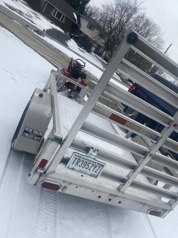

Pullstart 71,336 #14576 Posted February 11, 2022 Finally got to play with my Snowmotractor last night. There’s some work to do, but it moves and the first test run was a success! 7 6 Share this post Link to post Share on other sites
BHunter 1,702 #14577 Posted February 11, 2022 3 minutes ago, Pullstart said: Finally got to play with my Snowmotractor last night. There’s some work to do, but it moves and the first test run was a success! Looks so fun . You are a wild man! That bucking horse almost through you off on that one landing . Congrats on completing your build. It’s very cool. 2 2 1 Share this post Link to post Share on other sites
Ed Kennell 47,480 #14578 Posted February 11, 2022 But, will it plow snow? 2 4 Share this post Link to post Share on other sites
rjg854 13,392 #14579 Posted February 11, 2022 It's not about how fast you plow, it's about how fast you plow well. 2 1 3 Share this post Link to post Share on other sites
Pullstart 71,336 #14580 Posted February 12, 2022 6 hours ago, Ed Kennell said: But, will it plow snow? If it’s grille high? Yep. 1 1 2 Share this post Link to post Share on other sites
Lee1977 7,786 #14581 Posted February 12, 2022 (edited) 16 hours ago, Ed Kennell said: But, will it plow snow? If he gets it geared up it should throw two roster tails of snow. Edited February 12, 2022 by Lee1977 1 1 Share this post Link to post Share on other sites

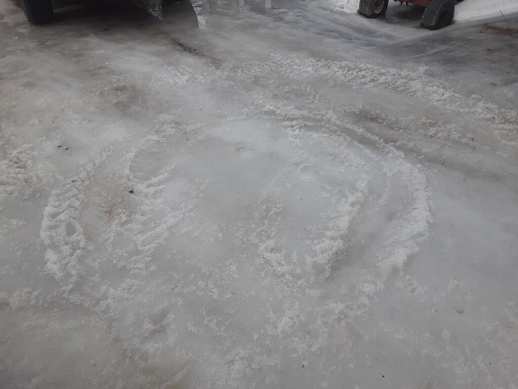

Oldskool 6,678 #14584 Posted February 12, 2022 Well we had a good warm day so took Hiram out for a spin. Using the split brakes and chains a bit to rough up our skating rink of a driveway. 5 5 Share this post Link to post Share on other sites

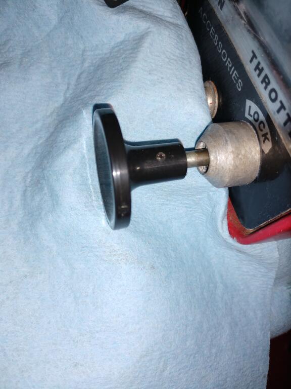

kpinnc 18,995 #14587 Posted February 13, 2022 (edited) I fixed my Bronco's throttle cable. I've changed it several times, but they eventually break loose and get stuck in the lock position. Horror Fright carries a couple different roll pin assortments. Both have 1/16th pins. So I cross drilled the knob though the shaft, and stuck a pin in it. Used small channel locks to press it in. Time will tell, but so far it's great! Edited February 13, 2022 by kpinnc 5 6 Share this post Link to post Share on other sites
Lee1977 7,786 #14588 Posted February 13, 2022 5 hours ago, kpinnc said: I fixed my Bronco's throttle cable. I've changed it several times, but they eventually break loose and get stuck in the lock position. Horror Fright carries a couple different roll pin assortments. Both have 1/16th pins. So I cross drilled the knob though the shaft, and stuck a pin in it. Used small channel locks to press it in. Time will tell, but so far it's great! Looks good you have it fixed unless the plastic nob breaks. I use the choke nob off my Vanguard on my 312. The finish on mine isn't hold up too well might need to paint it. 3 Share this post Link to post Share on other sites
kpinnc 18,995 #14589 Posted February 13, 2022 2 hours ago, Lee1977 said: I use the choke nob off my Vanguard on my 312. Nice! Never thought of that one! 1 Share this post Link to post Share on other sites

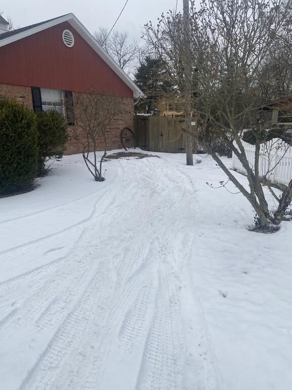

Ifixoldjunk 778 #14590 Posted February 13, 2022 I had to unwillingly beat the snot out of the poor 310 today. Got hit with a surprise 4 inches of snow overnight that landed right on top of my muddy gravel driveway. Last week was a heat wave and the ground didn’t have a chance to solidify. Sucked up more mud and gravel than I wanted too. 3 6 Share this post Link to post Share on other sites

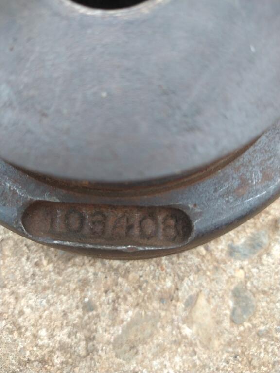

Renrag 69 #14600 Posted February 17, 2022 Well poop changing engine on my B115 the clutch housing got stuck to where I had to beat it off, well it came off, but not unscathed. The part of it where the belt rides half the lip broke off the cast, so idk if it's still usable or not. The drive belt fits really tight, but it's the rubbing and wear it'll cause drive belt is my worry. Anyone that would have a spare clutch housing for my little horsey I would be interested. 4 Share this post Link to post Share on other sites
