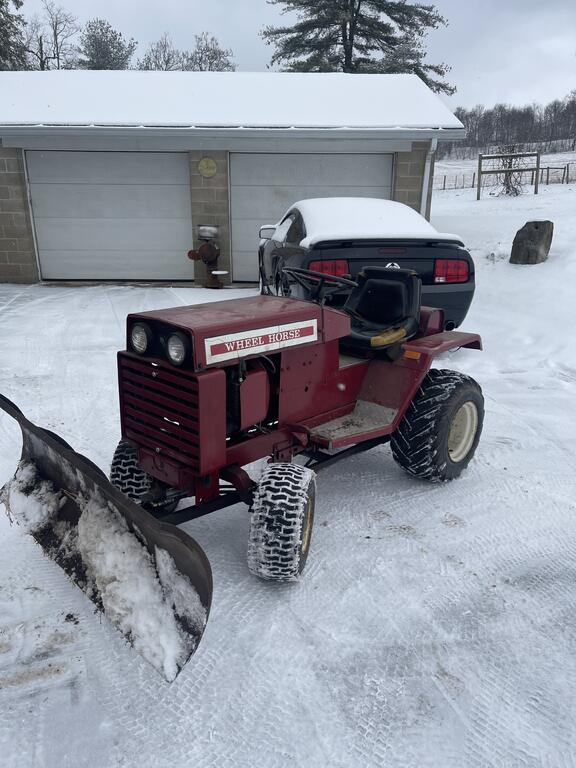

Desko 686 #14553 Posted February 6, 2022 More snow removal! Mostly used the blower on the 416H but I was able to get the D160 and move some snow. Haven't really used the D160 in year's other then snow removal (mainly because engine troubles aka valve seat) but a new replacement block and fresh parts along with a P series electronic ignition conversion has the ol girl running good and going easier on fuel. I might have to find another 48" for the 416 and convert the current 48" on the 416 back over to the D series and mow some lawn with it this summer for the first time in a very long time! 4 11 Share this post Link to post Share on other sites

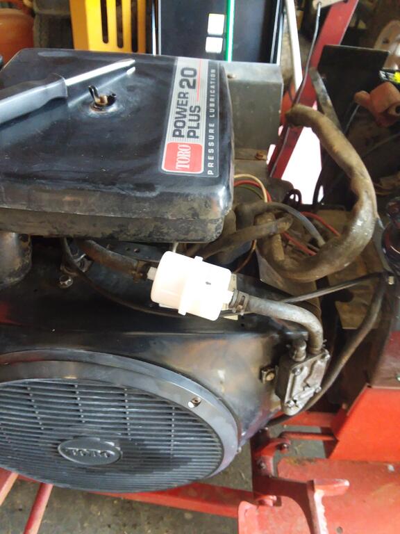

TJ5208 1,841 #14554 Posted February 6, 2022 52 minutes ago, Jeff-C175 said: Duzzit run better now? Cant tell yet i dont know why it wont run without partial choke for a long period of time 17 degrees when i started it cant find its sweet spot it sputters out. 2 Share this post Link to post Share on other sites
ebinmaine 80,811 #14555 Posted February 6, 2022 8 hours ago, TJ Salyers said: Cant tell yet i dont know why it wont run without partial choke for a long period of time 17 degrees when i started it cant find its sweet spot it sputters out. Odds are if you're blocking off air by using the choke you're in need of fuel. Likely the carb needs a cleanup/rebuild. 6 1 Share this post Link to post Share on other sites

peter lena 10,080 #14559 Posted February 6, 2022 @TJ Salyers check out EVIL ENERGY ,FOR FUEL LINE CHECK VALVES , since installing them on my three horses , cold start and operation has practically zero choke needed, get the 5/16 " size , most important is to mount it VERTICALLY , from fuel pump to carb , that will hold the fuel there , without any back flow . your description of cold fuel starvation , is what I also had, that check valve , MOUNTED VERTICALLY , will help you out , like 2 for 10$ , worth it , pete 3 Share this post Link to post Share on other sites

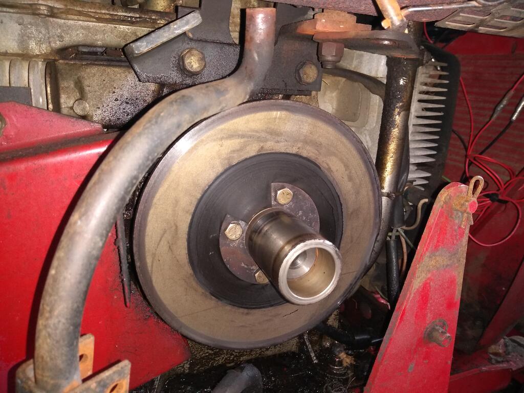

peter lena 10,080 #14560 Posted February 6, 2022 @Chestnut did you service / re grease the pto cone needle bearing ? hi temp grease , easy swipe out , just enough to lightly cover bearing . lubrication opportunity in picture, pete 1 Share this post Link to post Share on other sites

Chestnut 315 #14562 Posted February 6, 2022 1 hour ago, peter lena said: @Chestnut did you service / re grease the pto cone needle bearing ? hi temp grease , easy swipe out , just enough to lightly cover bearing . lubrication opportunity in picture, pete I did grease the bearings. Found a good Youtube video for the replacement before I did it. 3 Share this post Link to post Share on other sites

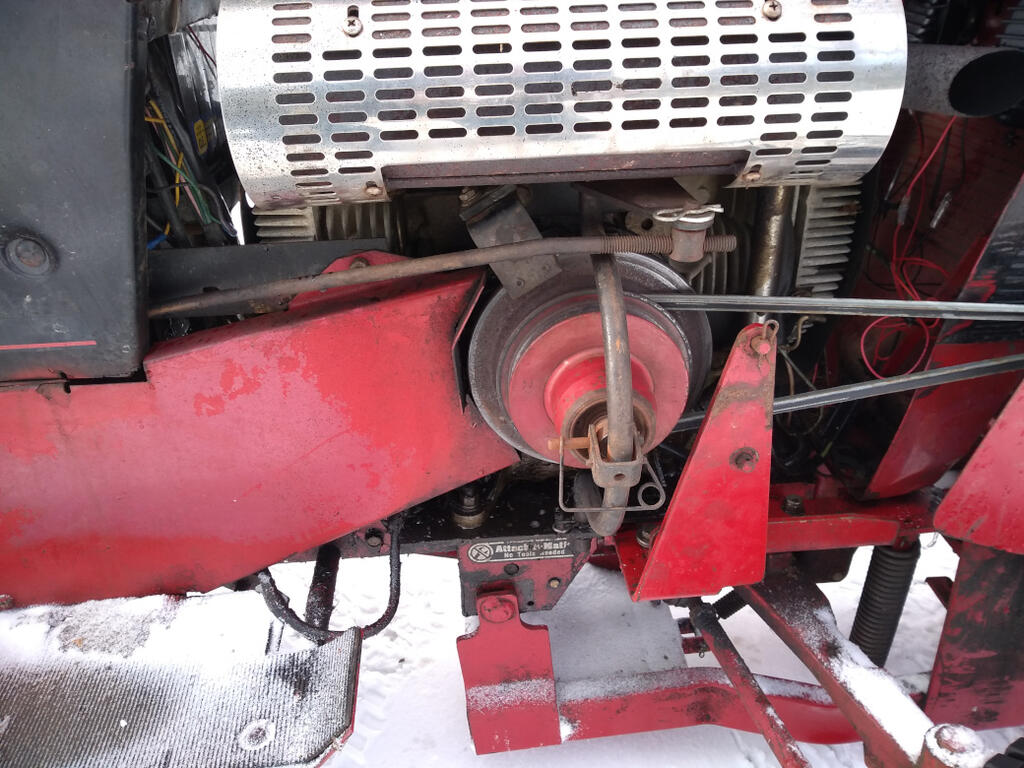

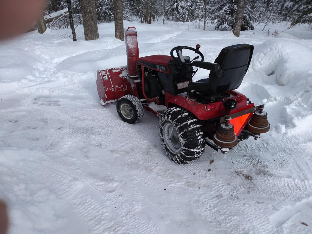

Chestnut 315 #14563 Posted February 6, 2022 As noted above I did get back to finish installing the PTO disc on the snowblower 520H. Went pretty smooth all in all. Greased the needle bearings as noted above as well. Cleared some of the walking path around my mother in law's house but left some for tomorrow as well. It's supposed to warm up for a day or two. I took a few pictures of the weight /reflector bracket I added last summer. The weight the PO had on it wasn't enough and really didn't work well, so I made up something different. Seems to. be enough weight for what I'm doing, but I may add a bit more. 6 6 Share this post Link to post Share on other sites

JCM 11,417 #14565 Posted February 6, 2022 (edited) @Chestnut FYI Blower belt should be on the outside groove of your PTO pulley. Inner groove for tiller and mower. Edited February 6, 2022 by JCM 4 Share this post Link to post Share on other sites
Chestnut 315 #14566 Posted February 6, 2022 38 minutes ago, JCM said: @Chestnut FYI Blower belt should be on the outside groove of your PTO pulley. Inner groove for tiller and mower. Thanks for the tip. I was wondering about that. I pulled the belt off the other day and I thought it was on the inner groove but I wasn't sure when I went back. Alignment looked a little off when I looked. I can easily correct when I go back. 3 Share this post Link to post Share on other sites

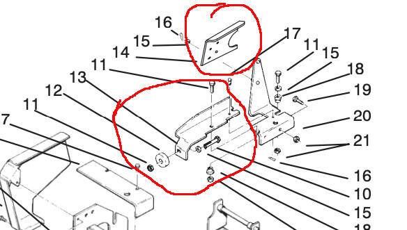

Ed Kennell 47,480 #14567 Posted February 6, 2022 1 hour ago, Chestnut said: 1 hour ago, Chestnut said: Pardon my ignorance, but what is that bracket forward of the PTO? 2 Share this post Link to post Share on other sites
lynnmor 9,042 #14568 Posted February 6, 2022 1 hour ago, Chestnut said: As noted above I did get back to finish installing the PTO disc on the snowblower 520H. See that rust on the pin? Put a drop of oil on the pins and the hoop ends. See that wear on the end of the bell? I have seen that a number of times, it comes from failed pins or the clip on the shaft. While you have the oil can out, put a drop of oil on the governor shaft on the opposite side of the engine. Ed, that bracket is for the belt guard that is missing. 2 1 Share this post Link to post Share on other sites
Ed Kennell 47,480 #14569 Posted February 6, 2022 Thanks Lynn, all my antiques are guardless. 2 Share this post Link to post Share on other sites
Chestnut 315 #14570 Posted February 6, 2022 7 minutes ago, lynnmor said: See that rust on the pin? Put a drop of oil on the pins and the hoop ends. See that wear on the end of the bell? I have seen that a number of times, it comes from failed pins or the clip on the shaft. While you have the oil can out, put a drop of oil on the governor shaft on the opposite side of the engine. Ed, that bracket is for the belt guard that is missing. Thanks for the info. I'll get the oil out. I was also wondering what the bracket is. There's another bracket that bolts through that one and runs forward and has a bearing on it. Not sure what that one's for either.The tractor came with a tiller and 60 inch mower deck which I've never installed. I had to loosen the bracket you see and remove the other one to get the clutch off. I thought for a minute I'd just leave them off, but decided to reinstall just so they wouldn't disappear before spring when I open the lean-to where the mower and tiller are stored. Just a comment - it's a pretty substantial bracket for a belt guard, but I guess that's the way they made them. 1 Share this post Link to post Share on other sites
lynnmor 9,042 #14571 Posted February 6, 2022 14 minutes ago, Chestnut said: Thanks for the info. I'll get the oil out. I was also wondering what the bracket is. There's another bracket that bolts through that one and runs forward and has a bearing on it. Not sure what that one's for either.The tractor came with a tiller and 60 inch mower deck which I've never installed. I had to loosen the bracket you see and remove the other one to get the clutch off. I thought for a minute I'd just leave them off, but decided to reinstall just so they wouldn't disappear before spring when I open the lean-to where the mower and tiller are stored. Just a comment - it's a pretty substantial bracket for a belt guard, but I guess that's the way they made them. Simply download the owners manual for the snowblower. The other bracket has a round piece on it that is not a bearing, it controls side to side movement. 1 Share this post Link to post Share on other sites
JCM 11,417 #14572 Posted February 6, 2022 The bracket guard which you have also has a belt guard # 117552-01 that's missing that attaches with 2 hairpins. 1 Share this post Link to post Share on other sites
Chestnut 315 #14573 Posted February 7, 2022 1 hour ago, lynnmor said: Simply download the owners manual for the snowblower. The other bracket has a round piece on it that is not a bearing, it controls side to side movement. 1 hour ago, JCM said: The bracket guard which you have also has a belt guard # 117552-01 that's missing that attaches with 2 hairpins. Both correct. I'll look at the anti-sway bracket tomorrow. It's installed as pictured, but it didn't seem to be located in a position that would stop any kind of side to side movement. I'll also have to look in the bucket of spares to see whether the belt guard is in there. Unfortunately it's in a spot that won't be easily accessed until the snow melts. 2 Share this post Link to post Share on other sites
