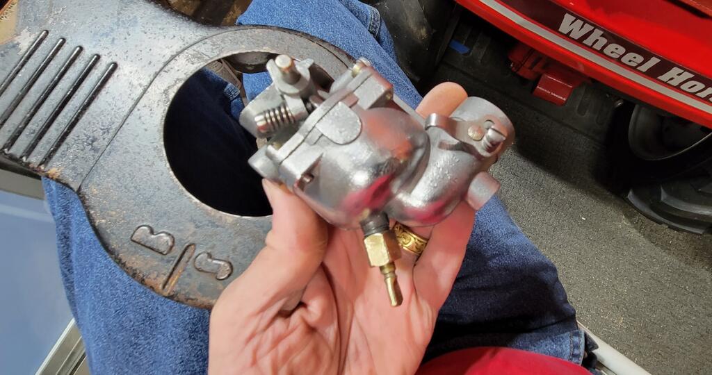

AMC RULES 37,260 #14232 Posted January 11, 2022 Rebuild kit for the Walk-Aways carburetor finally showed up in the mail today. 3 4 Share this post Link to post Share on other sites
Maxwell-8 4,371 #14233 Posted January 11, 2022 1 hour ago, Lee1977 said: Maxwell what is the engine pulley size. I guess it to be 6". It is 4" but the centrifucal pto is big. So I will be running a 1:1. Durability wise, the limit I feel comfortable with. Knowing my engine doesn't rev to 3600rpm. 1 Share this post Link to post Share on other sites
ebinmaine 80,841 #14234 Posted January 11, 2022 28 minutes ago, AMC RULES said: Rebuild kit for the Walk-Aways carburetor finally showed up in the mail today. Nice work Sir! 2 Share this post Link to post Share on other sites

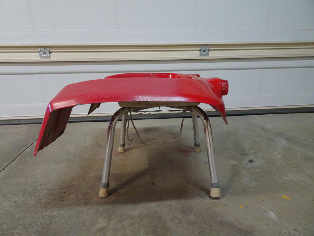

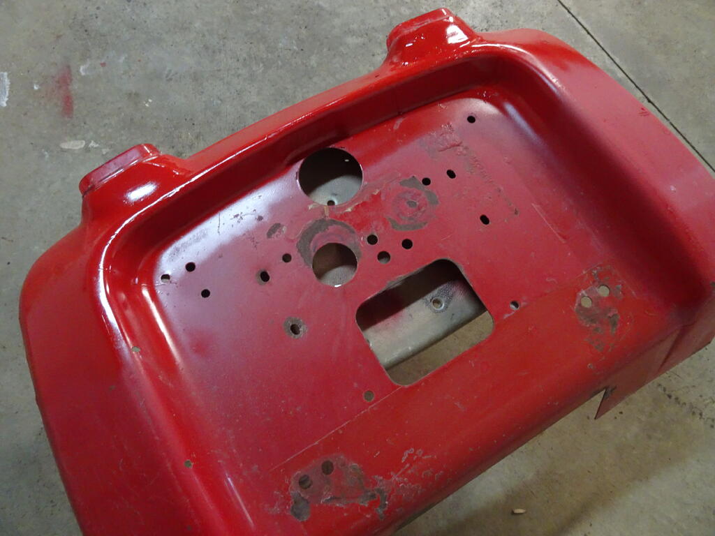

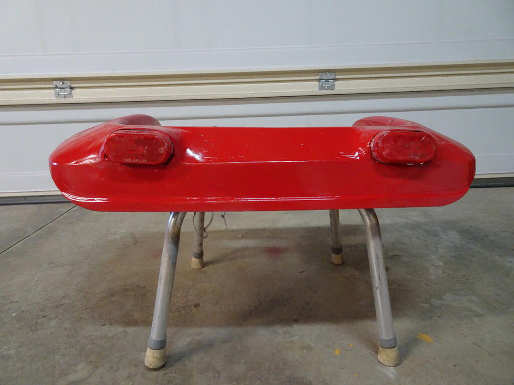

giddyap 1,574 #14235 Posted January 11, 2022 (edited) I honestly don't know if I like my custom tail lights. Much work remains Continued on post # 14235 Edited January 15, 2022 by giddyap update 5 4 Share this post Link to post Share on other sites
Snoopy11 5,731 #14236 Posted January 11, 2022 1 minute ago, giddyap said: I honestly don't know if I like my custom tail lights. Much work remains I LIKE THEM!!! Don 1 1 Share this post Link to post Share on other sites
peter lena 10,081 #14237 Posted January 11, 2022 @AMC RULES great opportunity , only if you want to , put a fuel check valve , VERTICALLY IN PLACE , just after fuel pump discharge and to carb intake , always a ready charge of fuel held in place , tell me how it quick starts , pete 1 Share this post Link to post Share on other sites
peter lena 10,081 #14238 Posted January 11, 2022 @giddyap are those LED ? have those on my 3 horses , Walmart , make sure you increase / enhance the grounding to those , nice and bright , pete 1 1 Share this post Link to post Share on other sites
kpinnc 19,000 #14239 Posted January 11, 2022 35 minutes ago, giddyap said: I honestly don't know if I like my custom tail lights. Much work remains Looks good to me! 1 Share this post Link to post Share on other sites

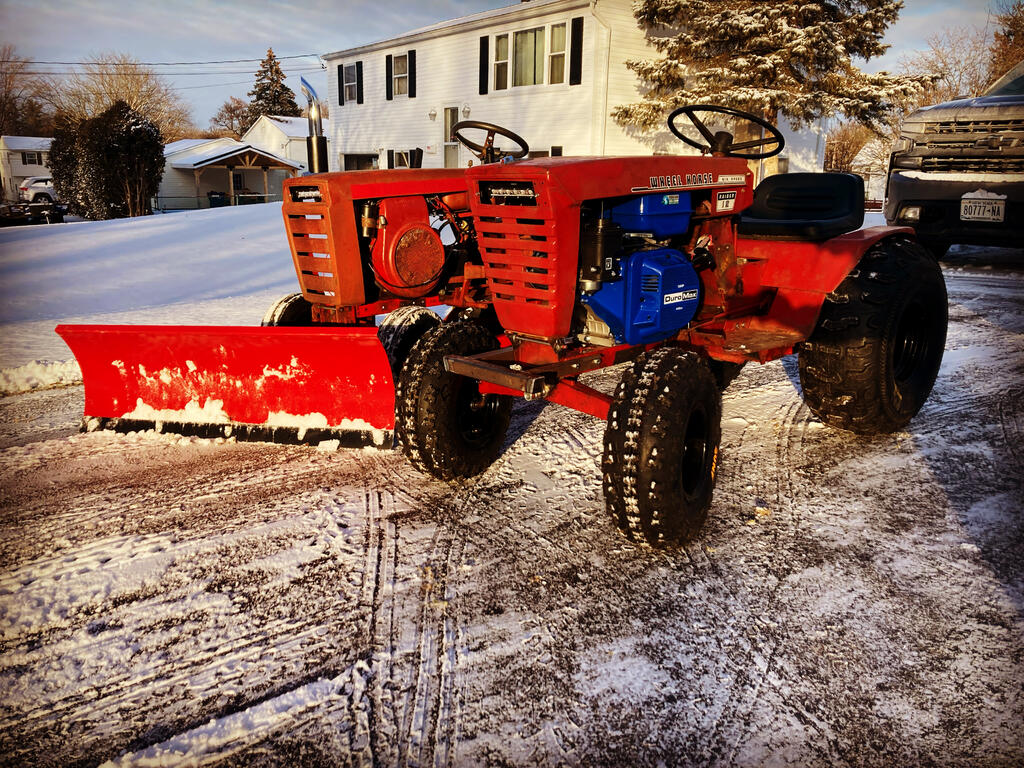

Crazy_Carl 254 #14241 Posted January 11, 2022 Took the C-100 and the Raider 12 out for some fun in the snow and snapped a picture while the lighting was good 5 9 Share this post Link to post Share on other sites
