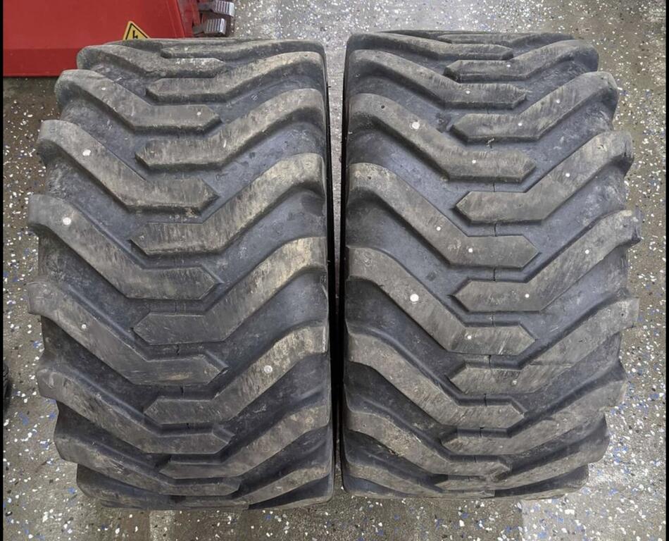

Bens vintage tractors 1,556 #13332 Posted October 26, 2021 Picked up some 26-12-12s for my b-160 build! 3 2 Share this post Link to post Share on other sites
ebinmaine 80,856 #13333 Posted October 26, 2021 7 hours ago, Pullstart said: Rylee and I had to determine the best performers in snow. Last winter, we learned that fatties don’t work well in the white stuff… no matter how cool they look! I run 23 x 10.50s on Cinnamon Horse. Filled. Weighted. Me. That's. Heavy. 3 hours ago, Bens vintage tractors said: Picked up some 26-12-12s for my b-160 build! Very cool. How will you go about moving the fender to add clearance? 2 1 Share this post Link to post Share on other sites
Lee1977 7,793 #13334 Posted October 26, 2021 2 hours ago, ebinmaine said: I run 23 x 10.50s on Cinnamon Horse. Filled. Weighted. Me. That's. Heavy. Very cool. How will you go about moving the fender to add clearance? All depends on what model tractor you have, The 1976 and later models you put a spacer under the fender bracket. then you will need spacers under the seat mounts. If you have a clearance problem it will be at the footrest. I had to bend mine for the 25 x 900 x 12 on my 312-8.as the uprights are not bolted to anything. 2 2 1 Share this post Link to post Share on other sites
Gregor 4,848 #13335 Posted October 26, 2021 30 minutes ago, Lee1977 said: put a spacer under the fender bracket. Wondering what, if anything, that does to your fuel tank spout. 2 Share this post Link to post Share on other sites
Pullstart 71,350 #13336 Posted October 26, 2021 6 hours ago, Bens vintage tractors said: Picked up some 26-12-12s for my b-160 build! Awesome! “Poppy” my 552 has those, they sure do roll over the big stuff well! 3 1 Share this post Link to post Share on other sites
Lee1977 7,793 #13337 Posted October 26, 2021 (edited) 23 minutes ago, Gregor said: Wondering what, if anything, that does to your fuel tank spout. By putting it under the fender bracket it raises the fuel tank also. I put a 1/8" across and spacers raising the seat and fuel tan bracket also. I inch would have cleared, but I also braced my receiver hitch off the top of the transmission I raised 1 3/4". Edited October 26, 2021 by Lee1977 4 Share this post Link to post Share on other sites
kpinnc 19,002 #13338 Posted October 26, 2021 These are 25s, with no raiser anywhere. So if you do have to add a little spacing, it should in fact be very little. On several of my tractors, I've had to put small (1/2 inch) blocks under the tank at the back under the transmission supports to keep the filler cap up, and that is with no spacing of any kind, just to make filling up easier. 1 Share this post Link to post Share on other sites
Maxwell-8 4,371 #13339 Posted October 26, 2021 On 12 inch wide, you will most likely hit the fueltank sideways or the brake, spacer will then be needed or making the stock rims wider. Share this post Link to post Share on other sites

Bens vintage tractors 1,556 #13344 Posted October 26, 2021 8 hours ago, ebinmaine said: Very cool. How will you go about moving the fender to add clearance? I usually make some small spacers that just lift the fender up an inch or 2.. I’ve fit 27s on a wheel horse before lol. 1 Share this post Link to post Share on other sites
kpinnc 19,002 #13345 Posted October 26, 2021 2 minutes ago, Bens vintage tractors said: I usually make some small spacers that just lift the fender up an inch or 2.. I’ve fit 27s on a wheel horse before lol. I can't wait for pics of this machine! 1 Share this post Link to post Share on other sites
Bens vintage tractors 1,556 #13346 Posted October 26, 2021 1 minute ago, kpinnc said: I can't wait for pics of this machine! 6 hours ago, Lee1977 said: you have a clearance problem it will be at the footrest. 1 inch fender lift and bent the foot boards out just a tiny bit to clear 27s 3 2 Share this post Link to post Share on other sites
Bens vintage tractors 1,556 #13347 Posted October 26, 2021 3 hours ago, Maxwell-8 said: On 12 inch wide, you will most likely hit the fueltank sideways or the brake, spacer will then be needed or making the stock rims wider. I’m putting them on a b series so I don’t have to worry about the tank.. however I do have some spacers kicking around if need be 1 Share this post Link to post Share on other sites
Thor27 892 #13348 Posted October 26, 2021 10 hours ago, Gregor said: Wondering what, if anything, that does to your fuel tank spout. I raised my fender 3/4" found out I couldn't get the cap off. I carefully enlarged the hole 1/4 all around with a drum sander. For those that raise the tank and all, what do you do to the rear lift cable? Share this post Link to post Share on other sites

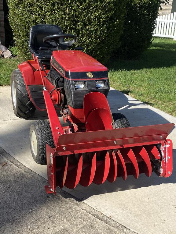

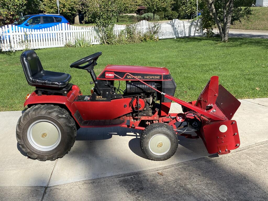

Lane Ranger 12,131 #13350 Posted October 26, 2021 Put my 42 inch snowblower on my 314 50th Anniversary Wheel Horse hydro tractor with hydro lift today. This snowblower I bought two years ago and used once on my 314-8. I think it is a 1985 so maybe 36 years old but I think it just looks like new. Operates great but I am putting a new belt on it . This will be my first time using a hydro in winter so I hear you have to warm up tractor some in cold weather to get transmission fluid warmed and flowing good. I would like to hear any tips you folks that use a snowblower on a Wheel Horse hydro might have as this will be my first time! I used my old 1967 Lawn Ranger with snowblower for years but I sold her in 2020. Lots of old videos on here using that equipment. It was always fun! 5 Share this post Link to post Share on other sites
