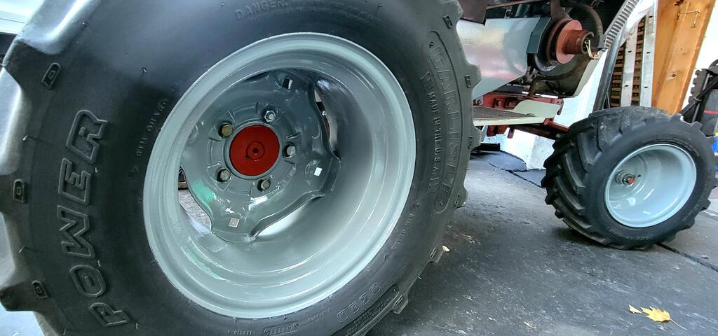

AMC RULES 37,259 #13252 Posted October 21, 2021 You improvise when the color you're looking for is unobtainable. 5 Share this post Link to post Share on other sites
19richie66 17,935 #13253 Posted October 21, 2021 22 minutes ago, AMC RULES said: You improvise when the color you're looking for is unobtainable. Walmart paint shelves are bare. Not much better in Lowes. Looks good though! 1 Share this post Link to post Share on other sites
AMC RULES 37,259 #13254 Posted October 21, 2021 Silver aluminum base with a grey primer topcoat and finished with a gloss clear coat. 2 Share this post Link to post Share on other sites

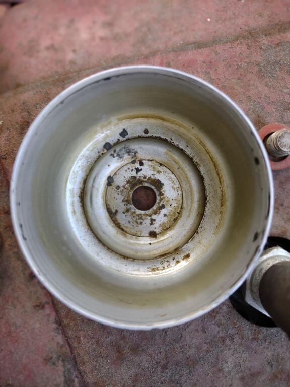

8ntruck 9,296 #13255 Posted October 21, 2021 Tinkered with my C195 this afternoon. I installed the new hydraulic unit drive belt clutch linkage bits and pieces that have been sitting on my bench for about a month. The clutch now latches in the off position. Having this layer of interlock operational increases my trust level in this machine. It is one more thing to insure that the Horse won't run off on its own when I start it. Tackled the fuel system next. Last time I used the tractor, it seemed to be running rich. I found the choke linkage was bound up, not letting the choke open all the way. The last time I ran the tractor, it ran better when the fuel pump was off, so the plan was to check the fuel pump, and float valve operation. While checking the fuel pump, I discovered that the gas tank was empty - KT19 is a hungry beast. At this point, it would fire on carb cleaner, but not run. Off with the carb and to the bench to open it up. Lots of crud in the bowl and lots of crud around the float valve. The float valve did not follow the float by gravity. Pulled the float valve seat and found it mostly clogged with some sort of goo. The carb is in pieces ready for cleaning. Got to come up with a rebuild kit. I did notice that there is a freeze pug just below the idle needle. Should I chase down a replacement plug so I can remove the one in the carb to make sure everything under it is clean? 2 Share this post Link to post Share on other sites
Handy Don 17,474 #13256 Posted October 21, 2021 7 minutes ago, 8ntruck said: .... I did notice that there is a freeze pug just below the idle needle. Should I chase down a replacement plug so I can remove the one in the carb to make sure everything under it is clean? I can only speak to the Onan twins and their carb Welch Plug removal is essential. Important passageways behind. But have the replacement on hand (and know how to install the new one! 1 Share this post Link to post Share on other sites
ebinmaine 80,694 #13257 Posted October 21, 2021 1 hour ago, 8ntruck said: Should I chase down a replacement plug so I can remove the one in the carb to make sure everything under it is clean Fair chance it could be in the carb kit. 57 minutes ago, Handy Don said: I can only speak to the Onan twins and their carb Welch Plug removal is essential. Important passageways behind. But have the replacement on hand (and know how to install the new one! This past weekend was the first time I'd ever taken a welch plug out. The Briggs carb on the big splitter was some grungy. On a Kohler carb I've always left the plugs in. I have and to clean em twice occasionally. 1 Share this post Link to post Share on other sites

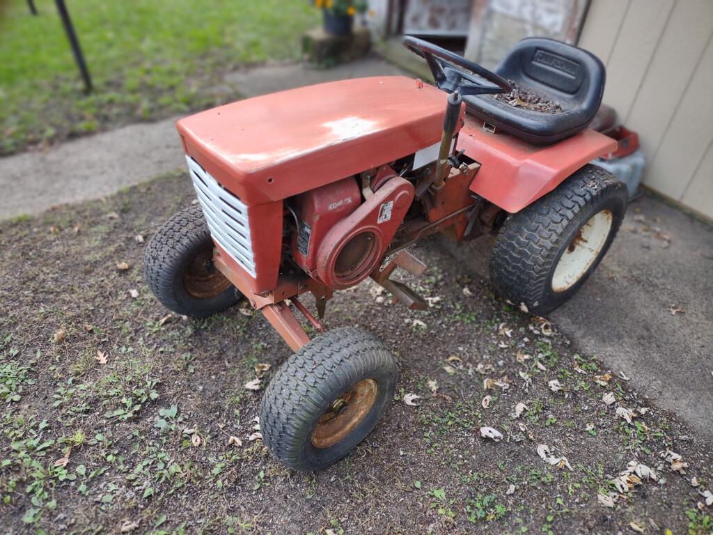

WHX?? 58,114 #13260 Posted October 22, 2021 (edited) Dan @Achto.... what about ole pale face here now.... I'm jonesin. ... I was gonna ship it off to the glue factory that's why I give it to you! Did you find the gas tank strap? We want all the details! Edited October 22, 2021 by WHX?? 1 1 Share this post Link to post Share on other sites

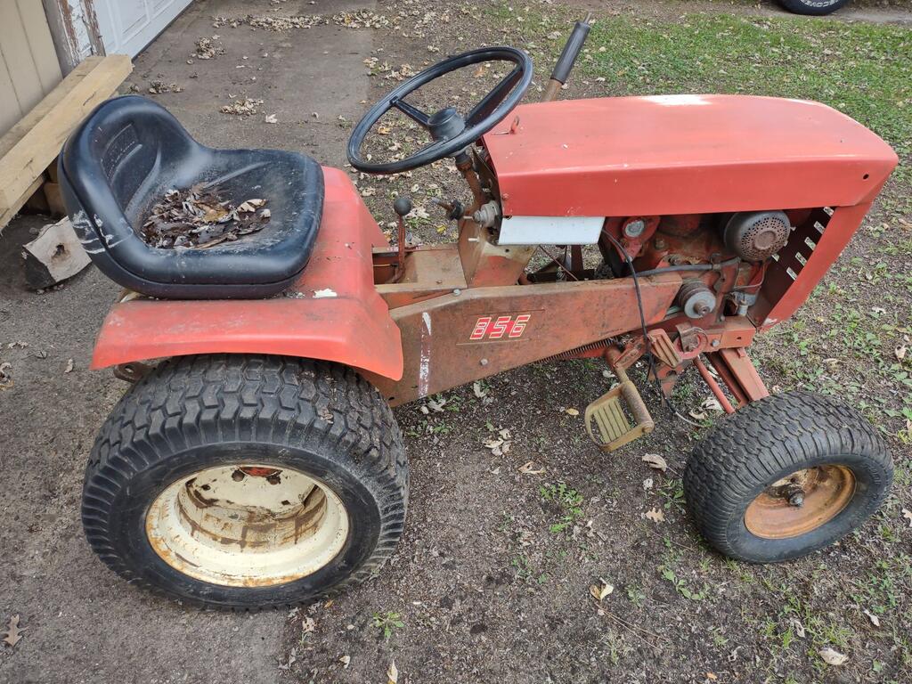

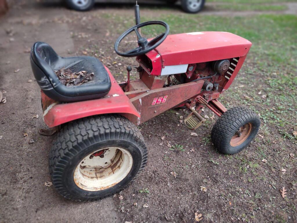

Achto 32,685 #13261 Posted October 22, 2021 Spent a little time with the newest member of my herd over the last couple of days. "Pale Face" as @WHX?? calls him showed up as a non-runner with a few pieces missing, most of the pieces were included with him though. Yesterday I spent some time getting the steering wheel off, installing a dash and getting the cables to move. The throttle cable had to be replaced but the choke cable was savable. Tonight I pulled the bowl off from the carb and was happy to see that it was relatively clean. After seeing this I checked the vitals, performed some field triage, and hooked up an IV bottle. I'm happy to report that the engine purrs like a kitten. I still need to flush the gas tank, replace the petcock, and finish running new fuel line. Tomorrows project. Then I can shake down the rest of the tractor. No boot on the shifter so I can imagine that the inside of the tranny will be a hot mess. 8 1 Share this post Link to post Share on other sites
WHX?? 58,114 #13262 Posted October 22, 2021 Saaaweet. . Yah tranny might need some love. She was sittin outside at my place much to my displeasure but what's a guy gonna do when he runs out of stalls? . Had pretty good luck getting all the horses running out of that score. 2 Share this post Link to post Share on other sites

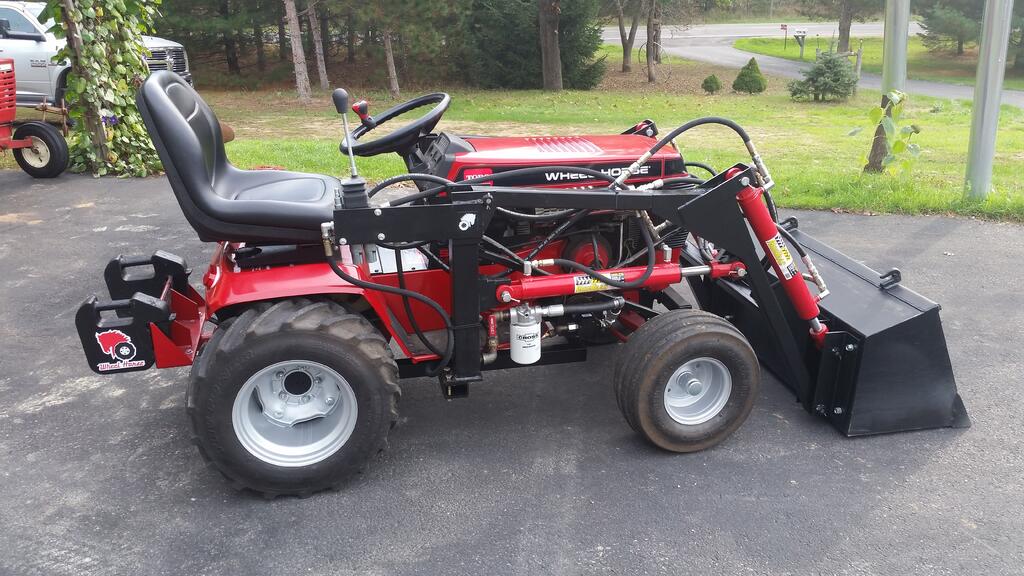

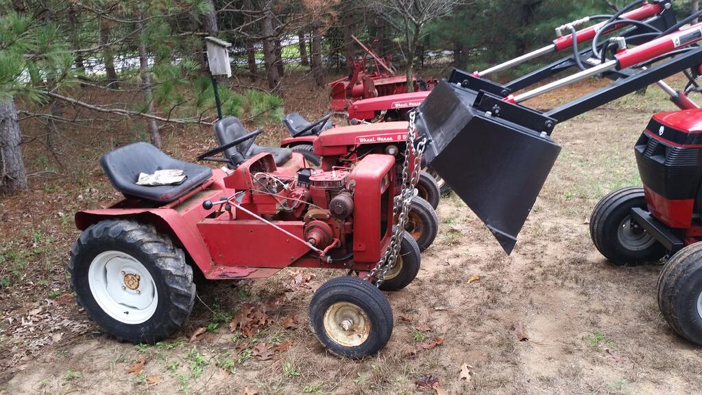

WHX?? 58,114 #13263 Posted October 22, 2021 (edited) Moved some tractors, implements & engines around with the FEL tonite . My Lord how did I get along without this tractor. My back thanks it. Now all I have to do is get someone to hook and unhook for me so I never have to get off the tractor! Got some light duty forks ordered for it but on the slow boat I guess. Be nice to stack decks & motors on a pallet and pick the whole thing up. After giving it several workouts @cschannuth she does not like to back up hills with the weights we have on her despite the loaded tires. She has a tendency to dig. All soft sand around her tho and cursed to live on a hill. Forwards not much of a problem. Building a ballast box/chain box for her see out that helps. Edited October 22, 2021 by WHX?? 1 9 Share this post Link to post Share on other sites
ebinmaine 80,694 #13264 Posted October 22, 2021 34 minutes ago, WHX?? said: Forwards not much of a problem. Building a ballast box/chain box for her see out that helps You get 300 or 400 lbs back there and it'll be a tad bit betterer. 1 Share this post Link to post Share on other sites
cschannuth 3,821 #13265 Posted October 22, 2021 2 hours ago, WHX?? said: Forwards not much of a problem. Building a ballast box/chain box for her see out that helps. When I had all seven suitcase weights on there it always did really well so I think once you get some more weight back there you’ll be in good shape. Of course, my 250 pounds sitting on the seat probably didn’t hurt anything either, ha ha. 1 1 3 Share this post Link to post Share on other sites

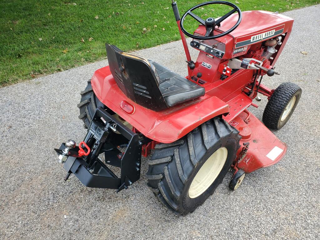

cblessj 88 #13267 Posted October 22, 2021 Installed a Johnny Products Uni-Sleeve on my 1968 Raider 12. Bought it for another tractor but decided to sell the other tractor and bought my Raider. I fabbed up the bracket for the switch and the hitch adapter myself. Also had to modify it slightly (had to cut notches at the top) to clear the seat/fenders when its open. 3 10 Share this post Link to post Share on other sites

jtrosp1980 89 #13270 Posted October 22, 2021 Looks sharp 1 Share this post Link to post Share on other sites
