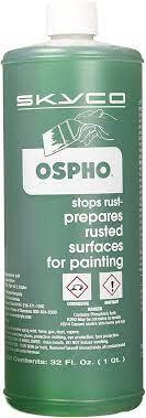

953 nut 68,157 #13206 Posted October 19, 2021 11 hours ago, adsm08 said: muriatic acid mix to wash the rust off the donor metal, which is used in a lot of rust converters Phosphoric acid is used in most rust converters. Share this post Link to post Share on other sites

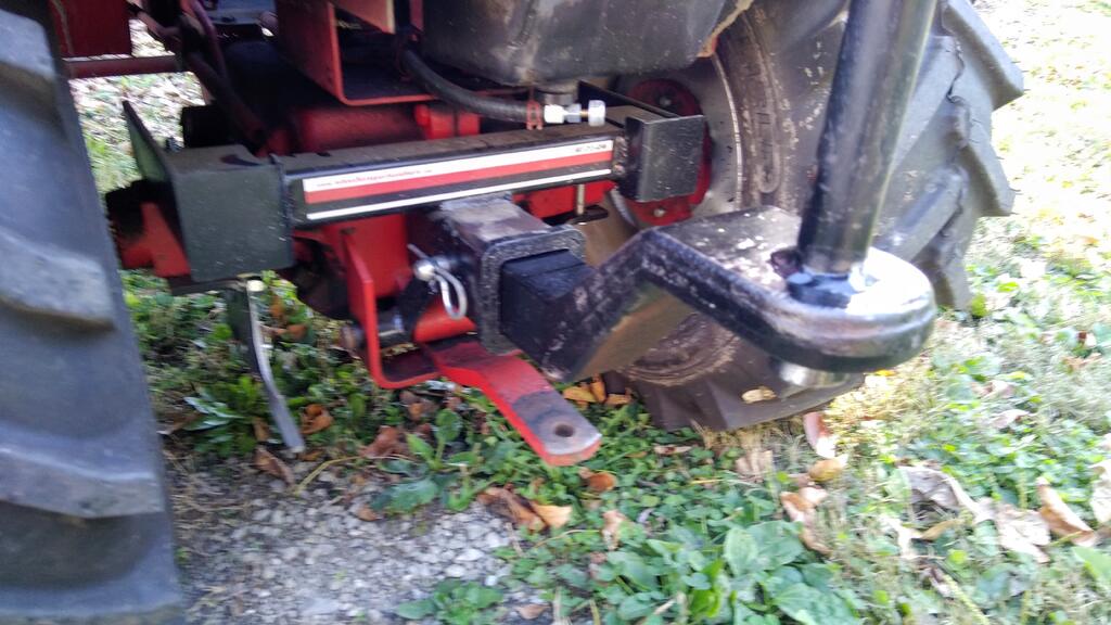

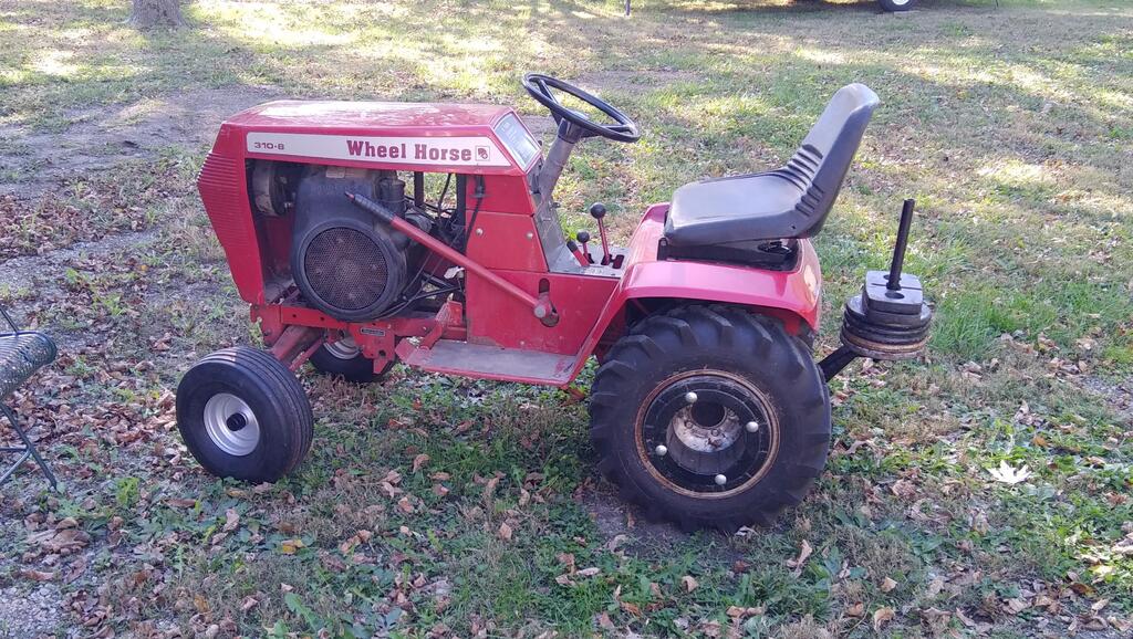

RandyLittrell 3,944 #13208 Posted October 19, 2021 Finally got my new shoes and repainted wheels back on my 310, just need to paint the rear wheels and a wash and wax and she will look new again! New spindle caps too. I made a weight rack from an old cast steel receiver hitch, had to drill a new hole for the pin and weld some tubing on to hold the weights. Just the hitch weighs a good 15 pounds, it's heavy. I have more weight at home I need to round up yet and get the blade mounted. 9 1 Share this post Link to post Share on other sites
adsm08 4,903 #13209 Posted October 20, 2021 11 hours ago, 953 nut said: Phosphoric acid is used in most rust converters. Years ago muriatic acid (hydrocloric acid) was used for acid washing rust, similar to vinegar. Phosphoric acid was also commonly used in rust converters to create iron phosphate. The green movement has push a switch by many companies to citric acid, which performs a similar function, but does not seem to work as well in my experience. 1 Share this post Link to post Share on other sites

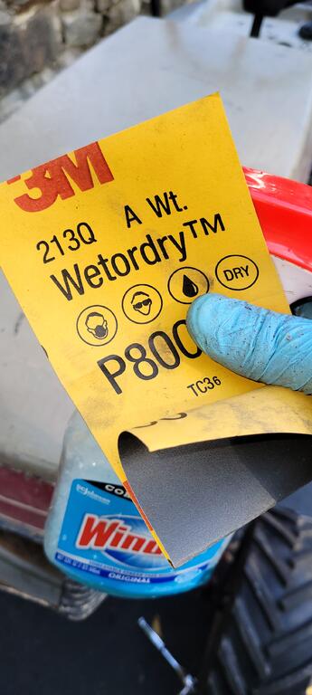

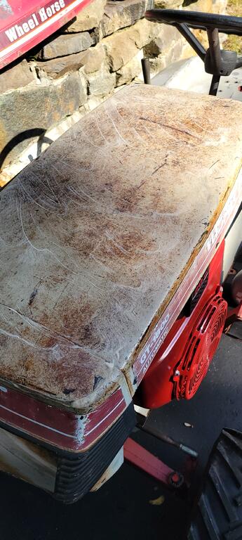

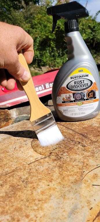

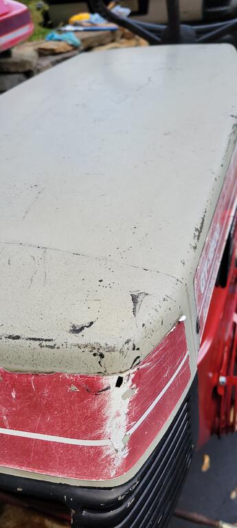

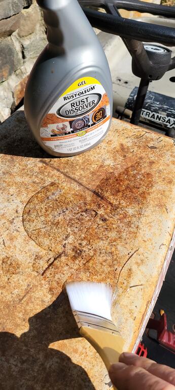

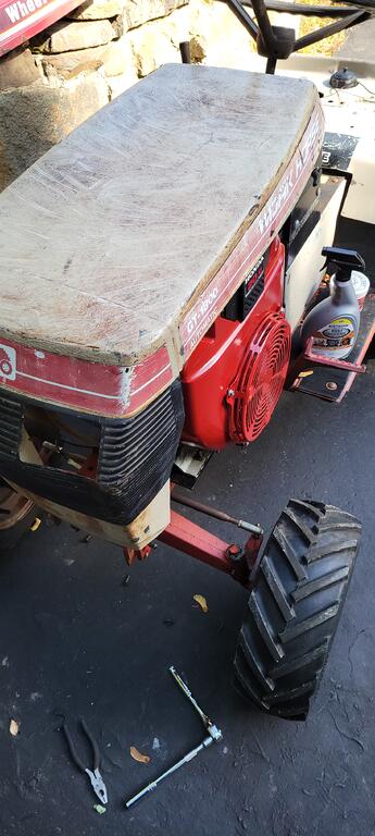

AMC RULES 37,259 #13210 Posted October 20, 2021 Had good results using this stuff. Found on the shelf a Wal-Mart. Pushed a good sized puddle of the gel... all over the rusted area, just keeping it wet with product for 20 or so minutes. Wiped the product off, then finished it with a quick wet sanding with 800 grit. Pretty pleased with my half hours worth putzing around. 8 6 1 Share this post Link to post Share on other sites

kpinnc 18,853 #13213 Posted October 20, 2021 1 hour ago, AMC RULES said: Pretty pleased with my half hours worth putzing around. Rusty or not, that tractor is awesome! 2 Share this post Link to post Share on other sites

Ifixoldjunk 778 #13216 Posted October 20, 2021 @RandyLittrell Ive built something similar in the past. Just some tubing and a chunk of flat bar and I can mount a 12in weight to the bagger mounts. 5 1 Share this post Link to post Share on other sites

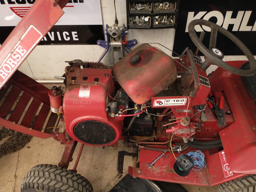

squonk 47,734 #13217 Posted October 20, 2021 (edited) Carb off for a cleaning. Had to rewire the C-160 I just got. The only wire in the correct location on the switch was the start wire to the solenoid. Someone managed to connect it so it still worked but we're overly generous with the wire nuts Edited October 20, 2021 by squonk 8 2 Share this post Link to post Share on other sites

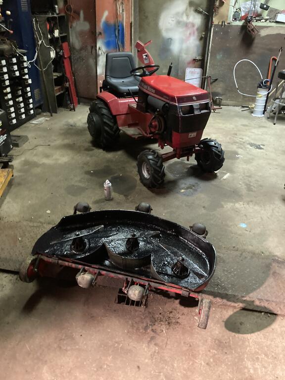

Ifixoldjunk 778 #13218 Posted October 20, 2021 (edited) just finished winterizing my deck. Probably won’t use it again this season. When do y’all think it’s time to start hooking up the blowers? Probably a bit early now. I usually wait until the first frost or so. I used a paint brush and some near vintage mystery transmission fluid to coat the underside of the deck. I’m always amazed how little rust is on it, I’d like to keep it that way😅 Edited October 20, 2021 by Ifixoldjunk 4 1 Share this post Link to post Share on other sites
953 nut 68,157 #13219 Posted October 20, 2021 23 hours ago, adsm08 said: muriatic acid (hydrocloric acid) was used for acid washing rust Yes, but it will flash to rust as soon as it is rinsed off. Rust converters will leave a rust preventive coating. 2 Share this post Link to post Share on other sites

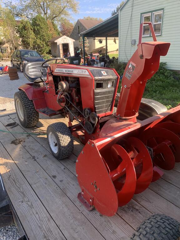

CB520HC 61 #13221 Posted October 21, 2021 Well finally installed my 44" 2 stage blower on one of my tractors hood came off due to fitment issues just sitting on the tractor for the pic everything works belt guard is off as well but id love to see if ohio will allow me to use this this winter. love to hear the k341 dig in. 8 1 Share this post Link to post Share on other sites

kpinnc 18,853 #13223 Posted October 21, 2021 2 minutes ago, CB520HC said: id love to see if ohio will allow me to use this this winter. love to hear the k341 dig in. Can't use a snow thrower in your state? Not being smarty pants at all- just surprised by that comment. Have no use for one here, not for the past 10 years anyway. 2 Share this post Link to post Share on other sites
Jeff-C175 7,209 #13224 Posted October 21, 2021 9 minutes ago, CB520HC said: see if ohio will allow me to use this this winter Yeah, I would also like to hear more about the reason you think the state would not let you use it! Boy, talk about big bother! Share this post Link to post Share on other sites
CB520HC 61 #13225 Posted October 21, 2021 I can just last couple years haven't had enough snow to really be worth it also have a gravel driveway. I use the 520hc with 56 blade to push the snow planning on using this if i start running out of room to stack the snow. 4 Share this post Link to post Share on other sites
