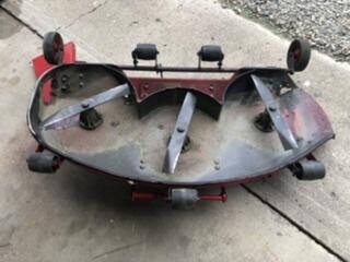

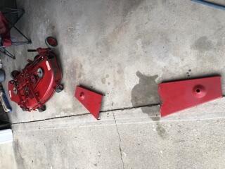

WheelPuke 78 #12660 Posted September 3, 2021 I mowed with the 414-8 then aired it off clean. After a bit of thought I started to do the deck treatment @peter lena does. I was going to do the deck, service and store it. From there my plan is to clean the tractor and service it then outfit it for winter after making some quick repairs. I hadn’t cleaned the deck since the start of the season other than blowing off the build up I could see through the chute or rust holes. It was a whopping mess. Several hours later and a cleaning with some kerosine I have to still finish the underside of the deck. From there I’ll need to do some repairs. I noticed a few issues with the deck. Missing bolts, loose bolts, and a bent rod and a heavily worn belt. After I cleaned the outside with kerosine I noticed it was cracked where the rear mounting hardware is bolted to the deck pan. I still have to do the oil treatment to the paint. For now though I’m calling it a day. 6 2 Share this post Link to post Share on other sites

peter lena 10,065 #12664 Posted September 4, 2021 @WheelPuke , good for you ! glad to see you getting after it , when I started getting after my decks , it was a catch up and a refresh to save them , once you scrape / clean and lubricate and get that hot sun dry out , you can really see how you have stopped the grunge / rot cycle. from then on its maintaining that state . just did a quick deck drop ,on one , little to no light cleaning , oil soak , insuring every area , especially spindle to deck mount area , my decks are all stained black , from the oil soaking , in the sun , thats what you want . light blade filing , chassis grease every lift frame movement point , spindle grease , lucas xtra heavy , anti sling, 560 temp rating , polyurea rated , no bearing failures , noise. this is something i regularly do to all my decks , they work with a very simple ease , its the detailing , on ever point that picks up a fault , looking at one on your ,bottom side picture , has curves in it , leave it at that , from feed back, good job , pete 2 2 Share this post Link to post Share on other sites

WheelPuke 78 #12667 Posted September 4, 2021 5 hours ago, peter lena said: @WheelPuke , good for you ! glad to see you getting after it , when I started getting after my decks , it was a catch up and a refresh to save them , once you scrape / clean and lubricate and get that hot sun dry out , you can really see how you have stopped the grunge / rot cycle. from then on its maintaining that state . just did a quick deck drop ,on one , little to no light cleaning , oil soak , insuring every area , especially spindle to deck mount area , my decks are all stained black , from the oil soaking , in the sun , thats what you want . light blade filing , chassis grease every lift frame movement point , spindle grease , lucas xtra heavy , anti sling, 560 temp rating , polyurea rated , no bearing failures , noise. this is something i regularly do to all my decks , they work with a very simple ease , its the detailing , on ever point that picks up a fault , looking at one on your ,bottom side picture , has curves in it , leave it at that , from feed back, good job , pete During the preliminary under side cleaning I found two loose bolts on a spindle. I’m hoping that’s not an indication of a bearing failure. I’ve got the chassis grease at the ready, I’ll have to pick up a case of the chain and cable lube, other oil, and spindle grease. Otherwise I was going to try a penetrating oil if I can’t find the specific oils you are using. I defiantly need to get the transmission guild and boot changed and paint treated with some oil before this machine hits the snow. I’ve got some neglect to catch up on this deck too. I’m guilty of adding some myself in the years it’s been mine out of ignorance. 2 Share this post Link to post Share on other sites
peter lena 10,065 #12668 Posted September 4, 2021 @WheelPuke could be just loose bolts to mower shell , they thread into the bearing spindle , if you can't find the specific spray oils , you might try kroil oil spray , and don't ,spare it . you have to start somewhere , overhead door , is a good spot to look for lubriplate aerosol chain and cable sprays . you might try the transmission first , its a pretty easy service , and it would give you the insight and confidence to do a more thorough deck service . good luck with it , pete 1 1 Share this post Link to post Share on other sites
