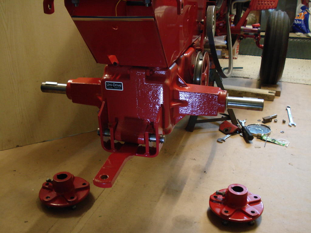

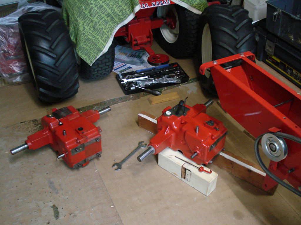

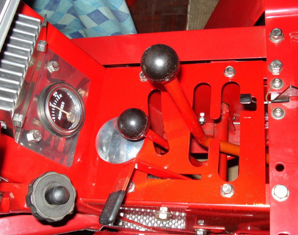

Anglo Traction 761 #1202 Posted September 28, 2018 Last week I swapped out the old tired 5091 Trans in the 8 spd C-120 and needs a rebuild. Replaced it with a spare 103916 I obtained 6 years ago- . Gave it 3 runs and all smooth and positive. Yesterday, I noticed a tiny weep in the brake shaft oil seal, so I pulled and replaced all the seals All done and finished today ready for more test runs tomorrow . Cleaned up, painted and fitted the original gear cover plate. Also swapped rear wheels over to the Maxxis Kevlar Turfs on this, as it is going to a new home for mowing and towing duties. 4 4 1 Share this post Link to post Share on other sites

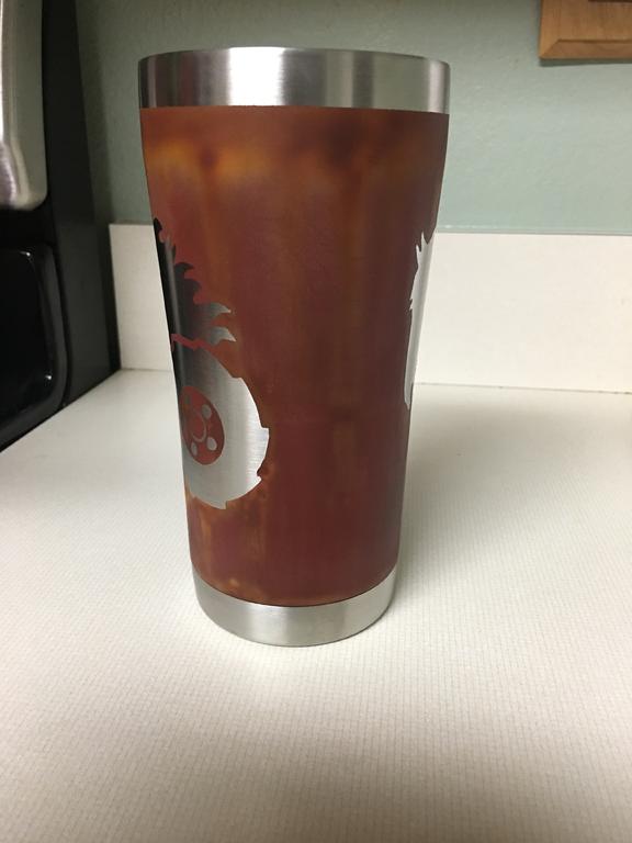

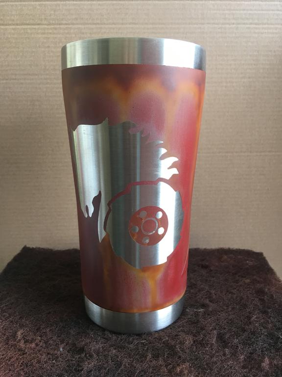

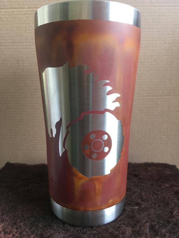

19richie66 17,937 #1203 Posted September 28, 2018 (edited) Well since it’s too hot outside to work on my horse, I did the next best thing. I painted one Trying to get used to this airbrush making a little bit of rust. Edited September 28, 2018 by 19richie66 2 5 Share this post Link to post Share on other sites

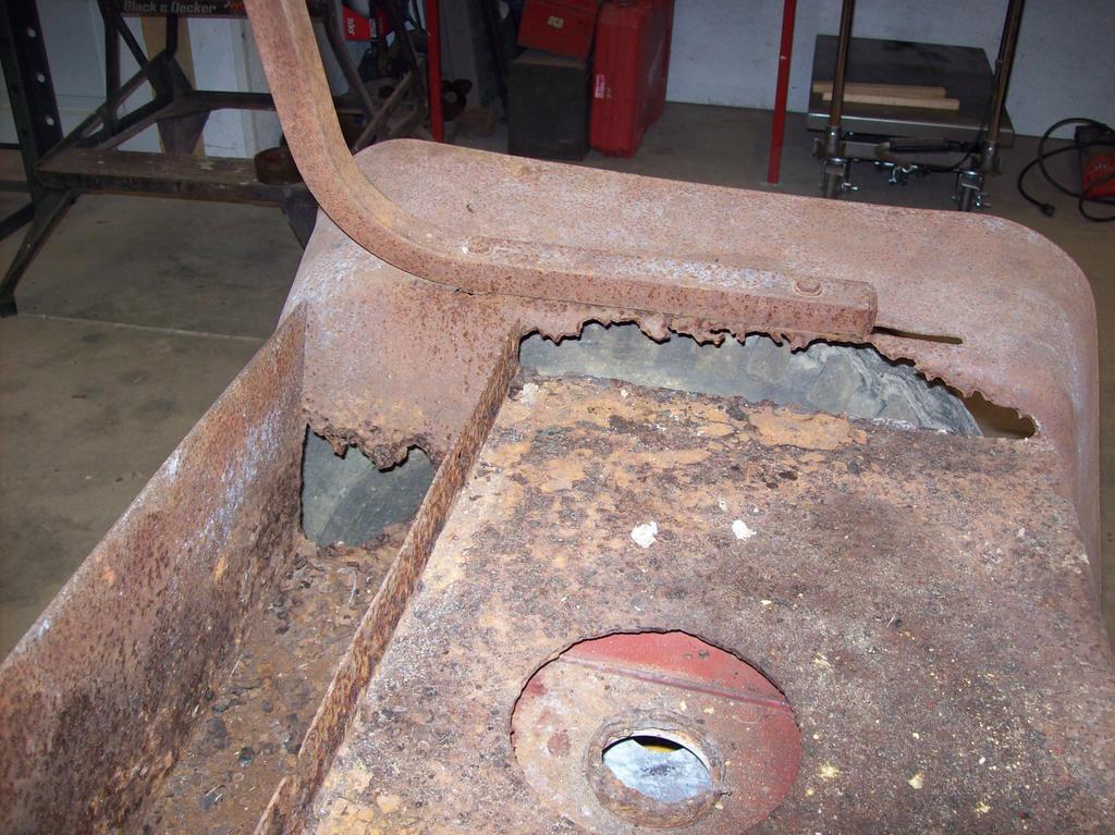

953 nut 69,874 #1204 Posted September 28, 2018 17 minutes ago, 19richie66 said: making a little bit of rust RUST! You want rust, I'll show you rust! 6 1 2 Share this post Link to post Share on other sites
19richie66 17,937 #1205 Posted September 28, 2018 2 minutes ago, 953 nut said: RUST! You want rust, I'll show you rust! Definitely have your fair share 3 Share this post Link to post Share on other sites

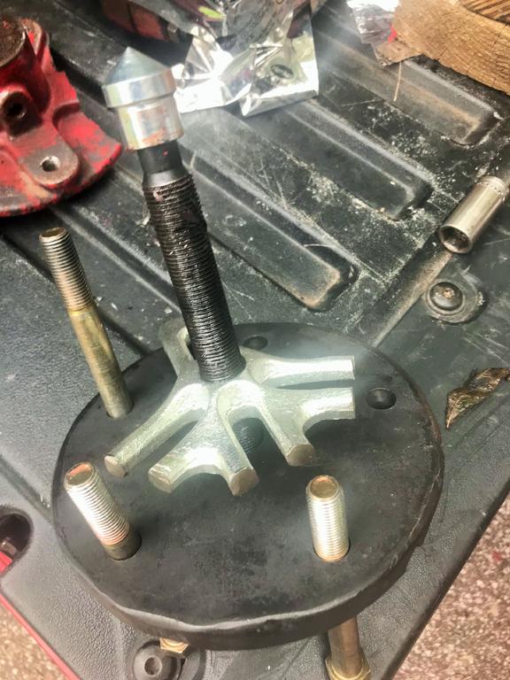

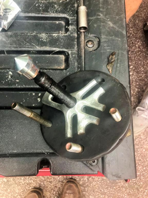

Lane Ranger 12,151 #1206 Posted September 28, 2018 (edited) Richie : Your puller is just like the one I use. I have a friend that lets me use one a little different one that works pretty well also. Here are some pics: Edited September 28, 2018 by Lane Ranger 1 1 Share this post Link to post Share on other sites
19richie66 17,937 #1207 Posted September 28, 2018 (edited) @Lane Ranger So far it has worked 100% and it was free scrap materials. I have about 2” left for it to come off but it’s too hot out right now. Couple hours I’ll go fight it again. Edited September 28, 2018 by 19richie66 2 Share this post Link to post Share on other sites

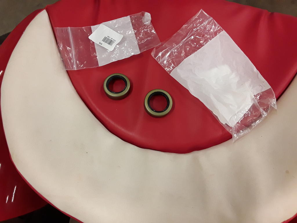

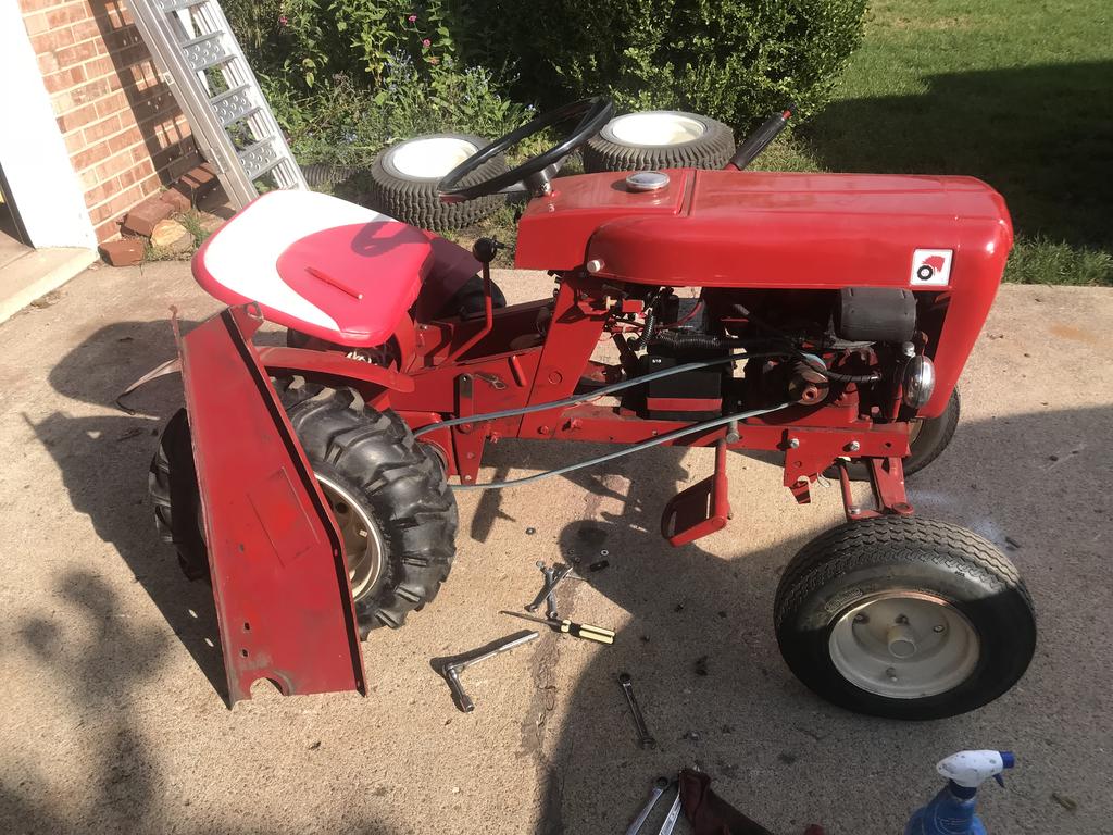

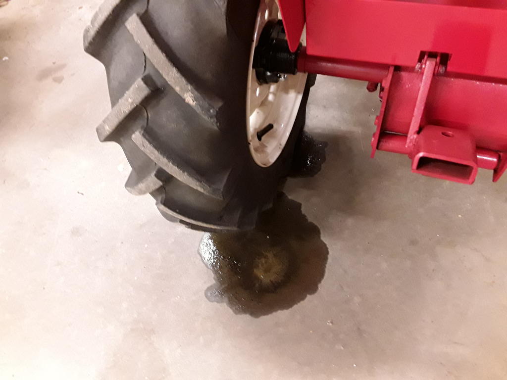

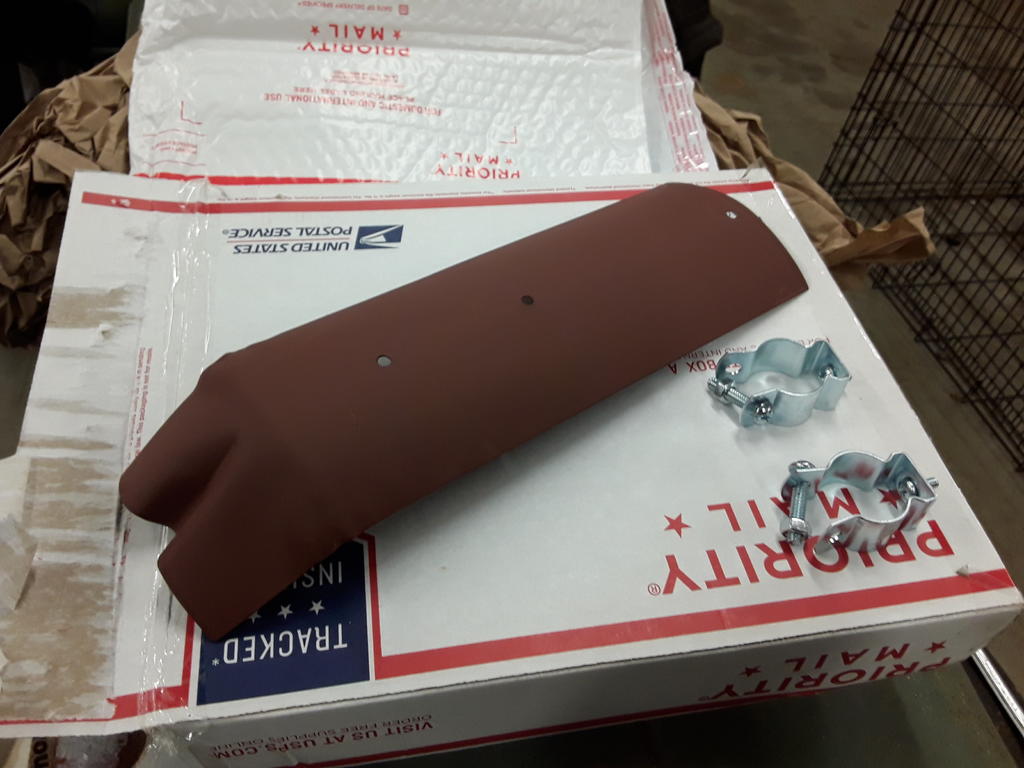

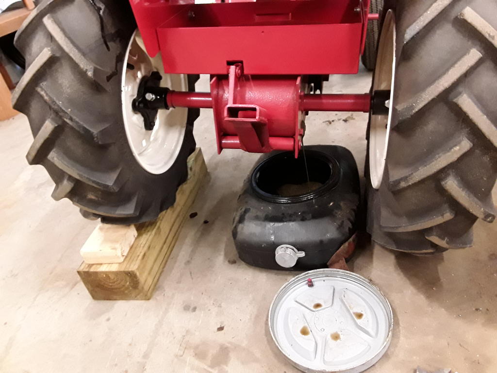

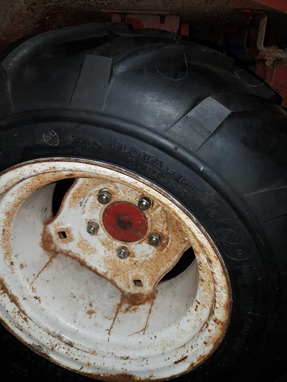

mhlmeader 689 #1208 Posted September 28, 2018 Today i drained out the new tranny oil i put in last week, leaky seal, seal repair stuff no worky..infact seemed to make it worse. Got new seals the other day. Prolly work on it tomarrow afternoon or sunday. I also got my replacement muffler guard in, and managed to intercept the box before my yellow lab secretly ran off with box. Rip it open. And loose all the parts. (Happened before). In the meantime, while beauty is sick, i still got the beast to putt around on!! 3 5 Share this post Link to post Share on other sites
cleat 9,389 #1209 Posted September 28, 2018 5 hours ago, Anglo Traction said: Last week I swapped out the old tired 5091 Trans in the 8 spd C-120 and needs a rebuild. Replaced it with a spare 103916 I obtained 6 years ago- . Gave it 3 runs and all smooth and positive. Yesterday, I noticed a tiny weep in the brake shaft oil seal, so I pulled and replaced all the seals All done and finished today ready for more test runs tomorrow . Cleaned up, painted and fitted the original gear cover plate. Also swapped rear wheels over to the Maxxis Kevlar Turfs on this, as it is going to a new home for mowing and towing duties. Holy, your old trans still looks like new. Great looking tractor. I love clean and fresh paint. Cleat 1 1 Share this post Link to post Share on other sites
wallfish 20,693 #1210 Posted September 28, 2018 (edited) 1 hour ago, mhlmeader said: Today i drained out the new tranny oil i put in last week, leaky seal, seal repair stuff no worky..infact seemed to make it worse. That sucks! But on the bright side, the bottom inside part of your rim is more shiney and snow won't stick to it. Make sure those axles are smoooooth, especially check and file the key slot as it doesn't take much to ruin those seals. Been there done that. Edited September 28, 2018 by wallfish 3 1 Share this post Link to post Share on other sites

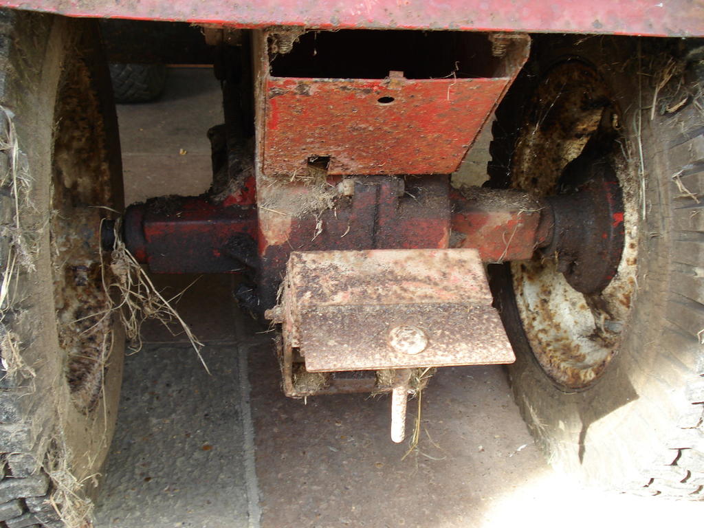

Anglo Traction 761 #1211 Posted September 29, 2018 15 hours ago, cleat said: Holy, your old trans still looks like new. Great looking tractor. I love clean and fresh paint. Cleat Thanks Cleat, that tired old 5091 (on left in my first pic) looked like this when I got it- Inside was just as bad, there were a multitude of reassembly errors by the previous owner as well. First run today of the replacement Tranny was good......got to go out again and again testing it...... oh the the things we have to endure ...seat time.! 1 3 Share this post Link to post Share on other sites

AMC RULES 37,260 #1214 Posted September 29, 2018 20 hours ago, wallfish said: That sucks! But on the bright side, the bottom inside part of your rim is more shiney and snow won't stick to it. Make sure those axles are smoooooth, especially check and file the key slot as it doesn't take much to ruin those seals. Been there done that. Plus, it's good measure to place a piece of black electrical tape over that key slot to ensure protection of that new seal during installation. 2 Share this post Link to post Share on other sites

WHX?? 58,307 #1218 Posted September 30, 2018 11 hours ago, Anglo Traction said: Thanks Cleat, that tired old 5091 (on left in my first pic) looked like this when I got it- Inside was just as bad, there were a multitude of reassembly errors by the previous owner as well. First run today of the replacement Tranny was good......got to go out again and again testing it...... oh the the things we have to endure ...seat time.! Looks to me Anglo you may have made the proverbial silk purse out of a sows ear, I'd normally say you best just lemme come get that but .....keep up the good work! 1 Share this post Link to post Share on other sites

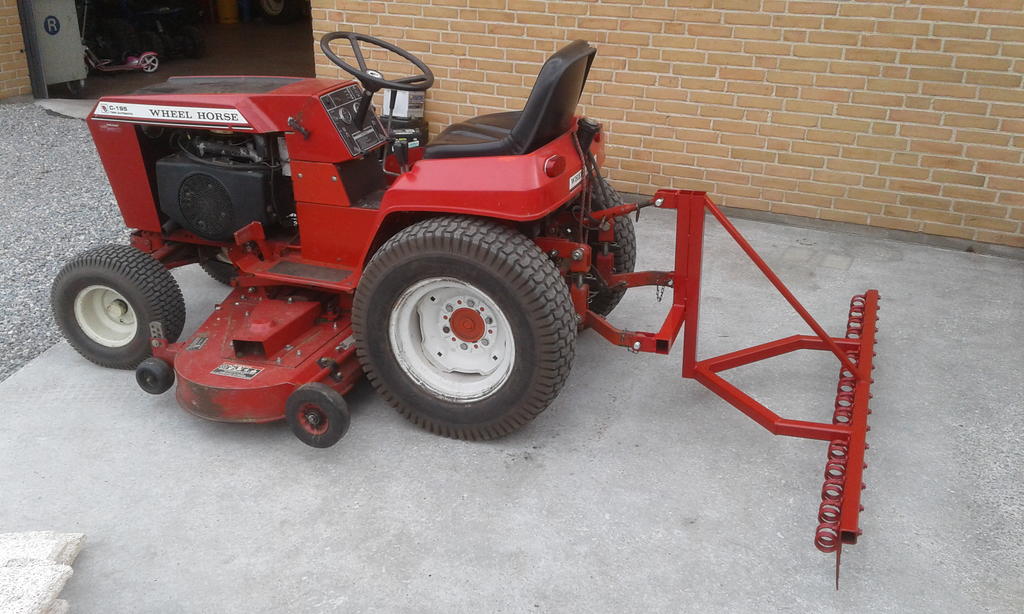

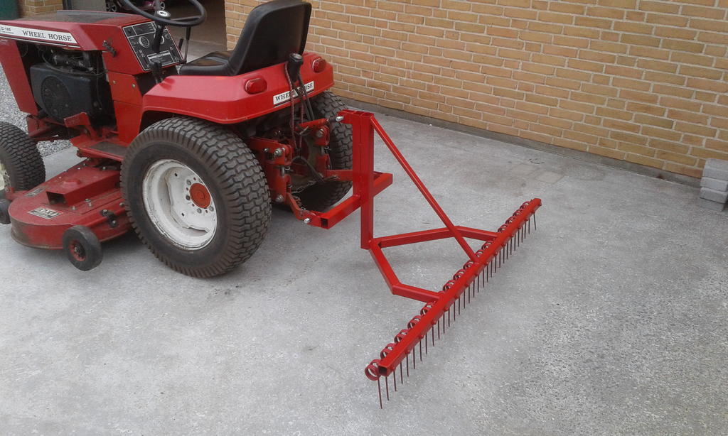

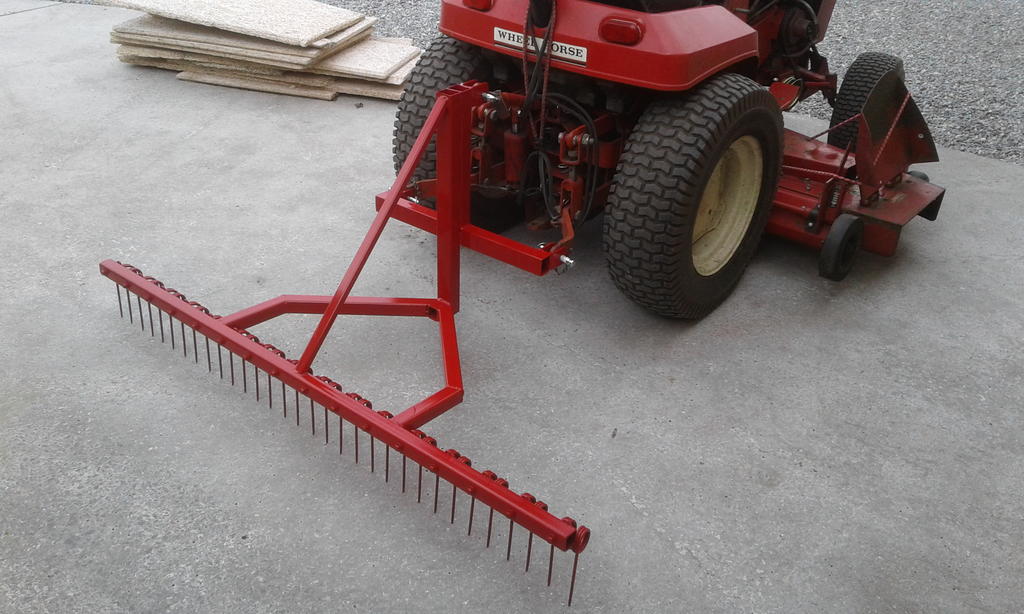

Skipper 1,792 #1220 Posted September 30, 2018 (edited) I had some rake tines laying around, and a few hours to burn. Only had an angle grinder, hand held drill, basic tools, and a welder available, so yeah, there are things that could have been a lot better executed, and planned too. This was more function over form Result was a 3 pt. rake, 6 foot wide. It ain't picture perfect, but for a quick fix to a problem a Saturday afternoon, it turned out usable, even though there was a few Oooh jeah's, sh....t's, and uuupsies under way. I got it setup so that I can push it about an inch into the ground if needed, or else it will just run freely with hydraulic valve in float position. It does a nice job on the granit chip driveway. I can force it to take a deeper scoop to move a bit of chip to where it's more needed, so it does what it was intended for, even though it won't win any fabrication Oscars. Paint is an industrial grade RAL code 3003. Closest match I have come by over here. Edited September 30, 2018 by Skipper 2 8 1 Share this post Link to post Share on other sites
cleat 9,389 #1221 Posted September 30, 2018 Looks good as does the monster 60" deck... 3 1 Share this post Link to post Share on other sites

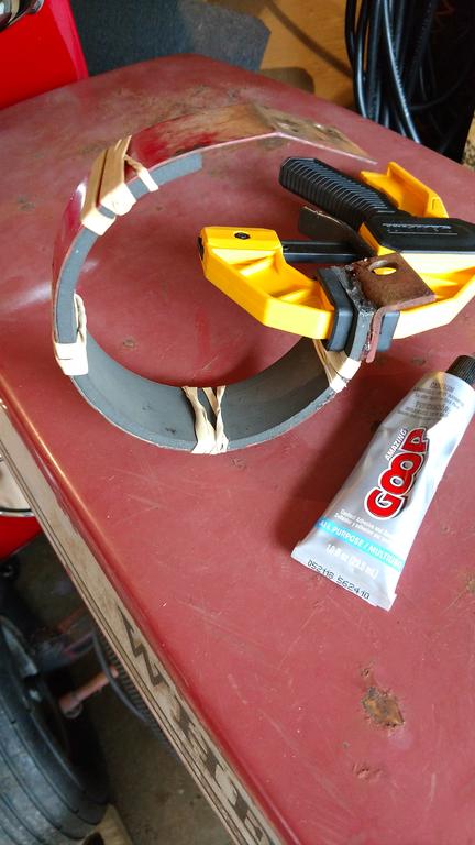

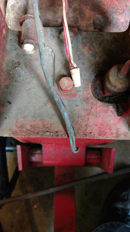

CountryRock 199 #1223 Posted October 1, 2018 (edited) Workin on one of the GT2500s today. Started by cleaning some electrical connections and swapping a battery out to troubleshoot the charging system. Then I took the brake band off, cleaned it and relined it with one of Bob Maynard's new liners. That's sitting to cure the adhesive now. Got a new magnetron could coming for it soon so I can get rid of the points. Eventually gonna flush the rear end on it. Took the fender pan off and cleaned out more dirt from around the transmission. Wondering what these wires are for. Red and orange nutted together and two greens twisted together. Just laying there. Edited October 1, 2018 by CountryRock 3 1 Share this post Link to post Share on other sites
WHX?? 58,307 #1224 Posted October 1, 2018 Most likely bypassed seat switch & possibly tail light wires? 1 Share this post Link to post Share on other sites
CountryRock 199 #1225 Posted October 1, 2018 (edited) 21 minutes ago, WHX21 said: Most likely bypassed seat switch & possibly tail light wires? Not sure this model ever had a seat switch and pretty sure it didn't come with tail lights, but maybe the wire was there for them to be added. EDIT: Electrical schematic shows a seat switch with two black wires. Edited October 1, 2018 by CountryRock Share this post Link to post Share on other sites
