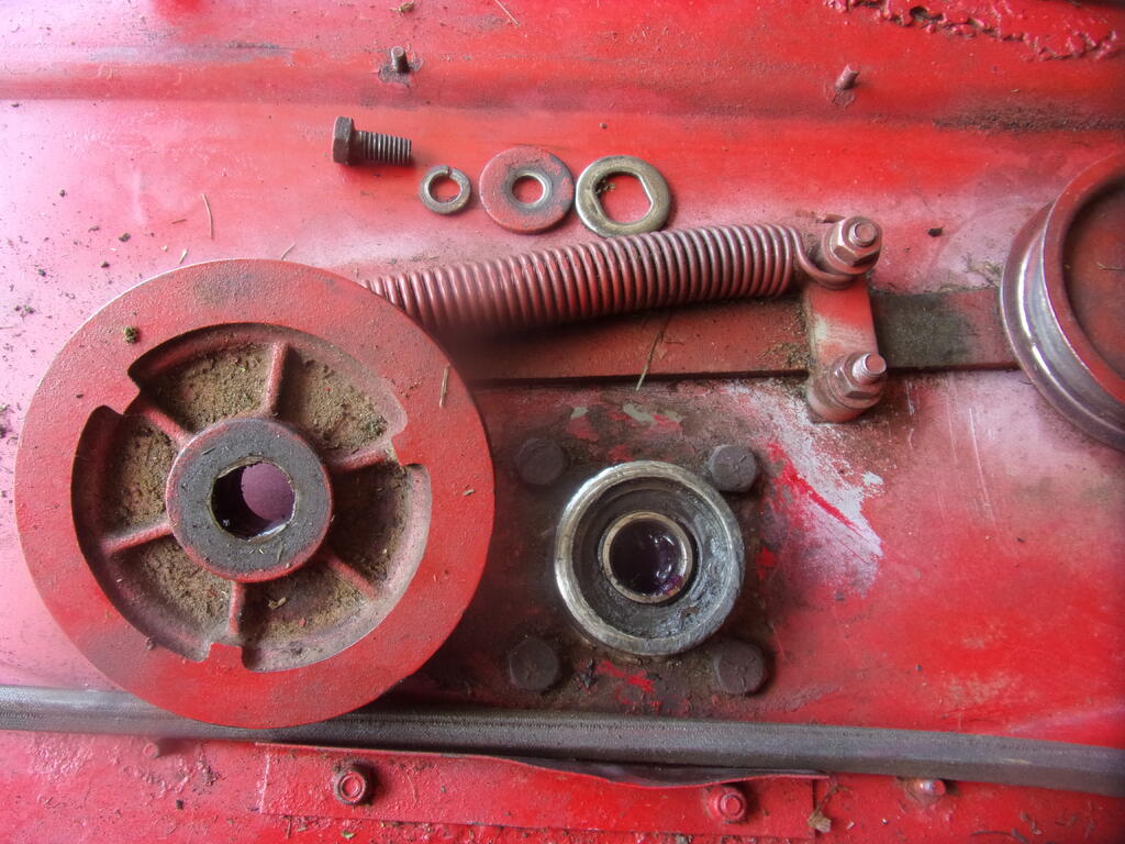

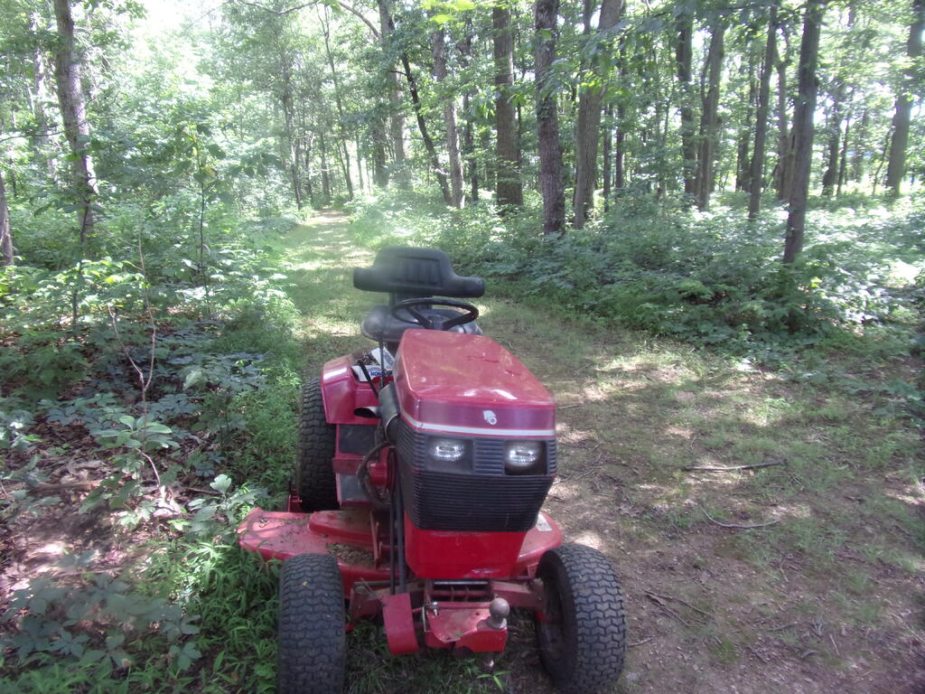

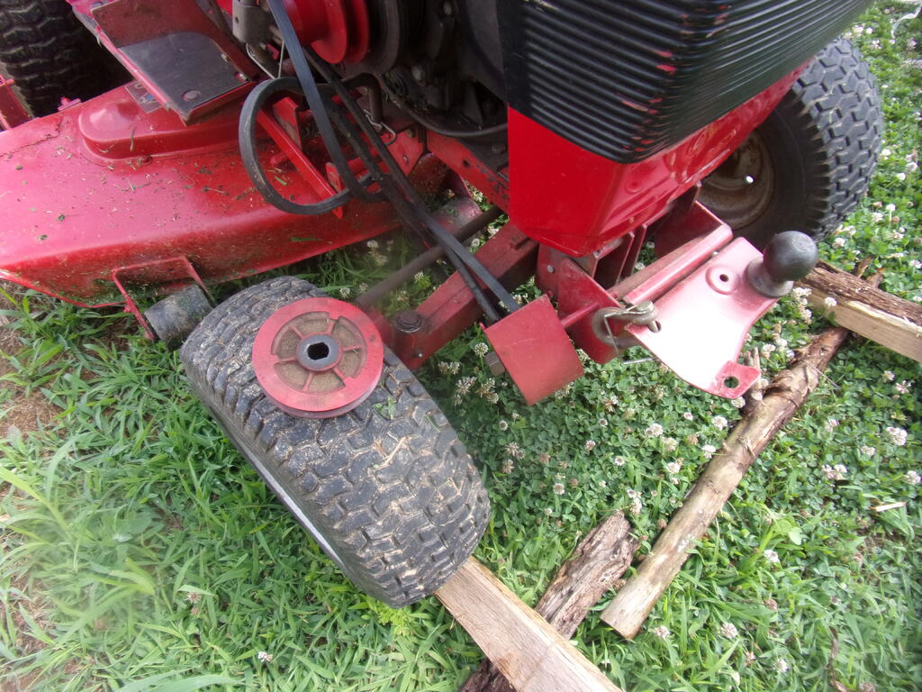

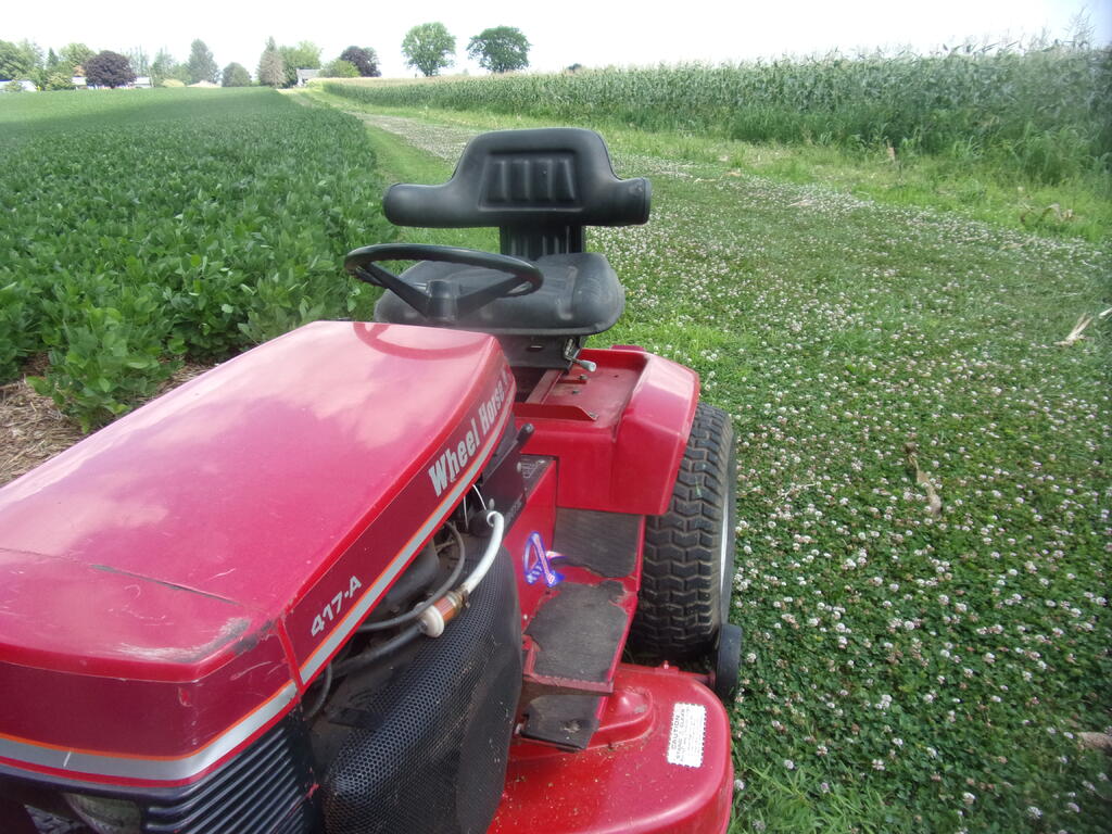

Ed Kennell 46,639 #12180 Posted July 12, 2021 I started out planning to mow the right o way around the farm and some woods trails. I got about a 1/4 mile from the house and the deck drive belt came off. I loosened the mule drive andreached under to put the belt back on the center pulley and it was gone. I found the pulley in the grass to the left of the tractor. Lucky it didn't go the other way into the beans. The spindle had dropped downnand the blade was dragging, so I had to find some ramps to get it high enough to get the spindle out for the ride home. When I took the deck off, the bolt and washers were still laying on top of the deck. While I had the deck off, I removed the other two spindles and greased the bearings. These do not have zerks. Back to mowing after the 2 hour delay. 12 8 Share this post Link to post Share on other sites
Jeff-C175 7,209 #12181 Posted July 12, 2021 1 hour ago, Ed Kennell said: the bolt and washers That little bitty bolt is all that holds that together? Share this post Link to post Share on other sites
Ed Kennell 46,639 #12182 Posted July 12, 2021 Yep, that's all folks. 1 Share this post Link to post Share on other sites
Jeff-C175 7,209 #12183 Posted July 12, 2021 1 minute ago, Ed Kennell said: Yep, that's all folks. Betcha there's some 'blue goo' on it now? 2 Share this post Link to post Share on other sites
Ed Kennell 46,639 #12184 Posted July 12, 2021 The right spindle was the only one with loctite. Thay all have it now 4 1 Share this post Link to post Share on other sites

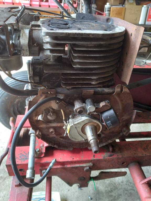

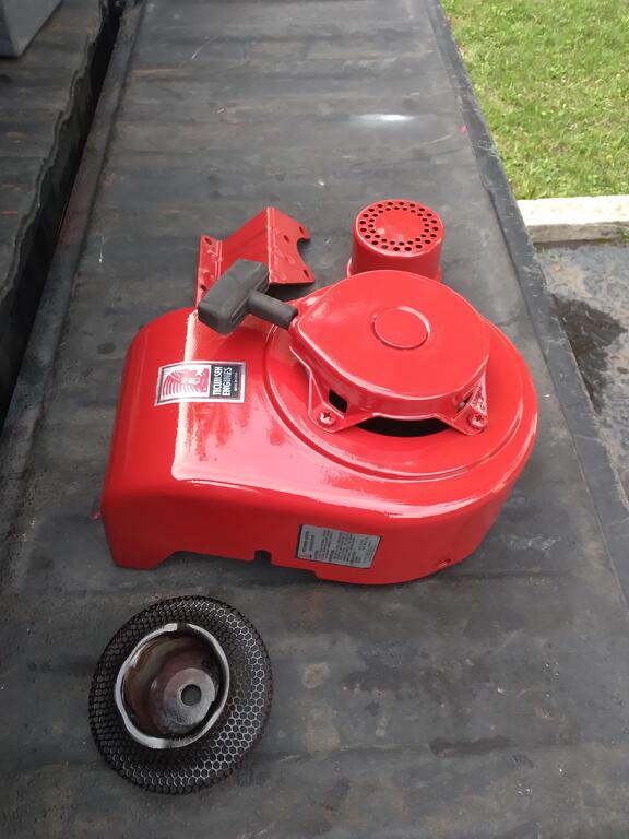

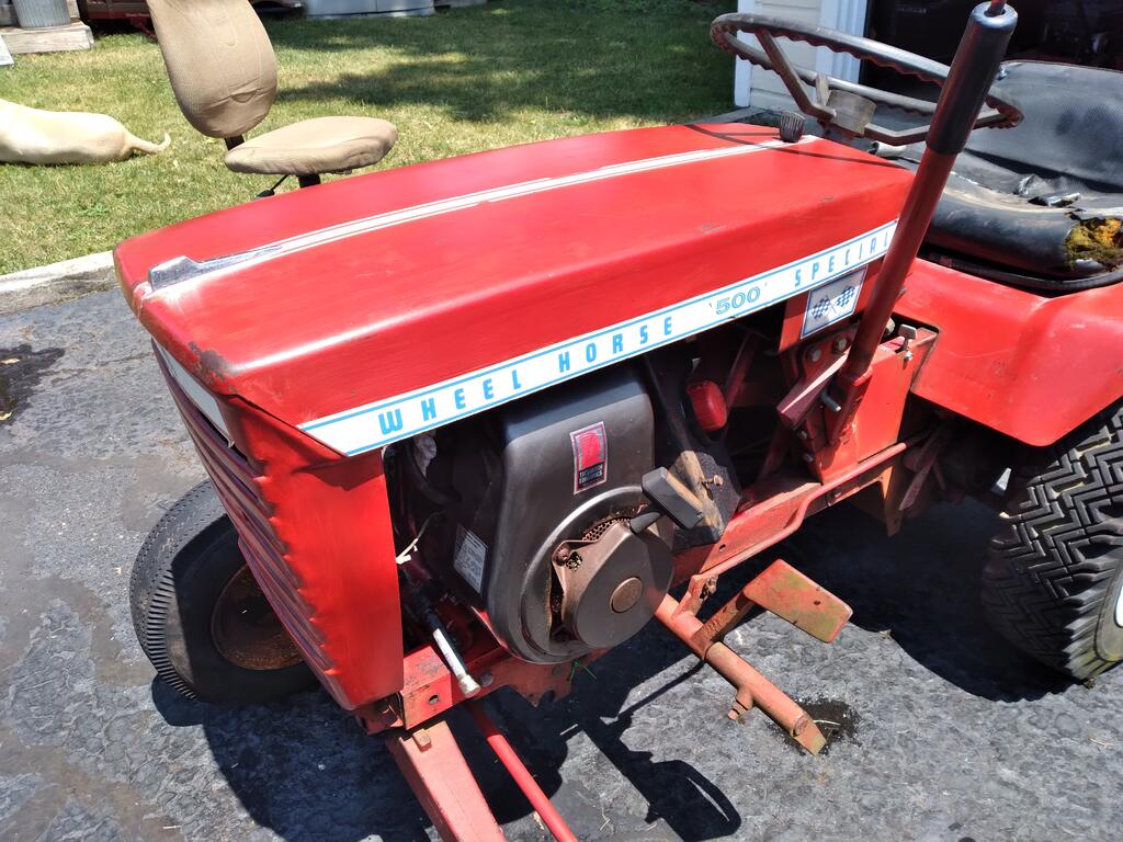

D_Mac 9,337 #12185 Posted July 13, 2021 Well since I have the flywheel off of the 500 Special to get new coil, points, and condenser. I thought I would do some more painting. The engine was not original and had nice paint on it but it was gray. Not anymore. I'm not going to paint the whole engine as the blower housing covers most of it. I will be painting the wheels when they come back from getting new tires mounted. I wanted to paint the wheels beforehand but didn't have time. 13 4 Share this post Link to post Share on other sites

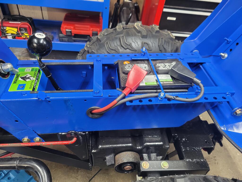

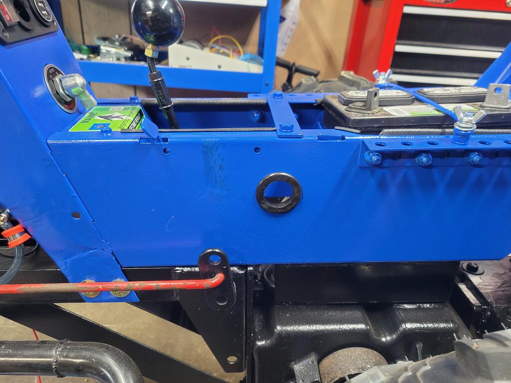

OldWorkHorse 3,156 #12187 Posted July 13, 2021 (edited) Drilled a hole to run the battery cables on the 1257 through, reused a rubber ring off the Toro 117 that alone made the purchase worth it . Edited July 13, 2021 by OldWorkHorse 6 6 Share this post Link to post Share on other sites

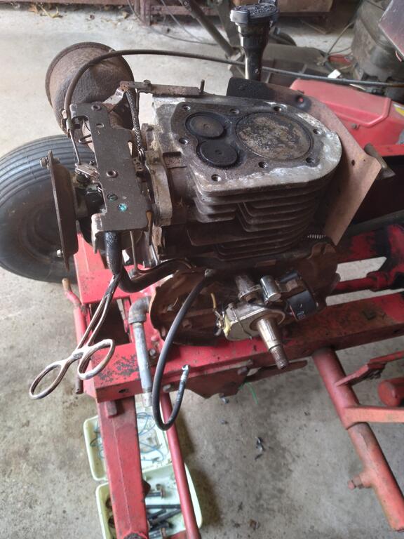

D_Mac 9,337 #12188 Posted July 13, 2021 Well more progress on the 500 Special. New coil, points, and condenser installed. Pulled the head and going to clean it off and put in new head gasket. Going to run new fuel line and put in a shut off valve. Went and got a new drive belt from Tractor Supply. The tabs for the belt cover are all missing or busted. Going to have to jury rig something for that. Shouldn't be long now but tomorrow I go back to work again. 6 3 Share this post Link to post Share on other sites

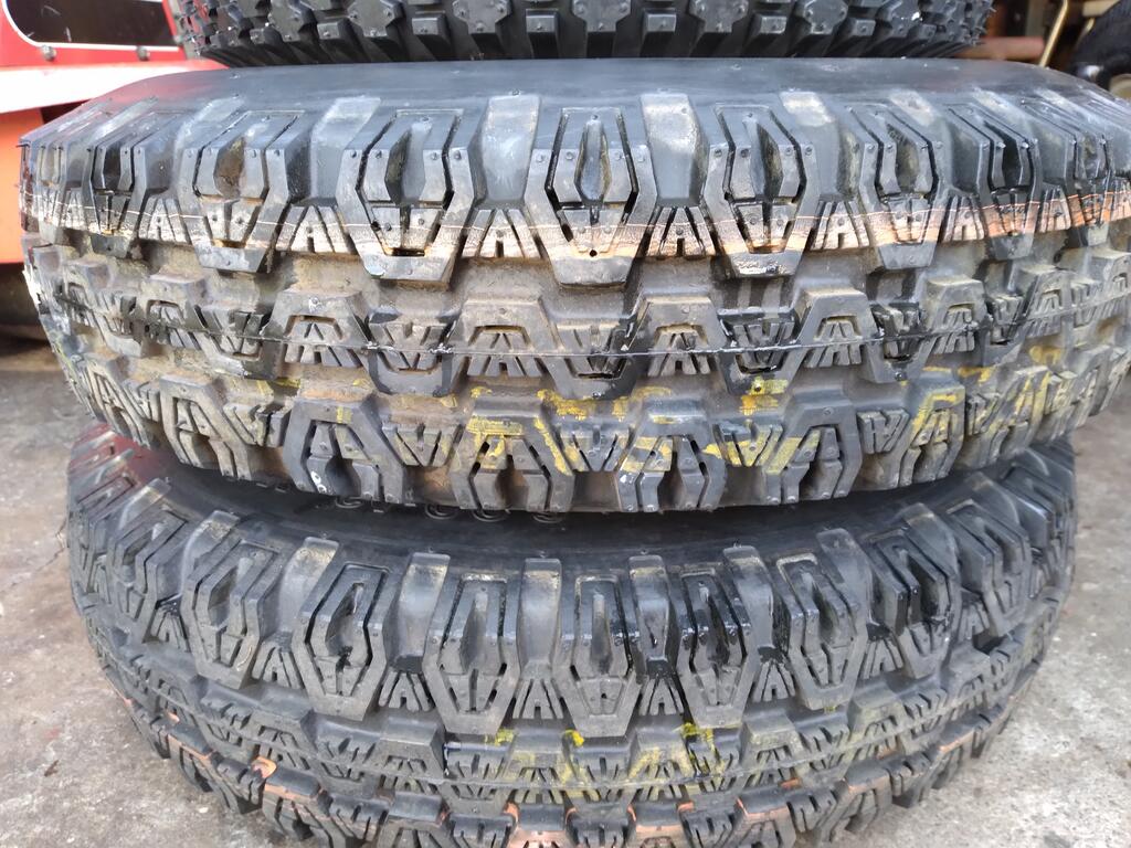

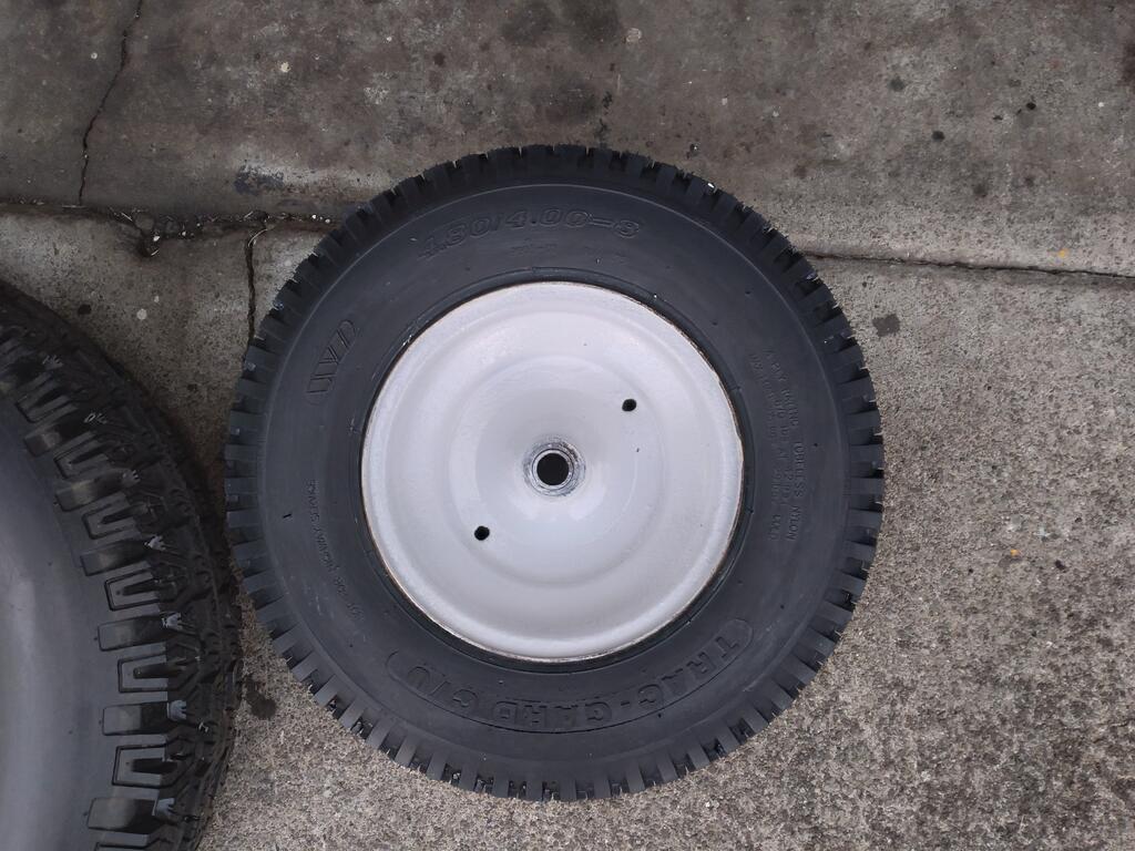

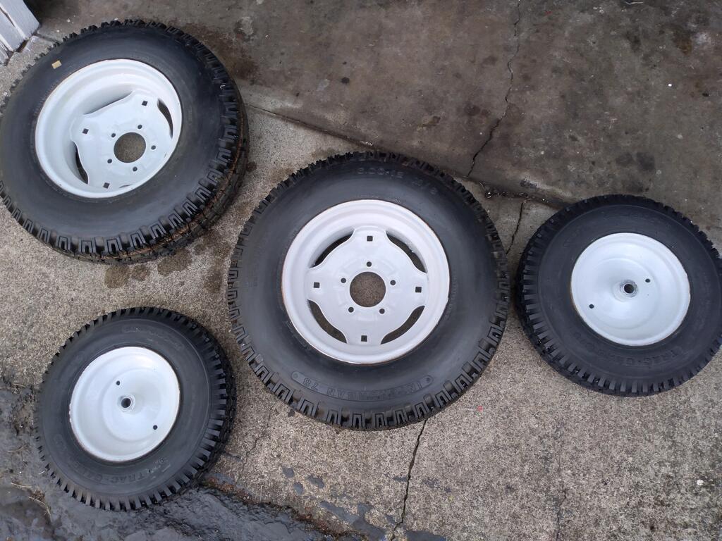

D_Mac 9,337 #12193 Posted July 15, 2021 Got the new tires mounted and the rims painted for the 500 Special. Painted rims white to match the decals. Won't be long now until it's finished. 4 6 Share this post Link to post Share on other sites
Lee1977 7,712 #12194 Posted July 15, 2021 On 7/12/2021 at 6:55 PM, Jeff-C175 said: That little bitty bolt is all that holds that together? Later around 1975 or 1976 they went with a heavy cupped washer along with the little bitty bolt. 1 Share this post Link to post Share on other sites

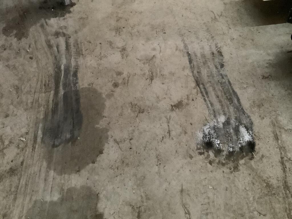

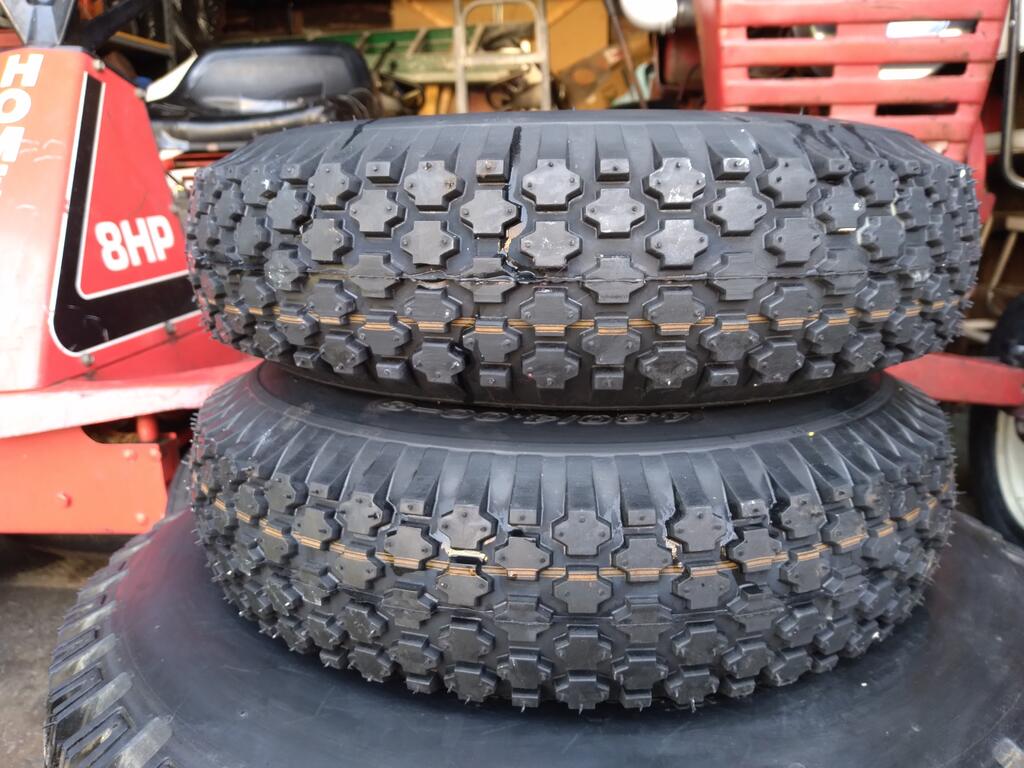

Pullstart 70,819 #12195 Posted July 15, 2021 Tugged a heavy load into the back barn today. 8 horse powers was all I needed... and a little extra grip might have helped! 3 4 7 Share this post Link to post Share on other sites
Snoopy11 5,731 #12196 Posted July 15, 2021 (edited) 2 hours ago, pullstart said: Tugged a heavy load into the back barn today. 8 horse powers was all I needed... and a little extra grip might have helped! If I would have tried to pull that load with my 51 horse tractor, there would be nothing but rims left... LOL You should get some sticky compound for those tires!!! Don Edited July 15, 2021 by Snoopy11 2 Share this post Link to post Share on other sites

WHX?? 57,472 #12200 Posted July 15, 2021 What flavor and your source are those rears @D_Mac? I like those ...kinda like a town & country but not. 4 1 Share this post Link to post Share on other sites
