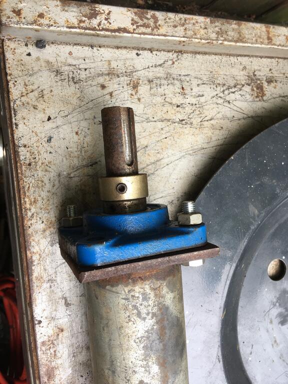

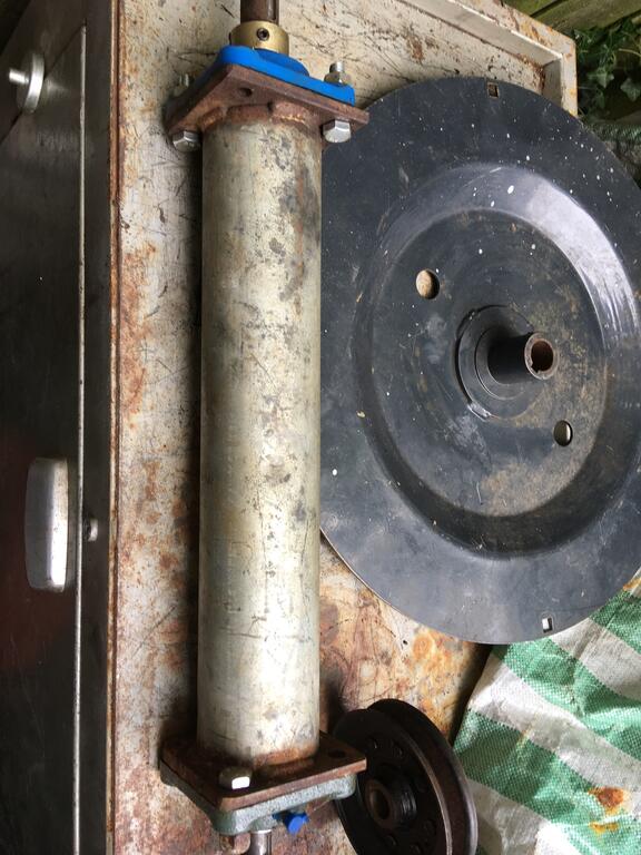

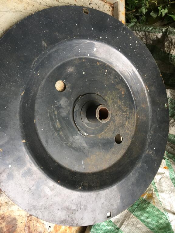

Tractorhead 9,217 #12060 Posted June 29, 2021 6 hours ago, ranger said: I have the remains of a “Westwood” D1200 ride on 7.5hp Lombardini diesel with a 42”? twin disc RD deck, it has contra rotating discs with two small swinging blades on each. This would cut very long grass without clogging, grass length which would stall the 42” SD deck on my 312-8. You could try using an old rear wheel drive car axle, (solid, not i.r.s.) cut the tubes close to the diff, fit bearings at the cut ends, pulleys on the half-shafts, single groove pulley on the outer shaft, twin groove on the inner crossed over belt between the two to contra-rotate shafts. Cutting discs attached to wheel mounting flanges. Semi mounted or tow behind with mower out the side like a sickle bar. Vertical shaft engine to drive discs. Fit blades on the top of one disc, and on the bottom of the other, to avoid leaving an uncut strip of grass and blades hitting each other. Or angle the assembly so one disc is slightly in front of the other to avoid the issues. Mine is being made from some scrap pipe, (ex street lighting lamppost, steel bar J.Deere deck pulleys, old road sweeper brush discs, 11hp Honda engine and some self aligning flange bearings. The idea is that it will be either 3point mounted, with a support wheel on the outer end, or an offset tow behind unit. Doug. That‘s nearly the idea i came up with, but instead of one discs, i thinkering about a doubledisc system. it should not only cut high grass, it could probably also be useful to cut the Hedge. mounted on the threepoint or maybe better on the Backhoe i build, this could be a cool Addon. 1 Share this post Link to post Share on other sites
ranger 1,862 #12061 Posted June 29, 2021 50 minutes ago, Tractorhead said: be 51 minutes ago, Tractorhead said: That‘s nearly the idea i came up with, but instead of one discs, i thinkering about a doubledisc system. it should not only cut high grass, it could probably also be useful to cut the Hedge. mounted on the threepoint or maybe better on the Backhoe i build, this could be a cool Addon. Mine is going to be a twin disc system, this is just one of them. The other one is waiting for me to mill the key ways in the shaft. If you drive it hydraulically, you can run at whatever angle you want! Doug. 1 Share this post Link to post Share on other sites
Tractorhead 9,217 #12062 Posted June 29, 2021 1 minute ago, ranger said: Mine is going to be a twin disc system, this is just one of them. The other one is waiting for me to mill the key ways in the shaft. If you drive it hydraulically, you can run at whatever angle you want! Doug. That was in my mind. an Oilmotor and connected to the Tractor‘s hydraulic system 1 Share this post Link to post Share on other sites
ranger 1,862 #12063 Posted June 29, 2021 3 minutes ago, Tractorhead said: connected 3 minutes ago, Tractorhead said: That was in my mind. an Oilmotor and connected to the Tractor‘s hydraulic system I would be inclined to consider using two hydraulic motors, one on each shaft. You then don’t have mechanical losses through extra shafts and gearboxes. If you use a single motor you will need a larger one to drive both cutters, so required oil supply won’t be much different. Doug. Share this post Link to post Share on other sites
Tractorhead 9,217 #12064 Posted June 30, 2021 You be right ranger, but if i use a oilmotor with attached pulley’s over gearboxes, i can change the gearratio simply by changin pulleys. so both systems have their pro and cons. additionally i see a big advance on the oilmotor beltdriven combo the possibillity for a friction clutch. So i can protect the hydraulicsystem from overload independently of the hydraulic oil flow and pressure. 👍 Share this post Link to post Share on other sites
ranger 1,862 #12065 Posted June 30, 2021 5 hours ago, Tractorhead said: You be right ranger, but if i use a oilmotor with attached pulley’s over gearboxes, i can change the gearratio simply by changin pulleys. so both systems have their pro and cons. additionally i see a big advance on the oilmotor beltdriven combo the possibillity for a friction clutch. So i can protect the hydraulicsystem from overload independently of the hydraulic oil flow and pressure. 👍 Good idea👍. You could also fit an inline pressure relief valve across the motor connections, this would give a bit more protection to hoses, control valves, etc in case of a jam. If the discs you are going to use will have any amount of weight to them, (Flywheel effect), not a bad idea to avoid constant stopping when cutting things like hedges etc, motors are available with internal “Freewheel” valves to allow whatever is being driven to coast to a halt when switched off, rather than a potentially damaging “dead stop” as oil flow is cut off. Or you could fit a one way check valve across the motor connections to produce the same effect, (as motor becomes a pump on overrun, and pumps oil around itself, reducing stresses to the rest of hydraulic system). Similar to the way a “Tow/Push” valve on a hydro tractor allows you to move it without damage. Doug. 1 Share this post Link to post Share on other sites

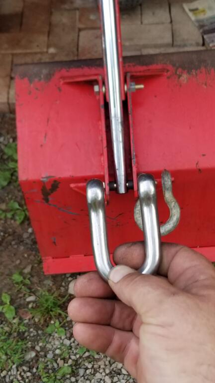

Wheel Horse 3D 3,827 #12072 Posted June 30, 2021 Got all the pivots upgraded, along with some temp shackles. Ill be on the lookout for a more U shape and wide enough to go to both sides. 2 3 Share this post Link to post Share on other sites
ebinmaine 80,988 #12073 Posted June 30, 2021 33 minutes ago, Wheel Horse 3D said: . Ill be on the lookout Fire 🔥🔥 up ya forge!! 1 Share this post Link to post Share on other sites
Wheel Horse 3D 3,827 #12074 Posted June 30, 2021 29 minutes ago, ebinmaine said: Fire 🔥🔥 up ya forge!! Not a bad idea, I could even give them a 90 or 60 to lay on the top better. 3 Share this post Link to post Share on other sites
