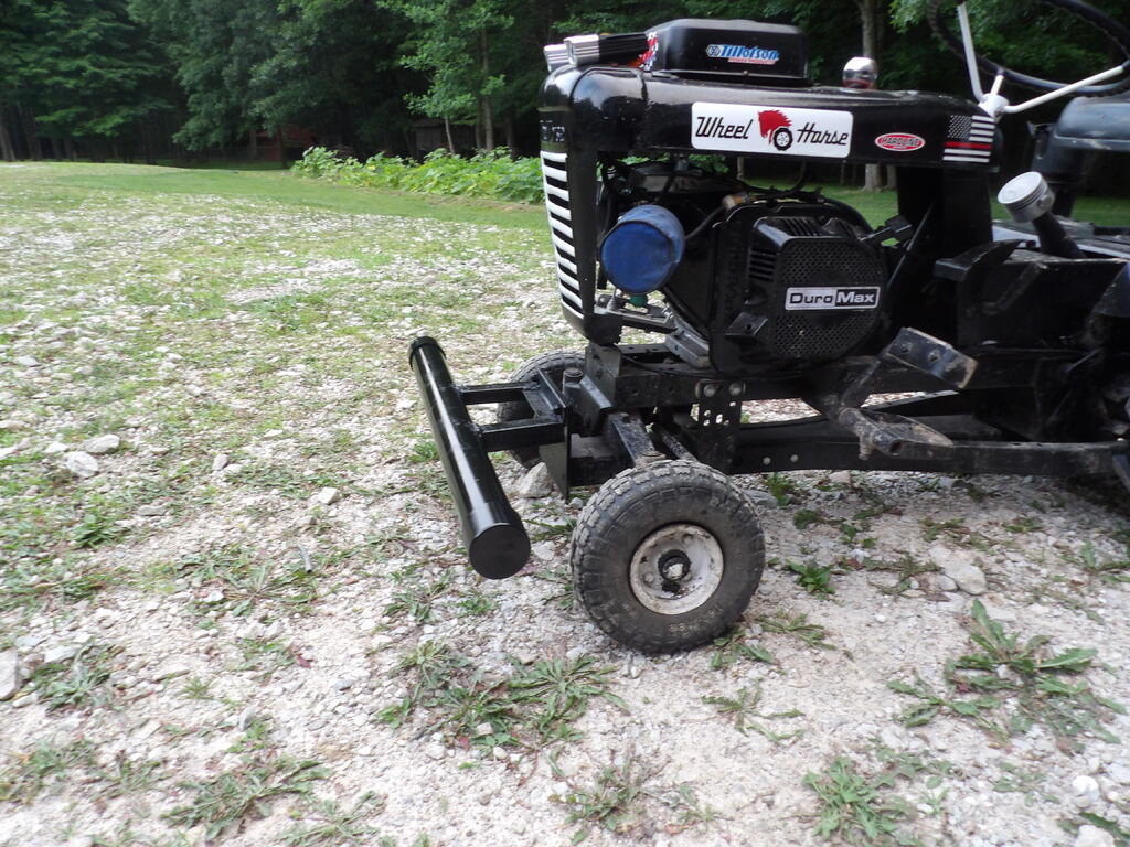

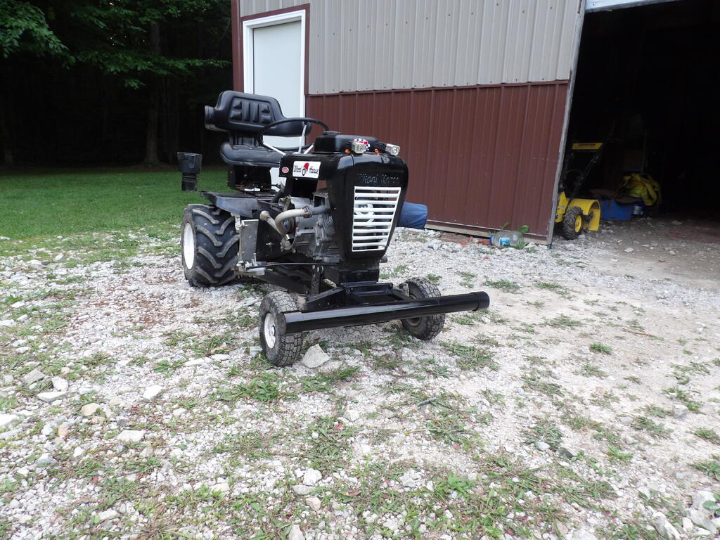

Snoopy11 5,731 #12027 Posted June 26, 2021 Made a bumper for the L-157... Don 4 3 Share this post Link to post Share on other sites

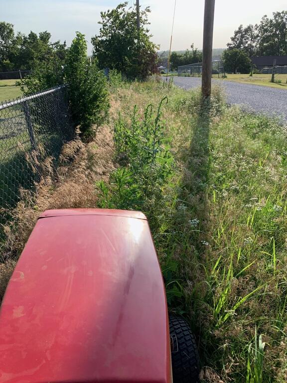

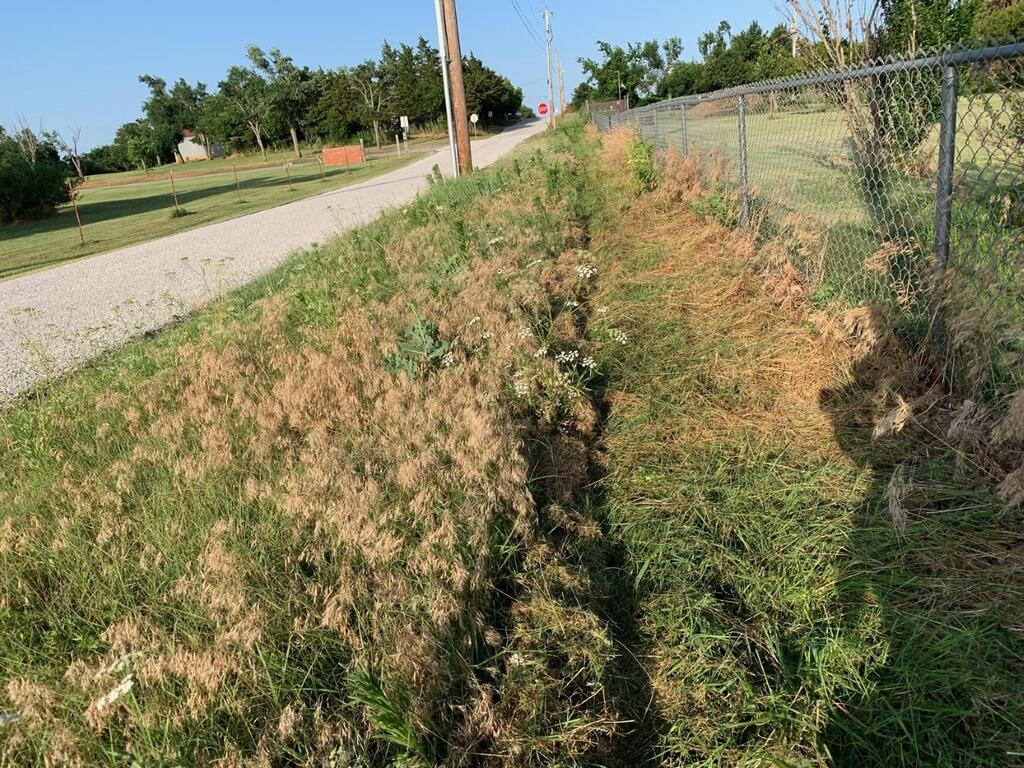

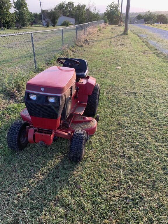

OutdoorEnvy 1,817 #12029 Posted June 26, 2021 Had a friend move to a new place on a couple acres, the back ditch needed some major attention so we put the 312 on it! Took 3 passes as it was worked down but came out good. He's now wanting a horse of his own... 5 5 Share this post Link to post Share on other sites
WheelHorse520H 710 #12030 Posted June 26, 2021 (edited) 1 hour ago, OutdoorEnvy said: He's now wanting a horse of his own... Can’t blame the guy, I want more than just one of my own! @Snoopy11 that’s a very nice looking machine you’ve got there. I love the shine. Edited June 26, 2021 by WheelHorse520H 2 1 1 Share this post Link to post Share on other sites

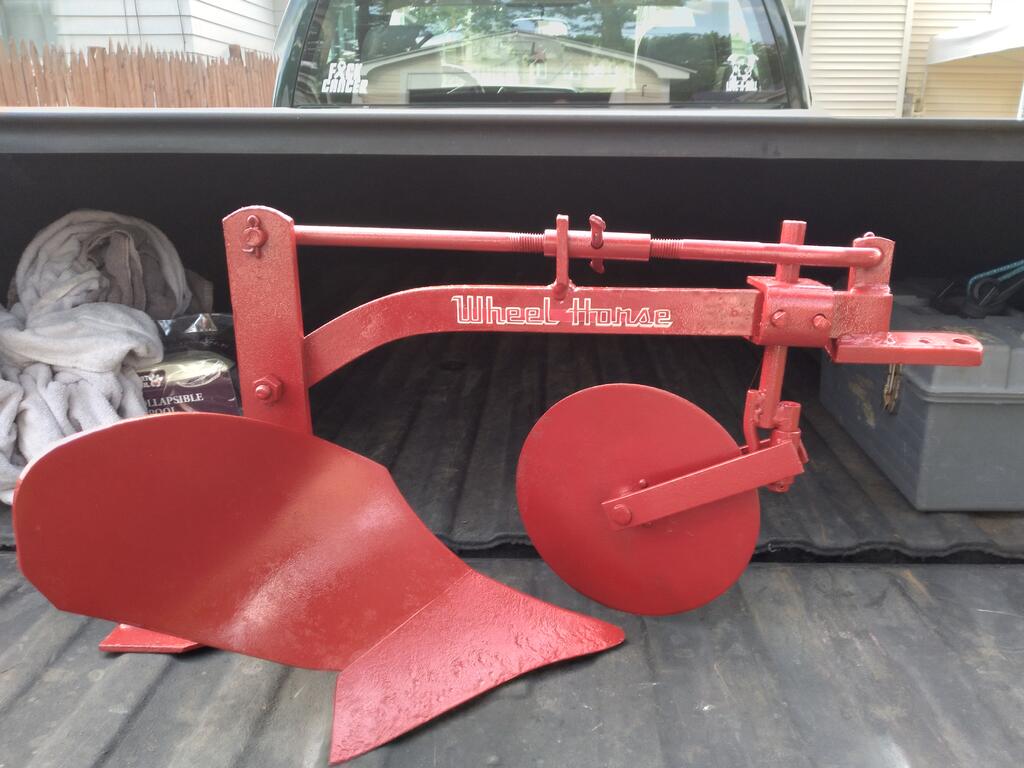

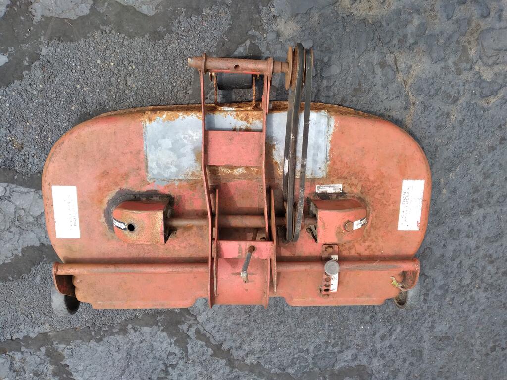

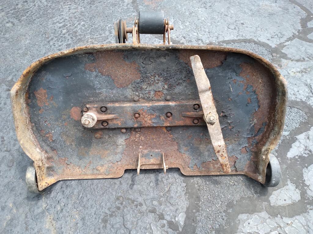

D_Mac 9,339 #12031 Posted June 26, 2021 Picked these up today. Deck for either the 857 or the 1075. It's missing a blade and the rear wheel. It's been patched. The bottom plow I have no information or knowledge of them. Any input I would like to hear. I got them cheap enough. 7 Share this post Link to post Share on other sites
OutdoorEnvy 1,817 #12032 Posted June 27, 2021 That plow looks good D_Mac. Looks like it's the slot hitch version? 1 Share this post Link to post Share on other sites
Snoopy11 5,731 #12033 Posted June 27, 2021 10 hours ago, WheelHorse520H said: Can’t blame the guy, I want more than just one of my own! @Snoopy11 that’s a very nice looking machine you’ve got there. I love the shine. Thanks man, yeah, I really love it too! Don 1 Share this post Link to post Share on other sites
D_Mac 9,339 #12034 Posted June 27, 2021 6 hours ago, OutdoorEnvy said: That plow looks good D_Mac. Looks like it's the slot hitch version? Yes, fits slot hitch. Not sure if I will ever use it but I couldn't leave it. I went to get the deck, the plow was a bonus. 2 Share this post Link to post Share on other sites
peter lena 10,091 #12035 Posted June 27, 2021 @OutdoorEnvy, nice finish on that cut, I always walk a or verify what I am planning to cut , also use my low range gearing , to help on the pto drive and deck speed , clean out deck after word . your paint finish is asking you for an oil lubrication rub down , MARVEL MYSTERY OIL , or similar aerosol on a clean cloth will quickly , feed the paint , cut thru the grunge and give it life. do that a couple of times , to show the paint shine , ( if you want to ) . brought back a lot of w/h paint with that easy paint feed . just my own experience , pete 1 1 Share this post Link to post Share on other sites
D_Mac 9,339 #12036 Posted June 27, 2021 Having a little trouble finding replacement blades for that deck. Share this post Link to post Share on other sites
pfrederi 21,235 #12037 Posted June 27, 2021 You will need to straighten the deck hanger frame or your PTO idler bearing will not last long. also deck may hit your rear tire... Share this post Link to post Share on other sites

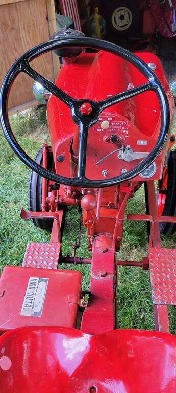

squonk 48,231 #12038 Posted June 27, 2021 On 6/23/2021 at 4:19 PM, AMC RULES said: Mounted up my Senior's newly restored steering wheel. 👍👍 A few of the befores here... Did you do that Craig? I was going to ask you about it and forgot. Elvis could use a wheel resto! 3 1 Share this post Link to post Share on other sites

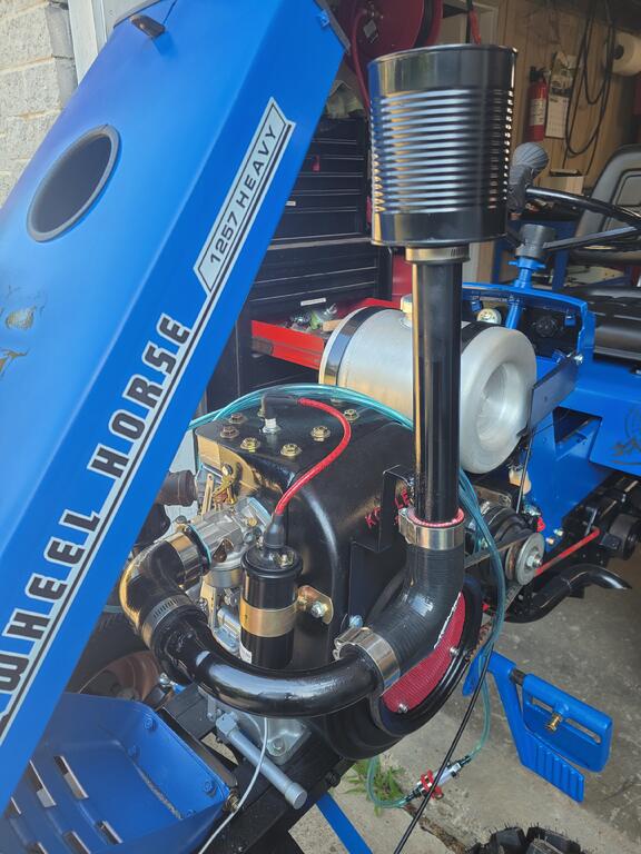

OldWorkHorse 3,156 #12045 Posted June 28, 2021 Finished up the mounting braket for the air intake on the 1257Heavy so that's done now. 3 3 Share this post Link to post Share on other sites

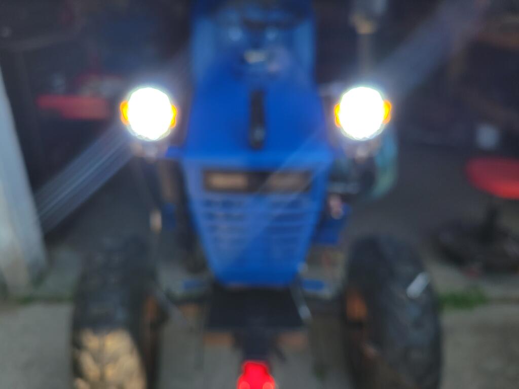

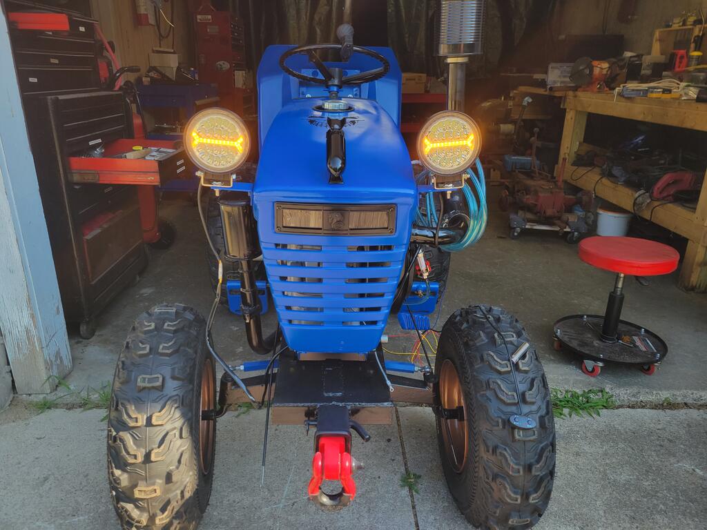

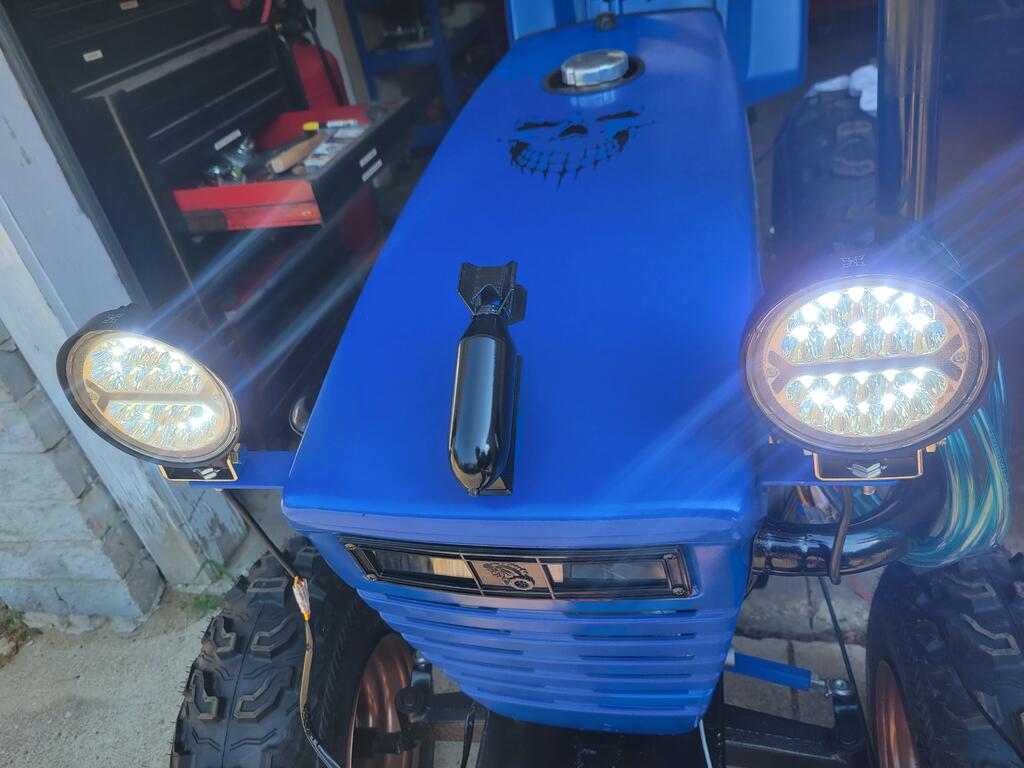

OldWorkHorse 3,156 #12046 Posted June 28, 2021 Working on getting some stuff hooked up starting with the lights. They are 4 inch LEDS with running orange lights or the orange lights can be a flashing hazard light. Thinking pretty cool. Might need to install these in the back of my 314-8 for reverse lights with hazards for snowblowing. 9 Share this post Link to post Share on other sites
