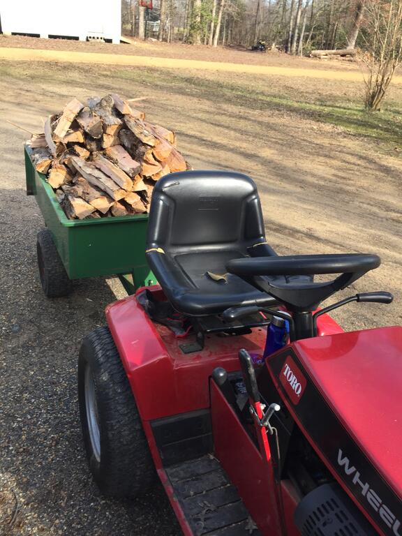

Shed 377 #11862 Posted June 14, 2021 I have about 14 chains on cycle and 10 in the box new. And 2 bars on backup. I sharpen a lot. Full chisel 3/8th chain. I do use bar oil never used motor oil too. But one log I was cutting I went through 3 chains in 15mins there was so much metal inside, steel cable spikes you name it. I use a husky 372 with a 20 and try to keep from hitting dirt bit if it's in the wood you'll find it. The wood trailers a little to heavy for the wheel horse and the splitter is to high to hitch so can't pull with them. That piles only half of what I have. I burn ae year round with out door stove 1 1 Share this post Link to post Share on other sites

ebinmaine 80,987 #11864 Posted June 14, 2021 1 hour ago, Shed said: splitter is to high to hitch Trina and I do all of our cutting and splitting out in the forest because we find it's easier to bring the splitter close to the tree after it's been felled. I had the same issue with the splitter being too tall for a Wheelhorse. I can't get any bigger equipment into my Forest unless I build a much wider bridge over an Old logging twitch trail that is filled with rotting corduroy logs and mud and muck. About 25 or 30 ft long. I went and got a drop hitch and flipped it upside down so I could pull our beast of a splitter out into the forest. 3 2 Share this post Link to post Share on other sites

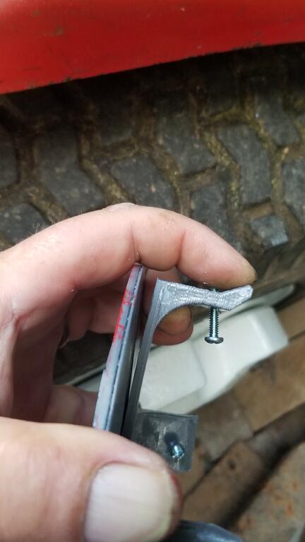

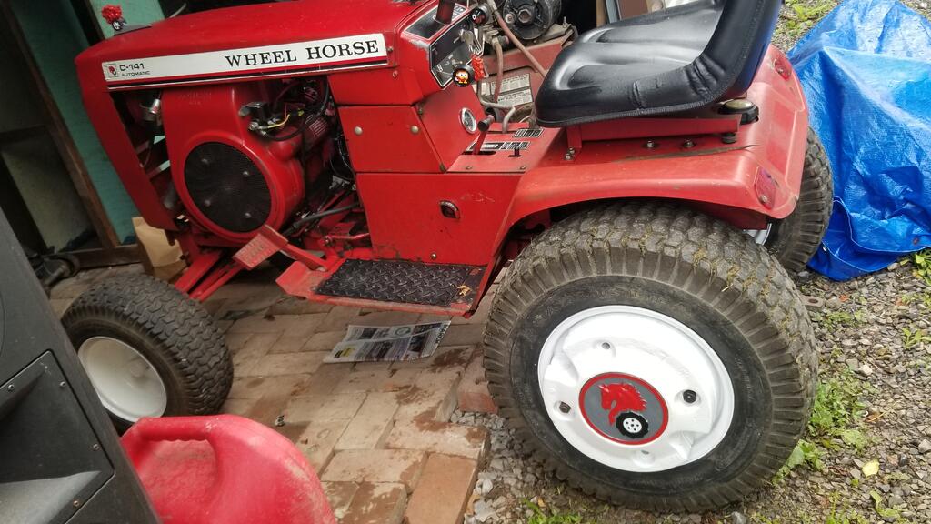

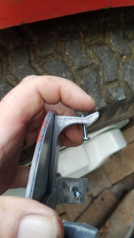

Wheel Horse 3D 3,827 #11871 Posted June 15, 2021 (edited) Still prepping Dug..got the wheel weight hubcaps done, but made a mis calculation in the depth or diameter Either way it came out even better with teeth that adjust for tightness and depth.and the cap sits INSIDE the weight. The plastic provides the spring. Went ahead and painted the front bearing caps red too. Ill put those on once they dry. Edited June 15, 2021 by Wheel Horse 3D 10 3 Share this post Link to post Share on other sites

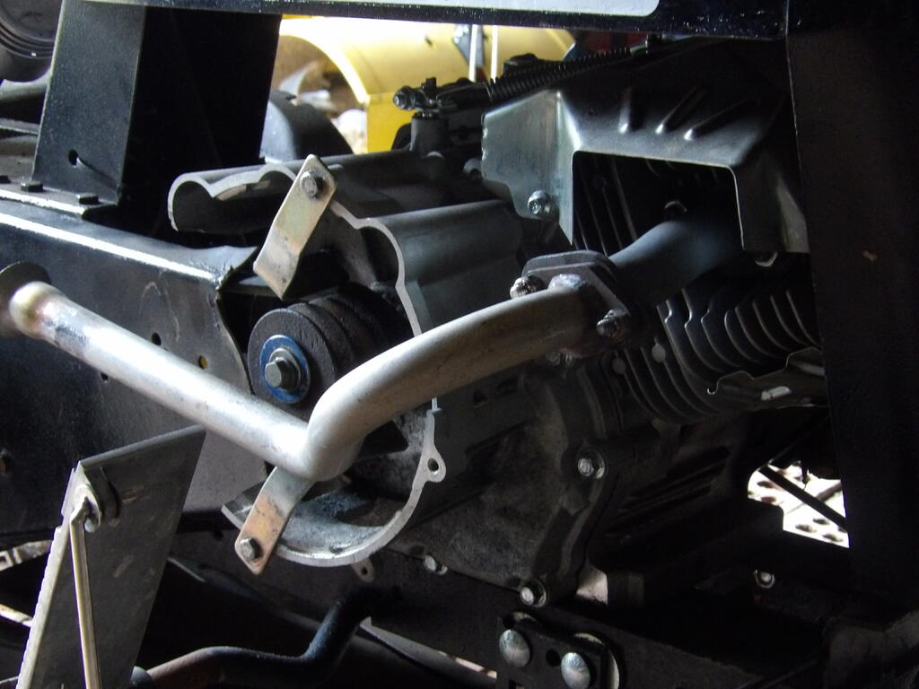

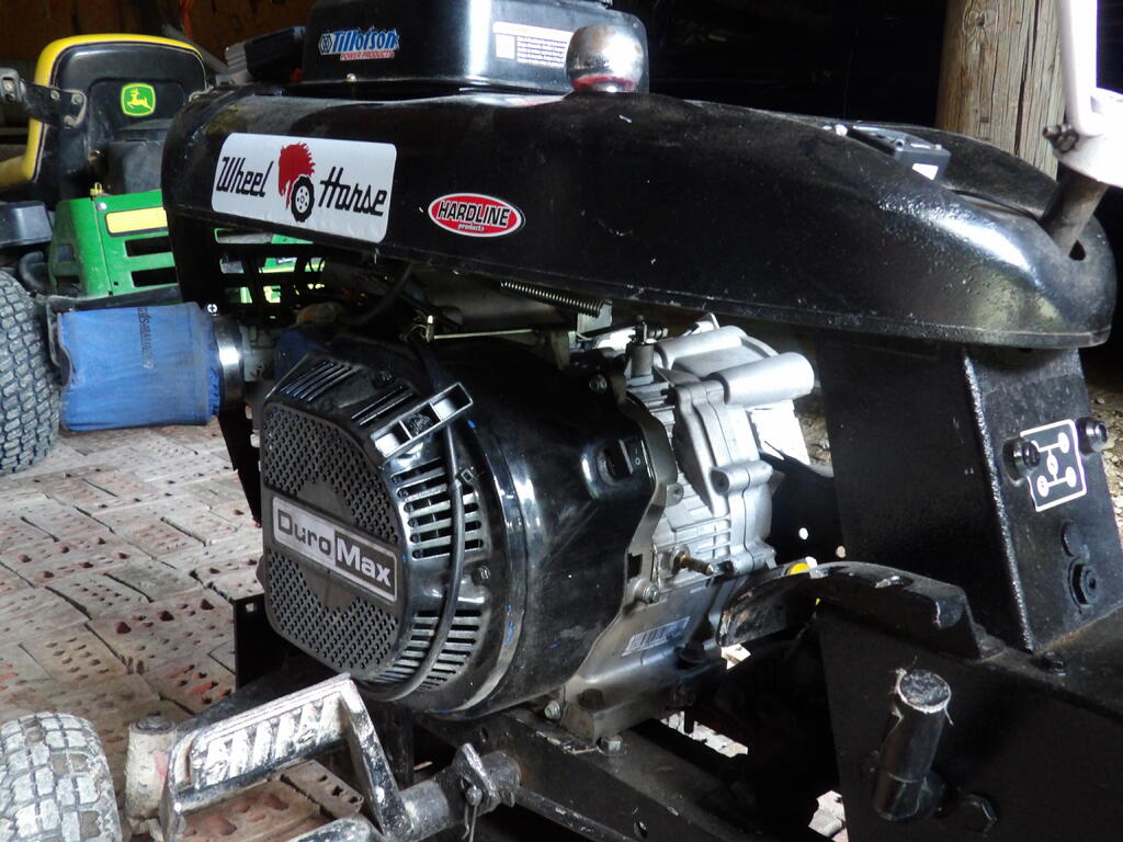

Snoopy11 5,731 #11875 Posted June 16, 2021 (edited) Howdy guys! So, after a long build on my Duromax engine, I have it on the tractor. I used a 65 inch belt made my own top-plate and belt stops on the motor housing. I ground down the cam, bored out the wrist pin section of the billet rod. I installed stainless pushrods. I had to use my die grinder to grind down part of the block inside the motor so the rod would rotate. I fabricated my own air intake. I custom made an adapter for my header pipe on the exhaust. Obviously, I attached my throttle cable. The Billet rod I went with is +.045 which took some 'doing' to make work. Here is the deal with the Billet rods on Duromax engines. If you do not have a die grinder, you cannot get a predator 420 rod to work in a Duromax 457. The wrist pin of the Duromax is slightly larger than that of a predator engine... so you have to grind out the inside of the rod to get the Duromax wrist pin to fit. The crankshaft journal fits just fine. The other thing is the cam. Not only do you have to grind down the cam between the lobes... you also have to grind part of the outside of the rod... very slightly because you have to have .080 clearance between the rod and cam. Again, my rotary die grinder got to do some work on this build. After speaking with ARC racing about this build, ARC told me that they dyno tested an engine that is comparable to mine, and it made 51 horsepower. Whether my engine is making that kind of power is up for debate... but it is making well over 40 hp. I will say, this motor growls like a hellion. It sounds WAY different than my Tillotson 25 horse engines. The Duromax engine literally sounds like a coyote 5.0. It really isn't as jerky as you would think with this much power. As long as you release the clutch slowly and give it a little throttle, it is actually really smooth... although when you even slightly mash the throttle... it rips. I did go with Mobil 1 oil for this motor, as I do with all my high power builds. Absolutely no oil is going by the breather, so that tells you what a good build this is. Aside from working on the engine, I also got some lights for the '67. These are lithium battery powered lights (since my engine does not have a charge coil, I went with some called Victagen). These lights are very bright and can last many hours without needing a charge. I am very happy with them. Don Edited June 16, 2021 by Snoopy11 added pictures 8 5 1 Share this post Link to post Share on other sites
