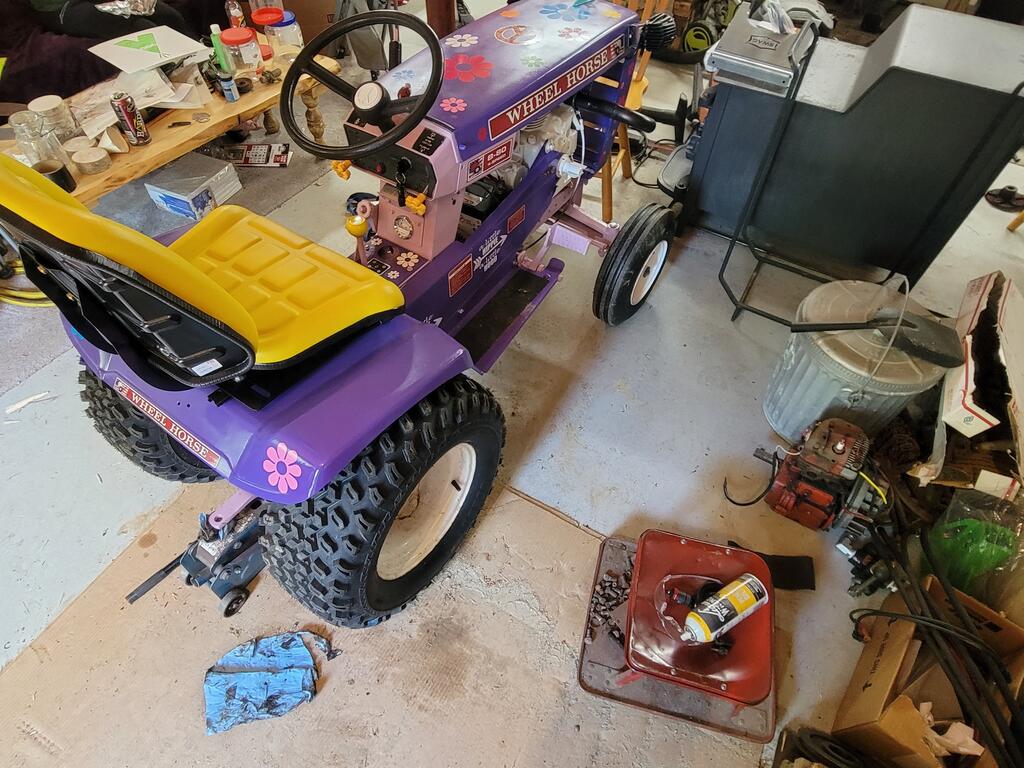

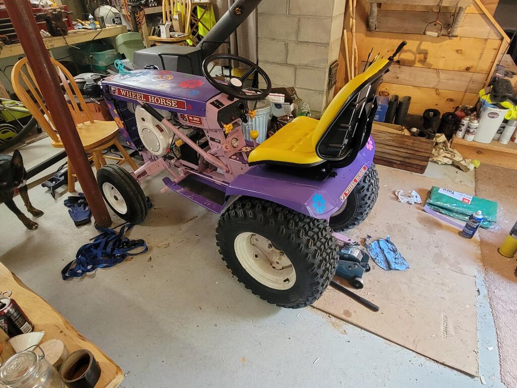

OldWorkHorse 3,156 #11776 Posted June 6, 2021 @ebinmaine hey thanks again for the helping hand! Once muffler is fixed and paint touched up,, I can add a horse to the completed list and hunt for my next project.... always have to have 2 going at a time! 4 2 Share this post Link to post Share on other sites

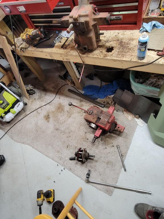

OldWorkHorse 3,156 #11777 Posted June 6, 2021 Started with going down to see @ebinmaine Eric, to fix some leaking rear seals and finished off with re painting the B-80s muffler since VHT yellow 1200° header paint don't like doing its job went with the old faithful rustoleum high temp grill paint. See how this holds up! 2 7 Share this post Link to post Share on other sites

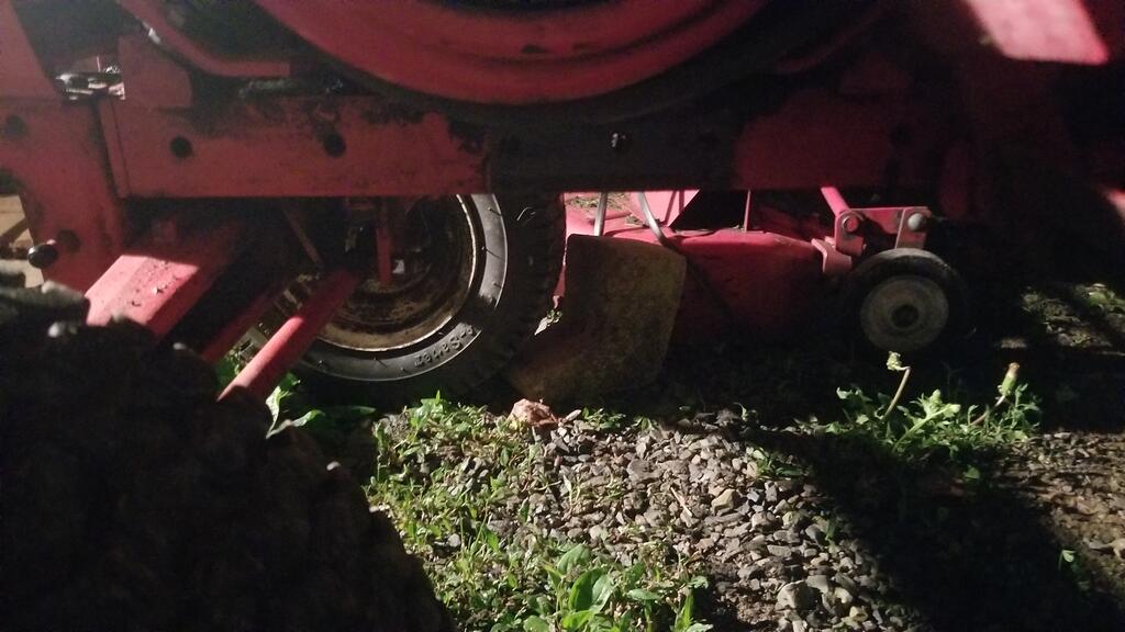

8ntruck 9,355 #11779 Posted June 6, 2021 I sharpened the blades on my 42" SD deck today. Scraped the grass out and shot some grease in the spindles while it was off of the tractor, too. Last time I mowed, I was unimpressed with the quality of the cut. Sharp blades made a world of difference! They still had a little trouble with the tall, thick grass over the drain field. Almost seemed like I was loosing blade speed under the heavier load. The blades are the double D style, 13 1/2 inches long. They don't seem to overlap when the center and side blades are parallel when width wise in the deck. That does not seem right? The cutting edges of these blades have been sharpened back close to 1/4 inch. I need to start shopping for a new set. 2 Share this post Link to post Share on other sites
ebinmaine 80,987 #11780 Posted June 6, 2021 2 hours ago, Wheel Horse 3D said: You'd think EB has pulled a hub or 2! I'm savin that little trick! Normally I pull the hubs using the puller while the transmission is laying on the ground flat. Certainly can be done while they are on the tractor as well. Given that scenario I will often use a jack stand as a stabilizer. Certainly was a heck of a lot easier with @OldWorkHorse Steve helping to use his ballast and muscle combined with my own. 2 1 1 Share this post Link to post Share on other sites

Ifixoldjunk 778 #11791 Posted June 7, 2021 22 hours ago, ebinmaine said: Had our friend @OldWorkHorse Steve around today so I could give him a hand changing the rear wheel seals on his Ariel's Flowah Powah tractor. He'd been pouring the Liquid Wrench spray to it for a couple weeks or more and the seals were pretty much not there so plenty of lube was getting in the hub. I was pleasantly surprised to have both hubs fly right off using my "spare hub as a puller" method I picked up from around here somewhere. Even better... He also gave me a hand pulling both hubs from a spare 8 speed that may end up in the C-160 Tecumseh engine tractor or as needed for whatever horse. Also from the 3 speed that I'll be rebuilding for Trina's Military Tribute Tractor. I'd been soaking the 8 speed for at least a year. Trina started spraying the 3 speed hubs a few weeks ago. All four came off!! Certainly took more effort than the ones on Steve's but it was great to see them slide out without serious issue. Here is the 8 speed on the bench, 3 speed on the floor, with the puller next to it. I’m actually surprised how nice a wheel horse looks purple! Nice job. 1 1 Share this post Link to post Share on other sites

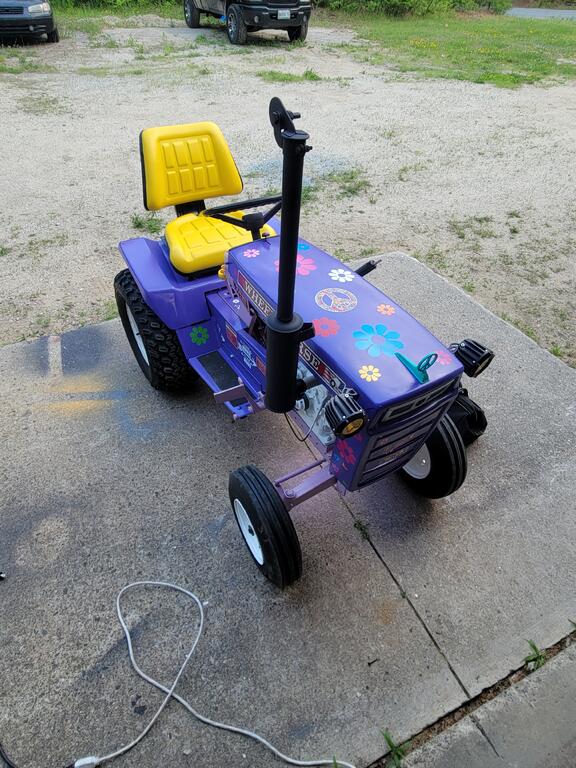

Ifixoldjunk 778 #11794 Posted June 8, 2021 I just got done giving the old horse a backup light. I figured it needs one for winter so I can see where I’m backing up while plowing 6 2 Share this post Link to post Share on other sites
Ed Kennell 47,620 #11795 Posted June 8, 2021 6 minutes ago, Ifixoldjunk said: so I can see where I’m backing up while plowing Lucky you....having one of those necks that still allows your head to turn to see behind the tractor. I have to rely on mirrors and the crunch when I back into something. 1 11 Share this post Link to post Share on other sites
