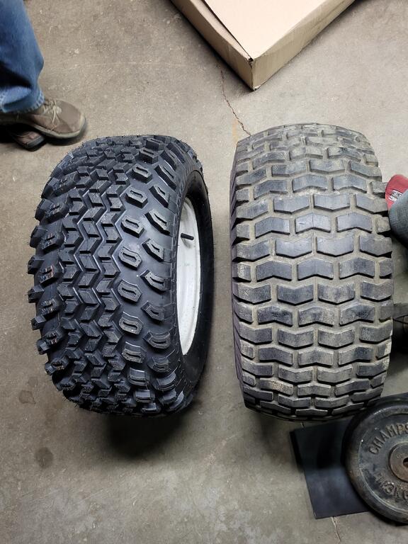

OldWorkHorse 3,153 #11608 Posted May 26, 2021 Got some new rubbers mounted up for the rear of the B-80 "FlowahPowah". Just need to get the fronts mounted and painted and she be back in business! 7 8 Share this post Link to post Share on other sites

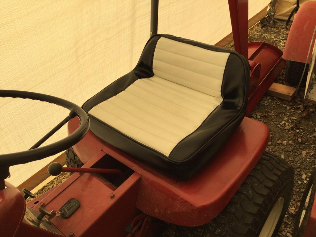

305 380 #11613 Posted May 26, 2021 Installed my new Bob Ellison seat on my Lawn Ranger 4 6 Share this post Link to post Share on other sites

Snoopy11 5,731 #11617 Posted May 26, 2021 1 hour ago, 305 said: Installed my new Bob Ellison seat on my Lawn Ranger What year do you have there, dear sir? Looks very familiar! 1967... my best guess from that picture! Don Share this post Link to post Share on other sites

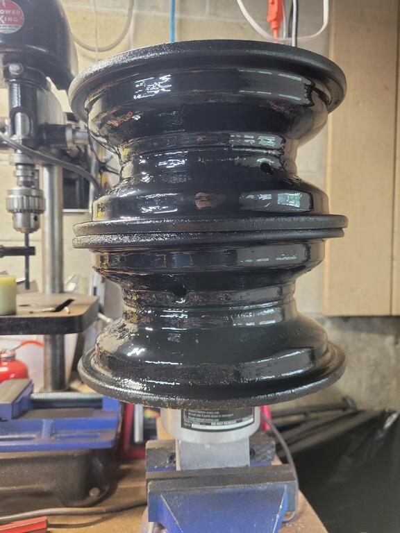

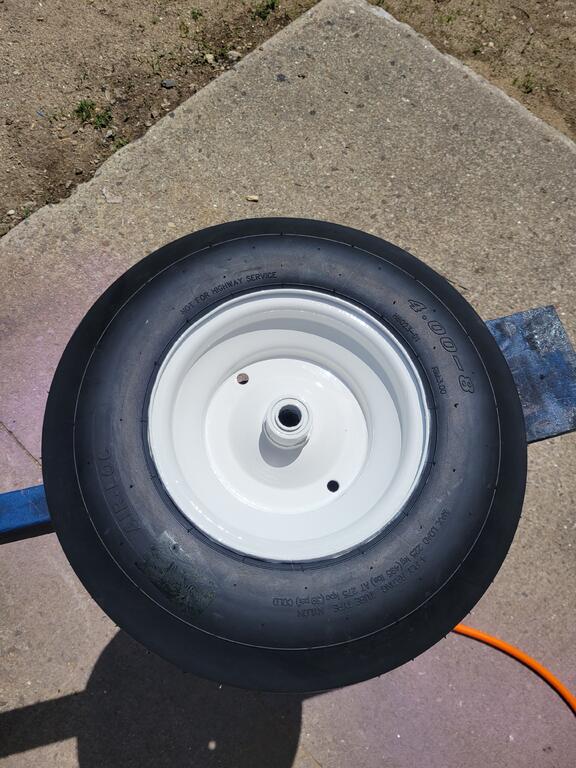

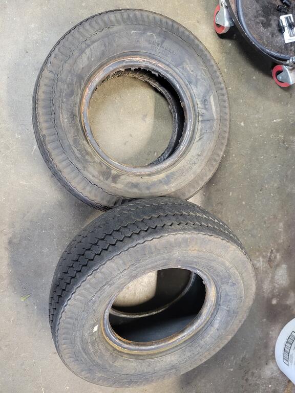

OldWorkHorse 3,153 #11623 Posted May 27, 2021 Just got the old saw tooth wheel horse tires off the rims put a coat of paint on the inside. Looked pretty good for as old as they are but either way there off so hit them with paint. Gonna let that dry and try and mount the tri rib tires here shortly. 5 3 Share this post Link to post Share on other sites

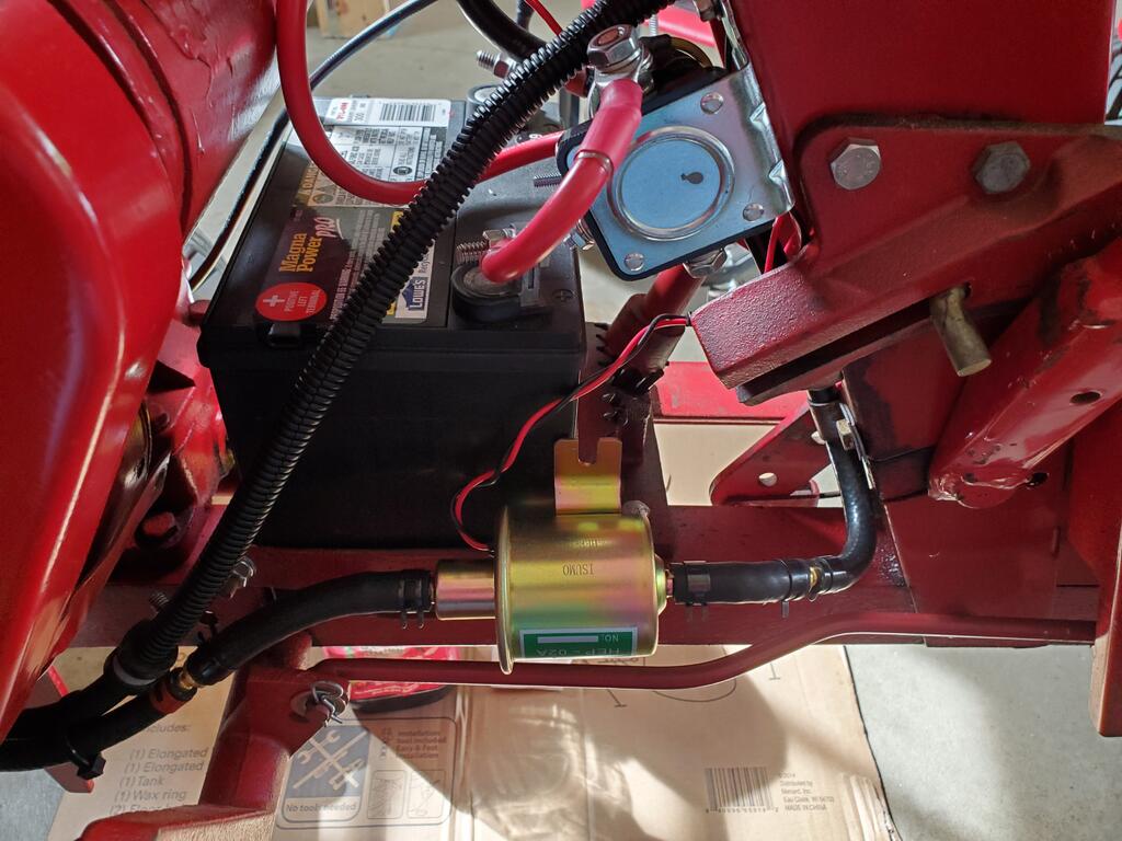

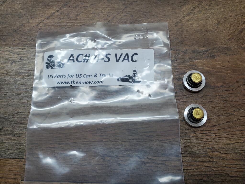

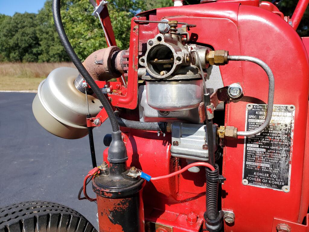

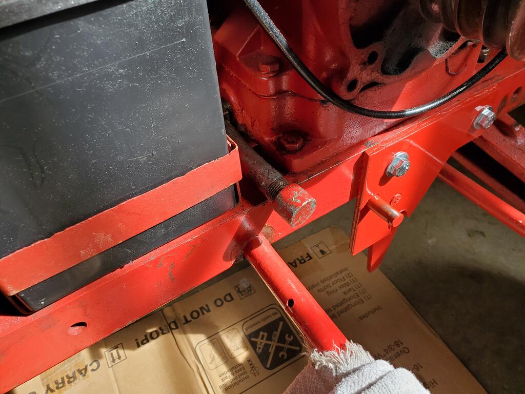

Racinbob 12,996 #11624 Posted May 27, 2021 Been doing several things to the 854. As some of you recall I did a pulley swap a while back to get a tad more speed. I have decided to put a mower deck on it so I went back to the original pulleys. This is the 854 I picked up at the 2018 big show and it came with the deck but it wasn't mounted because there was no mid mount hitch on the tractor. I didn't have a spare hitch so I found one on Ebay, painted it and slapped it on. Notice where the oil drain is. I thought it was odd coming out on the right side but I didn't think much about it. That is, until I went to install the PTO foot pedal. Ain't gonna work that way. So I'm in the process of rerouting it now. I was having issues with it starving for fuel at about 1/4 tankful. I figured it was the fuel pump and a full tank was needed to let gravity help. I cleaned it up and found that the valves in the kit weren't right. The diaphragm was bad so with hopes that was just the issue I only replaced that. It didn't help. I had two electric pumps on the shelf and I decided to use one on a temporary basis so I could remove the vacuum pump and contact Then and Now to see what's going on. I whipped up a cover for the pump hole. I did this so I didn't have to drill new holes since it's temporary. You can also see a starter solenoid. I had rewired the tractor shortly after I got it and paid the bucks for the original style switch because I kinda liked the sound of it starting without the 'click'. Let's face it, a solenoid is better. Now it's a run to the hardware store for a couple parts, finish the oil drain, remove the vacuum pump and mount the deck. I'll put her to work and I'll address the fuel pump kit issue in the next couple days. 5 1 Share this post Link to post Share on other sites

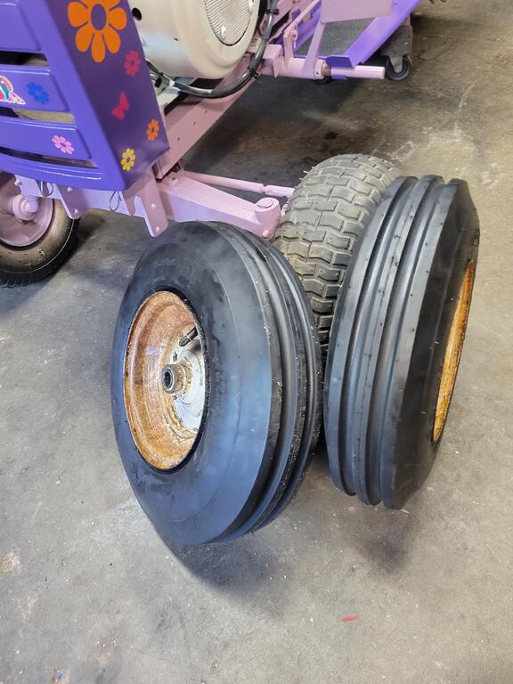

OldWorkHorse 3,153 #11625 Posted May 27, 2021 Got the new tri ribs on and began the paint process on the B80 5 5 Share this post Link to post Share on other sites
