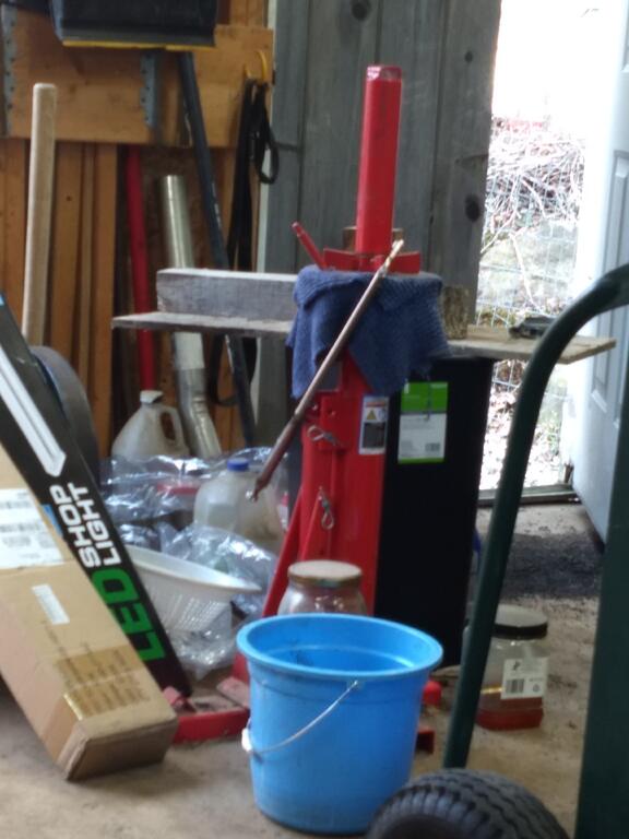

ebinmaine 79,754 #10902 Posted May 1, 2021 @OldWorkHorse Ready whenever.... 2 Share this post Link to post Share on other sites
OldWorkHorse 3,156 #10903 Posted May 1, 2021 8 minutes ago, ebinmaine said: @OldWorkHorse Ready whenever.... That's a big one! Should make fast work of these tires. Hardest part probly getting the OG WH tires off the rims lol 1 Share this post Link to post Share on other sites

ebinmaine 79,754 #10905 Posted May 2, 2021 1 hour ago, OldWorkHorse said: That's a big one! Should make fast work of these tires. Hardest part probly getting the OG WH tires off the rims lol Won't be as tough as you think with a Bear 🐻 leaning on it. 😉 1 Share this post Link to post Share on other sites

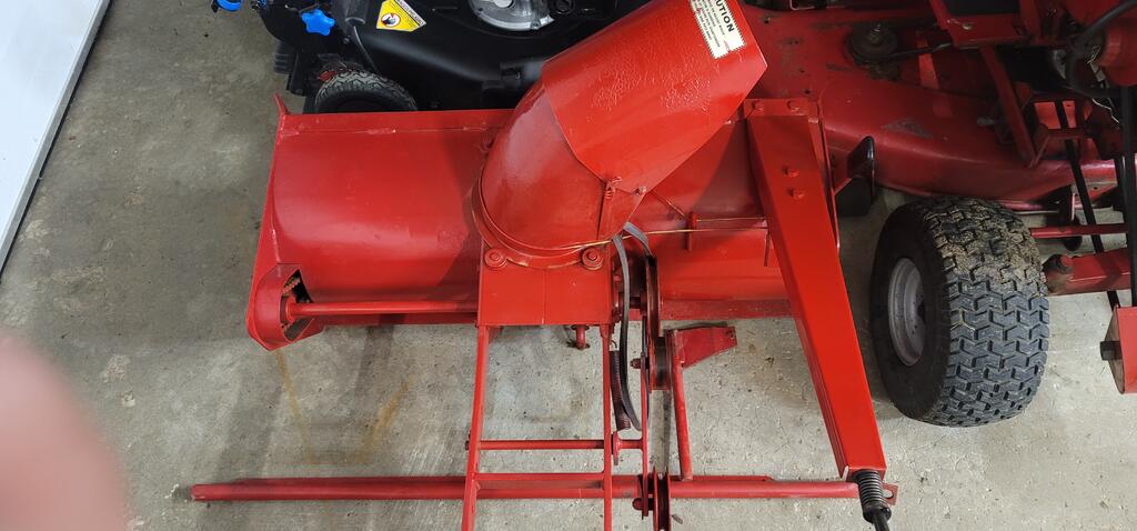

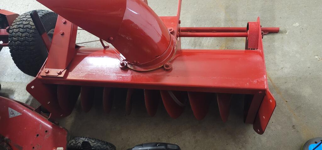

haydendavid380 759 #10906 Posted May 2, 2021 (edited) Picked up a beautiful old snow thrower that came on a Raider 12 from another local collector today. As this is the 3rd one I've bought in the last year, I'm hoping I actually got one that'll fit one of the tractors in my fleet 😆 Also got some headlight parts in from @ebinmaine , but haven't got them into action yet. Edited May 2, 2021 by haydendavid380 4 2 Share this post Link to post Share on other sites

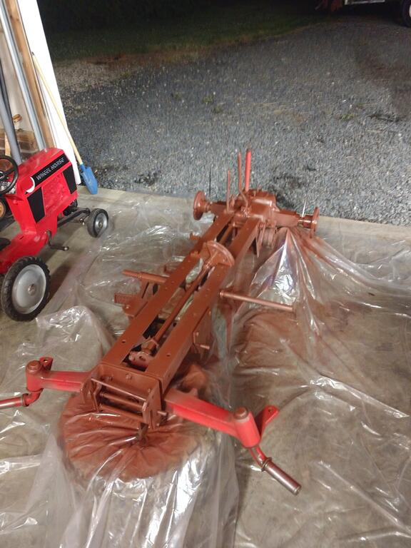

kpinnc 18,764 #10909 Posted May 2, 2021 Well I mowed the spots that my Scag won't fit. Then I did a little bit of tinkering. Full on rattle can job on the way ... 7 2 Share this post Link to post Share on other sites
Oldskool 6,678 #10910 Posted May 2, 2021 6 hours ago, kpinnc said: Well I mowed the spots that my Scag won't fit. Then I did a little bit of tinkering. Full on rattle can job on the way ... The frame is looking good, but that's one SWEET pedal tractor. I'd pedal my butt all over the yard on that bad boy 🤪. Might not be able to stand up after but so worth the ride. 1 6 Share this post Link to post Share on other sites

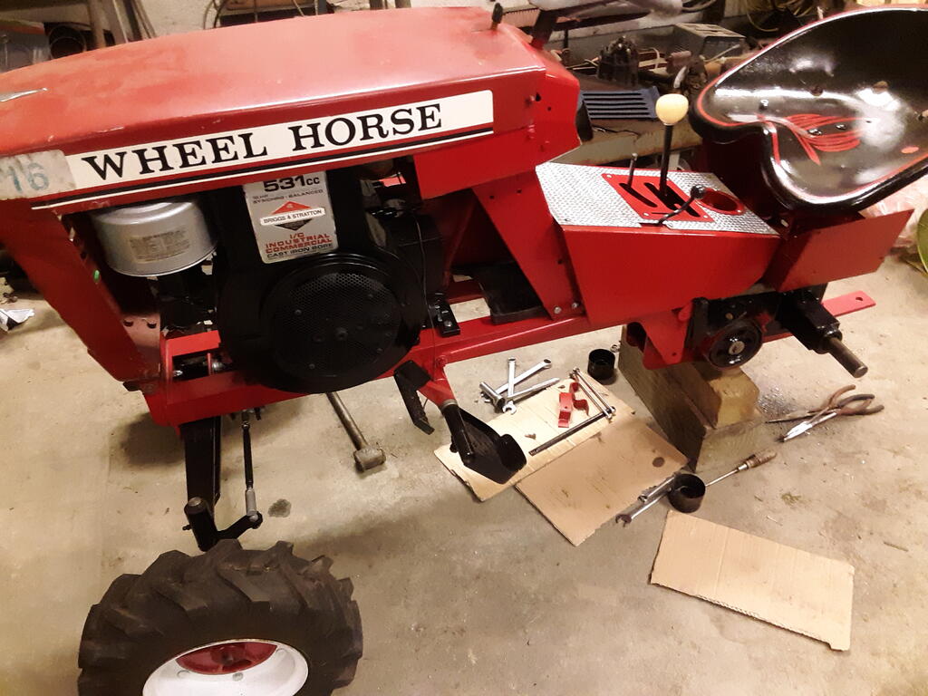

Oldskool 6,678 #10911 Posted May 2, 2021 Just getting ole Hiram put back to where we were at before a transmission malfunction. 7 2 Share this post Link to post Share on other sites

Pullstart 70,819 #10919 Posted May 2, 2021 2 hours ago, Oldskool said: Just getting ole Hiram put back to where we were at before a transmission malfunction. I’m really looking forward to seeing this one perform! 1 Share this post Link to post Share on other sites

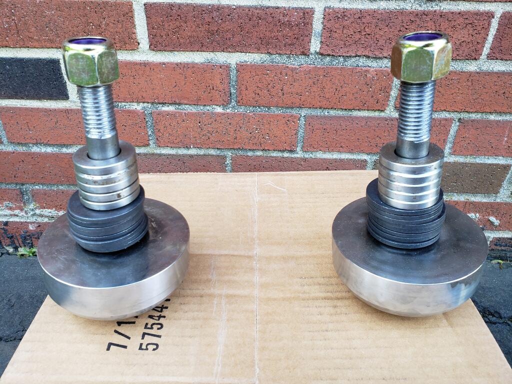

emdmat1981 62 #10920 Posted May 2, 2021 Wrong season for this .. but finally got around to adding a UHMW Strip to the 56" Plow along with a new set of Armor Shoes. Paid as much for the built to order Armor Shoes as I did for the plow (I did get it for a really good price though!) but was not impressed with anything else I could find for such a heavy plow. I went with a 4" puck mounted to a standard 3/4" shaft. Would highly recommend if anyone is looking for replacements based on the exceptional build quality. 4 Share this post Link to post Share on other sites
Oldskool 6,678 #10921 Posted May 2, 2021 22 minutes ago, pullstart said: I’m really looking forward to seeing this one perform! I'm getting so close now I can taste it. Oh wait that may be carbon monoxide and paint overspray. 4 Share this post Link to post Share on other sites

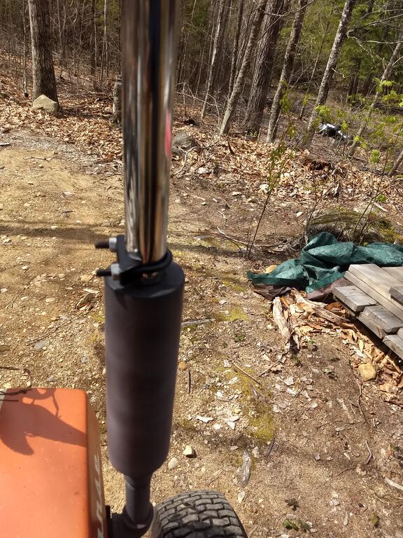

ebinmaine 79,754 #10922 Posted May 2, 2021 The exhaust stack base of the Cinnamon Horse C160 had been leaking since not long after I installed it. This morning I removed the stack and spacer. Cleaned them. Sanded them. Applied some Walker exhaust sealer. All back together so we'll see how it goes. 4 2 Share this post Link to post Share on other sites
Oldskool 6,678 #10923 Posted May 2, 2021 57 minutes ago, ebinmaine said: All back together so we'll see how it goes. Nice shot. So how long does that take to set up? 1 Share this post Link to post Share on other sites
ebinmaine 79,754 #10924 Posted May 2, 2021 12 minutes ago, Oldskool said: how long does that take to set up? Doesn't say in the packaging or directions. I let it set for 10 or 15 minutes then drove it for about the same. Seems mostly there. 2 Share this post Link to post Share on other sites
