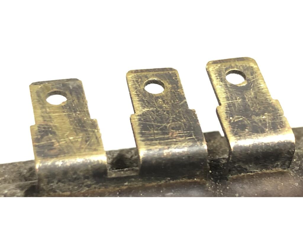

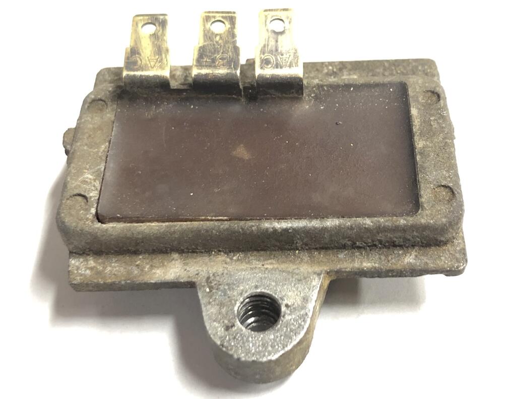

krystolo 504 #10513 Posted April 15, 2021 I replaced the rectifier/regulator with a new one. I was kind of sad that I had to toss the original. Don't guess there's any way to fix it, is there? 1 Share this post Link to post Share on other sites
Stormin 9,988 #10514 Posted April 15, 2021 Afraid not Krystolo. Well not that I know off. 1 Share this post Link to post Share on other sites
ebinmaine 80,411 #10515 Posted April 15, 2021 5 hours ago, krystolo said: I replaced the rectifier/regulator with a new one. I was kind of sad that I had to toss the original. Don't guess there's any way to fix it, is there? I'd agree with @Stormin. They're an internal non repairable as far as I know. 1 Share this post Link to post Share on other sites

Jeff-C175 7,211 #10517 Posted April 15, 2021 9 hours ago, krystolo said: Don't guess there's any way to fix it, is there? 4 hours ago, ebinmaine said: They're an internal non repairable as far as I know. I'm an 'electronics guy' by day. I had a bad one that I attempted to 'open' and repair. The 'potting compound' they use is some kind of epoxy that can't be 'melted' or otherwise removed without completely destroying the circuit board. I tried numerous methods, none worked. 4 Share this post Link to post Share on other sites

Handy Don 17,346 #10520 Posted April 15, 2021 19 minutes ago, Jeff-C175 said: I had a bad one that I attempted to 'open' and repair. The 'potting compound' they use is some kind of epoxy that can't be 'melted' or otherwise removed without completely destroying the circuit board. I tried numerous methods, none worked. A while back in another thread, a "half dead" regulator was being discussed and how one of the AC sides was linked internally to the B+ terminal on one that Jeff had "examined more closely". I pulled a dead one that I hadn't yet discarded (this is an Onan OEM for P216,218, & 220s) and took a closer look .... Found that indeed, on this unit one of the AC terminals and the B+ were together. (Note: this one died because the potting epoxy separated from the heat sink and the internals got damaged.) Share this post Link to post Share on other sites

lynnmor 9,019 #10525 Posted April 15, 2021 4 hours ago, Handy Don said: A while back in another thread, a "half dead" regulator was being discussed and how one of the AC sides was linked internally to the B+ terminal on one that Jeff had "examined more closely". I pulled a dead one that I hadn't yet discarded (this is an Onan OEM for P216,218, & 220s) and took a closer look .... Found that indeed, on this unit one of the AC terminals and the B+ were together. (Note: this one died because the potting epoxy separated from the heat sink and the internals got damaged.) Did you reverse the meter leads and test both ways on each? Share this post Link to post Share on other sites
