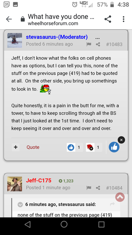

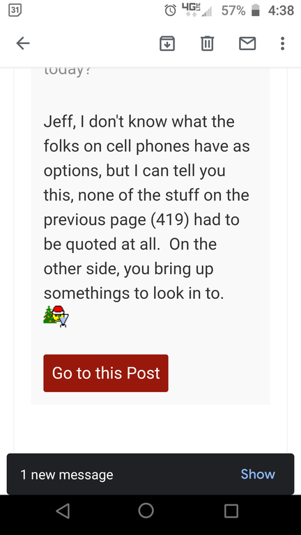

ebinmaine 80,411 #10486 Posted April 14, 2021 7 minutes ago, stevasaurus said: don't know what the folks on cell phones have as options Hey Steve I'll give you an example in two screenshots below. The first one is a shot of the email that I get which shows that somebody put a post on the thread. The second picture is a screenshot of that exact post after I have entered into the website off of the email. Note that I've changed nothing... but the type is substantially smaller in the second picture. So small in fact, that me with my bear 🐻 sausage fingers has a hard time highlighting one small word. Definitely agree with not posting the pictures over and over and on this device that's easy enough to do. Share this post Link to post Share on other sites

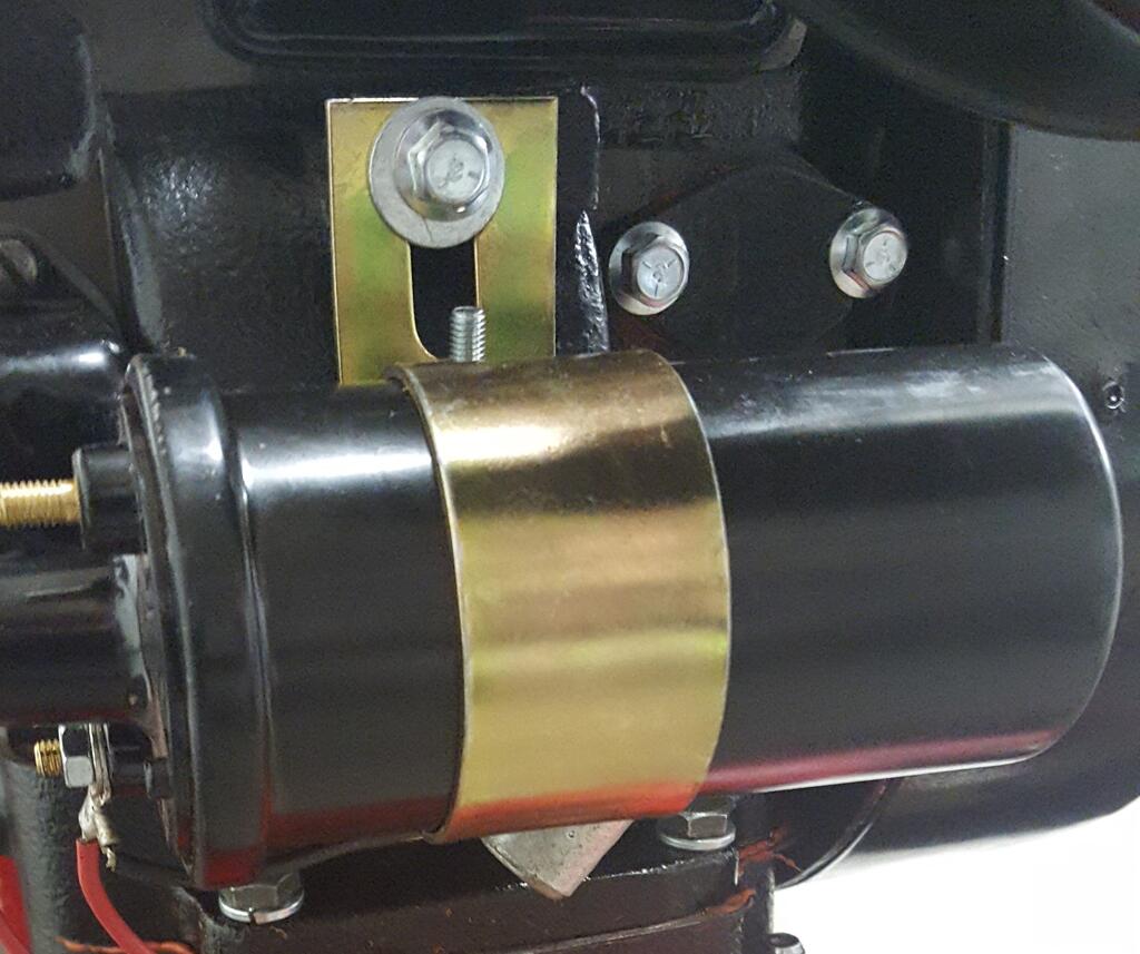

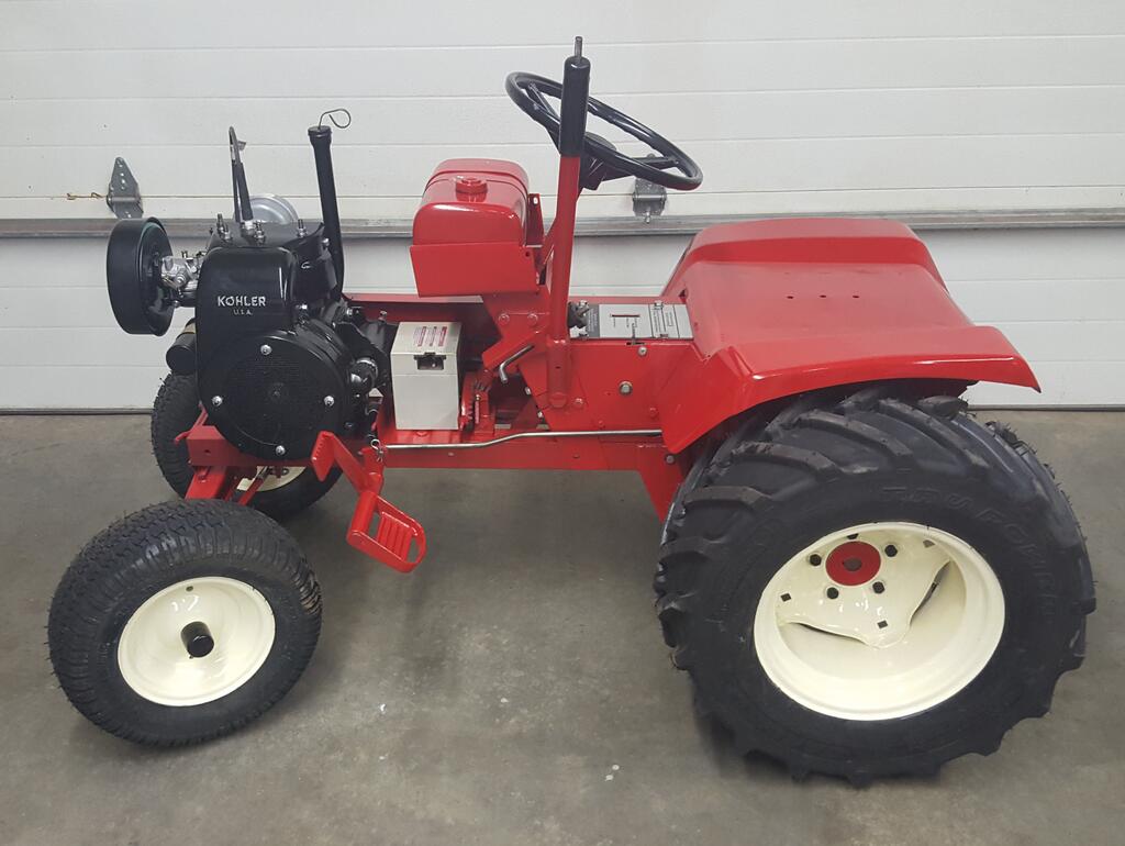

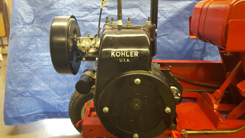

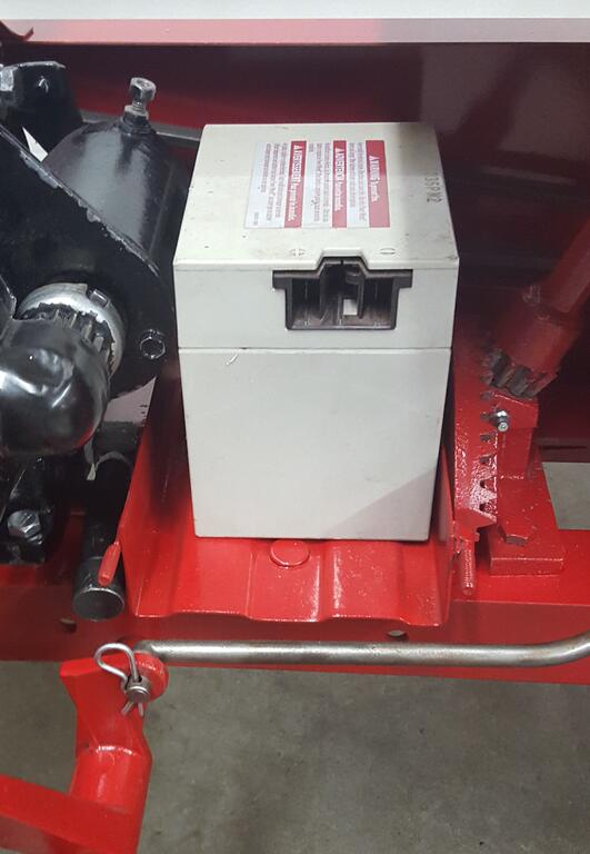

Gregor 4,848 #10497 Posted April 14, 2021 The 876 got new shoes today. No new wheels. I think I have spent my wheel budget for a while. Although, my wife hates this antique white color, sooooooooo..... I was hoping to get the new saddle today as well, but that didn't happen. I think it will be a surprise. I am trying to mount the K-181 #1 on it for now, but I am hitting a few road blocks. The correct motor in a Genny motor, this one has a typical starter. As you can see, the starter sort-a interferes with the battery box. I have my grand kids toy truck battery in it right now. I have no idea if it will spin the motor or not. It is 12v , 9.5Ah. Hopefully it will at least keep the motor running. It was magneto ignition, and I switched it to battery ignition. I have the coil mounted to the block.. Again, I don't know if tha'ts good or bad. Maybe it will transfer too much heat to the coil. The oil fill tube is much too high for the hood to fit I think. I would not be opposed to cutting it off though. I don't have the dash back from the media blaster yet either. I still don't think I have my brake/drive linkage quite right yet. One more trip to the R & D department, and I think I'll have it working correctly. I also want to install a remote, vacuum operated fuel pump. Every time I hook up one of these K161, or 181, with the #16 carb, to an electric fuel pump, I get too much fuel being thrown at it, so I will try the pulse pump. 2 3 Share this post Link to post Share on other sites
ebinmaine 80,411 #10498 Posted April 14, 2021 @Gregor I'm no battery expert but I've seen those used for small engines before. The coil will be ok if there's decent air activity around it. They don't like getting too hot. 1 Share this post Link to post Share on other sites

Jeff-C175 7,211 #10500 Posted April 14, 2021 58 minutes ago, Gregor said: I have no idea if it will spin the motor or not. It is 12v , 9.5Ah I don't think you should even try it to be honest with you. That battery is not designed for CRANKING AMPS! You could well end up frying an expensive battery right quick. If you PULL start it, it will certainly keep the engine running though. 3 Share this post Link to post Share on other sites
