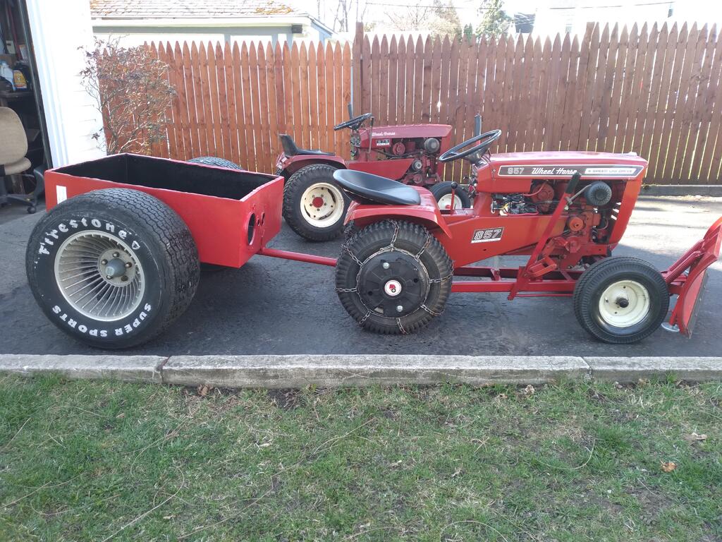

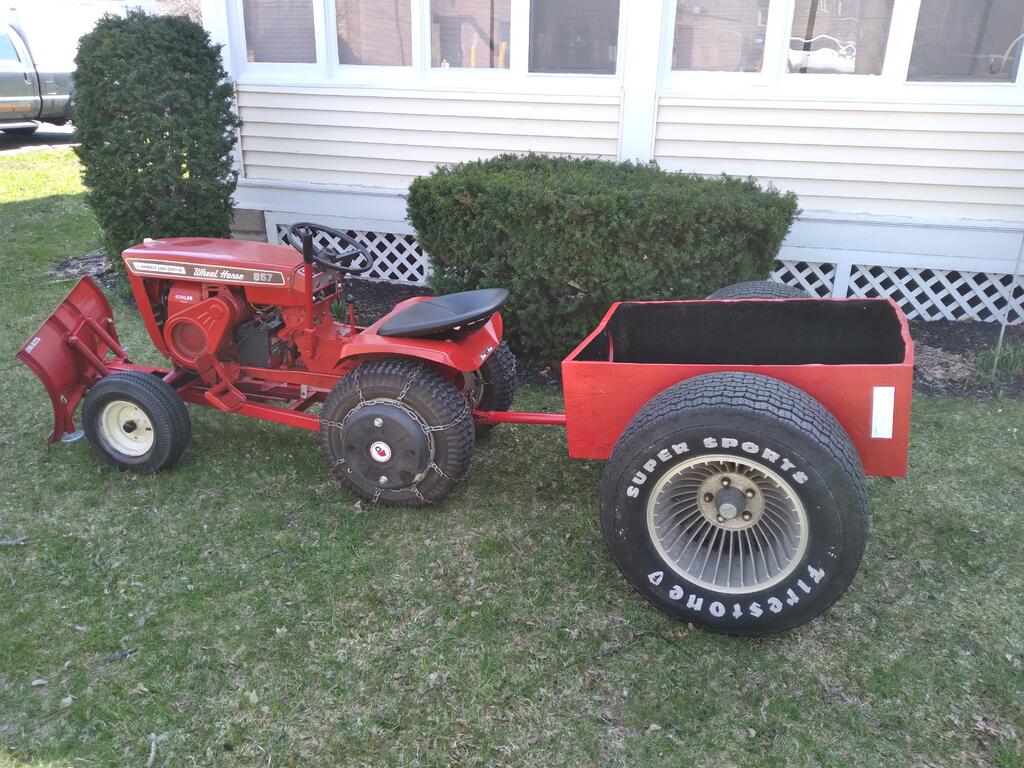

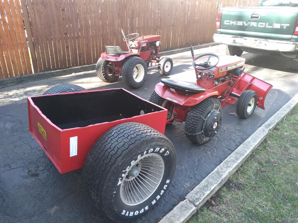

D_Mac 9,339 #10229 Posted April 6, 2021 Decided to take the 857 out for a little ride today. Hooked up the " hot rod " trailer and cruised up and down the street. Got a few waves from the neighbors. 1 9 Share this post Link to post Share on other sites

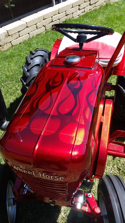

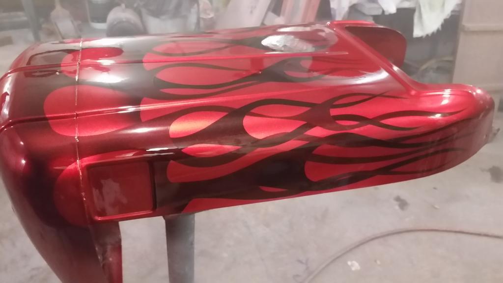

Gregor 4,848 #10230 Posted April 6, 2021 15 hours ago, Achto said: The paint on that one is House of Kolor candy apple red over a silver base coat. You specifically mentioned, "over a silver base coat". Does the paint underneath, have an effect on the top coat of all paints, or just certain paints? Share this post Link to post Share on other sites
Achto 32,845 #10231 Posted April 6, 2021 (edited) 20 minutes ago, Gregor said: You specifically mentioned, "over a silver base coat". Does the paint underneath, have an effect on the top coat of all paints, or just certain paints? Under coat can effect the top coat color on some paints. With Candy colors the base color will drastically change the color of the top coat. A little example of how the under color will change the candy top coat color. Edited April 6, 2021 by Achto 1 4 5 Share this post Link to post Share on other sites
Gregor 4,848 #10232 Posted April 6, 2021 (edited) So what color was the hoo0d painted in the end? Edited April 6, 2021 by Gregor Share this post Link to post Share on other sites
Wheel Horse 3D 3,827 #10233 Posted April 6, 2021 (edited) 1 hour ago, D_Mac said: Decided to take the 857 out for a little ride today. Hooked up the " hot rod " trailer and cruised up and down the street. Got a few waves from the neighbors. Heck of a use for an old electric service Box! Been kinda cool if it still had the door on it! Edited April 6, 2021 by Wheel Horse 3D 1 Share this post Link to post Share on other sites
ebinmaine 80,992 #10234 Posted April 6, 2021 26 minutes ago, Gregor said: You specifically mentioned, "over a silver base coat". Does the paint underneath, have an effect on the top coat of all paints, or just certain paints? Trina and I have experimented with putting WHITE OR RED PRIMER under a light red paint and also under my cinnamon paint. Under the light red paint it made quite a bit of difference but under the cinnamon paint we could see nothing... The other day she was spray painting my spindles red. There was a small area that did not have any primer. That area needed a third coat of paint because the difference was obvious. 2 Share this post Link to post Share on other sites
Achto 32,845 #10235 Posted April 6, 2021 (edited) 13 minutes ago, ebinmaine said: There was a small area that did not have any primer. That area needed a third coat of paint because the difference was obvious. Red and yellow are usually the 2 hardest colors to achieve "hiding" with. White is usually one of the easiest to achieve hiding with. When working in a body shop we would sometimes spray a similar color base down first to make it easier to cover with the correct color. Edited April 6, 2021 by Achto 3 1 Share this post Link to post Share on other sites
Achto 32,845 #10236 Posted April 6, 2021 17 minutes ago, Gregor said: Candy colors are very translucent. This is why the base color effects the candy color so drastically. 5 1 Share this post Link to post Share on other sites
WHX?? 58,307 #10237 Posted April 6, 2021 50 minutes ago, Achto said: Candy colors are very translucent. This is why the base color effects the candy color so drastically. Even then the under colors will change in different types of light. 2 Share this post Link to post Share on other sites
ebinmaine 80,992 #10238 Posted April 6, 2021 53 minutes ago, Achto said: Candy colors are very translucent. This is why the base color effects the candy color so drastically. 1 minute ago, WHX24 said: Even then the under colors will change in different types of light. And then If you really want to mess with tones add powdered pearl... 1 1 Share this post Link to post Share on other sites

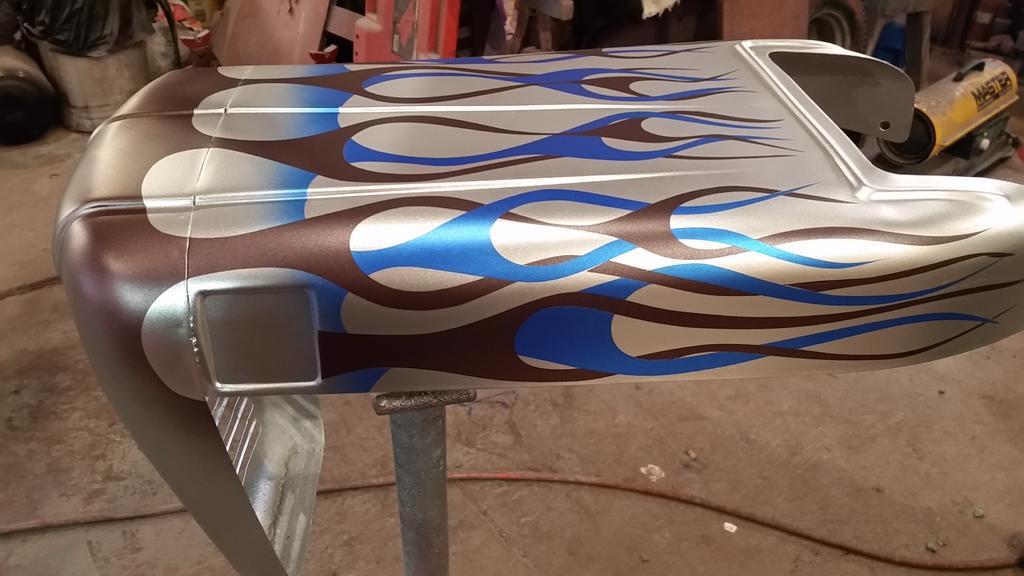

Achto 32,845 #10239 Posted April 6, 2021 (edited) 1 hour ago, Gregor said: So what color was the hoo0d painted in the end? The hood was first painted silver with blue & charcoal flames. Then 3 coats of Candy Apple Red was sprayed over the top of these base colors. This resulted in 3 different colors of red. Giving a "Ghost Flame" effect. After the 3 coats of candy apple red, three coats of urethane clear was applied for UV protection, Edited April 6, 2021 by Achto 1 3 Share this post Link to post Share on other sites
WHX?? 58,307 #10240 Posted April 6, 2021 In direct sunlight...the orange thing is the camera ... pics have a hard time capturing it. 5 6 Share this post Link to post Share on other sites
ebinmaine 80,992 #10241 Posted April 6, 2021 Preeeeetyyyy Share this post Link to post Share on other sites
Gregor 4,848 #10242 Posted April 6, 2021 You busy tomorrow? 5 Share this post Link to post Share on other sites
Tractorhead 9,217 #10243 Posted April 6, 2021 It has a fantastic look, and i like it very much. Some colors develops different color shades especially in sunlight. I also love the strong glossy on the top surface. I be completely unable to do that, I'm far too impatient for that, but i love it to see in result. 2 1 Share this post Link to post Share on other sites

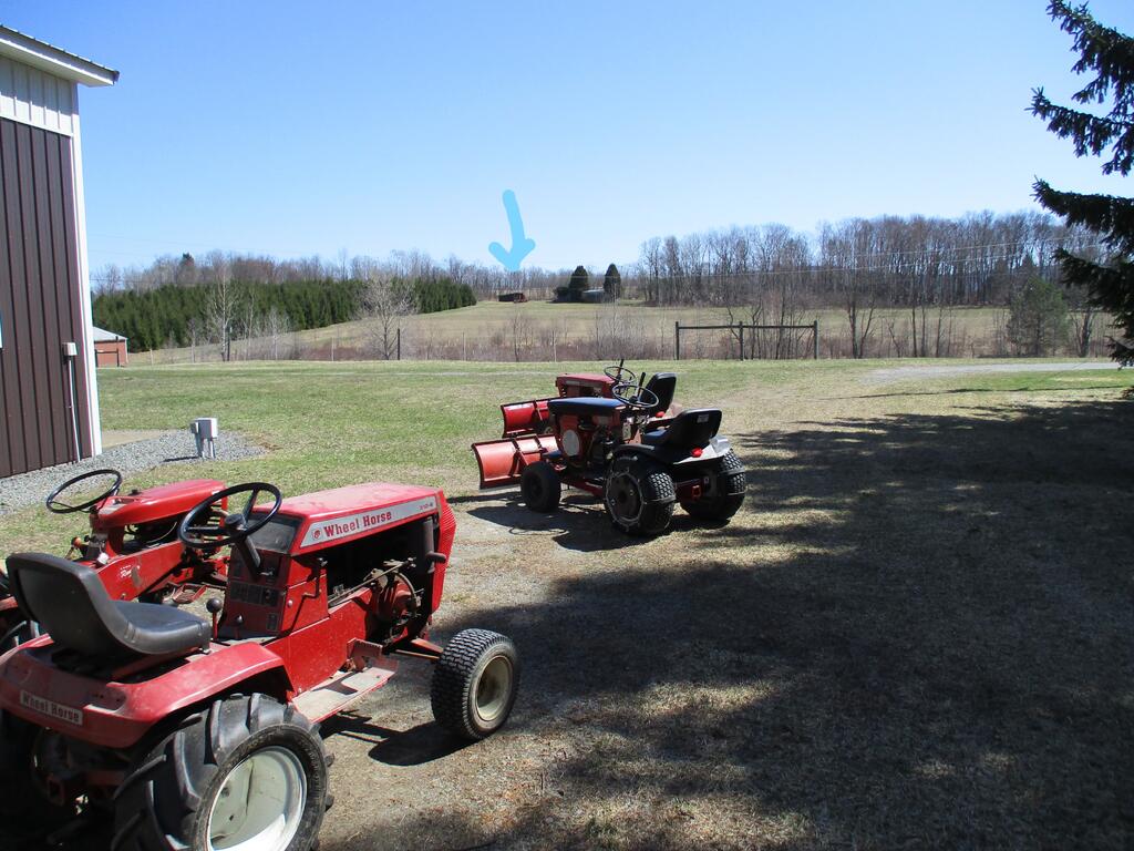

pfrederi 21,238 #10245 Posted April 6, 2021 Seasonal swap day. two plows and a blower up to the shed (blue arrow) two mower deck tractors down to the shop. Manged to squeeze 7 horses into the shed. only one issue Electro 16 mower had a flat tire... 8 1 Share this post Link to post Share on other sites

squonk 48,231 #10248 Posted April 6, 2021 18 minutes ago, pfrederi said: Seasonal swap day. two plows and a blower up to the shed (blue arrow) two mower deck tractors down to the shop. Manged to squeeze 7 horses into the shed. only one issue Electro 16 mower had a flat tire... Better fill up the tanks and empty one before making the trek! 3 Share this post Link to post Share on other sites
D_Mac 9,339 #10249 Posted April 6, 2021 2 hours ago, Wheel Horse 3D said: Heck of a use for an old electric service Box! Been kinda cool if it still had the door on it! Is that what it was? I have no idea what it was in its previous life. I have some chrome bumper parts off a 57 chevy I might add to it. 1 1 Share this post Link to post Share on other sites
Wheel Horse 3D 3,827 #10250 Posted April 6, 2021 (edited) 21 minutes ago, D_Mac said: Is that what it was? I have no idea what it was in its previous life. I have some chrome bumper parts off a 57 chevy I might add to it. Im pretty sure thats what it was...the main power would have come down in a metal conduit to that big hole, and the meter and maybe some breakers, and then smaller wiring out the smaller holes to wherever. And there would have been a metal door over the whole thing with maybe a hole for the meter face to stick through. As far as service boxes go that would have been a monster! Bumpers would be a nice addition! Edited April 6, 2021 by Wheel Horse 3D 2 Share this post Link to post Share on other sites
