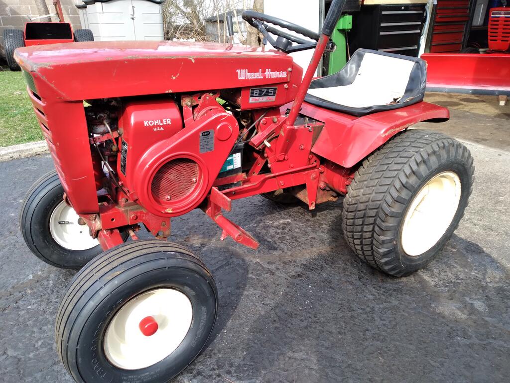

squonk 48,231 #10201 Posted April 5, 2021 (edited) "Well I cleaned off the points and put a new spark plug on 875. Connected some jumper cables from my truck to the tractor. Hit the button and it spun around and around and nothing." Did it spin real fast like the starter was on steroids? If it did it may be ,stuck valve, Broken rod or even a broken cam. Do the points open and close whilst cranking. If they don't move that points to the cam broken or not turning. Edited April 5, 2021 by squonk 1 1 Share this post Link to post Share on other sites

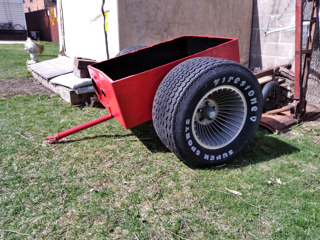

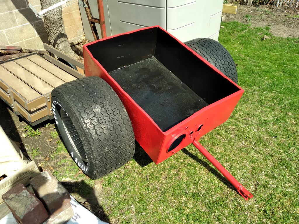

Oldskool 6,678 #10202 Posted April 5, 2021 1 hour ago, D_Mac said: Well I cleaned off the points and put a new spark plug on 875. Connected some jumper cables from my truck to the tractor. Hit the button and it spun around and around and nothing. Pulled the plug and cleaned the points again. Left the plug out to see if I was getting spark and no spark. Disappointed so I turned my attention to the hot rod trailer. Put some fresh paint on it and decided I liked it not so fresh. Taking the tractor to a friend's for help. Keep you updated. Did you check the new spark plug. It's not common but I have had bad plugs rite out of the box. 1 1 Share this post Link to post Share on other sites
Oldskool 6,678 #10203 Posted April 5, 2021 1 hour ago, D_Mac said: Well I cleaned off the points and put a new spark plug on 875. Connected some jumper cables from my truck to the tractor. Hit the button and it spun around and around and nothing. Pulled the plug and cleaned the points again. Left the plug out to see if I was getting spark and no spark. Disappointed so I turned my attention to the hot rod trailer. Put some fresh paint on it and decided I liked it not so fresh. Taking the tractor to a friend's for help. Keep you updated. Did you check the new spark plug. It's not common but I have had bad plugs rite out of the box. Share this post Link to post Share on other sites
Lee1977 7,805 #10204 Posted April 5, 2021 The U S Navy issued me some tools back in 1967 and said take good care of them, so I did still have some of them. I would guess the New York Central Railroad did the same. 2 hours ago, pfrederi said: Getting ready to put the snow horses to bed for the summer. Did some straightening of the blower assisted by the New York Central Railroad..Father "borrowed" the wrench about 1930 when he worked at the West Albany Shops (stamped N.Y.C.L)...... Central is gone, Shops are gone Father is gone 2 Share this post Link to post Share on other sites
D_Mac 9,339 #10205 Posted April 5, 2021 1 hour ago, squonk said: "Well I cleaned off the points and put a new spark plug on 875. Connected some jumper cables from my truck to the tractor. Hit the button and it spun around and around and nothing." Did it spin real fast like the starter was on steroids? If it did it may be ,stuck valve, Broken rod or even a broken cam. Do the points open and close whilst cranking. If they don't move that points to the cam broken or not turning. The points opened and closed. There was a noise that didnt seem to be normal but I dont think it was coming from the engine. It seemed to be coming from behind the drive belt guard on the right side. I tried two plugs. When I picked it up from previous owner the wire from the coil to the spark was disconnected at the coil end. Seemed to be wet in there so maybe its bad coil or wire. I did apply some decals. 4 1 Share this post Link to post Share on other sites
squonk 48,231 #10206 Posted April 5, 2021 Better look at the belt drive area good. Could be the idler pulley ready to hand grenade under the belt guard or the hydro fan screen ready to detonate. 1 Share this post Link to post Share on other sites

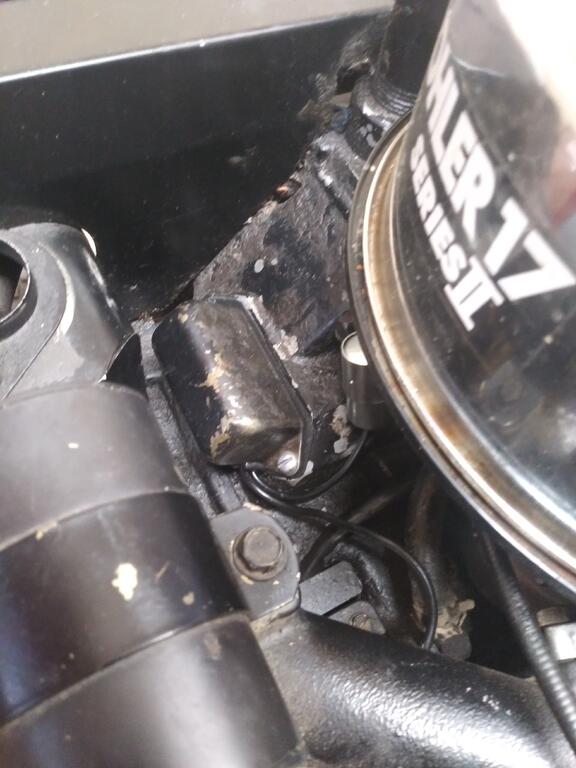

Cee245 861 #10210 Posted April 5, 2021 The last few days... I took apart the 97 416H, Onan P216, decarboned the pistons and heads, cleaned all the fins etc. Put all new gaskets, new oil pressure sensor, cleaned carb and drilled holes in belt cover to help dissipate heat. Still have to finish up some stuff, but lots done. On my 417A, I kept messing with the points cover. Ugh. I have new kohler points and condenser, also replaced the wire from the coil. When I tighten the 2 cover screws, it cuts out... I can run it, then tighten the screw and before it shuts off, loosen it and it runs... ??? I have a video as well. 1 Share this post Link to post Share on other sites
953 nut 69,858 #10211 Posted April 5, 2021 18 minutes ago, Cee245 said: When I tighten the 2 cover screws, it cuts out... I can run it, then tighten the screw and before it shuts off, loosen it and it runs.. Pinching the wire? There is a small notch and a rubber grommet on one end of the points cover. 1 Share this post Link to post Share on other sites
Cee245 861 #10212 Posted April 5, 2021 Right. I have the grommet in place with wires where they should be I think. They are not tight either. I'm stumped. Share this post Link to post Share on other sites
19richie66 17,937 #10213 Posted April 5, 2021 (edited) Is there a gasket under the cover? Possible the points are touching the inside of the cover and grounding out? I now see the gasket. Edited April 5, 2021 by 19richie66 2 Share this post Link to post Share on other sites
953 nut 69,858 #10214 Posted April 5, 2021 or the terminal on the new wire may need to be wrapped with tape. 1 Share this post Link to post Share on other sites
Cee245 861 #10215 Posted April 5, 2021 Yes it has the gasket... I will try taping. It's gotta be shorting out somehow! 2 Share this post Link to post Share on other sites
