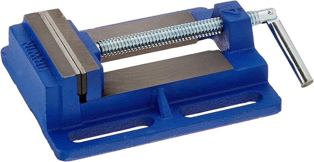

OldWorkHorse 3,156 #10106 Posted April 1, 2021 (edited) 2 hours ago, Gregor said: I am a little curious as to how yo jigged that up in your drill press, for drilling. Used 1 of these bolted to drill press table, oh yeah incase you don't already know i drilled out both ends with a 25/64th drill bit so could tap them with 7/16x20 thred. Edited April 1, 2021 by OldWorkHorse 1 Share this post Link to post Share on other sites

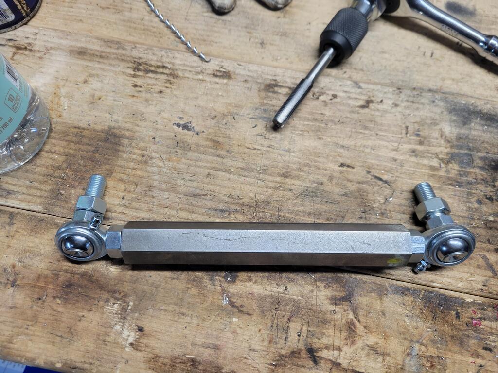

Gregor 4,848 #10107 Posted April 1, 2021 While I do like the look of the hex, I got to thinking about how I was going to cut 7/8" steel hex, and suddenly, my arm got really tired. I already had these materials ordered, and on hand, so I made these up for the 656. 6 1 Share this post Link to post Share on other sites

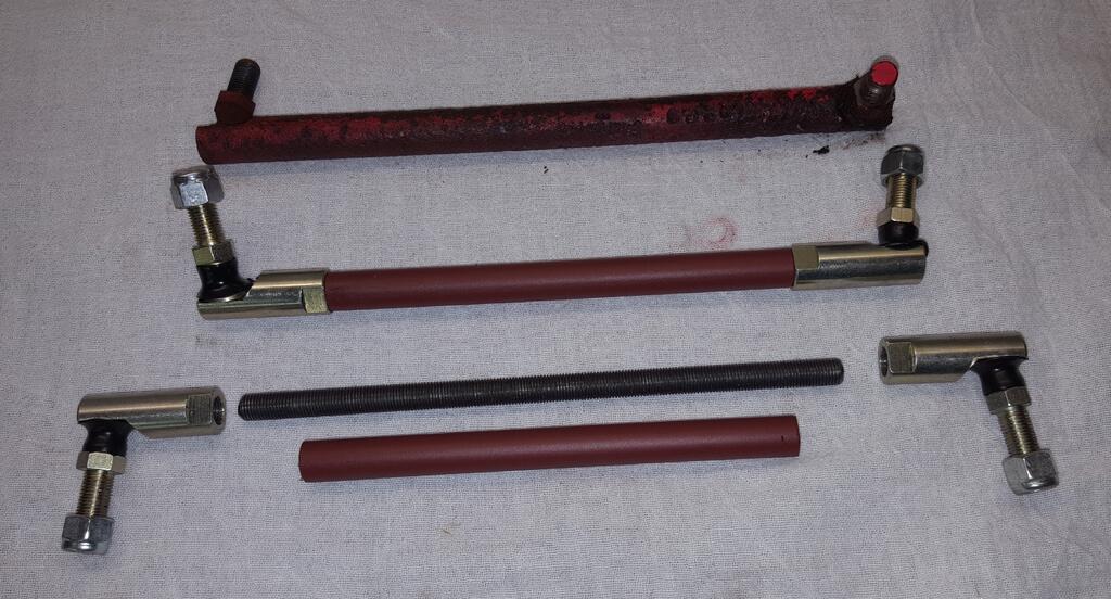

pfrederi 21,238 #10116 Posted April 1, 2021 45 minutes ago, Gregor said: While I do like the look of the hex, I got to thinking about how I was going to cut 7/8" steel hex, and suddenly, my arm got really tired. I already had these materials ordered, and on hand, so I made these up for the 656. This is what I use for making new ones. I know some people use heim joints. My theory is the original ball joints have lasted 40-50 years. These are better sealed and should last just as long. Don't see the need for the heims... 1 Share this post Link to post Share on other sites
