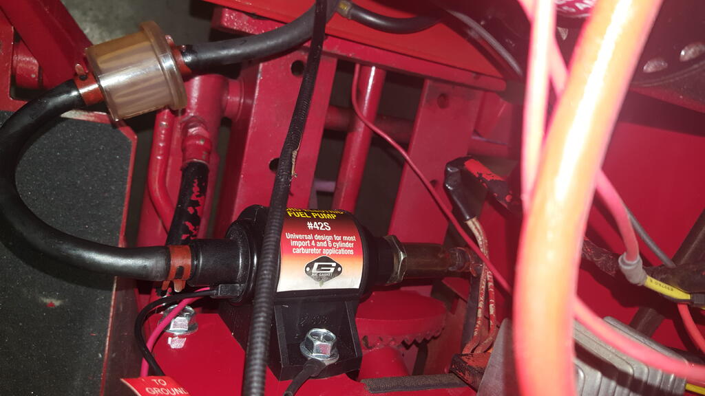

Gregor 4,848 #10027 Posted March 28, 2021 (edited) Since I can't find my Lawn Boy parts, and I'm sitting here waiting on parts for the 181, and parts from the stripper, and doing nothing, I replaced the cheap $14 fuel pump on the 141, with this one, suggested by another member. I didn't have a lot of faith in the other one. Not much to write home about, but it's something. I forgot to ask. Do you use tape on fuel lines? The only reason I do is because I saw Taryl Dactl do it. I don't know if it stands up to gas or not. Edited March 28, 2021 by Gregor Share this post Link to post Share on other sites
lynnmor 9,051 #10028 Posted March 28, 2021 1 hour ago, Gregor said: Do you use tape on fuel lines? The only reason I do is because I saw Taryl Dactl do it. I don't know if it stands up to gas or not. I use Teflon tape on the threaded fittings with no problem, be careful to not add it to the end of the threads to keep it from getting shreds in the gas. I see you have fuel filters before and after the pump. 2 Share this post Link to post Share on other sites

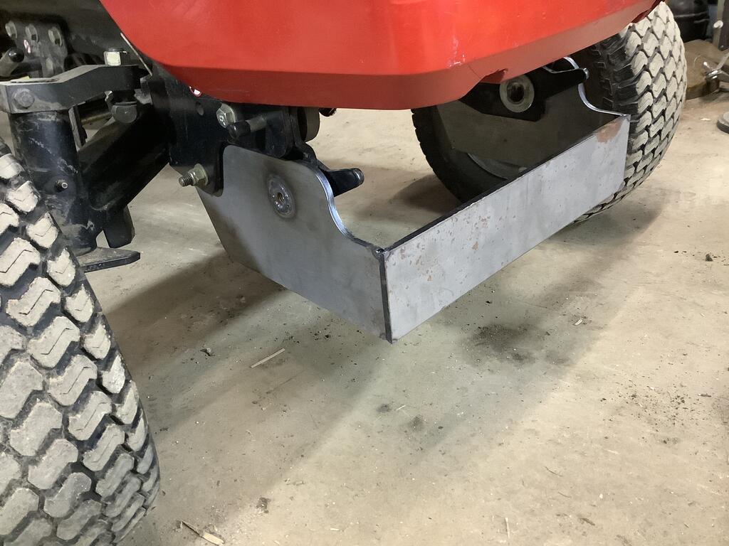

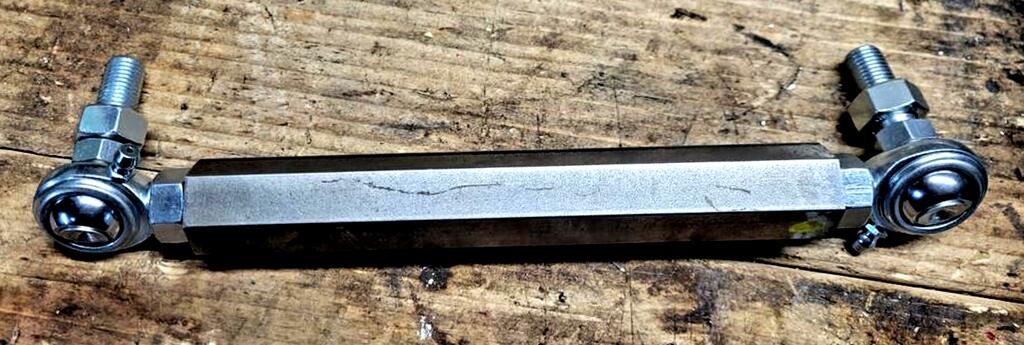

OldWorkHorse 3,156 #10029 Posted March 28, 2021 Its raining out so cant paint, so started making couple tie rods for the 1257Heavy. 4 5 Share this post Link to post Share on other sites
Ed Kennell 47,629 #10030 Posted March 28, 2021 Looks like a good way to add some weight to the front end. 2 1 Share this post Link to post Share on other sites
ebinmaine 80,994 #10031 Posted March 29, 2021 2 hours ago, OldWorkHorse said: Its raining out so cant paint, so started making couple tie rods for the 1257Heavy. Nice work mistah. Align the piece in the drill press ok?? 2 1 Share this post Link to post Share on other sites

OldWorkHorse 3,156 #10033 Posted March 29, 2021 22 minutes ago, ebinmaine said: Nice work mistah. Align the piece in the drill press ok?? Yeah drilled like buttah, that hex shape really helps! Also unique and looks awesome probly adds like 2hp! 1 1 Share this post Link to post Share on other sites

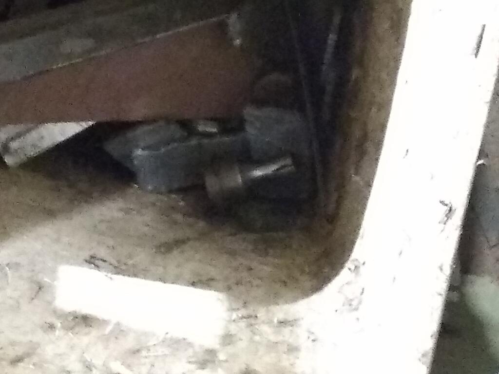

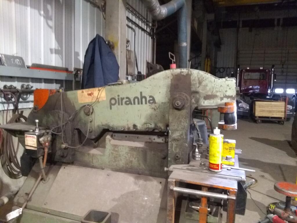

ebinmaine 80,994 #10035 Posted March 29, 2021 Trina and I took a trip up to Augusta today to have our friend help us with a few metal working projects. Here's pics of the plow blade (skid steer blade) I got from the jungle site. This is HARD metal. Our friend has been at this job doing commercial truck building and repair for decades. Never seen the Piranha metal puncher smash a bit. This is the scrap bucket... Here's the machine. We ended up using a plasma cutter to start the holes and air tools to finish to size. 6 Share this post Link to post Share on other sites

peter lena 10,092 #10038 Posted March 29, 2021 oldworkhorse, like the tye rod make up, been using heim joints for years on any movement point, with zero maintenance failures. like , pto lever rod, clutch linkage, snow plow lever swing arm , steering quadrant , makes any unstable swing point a very smooth and solid movement point , why not improve a problem area ? pete 1 1 Share this post Link to post Share on other sites
AMC RULES 37,260 #10039 Posted March 29, 2021 14 hours ago, OldWorkHorse said: Its raining out so cant paint, so started making couple tie rods for the 1257Heavy. Definitely wanting a set of those! 👍👍 4 Share this post Link to post Share on other sites
OldWorkHorse 3,156 #10040 Posted March 29, 2021 2 minutes ago, peter lena said: why not improve a problem area ? pete For sure it's a quick simple fix! They seem to move much more freely then the stock tie rods plus ones that were on this 1257 are about 50+ years old and the socket was badly worn. So figured I'd seen alot of people upgrade the stock tie rods don't think I'll have to worrie about these anytime soon 4 Share this post Link to post Share on other sites

OldWorkHorse 3,156 #10042 Posted March 29, 2021 1 minute ago, AMC RULES said: Definitely wanting a set of those! 👍👍 This my 1st time attempting them but I think each tie rod with 7/8 hex and 2 7/16x20 heim joints cost me $20? Not a bad investment of I say so. 2 Share this post Link to post Share on other sites

OldWorkHorse 3,156 #10047 Posted March 29, 2021 Just now, AMC RULES said: Sign me up please! For sure my 1st attempt so let me make sure my math works and the tie rods work dnt wanna mail paper weights lol 1 Share this post Link to post Share on other sites
