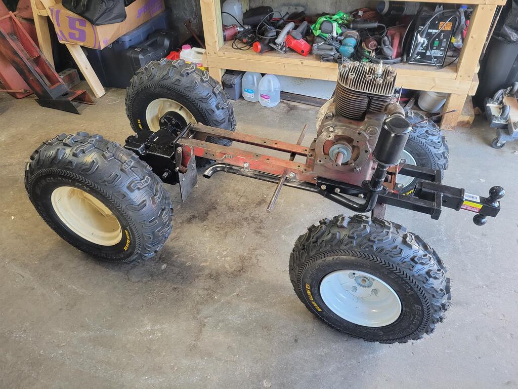

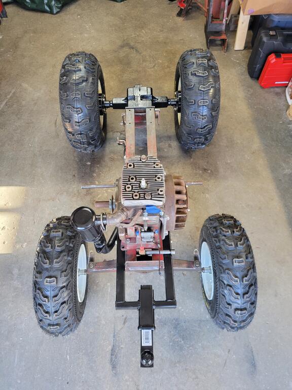

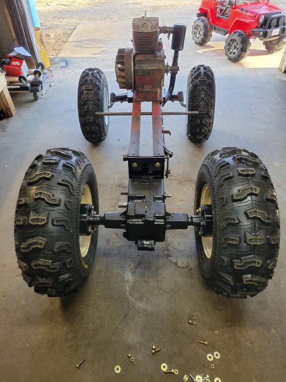

OldWorkHorse 3,156 #9915 Posted March 23, 2021 Well the 1257H is 100% a roller now. Transmission fully bolted in hubs fully installed spacers installed and rims drilled and bolted to the spacers! 4 8 Share this post Link to post Share on other sites

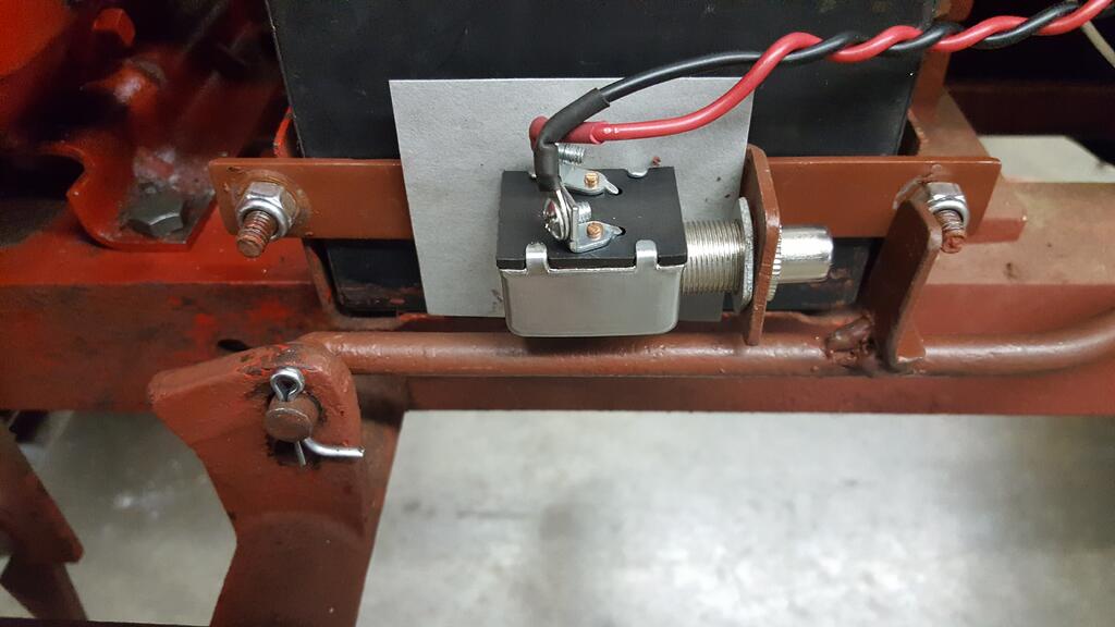

Gregor 4,848 #9921 Posted March 23, 2021 My 656 does not have any safety lock out switches. No seat switch, neutral switch, brake interlock switch, or anything like that. Believe ot or not, after all the trouble that little Tecumseh caused me, it starts and runs perfect. Sometimes too perfect. When it's warm, it will start with barely a bump of the key. More than once I have almost ran into one of our vehicles when I start it in the driveway. So, I installed a momentary contact switch between the ignition switch, and the solenoid, activated by pushing the brake pedal. I know, all I have to do is put it in neutral, problem solved, but.....I have 3 tractors in the garage I move out each morning, weather permitting. (Neighbors just love me a 4:30 AM) and sometimes it's hard for an old guy to remember just which tractor he is on.There is fish paper betwen the switch and battery hold plate. I need to find some small wire loom. As a side note, with the mess I have in here today, you would have thought I completed a lot of things, but I didn't. One of those days where everything had to be done twice, at least. I hate those days. 3 1 1 Share this post Link to post Share on other sites
