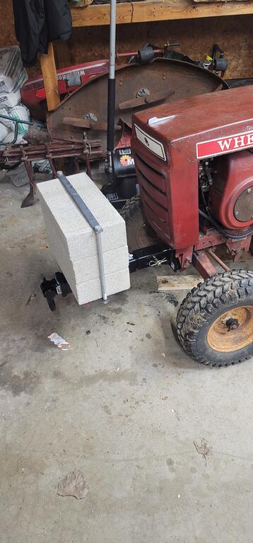

haydendavid380 759 #9802 Posted March 19, 2021 Got the B-80 weighted down up front. All ready to turn some dirt on Sunday. 2 Share this post Link to post Share on other sites

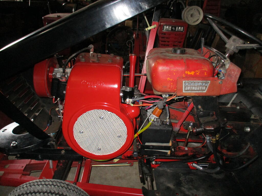

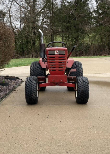

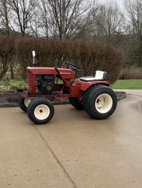

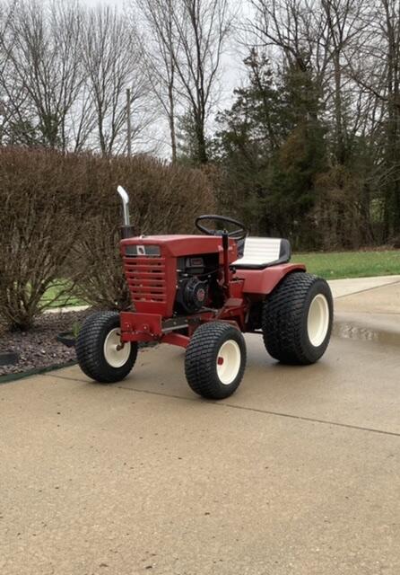

cschannuth 3,821 #9803 Posted March 19, 2021 After I got the charger 12 I put the tires and wheels on it from my rat 606. So for the 606 I decided to use the tires that came on the 520 that I turned into my loader tractor that I got from Horsefixer. They were like new but I wanted Ags and Vred 18 inch tires on the loader 520. I had the rear wheels fabbed for a little extra width and I really like how the larger tires look on the 606. 8 3 1 Share this post Link to post Share on other sites
ebinmaine 79,767 #9804 Posted March 19, 2021 6 hours ago, cschannuth said: larger tires VERY nice. I do like a nice wide rear. On a tractor. 2 2 2 Share this post Link to post Share on other sites
cschannuth 3,821 #9805 Posted March 19, 2021 (edited) 2 hours ago, ebinmaine said: VERY nice. I do like a nice wide rear. On a tractor. I was worried it might steer hard because I went from a narrow tri-rib to those 7.50 in front but with plenty of air in them I really can’t tell a lot of difference on that light tractor. Edited March 19, 2021 by cschannuth 1 Share this post Link to post Share on other sites
Horse Newbie 7,405 #9806 Posted March 19, 2021 7 hours ago, ebinmaine said: VERY nice. I do like a nice wide rear. On a tractor. I prefer no wider than necessary... 2 2 Share this post Link to post Share on other sites
Ed Kennell 46,641 #9807 Posted March 19, 2021 8 hours ago, ebinmaine said: I do like a nice wide rear. 8 Share this post Link to post Share on other sites

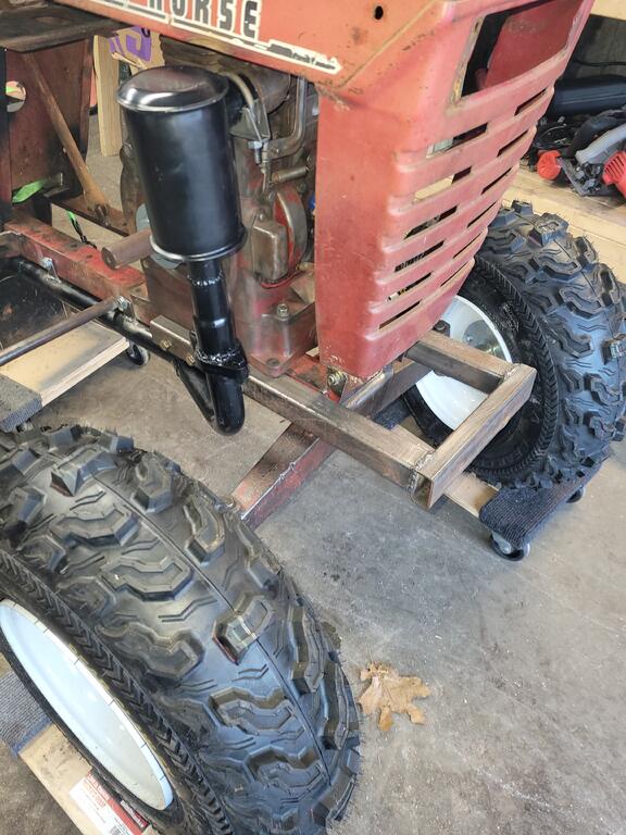

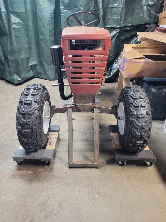

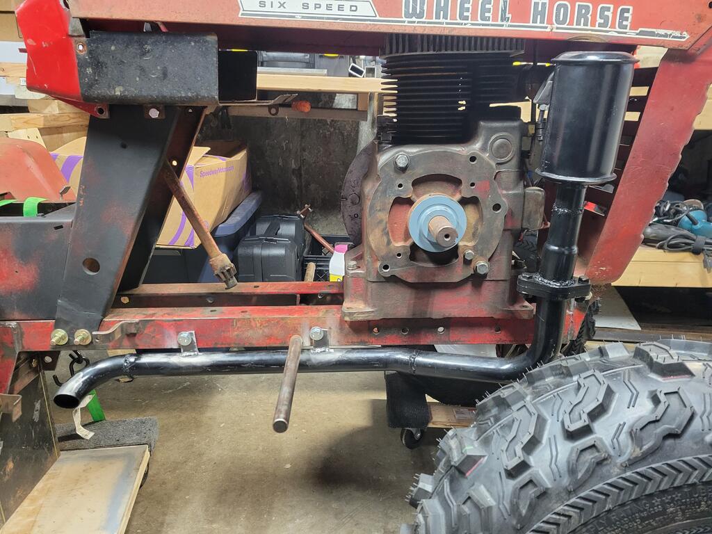

OldWorkHorse 3,156 #9809 Posted March 19, 2021 Worked on the 1257Heavy project today, put couple exhaust tabs on for support and started building a front bumper! Coming along slowly but nicely! 8 3 Share this post Link to post Share on other sites

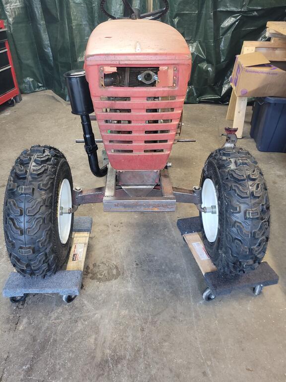

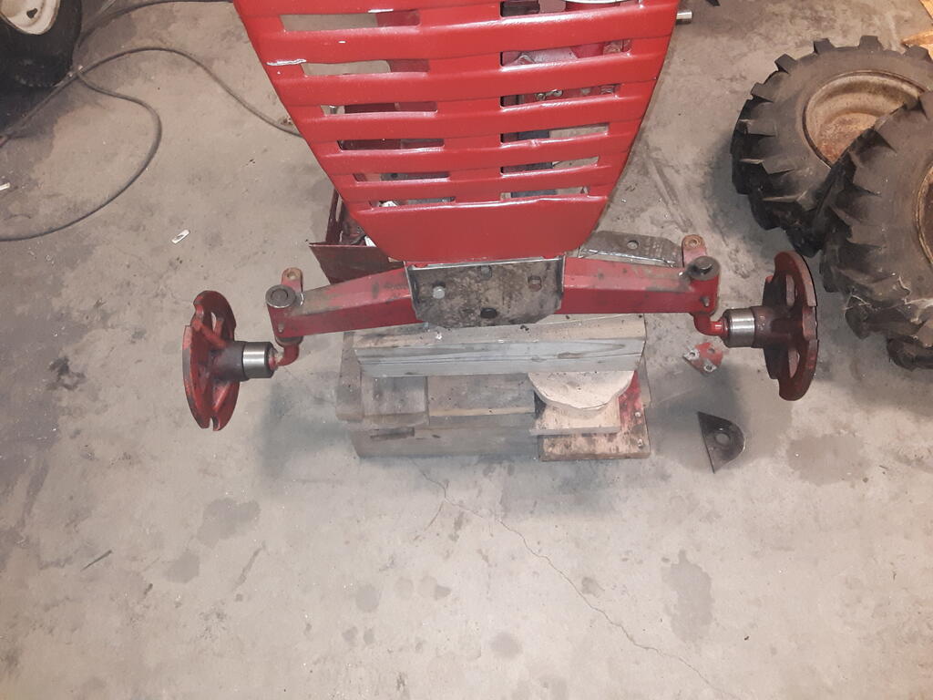

Oldskool 6,678 #9814 Posted March 20, 2021 40 minutes ago, Tuneup said: We should make a goal for this weekend to get this thread to 400 pages, no less! I'll help out. I'm all horse all day today. Finished my front hubs this morning. 7 1 1 Share this post Link to post Share on other sites
ebinmaine 79,767 #9815 Posted March 20, 2021 22 minutes ago, Oldskool said: I'll help out. I'm all horse all day today. Finished my front hubs this morning. Find you some front sneakers for that beast yet? 2 Share this post Link to post Share on other sites
Gregor 4,848 #9816 Posted March 20, 2021 27 minutes ago, Oldskool said: Finished my front hubs this morning. Did you have the center of those spindles bored out? I'd like to do that to a couple of tractors. 1 Share this post Link to post Share on other sites
Oldskool 6,678 #9817 Posted March 20, 2021 21 minutes ago, ebinmaine said: Find you some front sneakers for that beast yet? I'm going to run AGs on it for now. I should have them on today 1 Share this post Link to post Share on other sites
Oldskool 6,678 #9818 Posted March 20, 2021 17 minutes ago, Gregor said: Did you have the center of those spindles bored out? I'd like to do that to a couple of tractors. Those hubs are Gravely. They were tapered and keyed. I drill them out on the drill press. Slow process. The shiny pieces were done on a lathe. Bushings/spacers. Assembled then line bored on the lathe. 1 Share this post Link to post Share on other sites

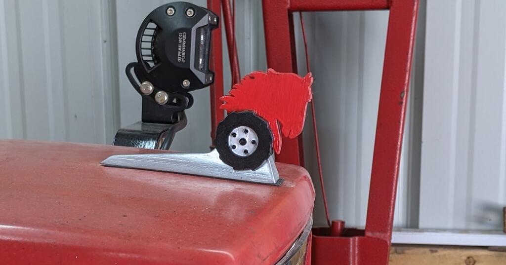

rjg854 13,203 #9822 Posted March 20, 2021 Installed the ornament I got from 3D Wheel Horse 6 4 Share this post Link to post Share on other sites
