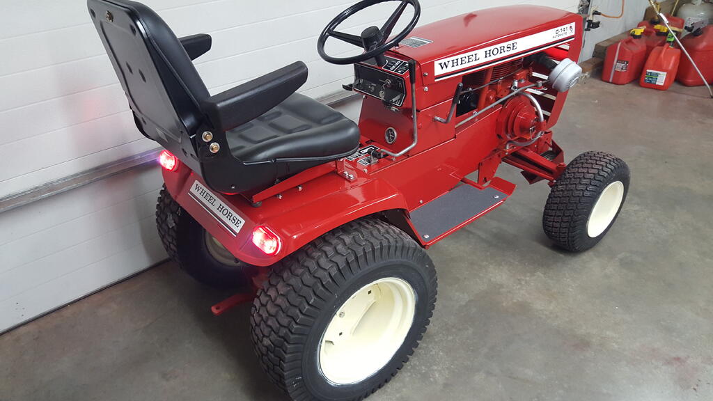

Gregor 4,848 #9476 Posted February 28, 2021 (edited) I just like the look. Probably overkill. This one probably isn't the quality of some others, but it works well for m Edited February 28, 2021 by Gregor 7 4 Share this post Link to post Share on other sites

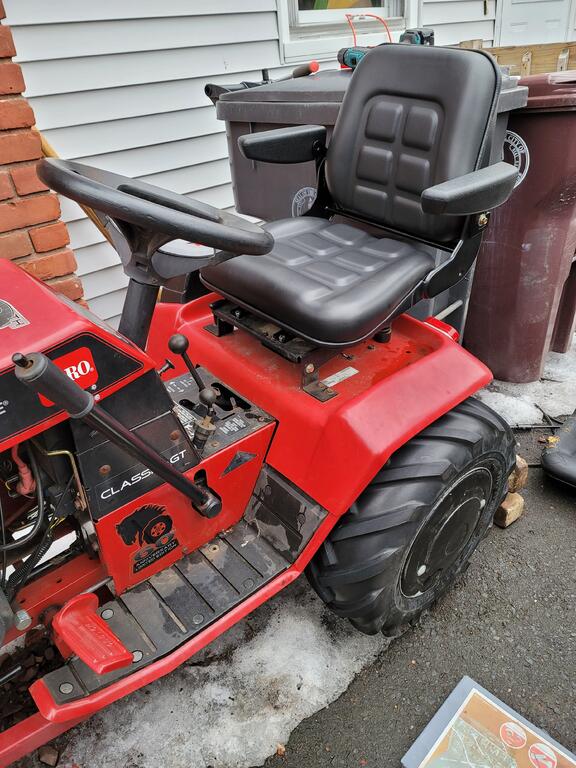

Jhook 849 #9477 Posted February 28, 2021 48 minutes ago, WVHillbilly520H said: Yes my 95 has them, they were an additional bolt on option not always added, and WH had 2 styles the 2 piece like on mine or the one piece bracket like on older B/C series tractors, I put mine on a year or so after installing the seat, most times IMO/experiences are more in the way than actually useful, more of a "cool" factor, good luck and hope you enjoy yours. Here is the seat I used on my 95 520... https://www.oleegoliq.com/michigan-seat-extra-highback-seat-black-model-v818-p-117829.htm Very nice. Good to know i just always recognized the 520s as having armrests. I doubt they will be very useful on this type of machine but they will look decent i hope. In the process of mounting it now 2 Share this post Link to post Share on other sites

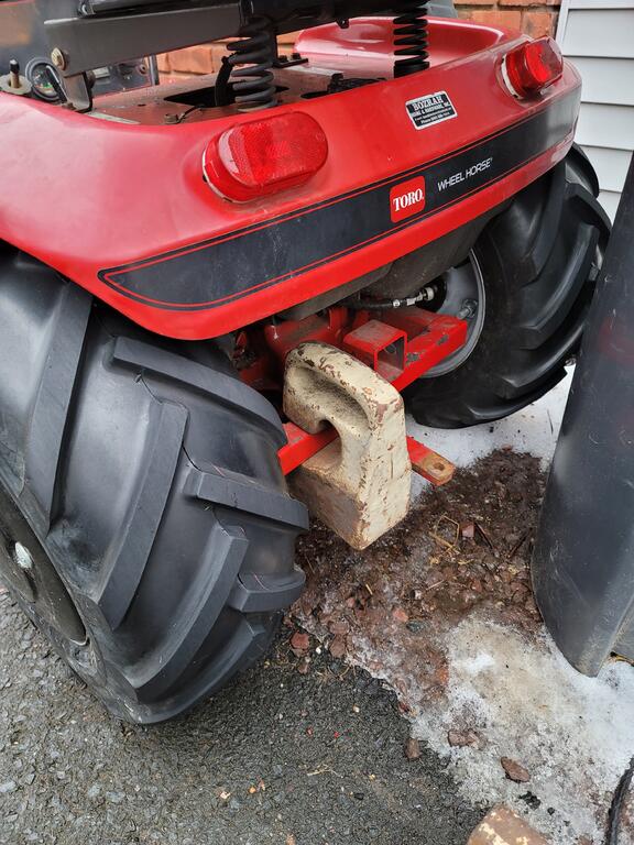

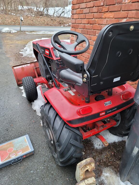

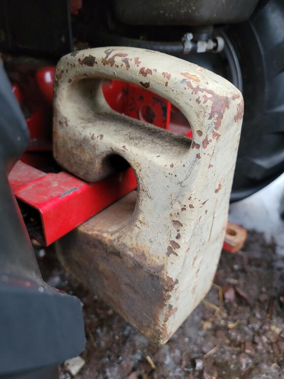

Jhook 849 #9478 Posted February 28, 2021 Well the seat is on, its very comfortable. Slides forwards and backwards about 8 inches with the adjustment lever. Folds up nicely on the factory seat mount, and the back folds down on the seat. Very easy direct bolt on replacement. Hopefully it holds up well. Next on the list is a mount for my 2 new rear weights 6 1 Share this post Link to post Share on other sites

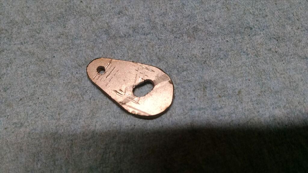

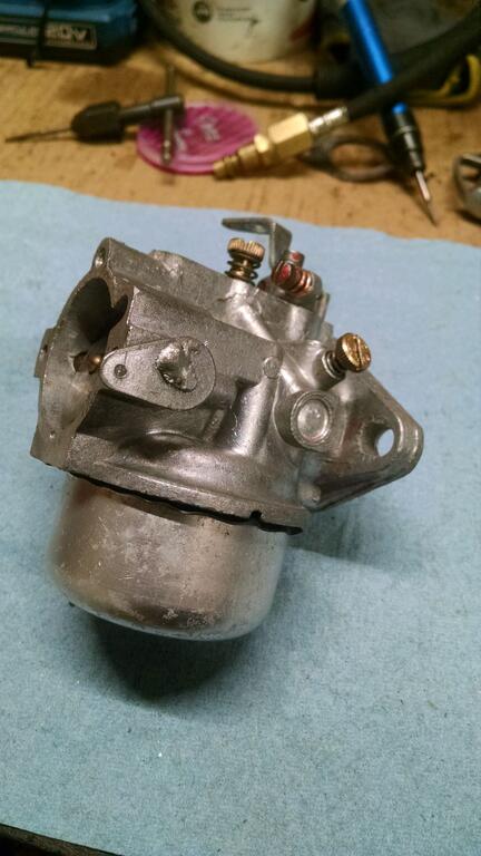

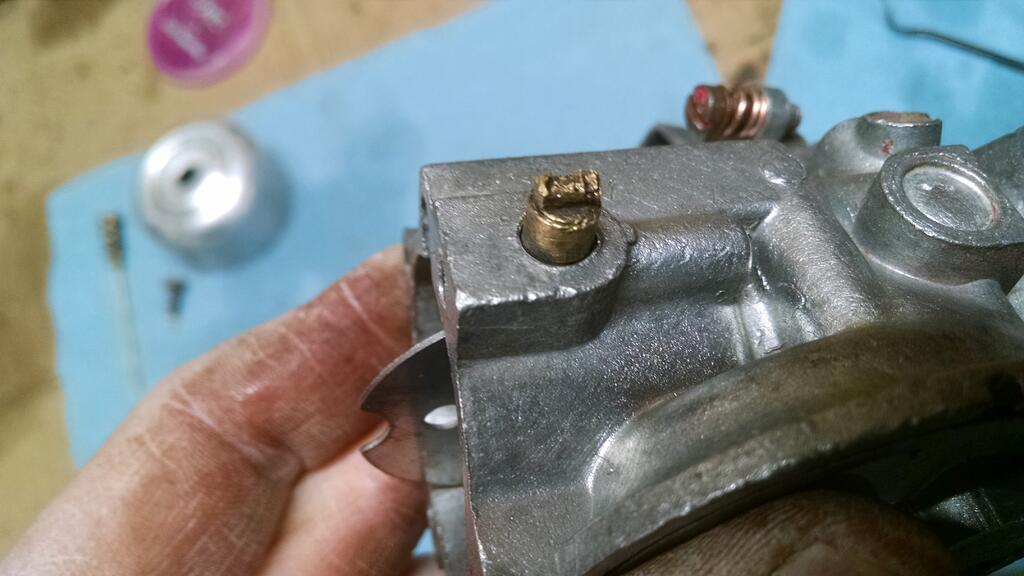

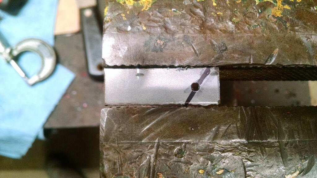

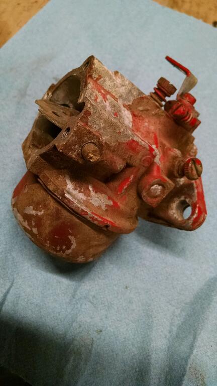

Achto 32,846 #9483 Posted February 28, 2021 (edited) Did some carburetor surgery. A friend of mine bought a 1267 and it had a china carb on it. Well it lasted a few hours for him and then gas started pouring out the air cleaner. If you tapped on the bowl it would be fine for a while but would start leaking again. Luckily the original Carter came with the tractor when he bought it, so he asked if I would be able to do anything with it. Here is ground zero on the original carb. An over night soak in Berrymans Chem dip cleaned it up real nice but there was a rather important part missing. The lever for the choke. Any one who knows me, knows that I like a challenge and like to fab my own parts. A small piece of scrap starts the repair. After making the hole oval and insuring that it was a tight/press fit on the shaft. A hole was added for the choke cable and a little shaping to make it look like something, I had my replacement part. After pressing the choke shaft on to my new part and peening the end of the shaft, I silver soldered the two parts together to ensure that the two parts would be one. The rebuilt Carter should last a lot longer than the China Carb did. Edited March 1, 2021 by Achto 4 12 1 Share this post Link to post Share on other sites

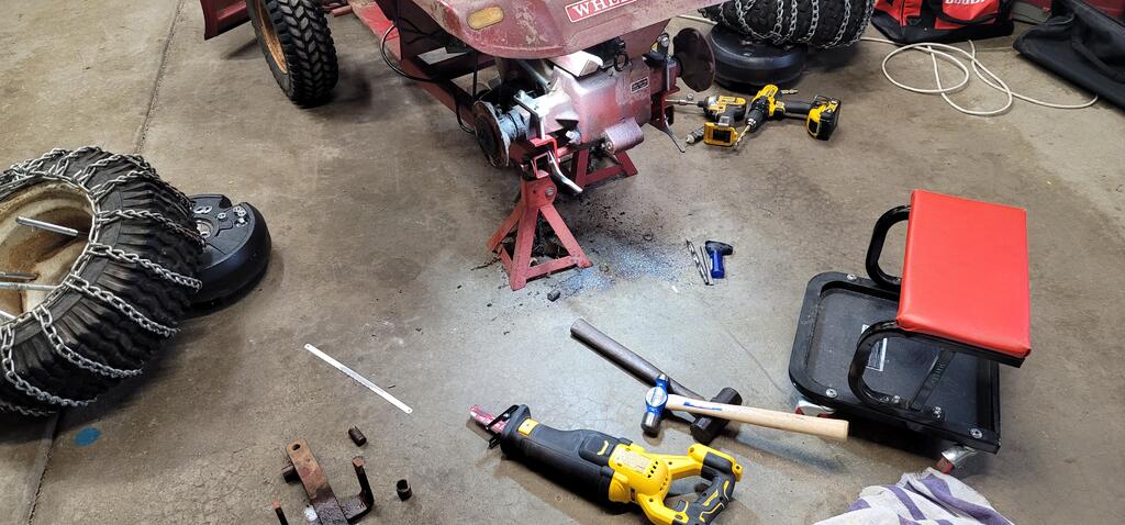

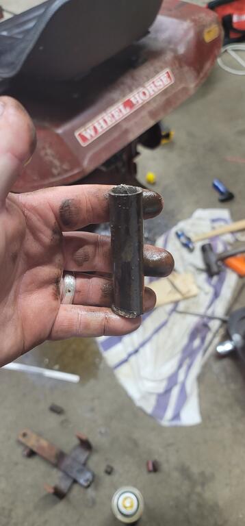

haydendavid380 759 #9484 Posted February 28, 2021 21 minutes ago, MikMacMike said: Oh oh when I see the sawzall come out you know its getting seriouse heheheheh, hey a wee bit of cussing is good for the sole brutha, excersizes the heart heheheheh, I have to close the shop door when I cuss, maws a wee bit religouse. Besides when I cuss she always bursts out laughing and that urks me more hahahahaha It's even more serious now, the smoke wrench is out, I've shattered two 1/2" punches, and have blisters on my hand from swinging a mini sledge all day....and I've got about 2mm of movement. I'm doing everything I can before I drill through the case to get PB down to the middle of the pin. 1 Share this post Link to post Share on other sites
Ed Kennell 47,648 #9485 Posted March 1, 2021 12 minutes ago, haydendavid380 said: I drill through the case to get PB down to the middle of the pin. This is the first step I take when preparing to remove a pin. I drill a 3/16 hole down to the pin in each side of the lug and keep it full of PB for a month. After I remove the pin, I tap both holes for a grease zerk. 4 Share this post Link to post Share on other sites

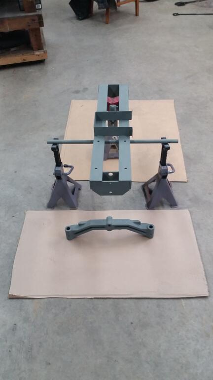

WHX?? 58,308 #9486 Posted March 1, 2021 It begins...laid the keel ... 8 6 Share this post Link to post Share on other sites
Horse Newbie 7,405 #9487 Posted March 1, 2021 5 hours ago, WVHillbilly520H said: Yes my 95 has them, they were an additional bolt on option not always added, and WH had 2 styles the 2 piece like on mine or the one piece bracket like on older B/C series tractors, I put mine on a year or so after installing the seat, most times IMO/experiences are more in the way than actually useful, more of a "cool" factor, good luck and hope you enjoy yours. Here is the seat I used on my 95 520... https://www.oleegoliq.com/michigan-seat-extra-highback-seat-black-model-v818-p-117829.htm Looks like the holes are pre-drilled in the back for the Wheel Horse armrests ... am I seeing that right ? Share this post Link to post Share on other sites

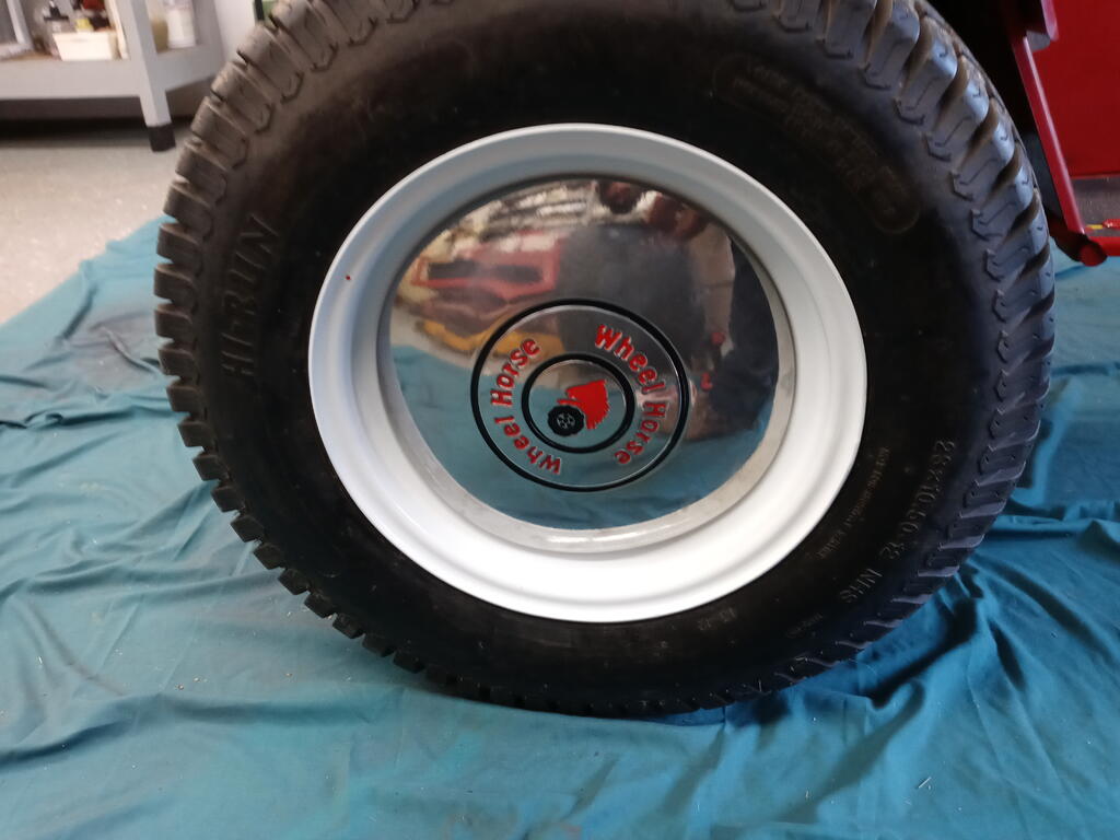

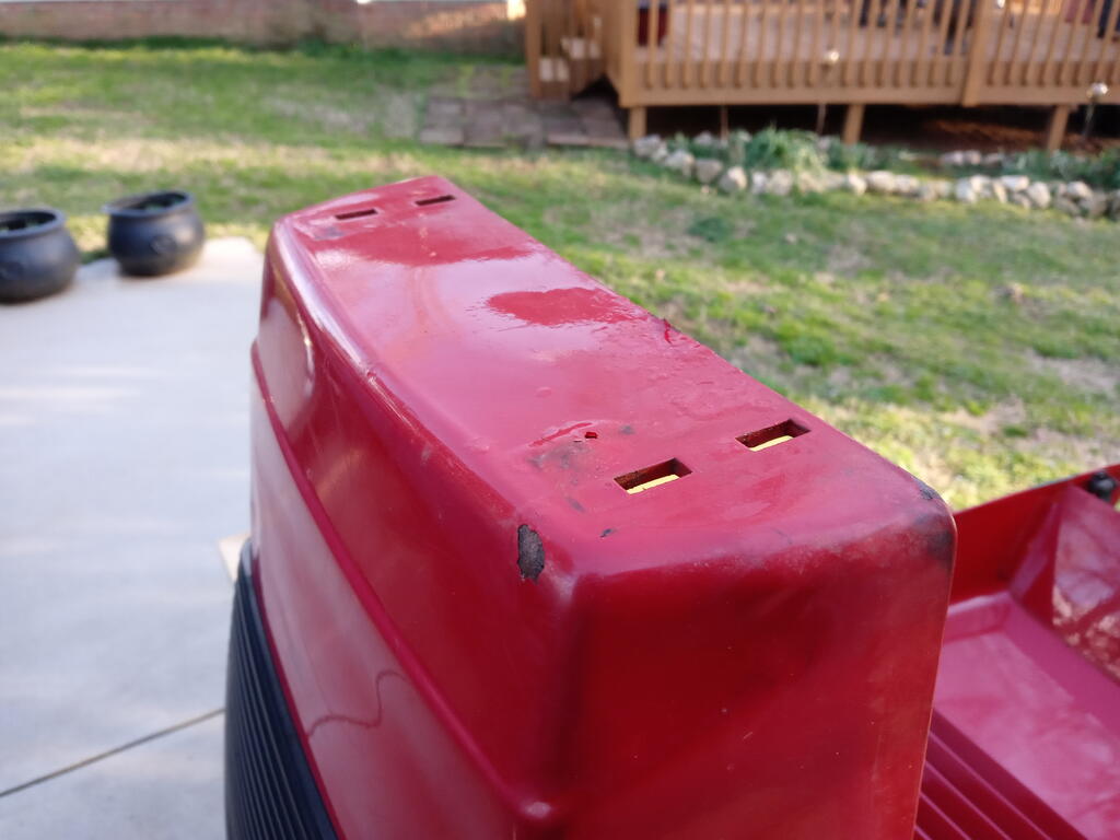

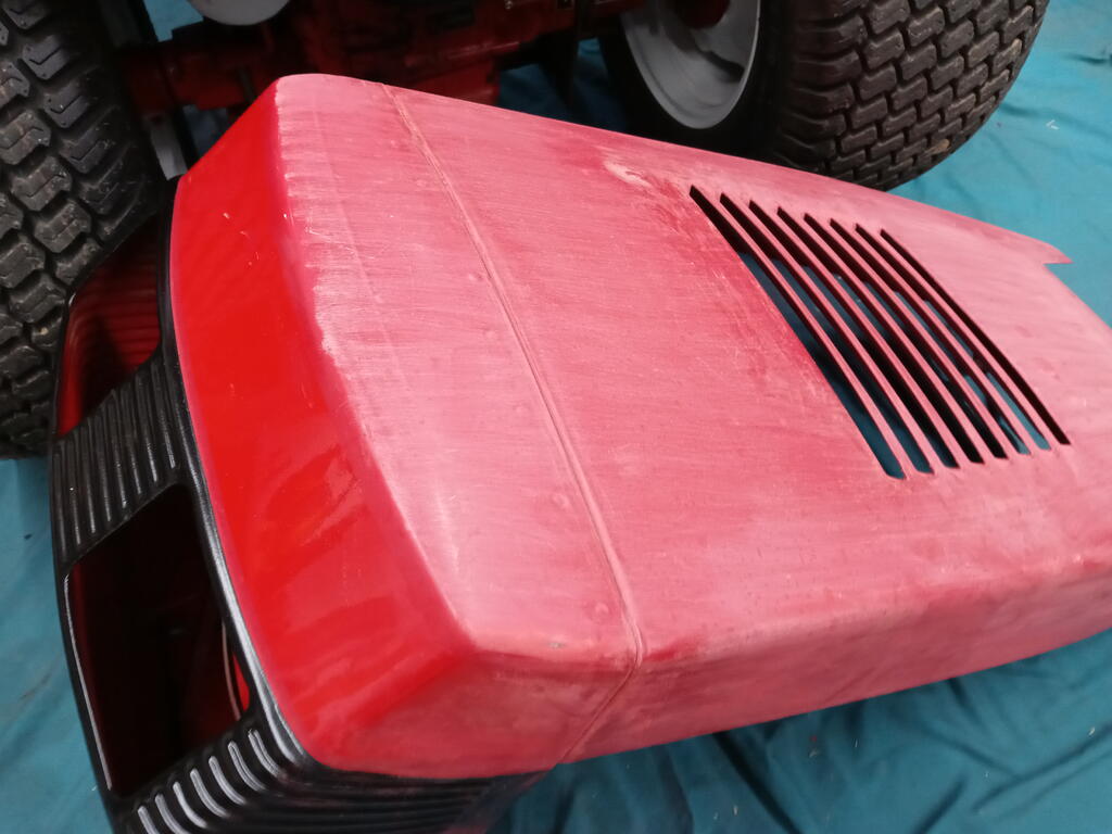

Horse Newbie 7,405 #9488 Posted March 1, 2021 (edited) Finally got around to installing my rear hub caps on my 1994 520H...was waiting until I painted my hubs... Also started sanding my hood to prep for Rustoleum Regal Red...was gonna leave the original paint, put I ordered new decals , and noticed some paint flaking and rust under the front of the hood where the hood hinges bolt on... Edited March 2, 2021 by Horse Newbie 6 1 Share this post Link to post Share on other sites
haydendavid380 759 #9489 Posted March 1, 2021 1 minute ago, Horse Newbie said: Finally got around to installing my tear hub caps on my 1994 520H...was waiting until I painted my hubs... Also started sanding my hood to prep for Rustoleum Regal Red...was gonna leave the original paint, put I ordered new decals , and noticed some paint flaking and rust under the front of the hood where the hood hinges bolt on... Those wheels look fantastic 2 1 Share this post Link to post Share on other sites
haydendavid380 759 #9490 Posted March 1, 2021 After nearly 12 hours that's almost enough to bring a man to tears 7 4 Share this post Link to post Share on other sites
Machria 78 #9491 Posted March 1, 2021 Nice hub caps!! 1 1 Share this post Link to post Share on other sites
ebinmaine 80,998 #9492 Posted March 1, 2021 6 hours ago, haydendavid380 said: After nearly 12 hours that's almost enough to bring a man to tears Victory! 1 1 Share this post Link to post Share on other sites
WVHillbilly520H 10,379 #9493 Posted March 1, 2021 8 hours ago, Horse Newbie said: Looks like the holes are pre-drilled in the back for the Wheel Horse armrests ... am I seeing that right ? Yes 100% 1 Share this post Link to post Share on other sites
Maxwell-8 4,371 #9494 Posted March 1, 2021 8 hours ago, haydendavid380 said: After nearly 12 hours that's almost enough to bring a man to tears That is promising for me. Have to remove one to that is stuck, yours doesn't look bad, mine is very rusty. Share this post Link to post Share on other sites
ebinmaine 80,998 #9495 Posted March 1, 2021 25 minutes ago, Maxwell-8 said: That is promising for me. Have to remove one to that is stuck, yours doesn't look bad, mine is very rusty. If you're going to use a hammer on the end be sure not to mushroom it so it won't go through. 2 1 Share this post Link to post Share on other sites

Pullstart 71,406 #9497 Posted March 1, 2021 9 hours ago, haydendavid380 said: After nearly 12 hours that's almost enough to bring a man to tears 1 hour ago, Maxwell-8 said: That is promising for me. Have to remove one to that is stuck, yours doesn't look bad, mine is very rusty. If you can leave enough nub on one end of the rod to get a pipe wrench on, you might be able to spin it free easier than pounding it too 3 1 Share this post Link to post Share on other sites
johnnymag3 2,646 #9498 Posted March 1, 2021 1 hour ago, ebinmaine said: If you're going to use a hammer on the end be sure not to mushroom it so it won't go through. Eric....Just heat and cool several times....use impact between cycles...it will come right out !!!! I have dealt with MANY of those suckers, they can be WICKED !!! Learned the Heat / Cool to move the metal on its own.. Good Luck, john 3 1 Share this post Link to post Share on other sites
lynnmor 9,051 #9499 Posted March 1, 2021 12 hours ago, Horse Newbie said: Looks like the holes are pre-drilled in the back for the Wheel Horse armrests ... am I seeing that right ? Yes, they are the correct holes, actually the metal shell is the same except the seat mounting holes. I am a bit skeptical about the online store, proceed with caution. If you do buy, let me know how that went, the price is great. 1 Share this post Link to post Share on other sites

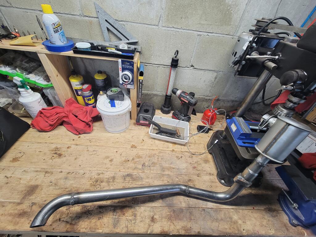

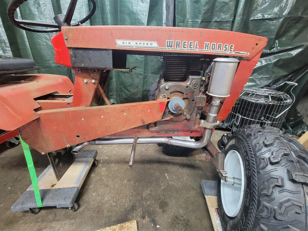

OldWorkHorse 3,156 #9500 Posted March 1, 2021 (edited) Worked on the 1257Heavy project today. Fab up the exhaust or most of it still need some hangers and clean up some welds but not to bad. Put couple flanges in so don't have to take it all out if somthing needs be worked on. PSA make sure to grind down sharp cut pipe edges.... my knuckle will thank you. Edited March 1, 2021 by OldWorkHorse 6 5 Share this post Link to post Share on other sites
