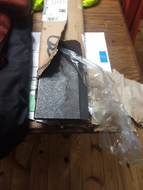

ebinmaine 80,856 #9301 Posted February 16, 2021 Got this on the FedEx today. Now to drill some holes. 6 2 Share this post Link to post Share on other sites

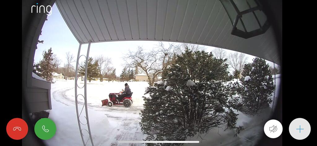

Andy N. 2,845 #9303 Posted February 16, 2021 So I had to go into work early today, and it was snowing. About mid morning during a conference call, my Ring notification kept going off. When I had a moment to look, I was pleasantly surprised to see my wife plowing the driveway on the 312-8. I was able to snap this screen shot with my phone. Of course it started snowing again shortly after this pic and hasn't stopped since, but I am thankful for the work that she put in. I guess now I'll have to share snow plowing seat time as I do the grass cutting seat time. 4 7 1 1 Share this post Link to post Share on other sites
ZXT 2,402 #9304 Posted February 16, 2021 24 minutes ago, ebinmaine said: Got this on the FedEx today. Now to drill some holes. And what is that? Story time! 2 minutes ago, Andy N. said: So I had to go into work early today, and it was snowing. About mid morning during a conference call, my Ring notification kept going off. When I had a moment to look, I was pleasantly surprised to see my wife plowing the driveway on the 312-8. I was able to snap this screen shot with my phone. Of course it started snowing again shortly after this pic and hasn't stopped since, but I am thankful for the work that she put in. I guess now I'll have to share snow plowing seat time as I do the grass cutting seat time. Very cool! Good woman there. 5 Share this post Link to post Share on other sites

ebinmaine 80,856 #9306 Posted February 16, 2021 7 hours ago, ZXT said: And what is that? Story time! That there is a piece of steel 60" long, 4" wide and 1/2" thick. I saw the recommendation on this site somewhere awhile back and put it in my jungle site "save for later". After I drill 6(?) Holes it'll be the lower cutting edge for the 61" plow I got from @wallfish. I'll also be adding a reinforcing bar of some sort across the top. Beast plow! 2 3 Share this post Link to post Share on other sites
Lee1977 7,793 #9307 Posted February 16, 2021 6 hours ago, ebinmaine said: That there is a piece of steel 60" long, 4" wide and 1/2" thick. I saw the recommendation on this site somewhere awhile back and put it in my jungle site "save for later". After I drill 6(?) Holes it'll be the lower cutting edge for the 61" plow I got from @wallfish. I'll also be adding a reinforcing bar of some sort across the top. Beast plow! That going to add around 40 pounds, are you building this for Trina? 1 4 Share this post Link to post Share on other sites
ebinmaine 80,856 #9308 Posted February 16, 2021 17 minutes ago, Lee1977 said: That going to add around 40 pounds, are you building this for Trina? No Sir. I'll be hefting this one. 2 Share this post Link to post Share on other sites

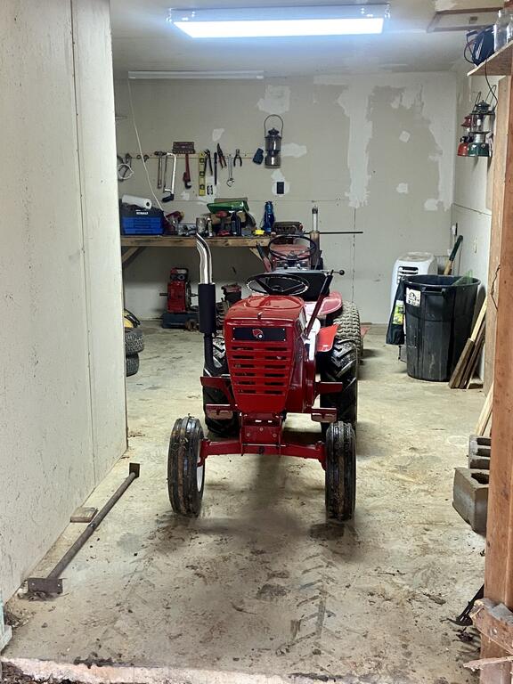

TJ5208 1,841 #9309 Posted February 16, 2021 Here's ole red awesome new exhaust hope you guys like it can't post or start topic because of some voting thing 8 Share this post Link to post Share on other sites

TonyToro 1,190 #9311 Posted February 17, 2021 23 hours ago, ebinmaine said: Got this on the FedEx today. Now to drill some holes. Where did you purchase it from? Plastic edge is a great idea. I had a poly edge on my last pickup trucks plow. It was quiet and scrapped well. Share this post Link to post Share on other sites
8ntruck 9,328 #9312 Posted February 17, 2021 16 hours ago, ebinmaine said: That there is a piece of steel 60" long, 4" wide and 1/2" thick. I saw the recommendation on this site somewhere awhile back and put it in my jungle site "save for later". After I drill 6(?) Holes it'll be the lower cutting edge for the 61" plow I got from @wallfish. I'll also be adding a reinforcing bar of some sort across the top. Beast plow! What kind of steel? Share this post Link to post Share on other sites
ebinmaine 80,856 #9313 Posted February 17, 2021 54 minutes ago, 8ntruck said: What kind of steel? Seems to me it's 1055 1 Share this post Link to post Share on other sites
ebinmaine 80,856 #9314 Posted February 17, 2021 1 hour ago, TonyToro said: Where did you purchase it from? Plastic edge is a great idea. I had a poly edge on my last pickup trucks plow. It was quiet and scrapped well. This is steel I got off the jungle site. 2 Share this post Link to post Share on other sites
8ntruck 9,328 #9315 Posted February 17, 2021 23 minutes ago, ebinmaine said: Seems to me it's 1055 I'll have to check to be sure, but I think you could flame harden the edges and get a little more wear from it. 1 1 1 Share this post Link to post Share on other sites

ebinmaine 80,856 #9318 Posted February 17, 2021 6 hours ago, 8ntruck said: I'll have to check to be sure, but I think you could flame harden the edges and get a little more wear from it. I'd be curious to know but I only have a propane torch to use. Share this post Link to post Share on other sites

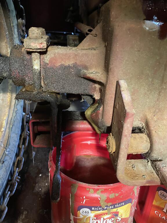

pfrederi 21,214 #9321 Posted February 17, 2021 6 minutes ago, MichiganCO said: Welcome to red square. Looks like a leaky axle seal. Not a major issue. But if it is too cold to work on it right now just make sure you keep adding gear oil. Also if you can jack it up see if there is any up/down front/rear play in the hub. (a little in and out is oK) 2 Share this post Link to post Share on other sites
MichiganCO 4 #9322 Posted February 17, 2021 Thank you, yeah I’m currently draining the trans oil. it’s brown ish green and tons of sludg 2 Share this post Link to post Share on other sites
pfrederi 21,214 #9323 Posted February 17, 2021 1 hour ago, MichiganCO said: Thank you, yeah I’m currently draining the trans oil. it’s brown ish green and tons of sludg If you have a warm place to work go ahead and pull the hub. The seal can be replaced from the outside. if it has been leaking for a while the hub may come off easily. Do not beat on it if you use a 3 jaw puller and it doesn't move fairy easily stop and look in the transmission section here for various methods to remove the hub. The 3 jaw can break the hub if you push it hard. 3 1 Share this post Link to post Share on other sites
ebinmaine 80,856 #9324 Posted February 17, 2021 1 hour ago, MichiganCO said: Thank you, yeah I’m currently draining the trans oil. it’s brown ish green and tons of sludg 30 minutes ago, pfrederi said: If you have a warm place to work go ahead and pull the hub. The seal can be replaced from the outside. if it has been leaking for a while the hub may come off easily. Do not beat on it if you use a 3 jaw puller and it doesn't move fairy easily stop and look in the transmission section here for various methods to remove the hub. The 3 jaw can break the hub if you push it hard. Hey Paul I put some "search words" in a thread by @Bear G that shows a few good pullers. Plug in whatever comes to mind in the search window and change the search to "*** AND ***" to include the words. Here's the link: 2 Share this post Link to post Share on other sites
