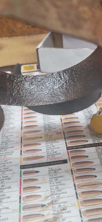

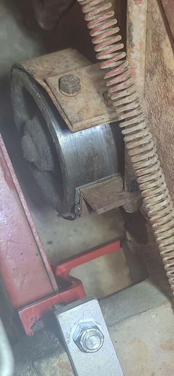

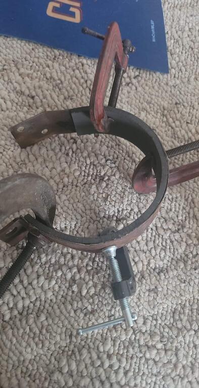

haydendavid380 759 #8984 Posted January 30, 2021 26 minutes ago, sparkie333 said: I agree must be clean --works the best--great to see the fix. This is how it came out after putting a wire wheel on it to knock off all the rust Sprayed it down with brake cleaner, spread glue down to both surfaces, and clamped it for about 4 hours Got everything back together once the glue was tacky enough to hold the material to the back during installation, and then tightened it down and set the parking brake. Hopefully everything will be golden by tomorrow morning to shove around some snow. 4 1 Share this post Link to post Share on other sites

sparkie333 265 #8987 Posted January 30, 2021 3 minutes ago, haydendavid380 said: Hopefully everything will be golden by tomorrow morning to shove around some snow. Looks good I'm sure every thing will work out fine. 2 Share this post Link to post Share on other sites

sparkie333 265 #8990 Posted January 30, 2021 14 minutes ago, haydendavid380 said: This is how it came out after putting a wire wheel on it to knock off all the rust That looks real good should do the trick. 1 Share this post Link to post Share on other sites

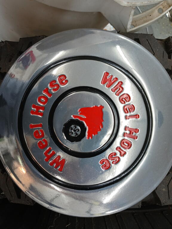

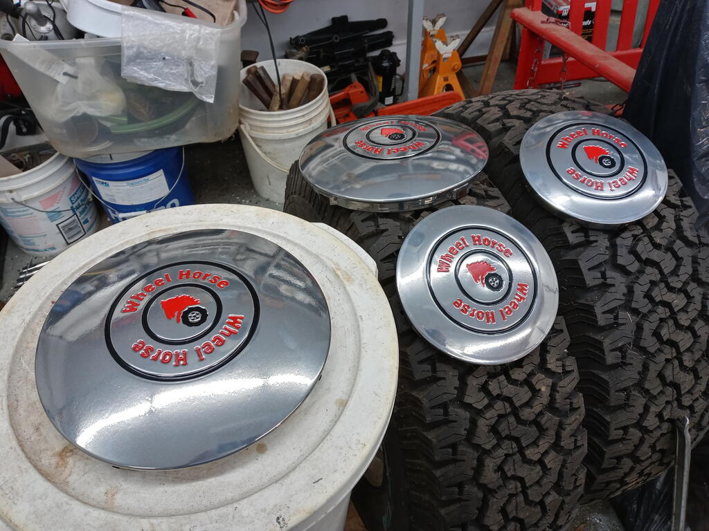

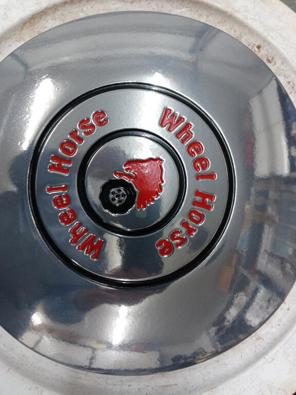

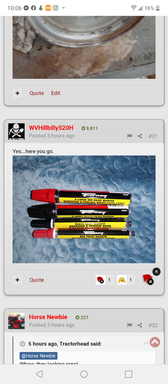

Horse Newbie 7,405 #8996 Posted January 31, 2021 Okay, so today I finally painted the center of my 520H hubcaps...an idea I stole from @WVHillbilly520H... 3 6 Share this post Link to post Share on other sites

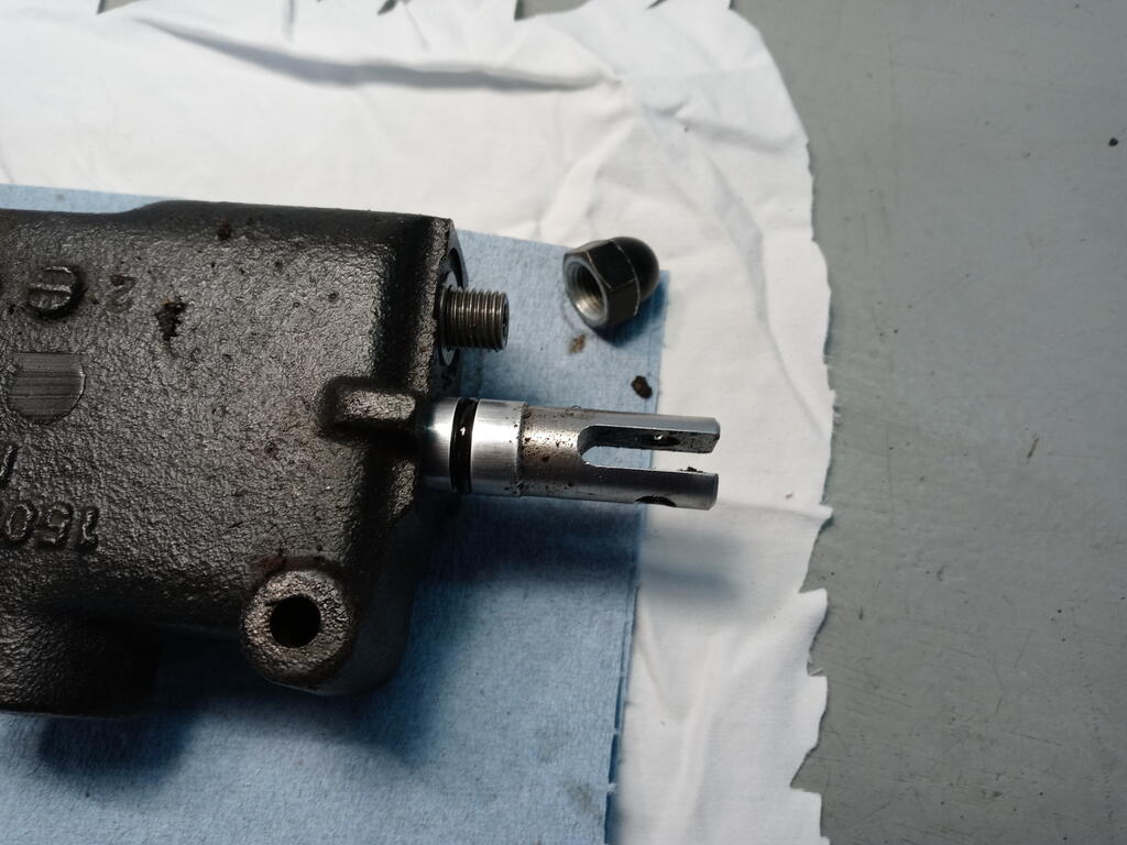

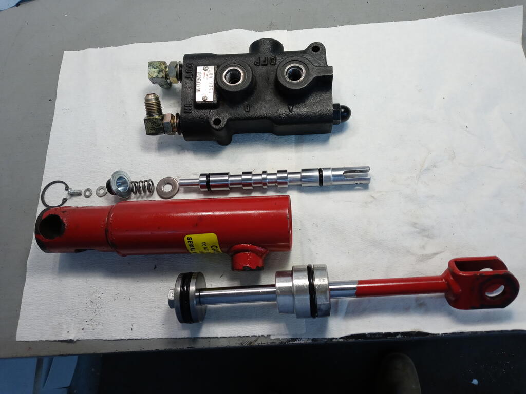

Horse Newbie 7,405 #8998 Posted January 31, 2021 So today I disassembled my hydraulic control valve on my 1994 520H...the shaft was coming too far out of the front of the valve body exposing the o- ring ( not sure if this was the source of leak )... looked at parts list for the valve body and discovered that I was missing the small washer and screw that goes on the left end of the shaft that runs through the valve body. 4 1 Share this post Link to post Share on other sites
JohnD 145 #8999 Posted January 31, 2021 6 minutes ago, Horse Newbie said: Okay, so today I finally painted the center of my 520H hubcaps...an idea I stole from @WVHillbilly520H... Nice caps! I like the tread on those tires the caps are sitting on. What brand and model are those tires? 1 1 Share this post Link to post Share on other sites
sparkie333 265 #9000 Posted January 31, 2021 18 minutes ago, Horse Newbie said: Okay They look great to me. 1 Share this post Link to post Share on other sites
